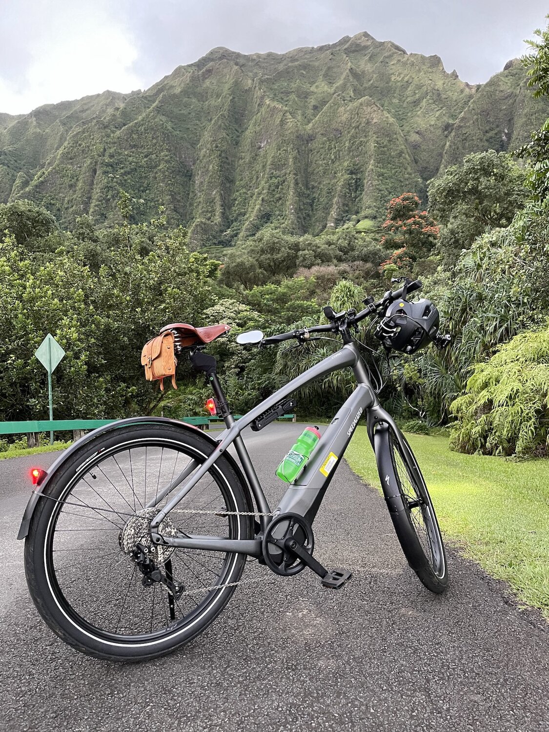

Very pleased with new Como 4.0 650b
Specialized confirmed that mine is the 6 volt version. I also asked if any XL Como 5.0 were in the plans and she didn't see anything for the coming year. Bummer.

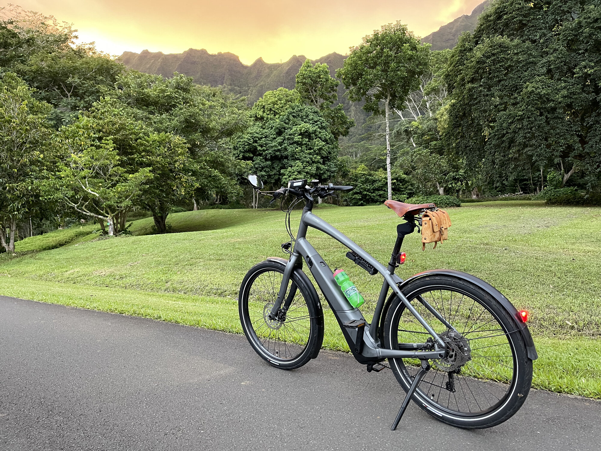

I finally got a video of the daily ride through the park. It's getting dark early and that's why I want to improve my lighting. I'm using a 2000 lumen light on my hemet. I'm also using a B&M Ixon Space (150 lux) on my handlebars.
Tonights ride

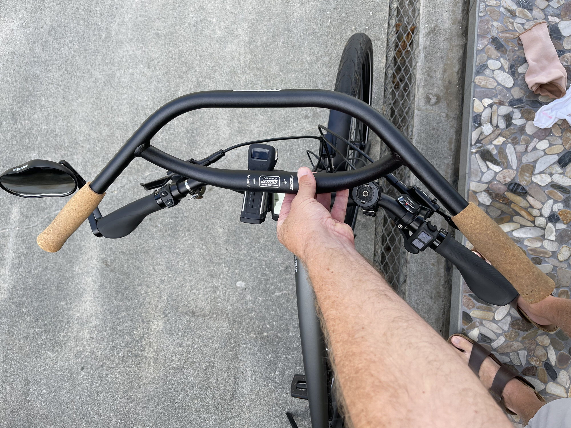

Thanks Stefan. The new chainring is on the way. I'll have the bike shop sort it out. I'm going to make some other changes:
  • change the bars to Jones H Bar with the 2.5" rise
  • Install Supernova Mini Pro 25 light
  • Have them continue to problem solve my electrical / software issue
Let us know how the Jones H Bar works out.
I wouldn't use the Jones H-Bar as curved handlebars eliminate the use of Redshift ShockStop stem (the suspension stem gets its load from a wrong angle).
When I got the H bars I was a little disappointed that they didn't sweep back more. For the last 20 years I've ridden bars that sweep all the way back. The 45 degree bend on the H bars is not that different than the stock 30 degree Specialized bars.
Here's what sold me on the H bars:
  • 2.5" gain in rise
  • the extra bar in the front to add lights and such. My bars are getting crowded
  • the extra space on the bars where the grips and controls go...I'm adding extra stuff like remote controls for lights
  • the bag looks really cool. I want to bring my binoculars on my daily garden ride. The bag is not too big...not too small. H Bar Pack
But, correct me if I'm wrong...I don't think the redshift ShockStop or their competitor come in a 31.8 clamp diameter.
Anyway, I've got them and I'm going to try them out. I'm in the experimental stage of new bike ownership. However, for most people the stock Como would be perfect.

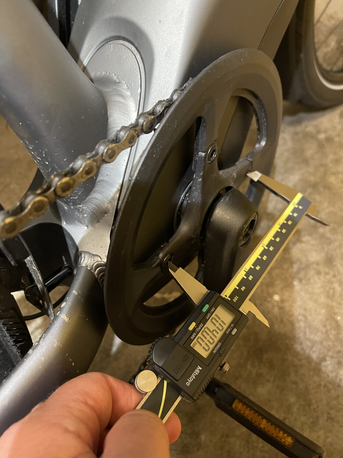

It does. The standard diameters are 25.4, 31.8 and 35 mm, and the ShockStop comes in 31.8 mm size. The 31.8 diameter is the most popular nowadays (I've just checked the diameter with a caliper).
The limitation of Redshift is it can only take a flat handlebar or the drop one. The documentation specifically reads any curved handlebars wouldn't work.
Sorry, I was wrong. I think my Como has a 1 1/4" stem. I asked Redshift and here's their reply.

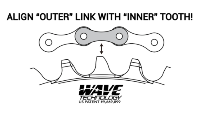

Dave:
  • Check whether the derailleur clutch is engaged. The small grey plastic tab should be in the backward/top position.
  • Check if the links of the chain are placed properly in the Narrow-Wide manner on the chainring.
With the class of your drive-train, the chain should never jump off!
@Super Dave
I've had that happen a few times with my Creo. And the chain got stuck between the ring and the motor housing. One time I did forget to re-engage the clutch.
The second time was after another rear flat. I may have misaligned th chain and the gear teeth as mentioned by @Stefan Mikes. I know I had a picture of the proper alignment but can't find it now.

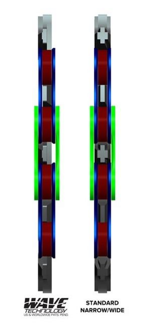

Two possible arrangements depending on the manufacturer:
Praxis "Wave" chainring.
With Narrow-Wide chainrings, the outer link should be placed on the wider chainring tooth when looking from the top. (The wide and narrow teeth alternate). There is a diagram at the back of of the chainring showing where the outer chain link should be placed.
