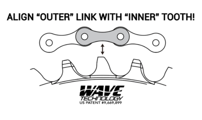

Two possible arrangements depending on the manufacturer:
Praxis "Wave" chainring.
With Narrow-Wide chainrings, the outer link should be placed on the wider chainring tooth when looking from the top. (The wide and narrow teeth alternate). There is a diagram at the back of of the chainring showing where the outer chain link should be placed.
That's it. Thanks. I now have at least one copy but where's the other one? (g)

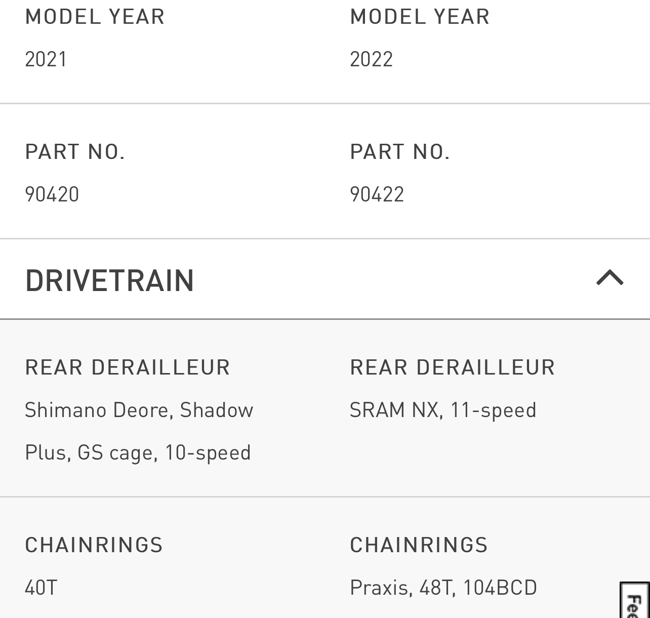

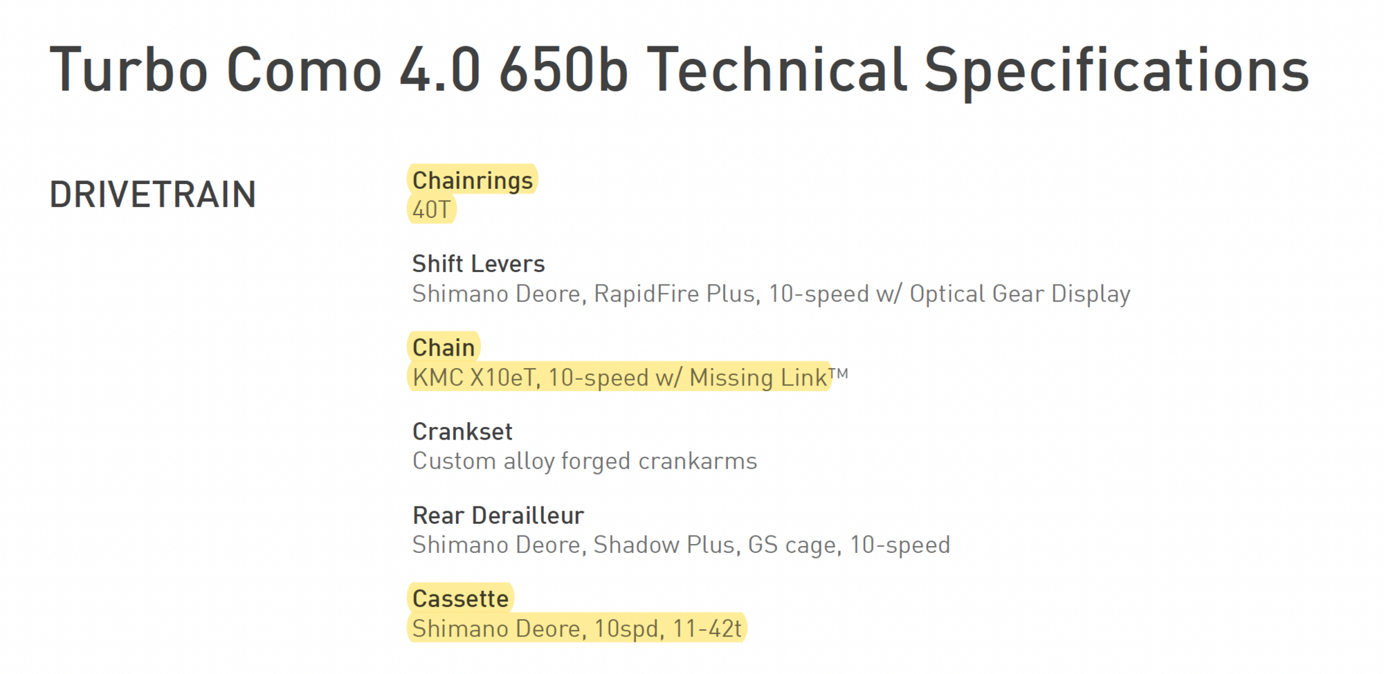

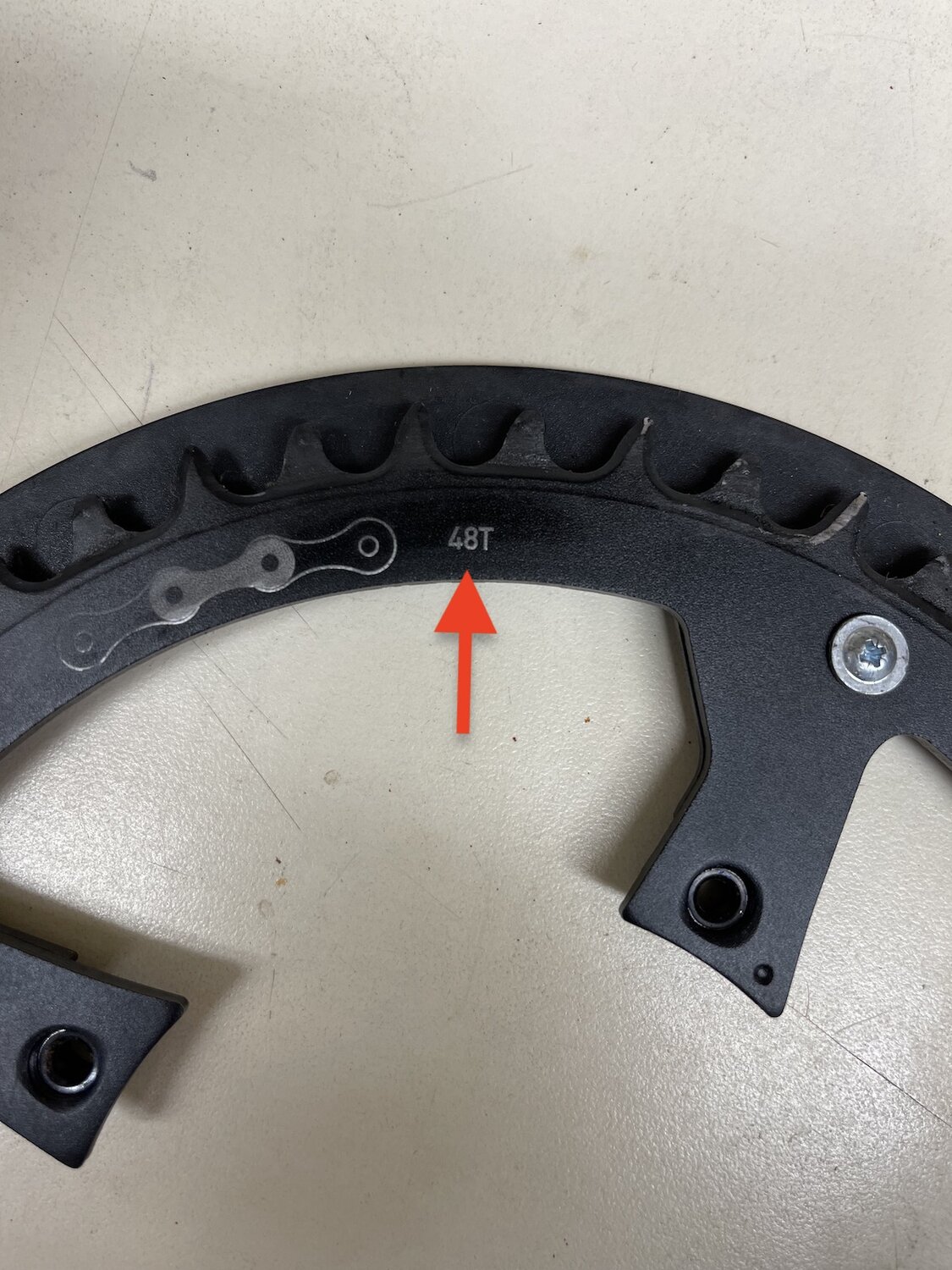

Man, the published Como specs are freaking wrong on the size of the chainring. The specs state 40 teeth. The actual chainring is 48. My new chainring is 38. Way too big of a jump down. Awww man, that was a waste.
that’s frustrating! specialized changes stuff all the time … the 2022 version has a 48t up front per the spec. maybe they ran out of the 40t and already had the 48 and started using them. of course the 2022 is also an SRAM 11-speed …. they’ve switched a lot of shimano drivetrains to SRAM for whatever reason, probably availability at least in part.
Dave: Como has always come with a 48T chainring. Don't despair: Riding steep hills? You'd love the jump from 48 to 38 teeth. That was exactly the swap I did to my full power Vado! I could clear very steep hills during my vacations (and I had the 46T largest cassette cog!) Now, in the flatland, I actually keep the 38T chainring, as it gives me tremendous acceleration. My cadence is very good, and actually I don't ride at top speed in the Winter...
That's also a good picture of the chain "inner tooth" alignment mark. I used a silver marker to put an alignment line on the outside of the chainring since you can't easily see the diagram on the roadside after you've dropped a chain.
Yes, they make that diagram almost absolutely useless by tucking it on the inside. I'm pretty certain that's the reason for one of my de-chain incidents - misalignment.
The outside of the chainring is covered with a chainguard, so no use for the diagram on the outside, either. With some practice, the user can easily see the proper alignment by looking at the chainring from the top.

Also, the bike shop said my chain was too short for the 48 tooth chainring and that's why it could have been jumping off.
