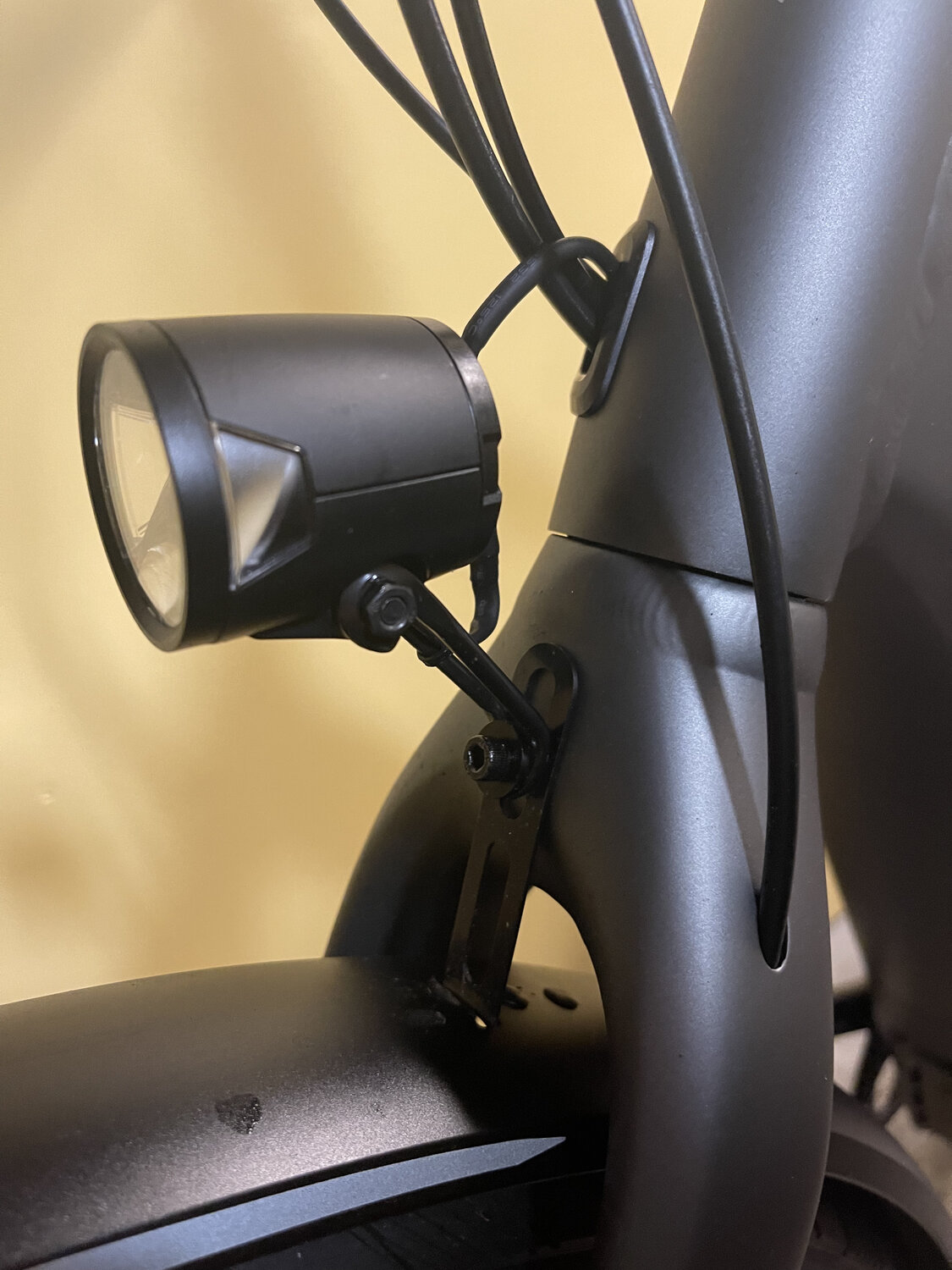

You could use the Lezyne Power E115 from the 5.0 which is quite a bit brighter than the E65. I use a Vado SL version for my Creo. You would need to order the Como version and not the Vado SL version due to the mounting differences. The Vado SL is mounted upside down on the bars rather than on the fork. I just ordered it from a Specialized dealer as a spare. I started with the H65 on my Creo because the ebike shop had it in stock and I forgot to check the P/N until after I bought it. I used it until I was able to get the E115 which is noticeably brighter.

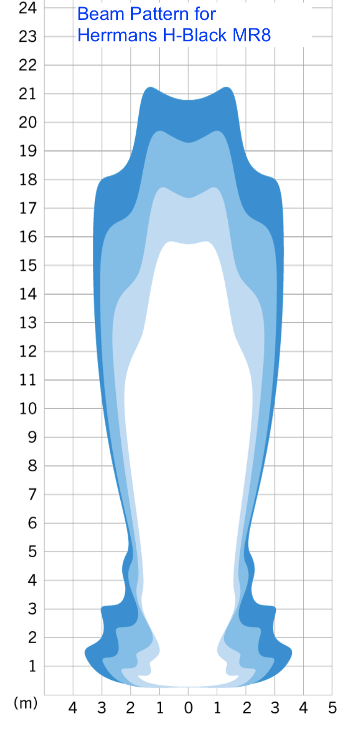

Allan, thanks for the Specialized link. Interesting that the light my Como has is not listed. I think my Como came with a Herrmans H-Black MR8. They also make a higher output light in the link below but it's not as powerful as the Lezyne Power E115.
Herrmans light simulator
Herrmans also provides good diagrams on the beam patterns of their lights. After looking at their beam diagram I think I need to tilt the light higher. That might help with providing a wider beam.
That's very useful information. Indeed, tilting the light properly makes miracles (I'm doing such adjustments on empty road at nighttime).
Allan, you are very right! I have overlooked the fact the lights are differently placed in different Specialized e-bike models.
If tilting it up doesn't do it then the Lezyne Pro E115 STVZO eBike Headlight is available online with bare wire ends. Since the Como light is mounted upright it's not a custom version like the Vado SL light. The connectors are 3mm (or 2.8mm?) spade connectors. The connectors are a little harder to find but are also used in hobby type RC vehicles. A lot of wired bicycle lights use these connectors which is not as common in the US but is my preference over battery lights.

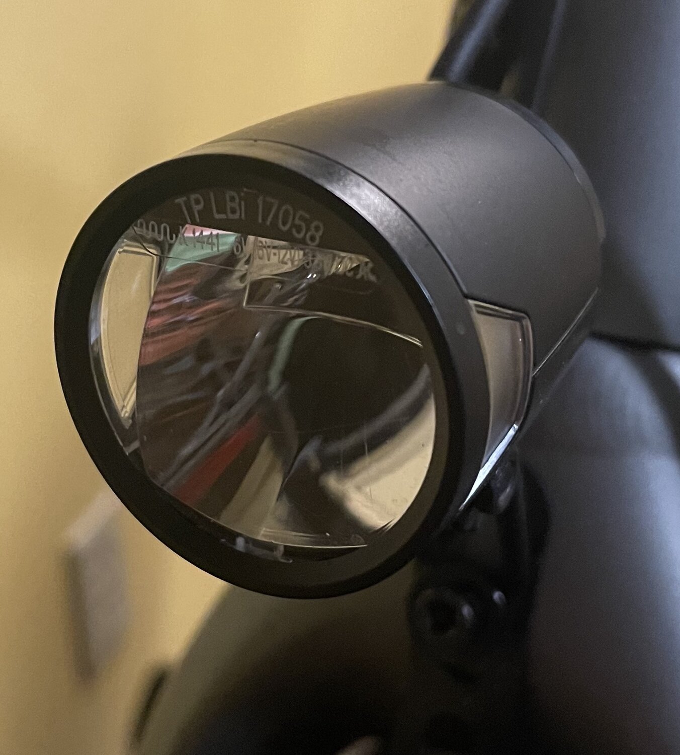

I read on another thread that your Specialized comes with the Supernova model light. How do you like it? How's the power output and beam quality?
Supernova V521s
The reason I ask is because the Specialized Rider Support contacted me to see how I like the new bike. They said I can order this SuperNova from them but they don't have much info on it and it doesn't show up on my dealer's computer. I assume it's the same that came on your light. Here's the Specialized reps description.

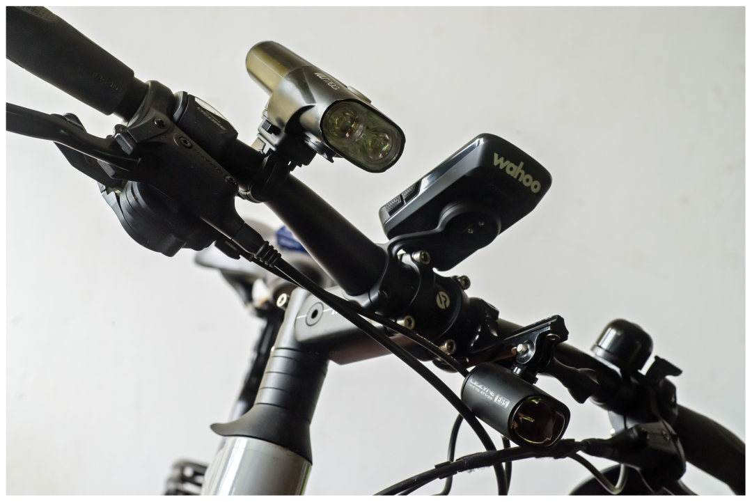

Unfortunately the new 2022 Como 5.0 lights, Lezyne Power E115 will not work on your 2021 Como 4.0, because this is a fork-mounted front light, the most similar replacement that we carry and it is a significant upgrade, approx. 180 lumens:
S195800001 LGT MY19 COMO/SUPERNOVA FRONT LIGHT W/MULTIMOUNT ADAPTER TO MOUNT ON FORK, INCL. CABLE/CONNECTOR
By the way, I think she was misinformed on the Lezyne E115 because mine came with a fork mount.

She may be referring to the Lezyne E115 Specialized uses on the Vado SL. It is an OEM version with the lens and projector reversed so it can be mounted up side down like the one in Stefan's photo. The standard off the shelf Lezyne E115 is a fork mount.

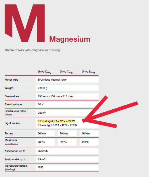

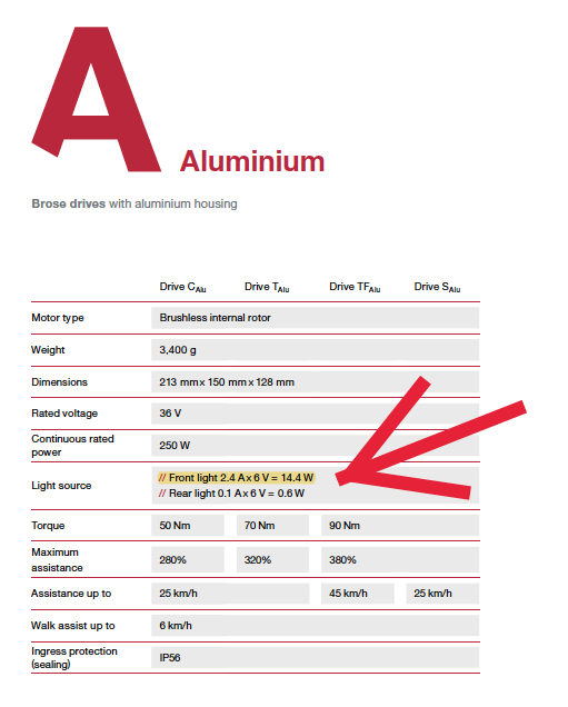

I'm still searching for a better headlight. The Lezyne is pretty good but requires additional lighting. I know my model 4.0 uses the Brose T motor. But, it appears Brose has two versions of their model T. Does anyone know which one of these versions would be on my 4.0 Como?
  • Front light 2.4 A × 6 V = 14.4 W
  • Front light 2 A × 12 V = 22 W

@Super Dave: Your motor is Specialized 1.2, and that's Brose T Alu. Interestingly, pre-2022 Vado and Como 5.0 come with Specialized 1.3, which is Brose S Alu. The magnesium casing motors have only been used with Specialized e-MTBs, that is Levo and Kenevo. Could you use a voltmeter to make sure about the voltage?
Of course Rome is wrong here because he thinks of Brose motors as defined for Europe, while Specialized motors are made by Brose for Spesh, and Spesh do what's appropriate for them. In Europe, Brose T (Specialized 1.2) motor is for 25 km/h e-bikes, and Brose TF (Specialized 1.2s) is for 45 km/h S-Pedelecs. In Canada, Specialized just sets the 1.2 motor to 32 km/h, and it is set to 28 mph in the United States, as the North American e-bike law is not that strict as we experience it in the EU.
