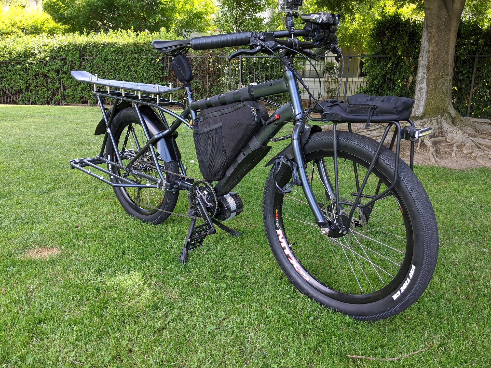

I have run the Speedster in 26x2.8 on MTX39's (32mm inside width IIRC) and they are great.
The tread by its nature picks up and throws sand and grit back at the rider. You'll see I have a body fender on the down tube of the bike and this is a big help. They roll smooth and fast. Inside I have a 26x4.0 oversized tube and FlatOut tire sealant. They do not self-steer. Tire pressure is near the max but its still really low thanks to the near-fatness of the casing. I have had this bike carrying in excess of 400 lbs so bigger tires with near max air pressure, on wider rims, has a practical application.
I formerly used Continental Contact Plus City tires in 2.15 on this bike and they were flatproof... but the ride was basically like round rocks.

Very cool bike! Are those Jones handlebars?
I've had 26x3.5 on my bike for three years. Zero flats but I don't ride off road much.
@Alanzo Yes those are Jones bars. I was hit by a car a few years ago and injured my wrists as part of the result. I can't ride straight bars anymore cuz of the pressure on the wrists. The Jones bars are on most of my bikes as a result. This pic's angle shows the bars and a good angle on the Vee 2.8 tires and their profile on the rims. they are right in the sweetspot of that rim width according to the DT Swiss chart.

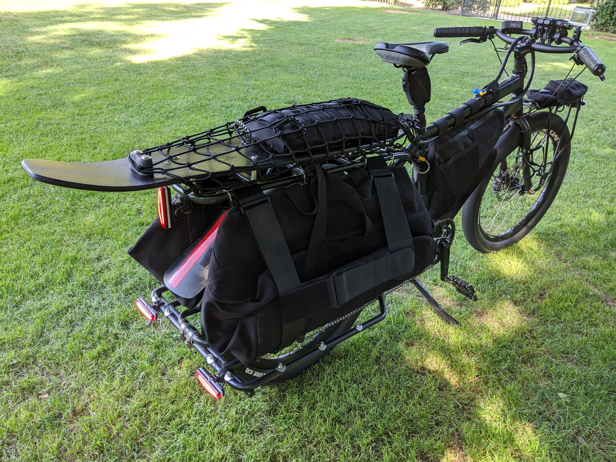

Is this a bike you built? Very unique rack system!
