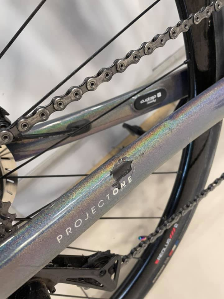

This is a photo of today published by a guy who had a crash on a bike path. Yes, you read it correctly: on a bike path. The good CF frame went to waste. I really didn't want something like that happened to the fork of my SL. I could afford the carbon fork but only once.
Aluminum might not take such a beating well either. And in a fork, it might be toast bent aluminum can't be easily bent back into shape - steel on the other hand can be forced back into shape.
An aluminium replacement fork is far cheaper.
