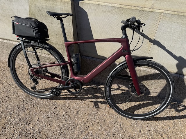

Yes, meant cadence .
The measurements are the same old / new bike but the handlebar sits higher and thud the right is more upright . Guess that’s why I get this feeling. Anyway will get it adjusted some time soon. Could maybe do it myself but the local bike shop 1 km away is actually pretty good for repairs/ small fixes .
…….after checking that the crank length is the same on all your bikes. The le length is marked on all cranks.
Rest assured, it is the same crank length.
If the crank length is the same and the saddle height is the same on both e-bikes then you cannot improve anything by manipulating the saddle height. (If the saddle gets higher or lower then you can never pedal efficiently).
It is the Future Shock system at the stem. A non-Specialized store cannot give you any advice how to improve the e-bike geometry as the parts there are proprietary. Specialized can install a longer FS compatible stem. Just saying.
