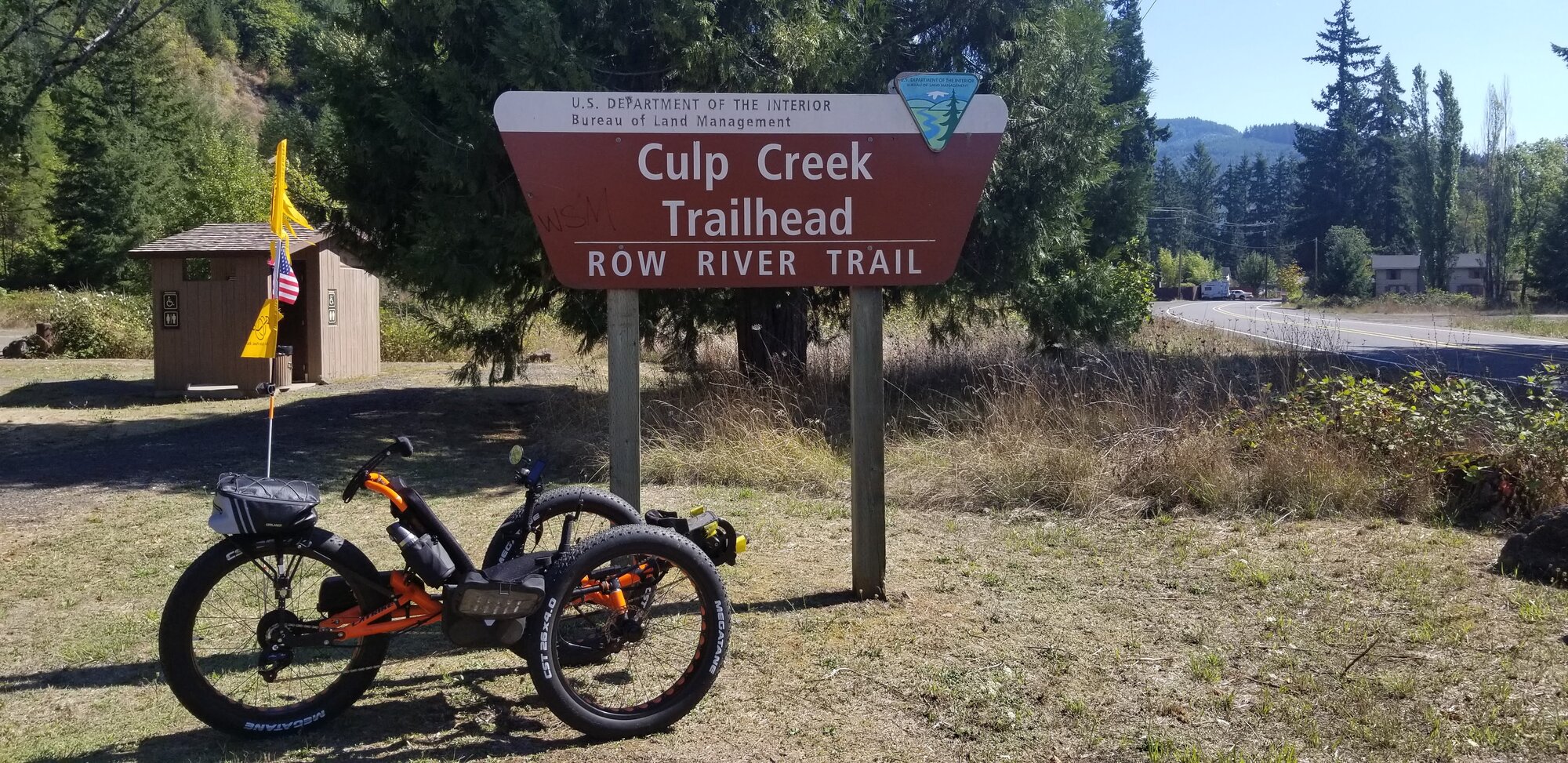

Utah Trikes has the motor listed as the 750w incorrectly, it's the torque sensing Bafang Ultra (recognizable from the photos). This motor performs very well. It handles very steep grades and gives me the confidence to ride long distances. In the picture below, I did 40 miles that day on various trails with 55% of the 17amp hour battery left. That was after going up and down some pretty good hills. There is a bit of motor buzz but I would say it's within reason.
