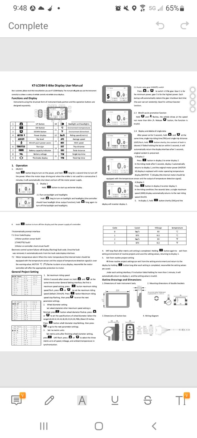

Using KT 35 A Controller + Display on Aventure
Rob55
Has anyone done this?
Do the connecters fit?
Are there instructions available?
Am I correct this modification will work with an external controller mount and a splice of the battery connector?

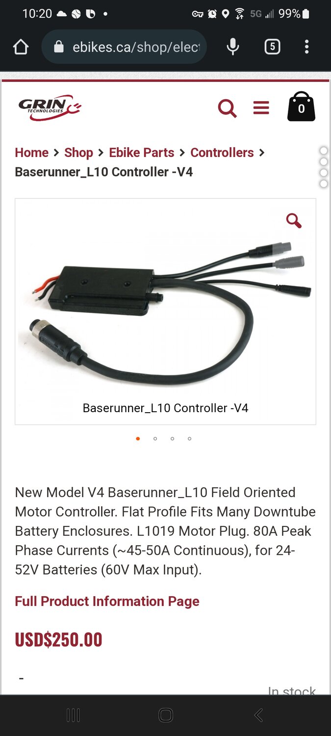

I looked into doing exactly what you want to do. The motor has an L1019 connector on the Aventure. Rewiring that and all the other connectors to fit the KT was more than what I wanted to dig into. Of course it can be done, but that's beyond my interest or expertise at this time. Grin Tech. has controllers (with L1019) and a display too, but they are very much DIY and expensive. Aventon really missed the boat with their stock controller settings. PAS is horrible. As you know, there is long delay in assist on both the throttle and pedal.

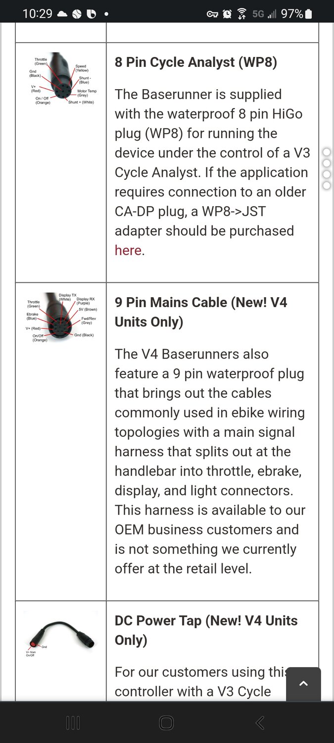

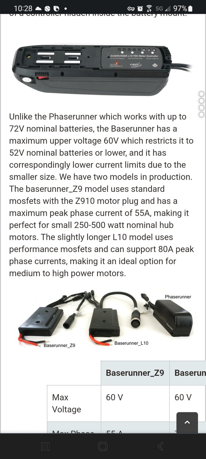

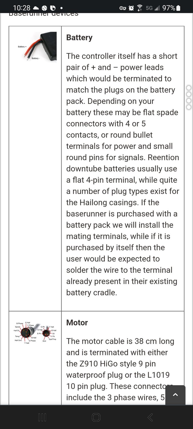

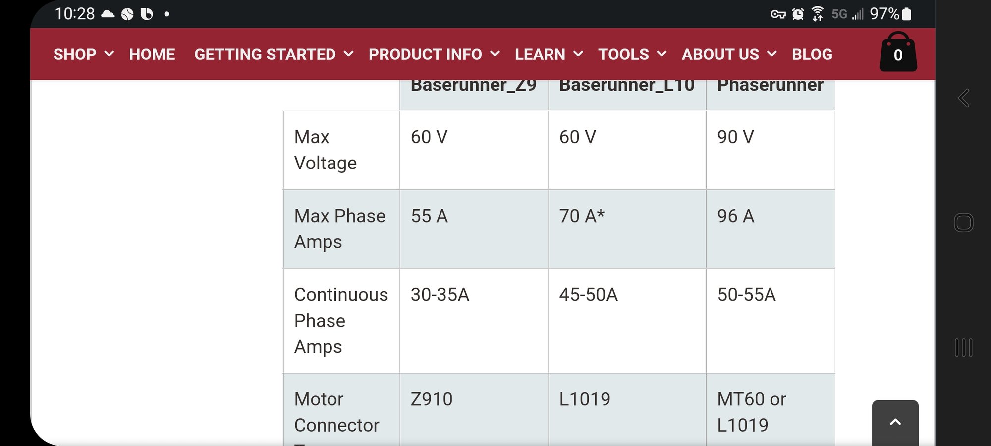

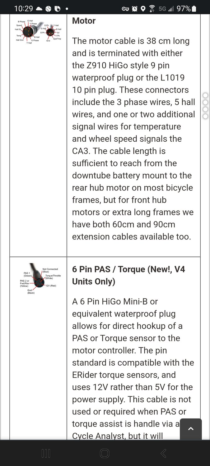

More on this controller

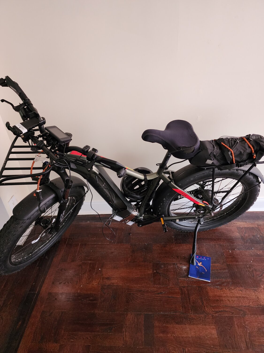

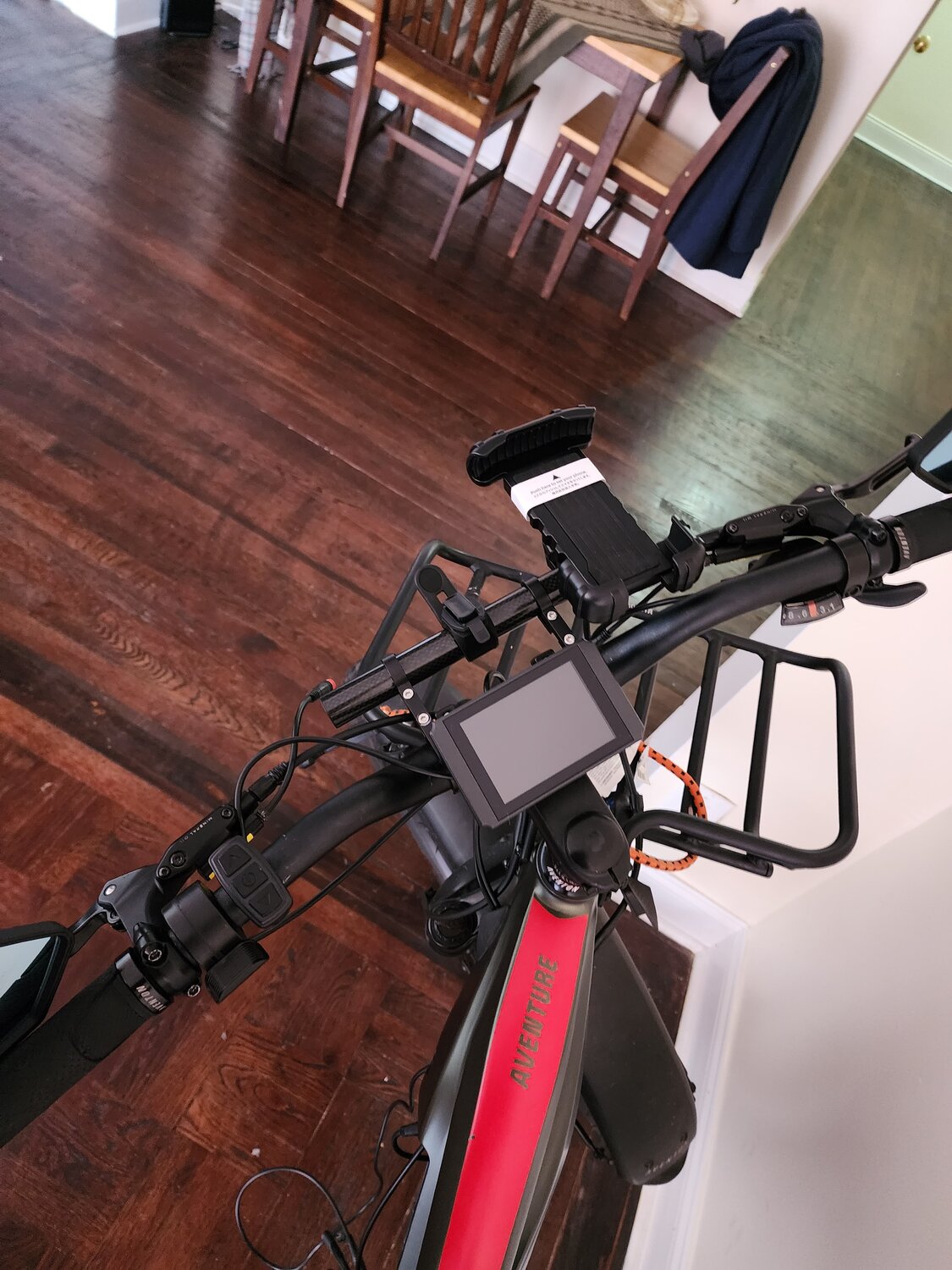

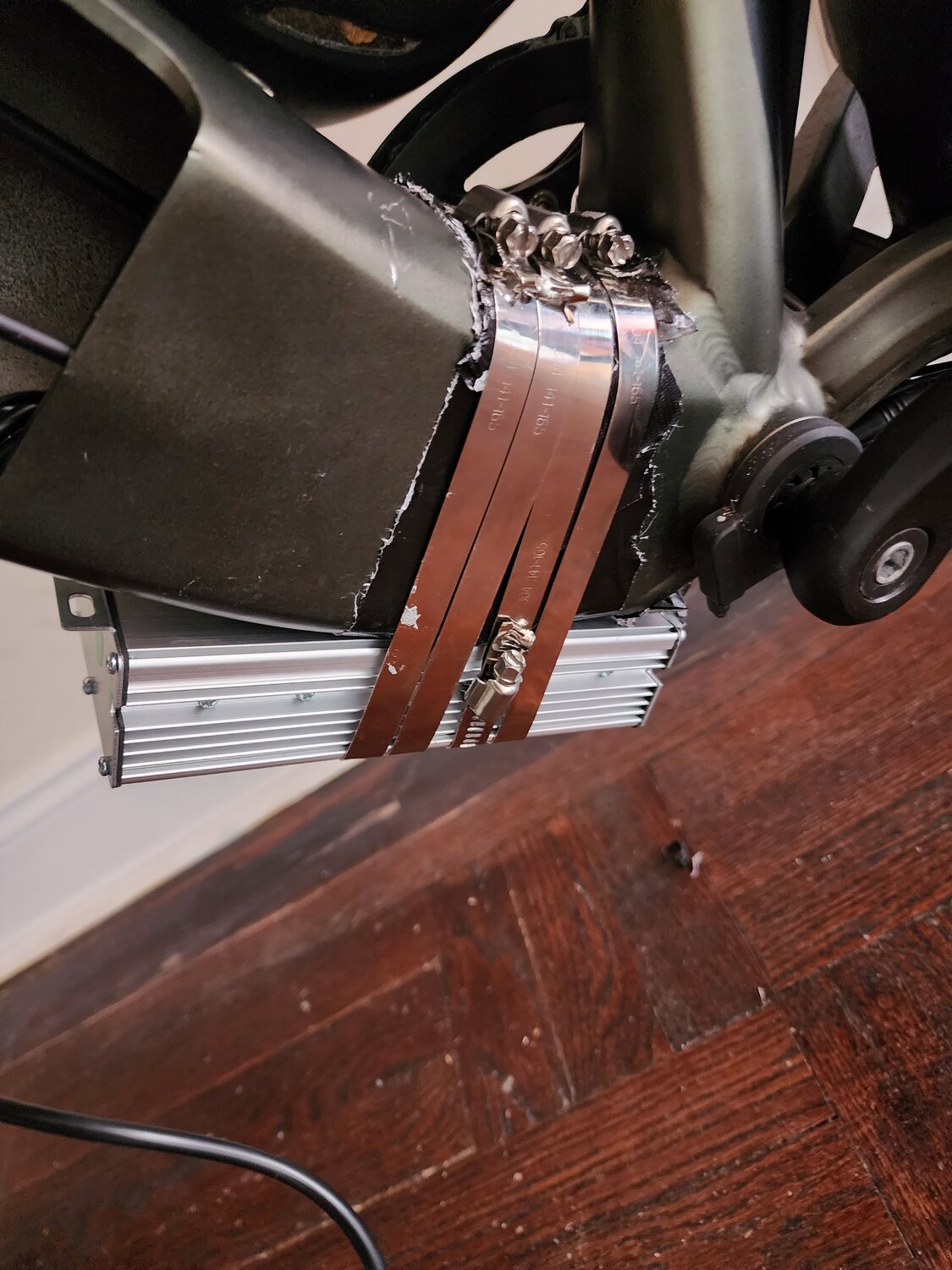

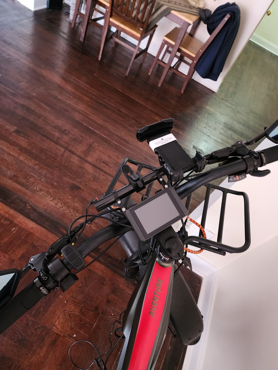

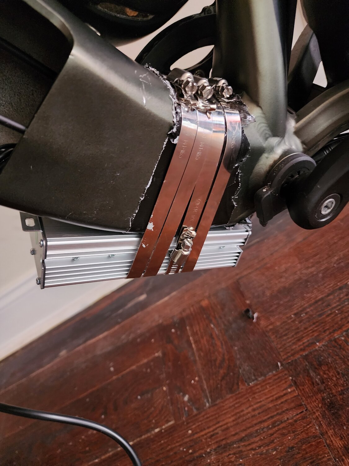

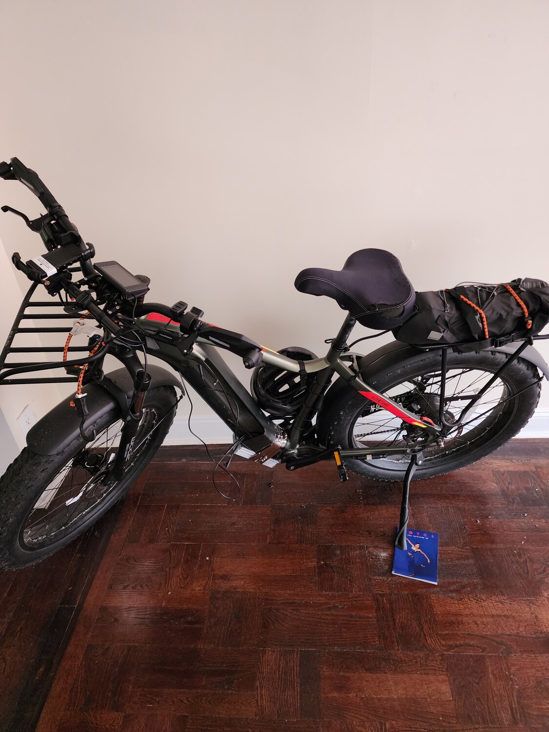

I have mostly installed the 35 Amp controller from electrobikeworld.com. It's weather proof and huge! Had to order different parts and wires to make it work.
