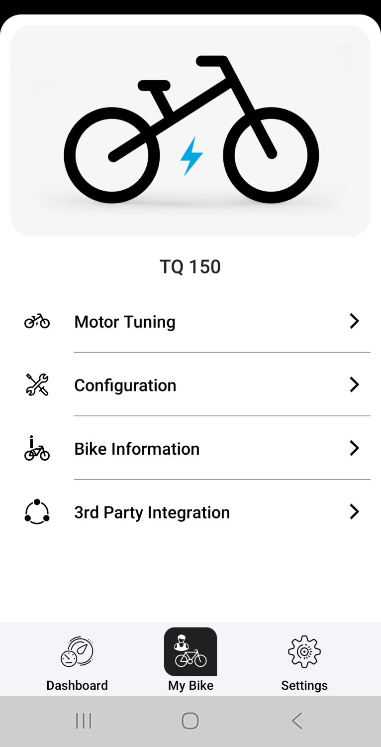

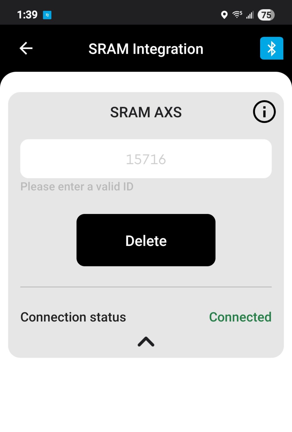

Yes, I upgraded my BMC RoadMachine AMP X from the stock SRAM Rival to the new Force controllers with the bonus buttons.
1: pair your new SRAM Components then add them together in the SRAM AXS app. Then use the SRAM app to assign the right lever bonus button to Ant+ 1 and the left lever bonus button to the Ant+ 2.
2: in your mobile TQ app, if you have the latest firmware update for your bikes TQ system and also the tq app, you should see a 3rd Party Integration option under the My Bike menu. Input your SRAM Derailleur ID. I found my ID by looking at the Derailleur info in my Garmin Edge 540 sensors.
If you already have your ID set in the TQ app before you programmed the SRAM Bonus buttons, it won't work! Just delete the SRAM ID from the TQ 3rd Party Integration and re-add it.
It works great! Just use a quick press on the SRAM controller Bonus buttons. If I press for a bit more of a moment it won't respond. But a quick press works nicely.
