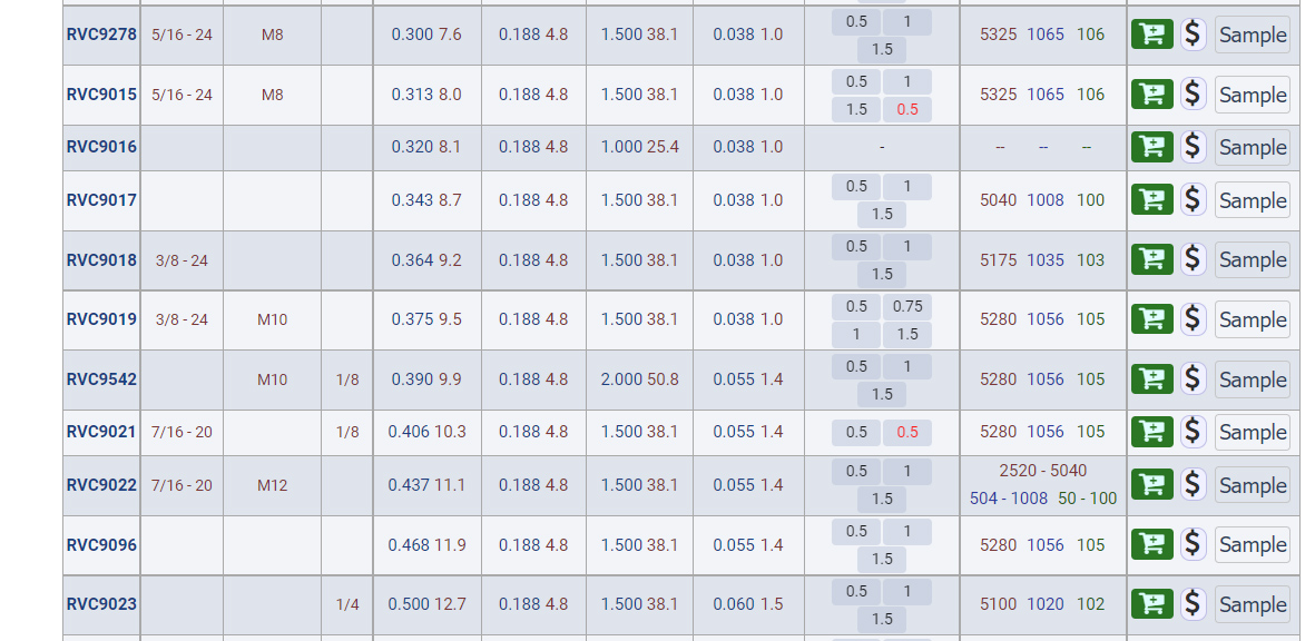

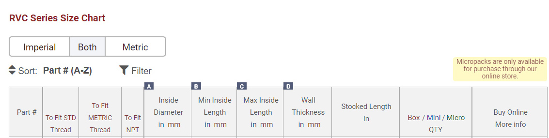

The Higo and Julet connectors I have are all between .375 and .500 in diameter.
One of these part #'s from Mocap should fit but measure to be sure. They will stretch somewhat for a tight fit, especially if heated.
