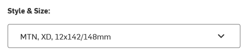

I tried to upgrade today to an SRAM XD cassette, 10-52 (XX-1) assuming that the NX that came stock on the bike (10-52) was XD, and I had an unpleasant surprise when I took off the cassette and saw it had a Shimano freehub body. I misunderstood compatibility; everything is compatible; XX1 shifter, XX1 chain, XX1 cassette but I forgot about the hub :rolleyes: I was ready to return the cassette when I realized that I could change the freehub body. I think this one will work
https://www.backcountry.com/dt-swiss-3-pawl-freehub-body-and-end-cap
The Vado SL 5eq is equipped with a Specialized hub 148/12 mm thru axle, 3-pawl freehub and I would be switching out the Eagle NX cassette to an Eagle XX1. Has anyone had experience with this particular upgrade?

I did this upgrade on my 2022 Vado SL 5.0 EQ. I checked with my local Specialized dealer in Nashua, NH and they told me that there is an XD driver replacement freehub for the stock wheel that is a direct replacement for the HG freehub. I think I paid around $70 for this back in January 2023. This was ordered from the Specialized parts catalog by the dealer.
To do the swap, take off the wheel, remove the old cassette and axle spacers. Grab hold of the HG freehub and pull firmly (I should use the phrase "jerk it off" but that sounds wrong). The freehub came off easily. Then clean the old grease off of the ratchets and friction surfaces on the wheel hub. Grease the pawls and threads on the freehub and repack the ratchet mechanism (on the hub and the freehub). Push the freehub back on to the wheelhub, being sure to push the ratchet pawls in so they engage with the ratchet teeth on the hub. Reinstall the axle spacers. Make sure the freehub is fully engaged on the wheel hub. Install the cassette using a standard tool. Make sure the cassette is fully seated on the XD driver and that you have not crossthreaded the cassette/freehub interface. A standard cassette tool works nicely for me.
