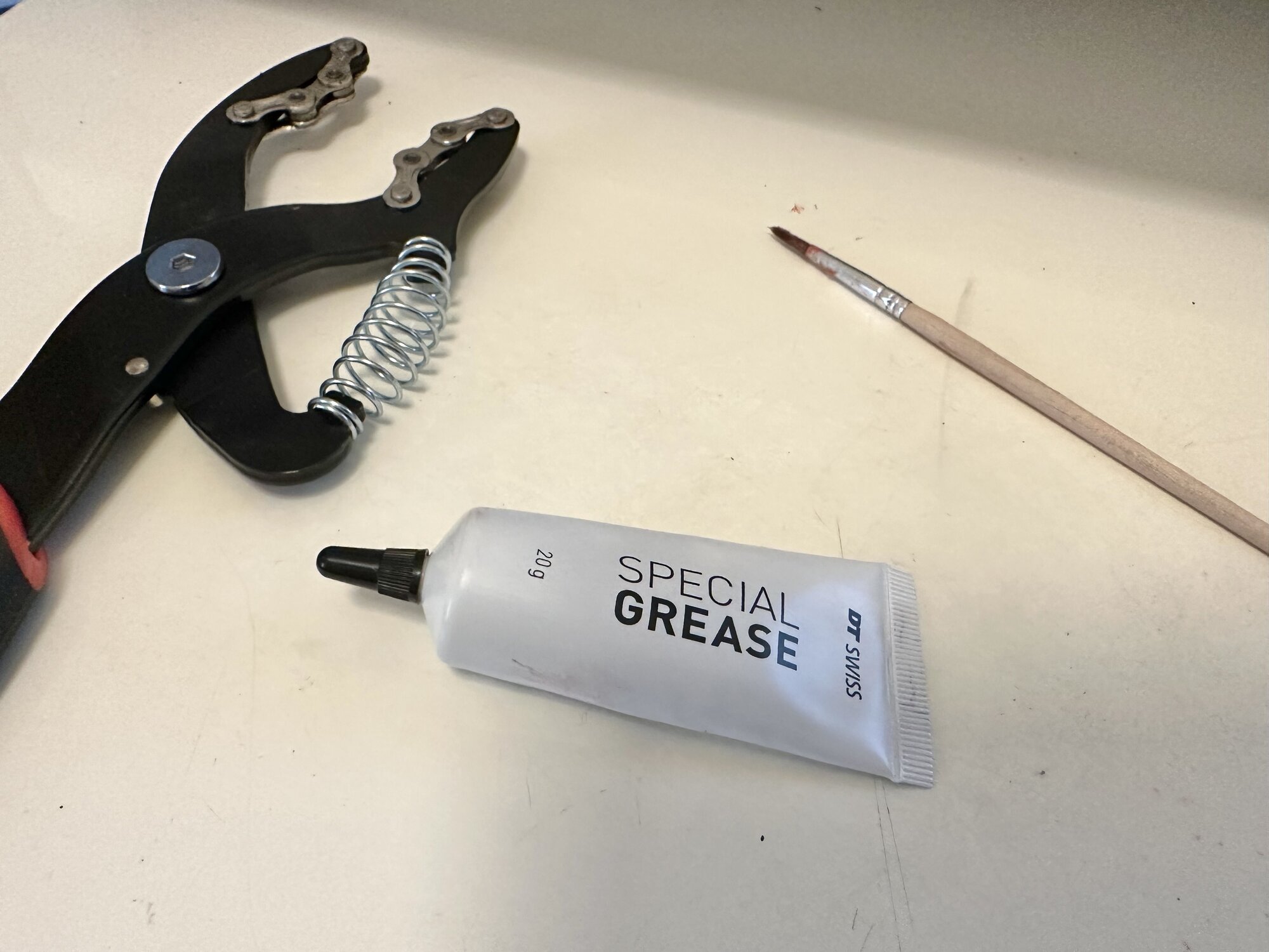

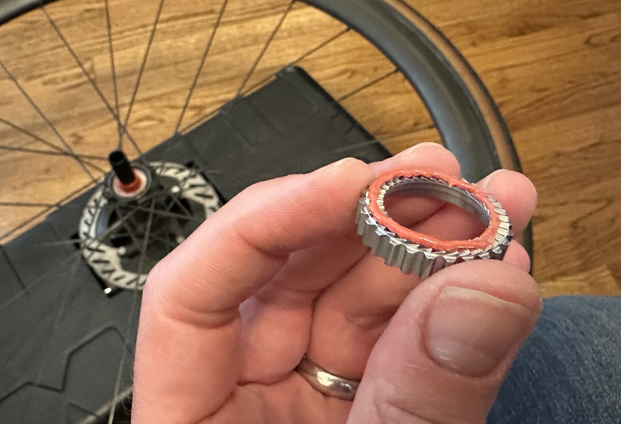

glad to hear! i hate how loud my DT swiss ratchet exp hubs are, and found that cleaning them well (remove all bits and pieces, degrease, scrub, replace) plus the DT Swiss grease (likely very similar to the dumonde) made it incredibly quiet.... for a while.
unfortunately after 1,000 miles or so the noise comes back gradually. now i'm trying to decide how often it's worth doing this.

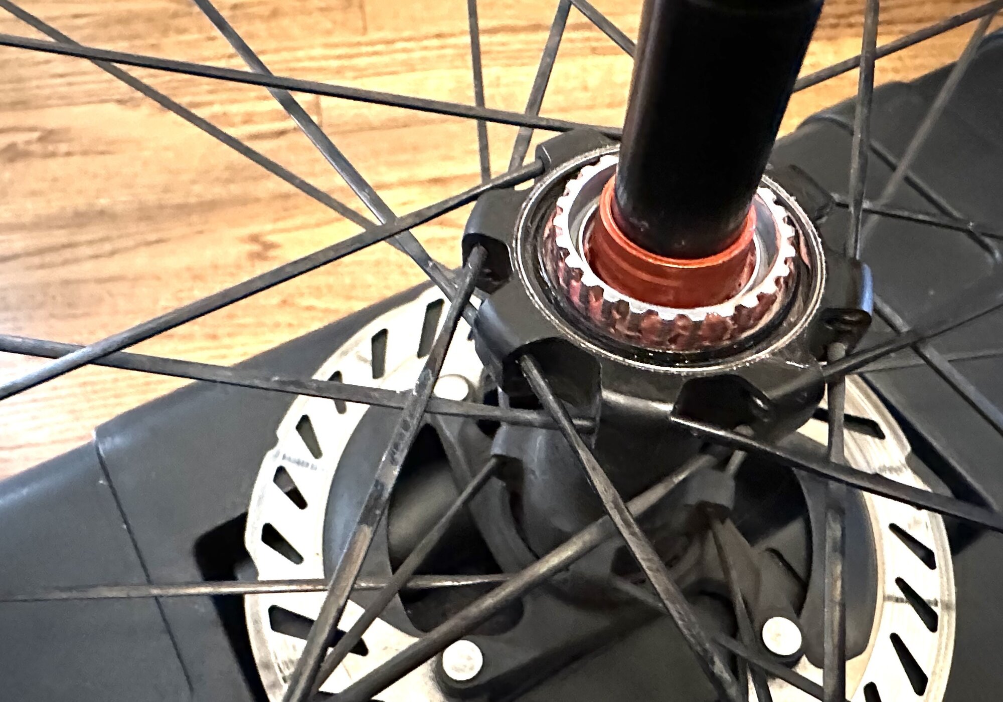

Oh boy oh boy! Oh boy! I can't wait to do this. Can you explain your photos a little bit so I can better understand what I need to do?
While I'm glad Roch has found a temporary solution, I'm afraid the silencing the hub won't last long. My latest model of DT Swiss 350 rear hub was totally silent when it was new (because the freehub was packed with grease) but it only lasted for a very short time.
my DT swiss hub may be slightly different than yours. i used this video as a guide
some have a couple clicking pawls rather than the fine toothed ratchet. principle is the same either way, but the stock one on my creo comp was actually pretty hard to remove. the one pictured above just falls right apart once the cassette is removed! well worth it IMO.

@mfgrep The video is for Swiss DT hubs which is not what you have. Your Specialized hub is like mine and has three spring-loaded pawls on the freehub that engage with an internal gear on the main body of the hub. As I mentioned in my post, with the rear wheel off the bike, you should be able to just pull on the large cassette sprocket and the freehub will pop right off and you will see what needs to be done. You can use some degreaser to get the old grease off of everything, but be careful not to get it into the bearings! After greasing the inner gear and the pawls liberally, slide the cassette-hub assembly back on, turning it counterclockwise as you do to get the pawls to pop into place. There is also an outer axle sleeve that comes off with the hub and you have to put that back in place. It's all actually less complex than my explanation!
This thread has a couple of photos that will show you exactly what I'm talking about.

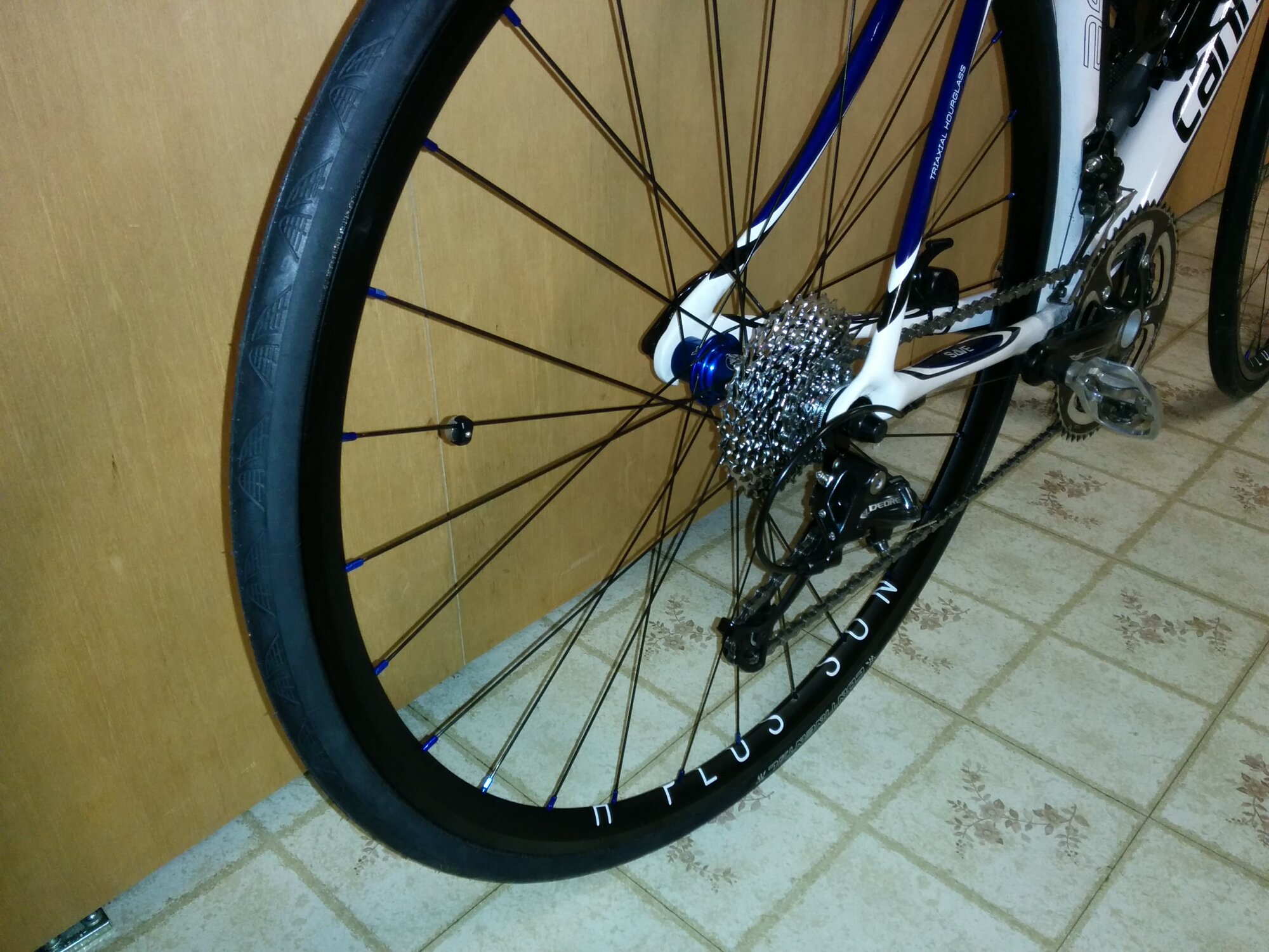

Nice! I previously had some wheels built for my old road bike by ProWheelBuilder and have been recently playing with their configurator. My tentative configuration uses Swiss DT 350 hubs with Sapim bladed spokes. The rims would be alloy similar to the OEM wheels; I hadn't been looking at carbon rims.
For reference, these are pics of my old custom wheels. The blue anodized White Industries hubs and spoke nipples set them off nicely against the color scheme of the bike.
