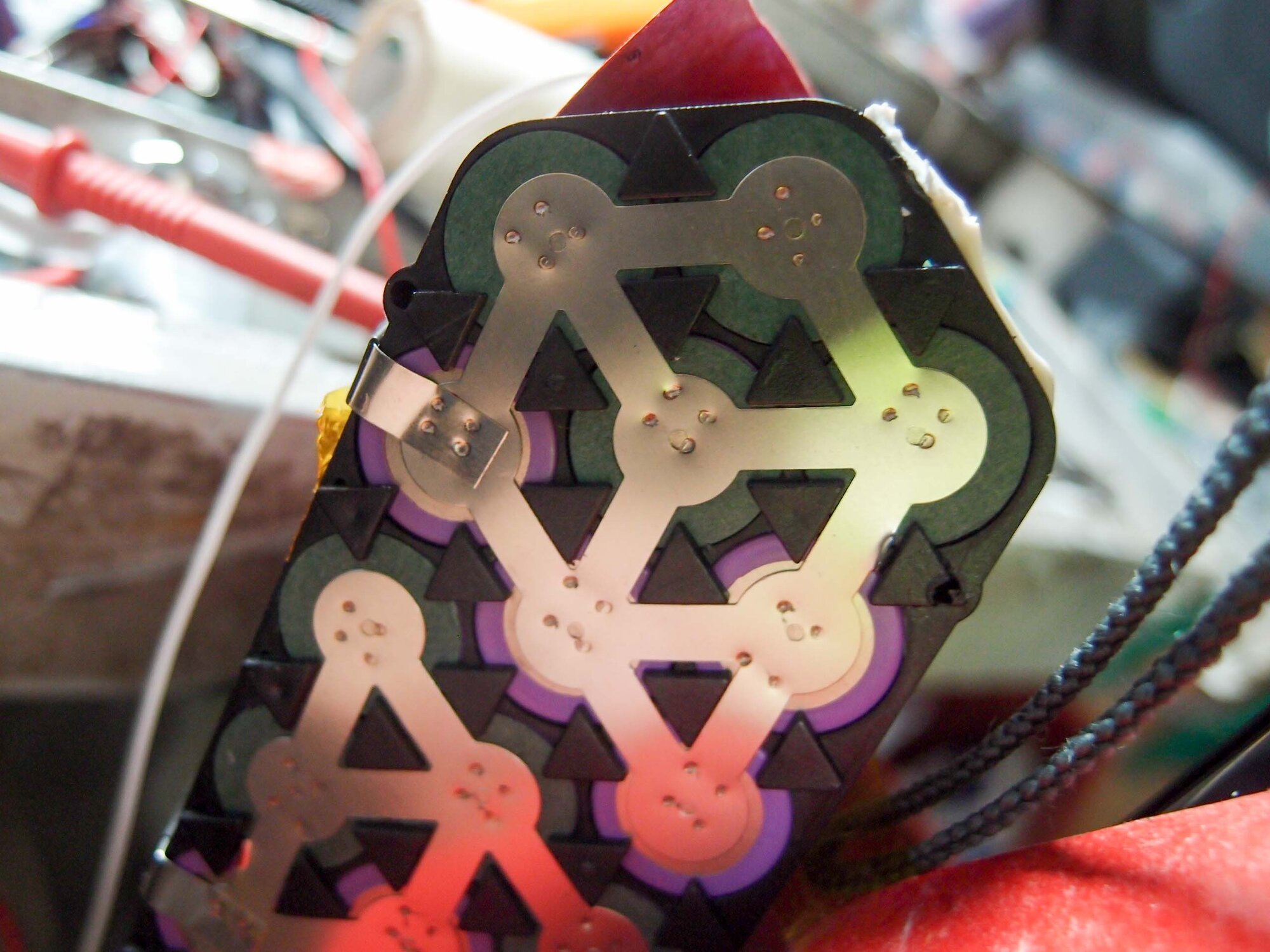

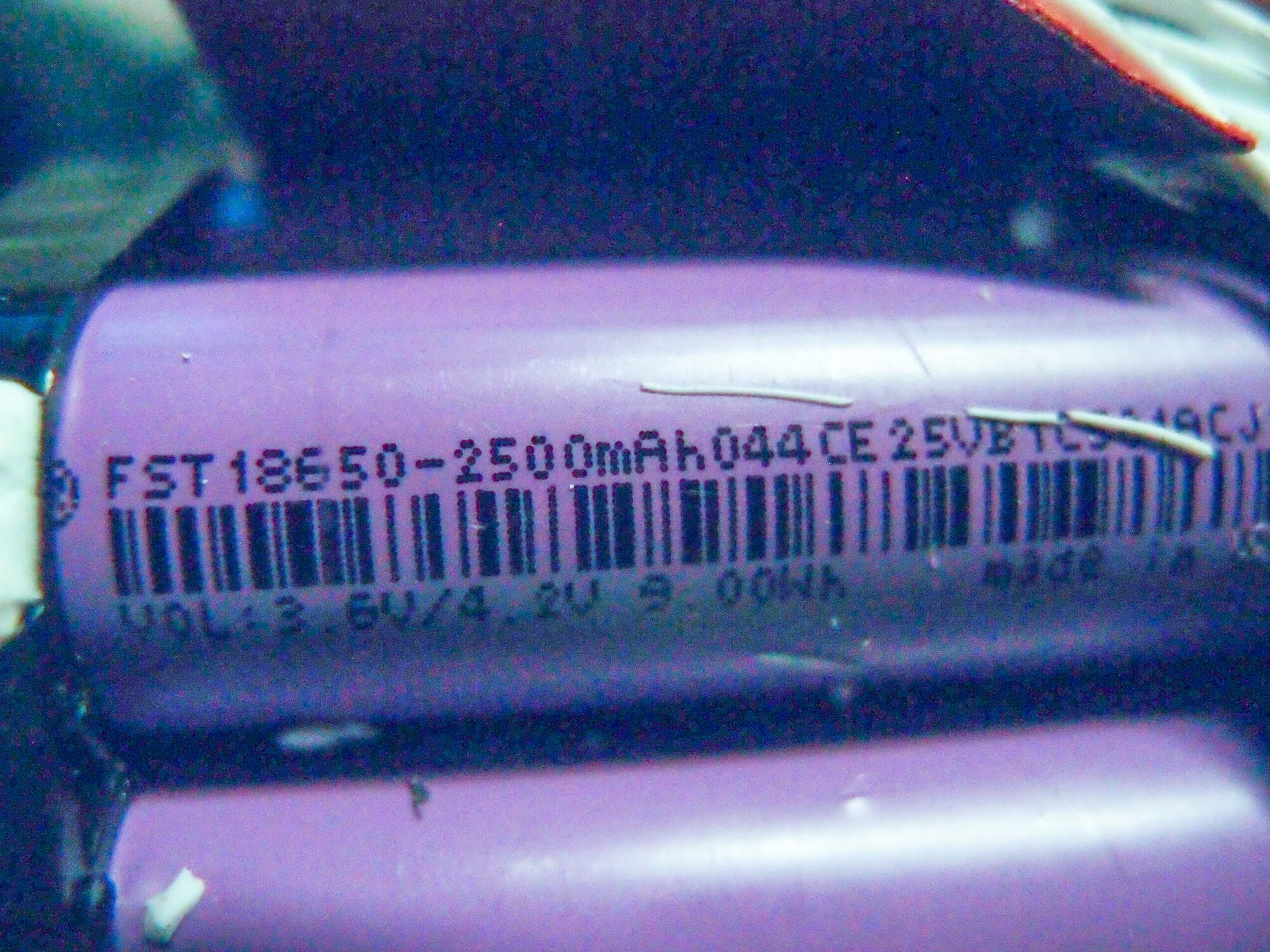

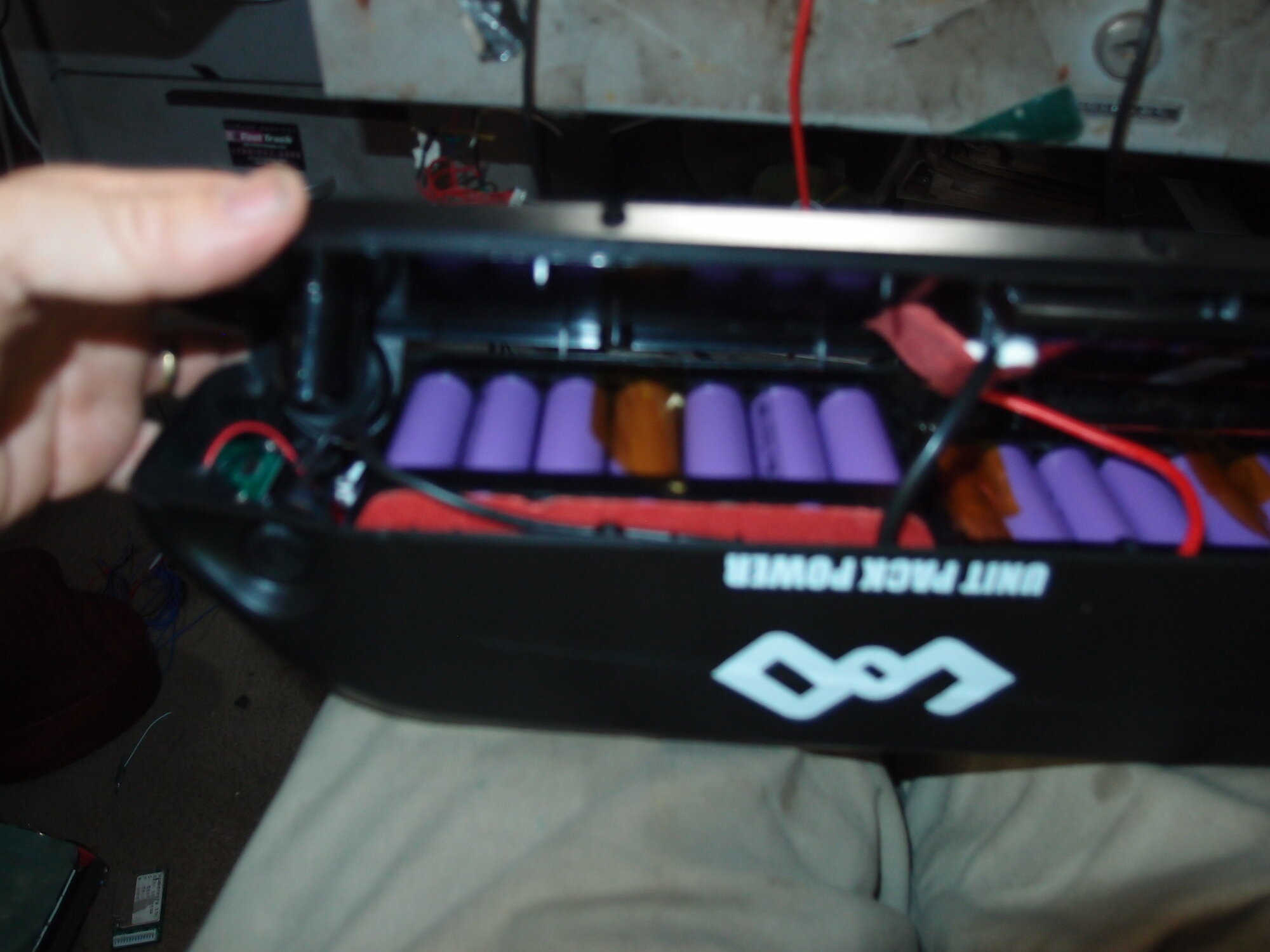

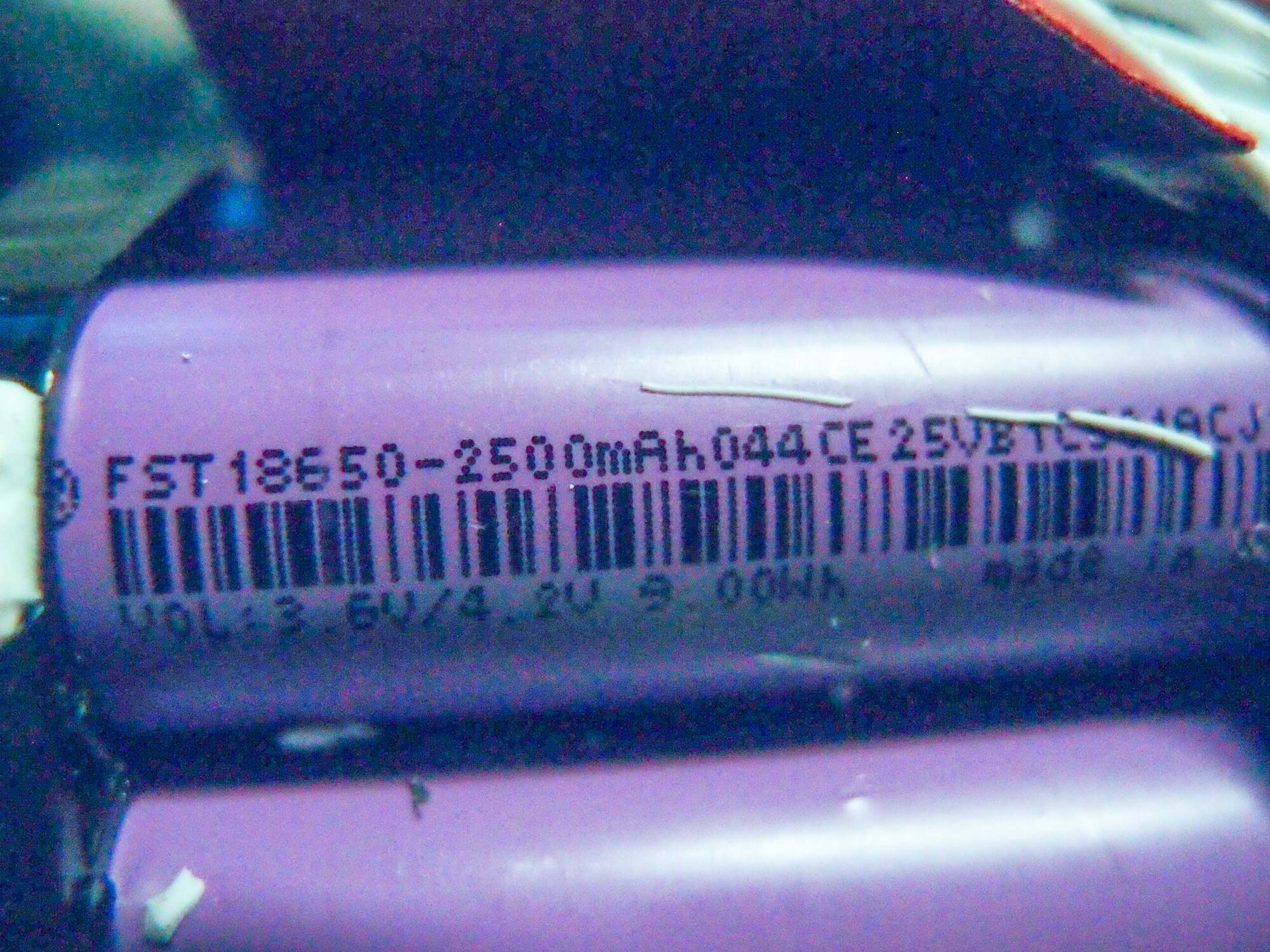

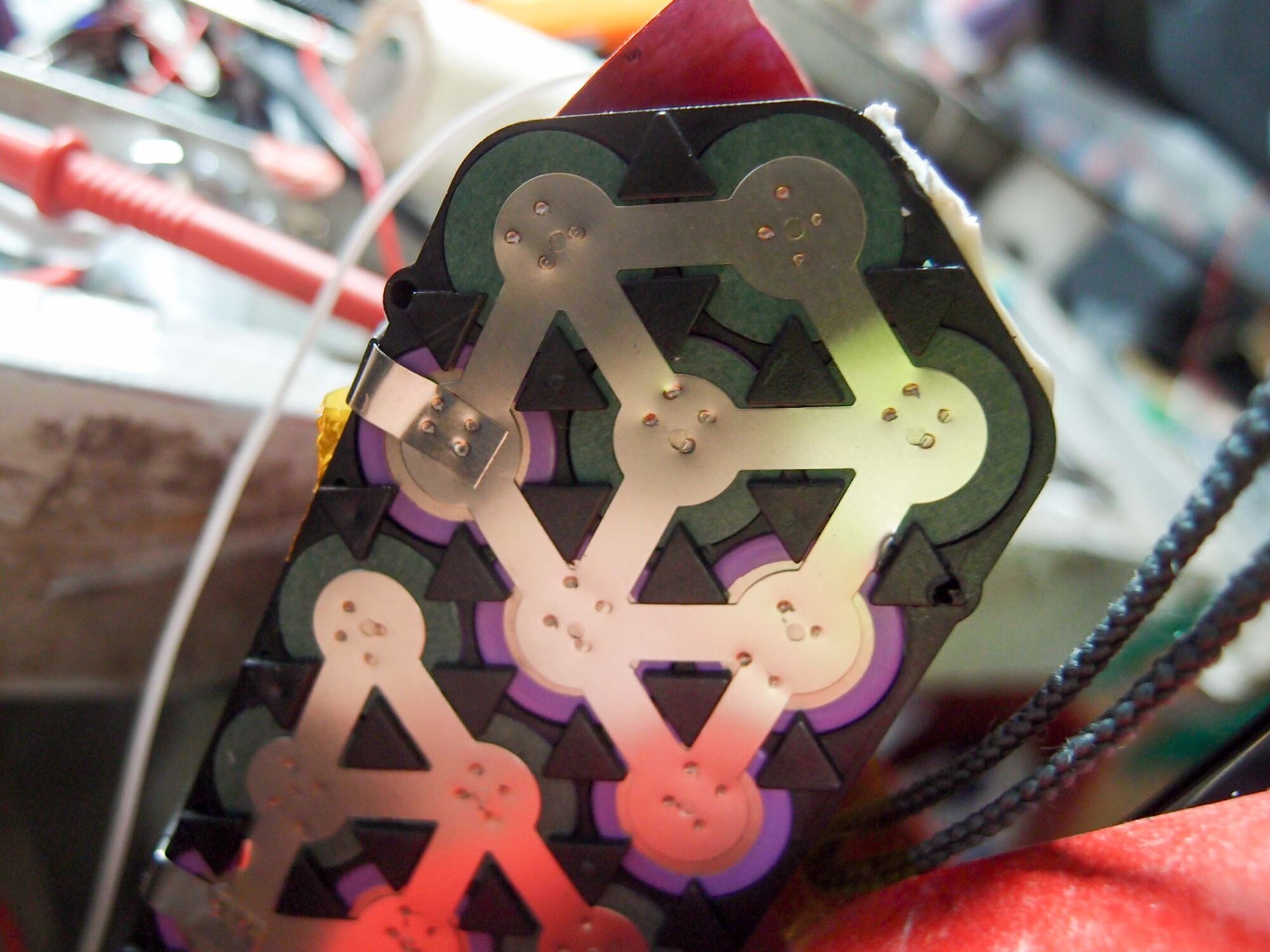

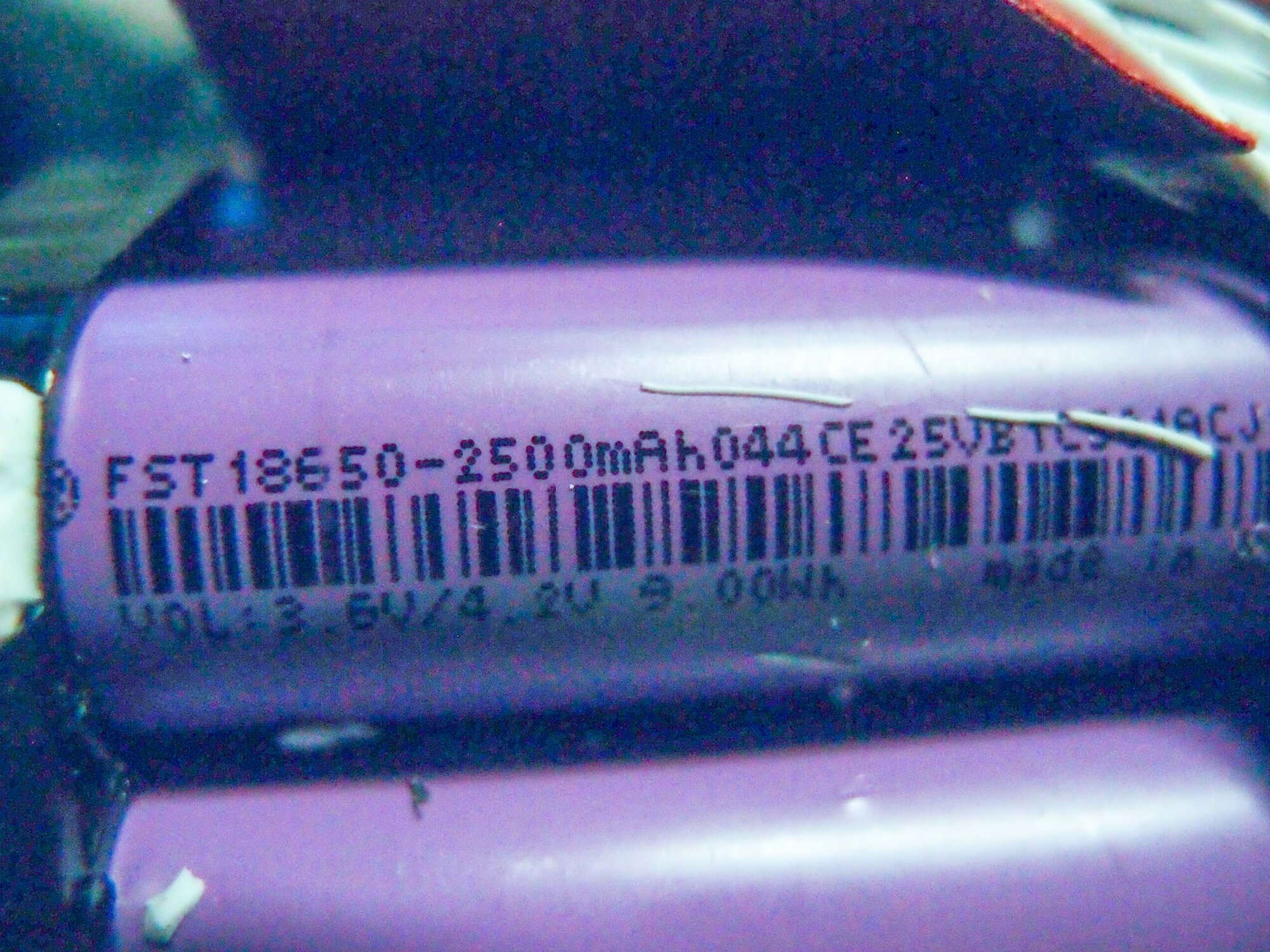

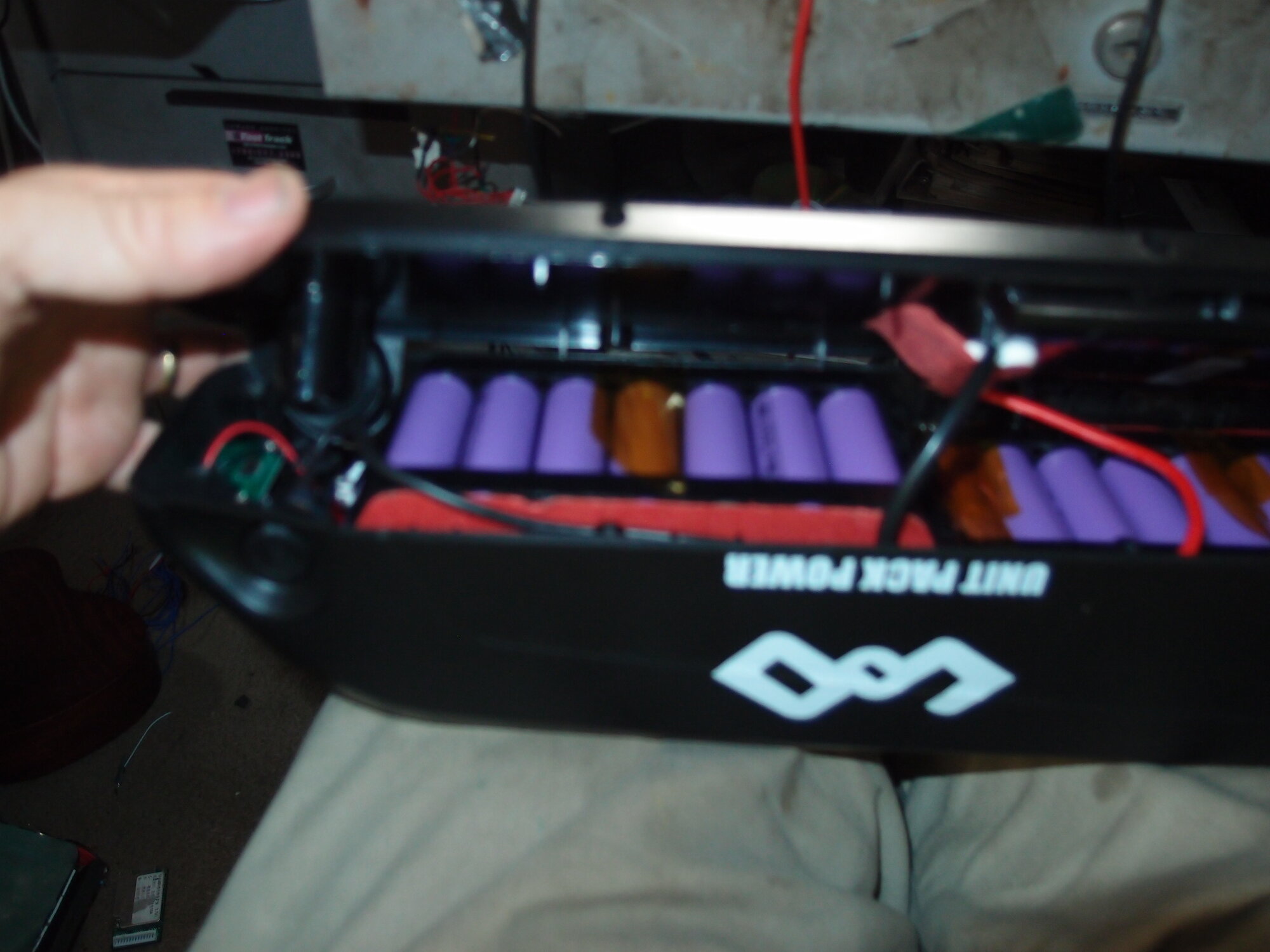

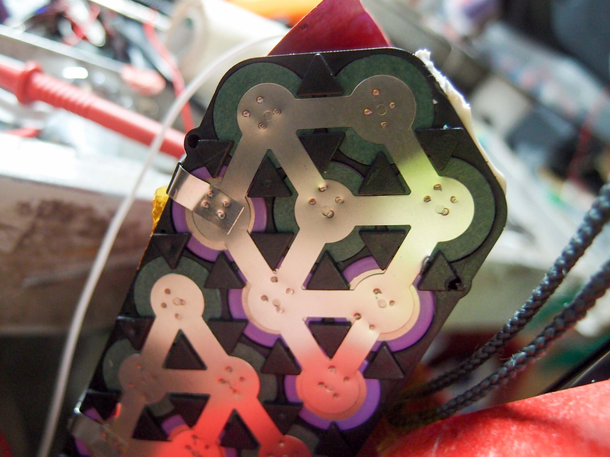

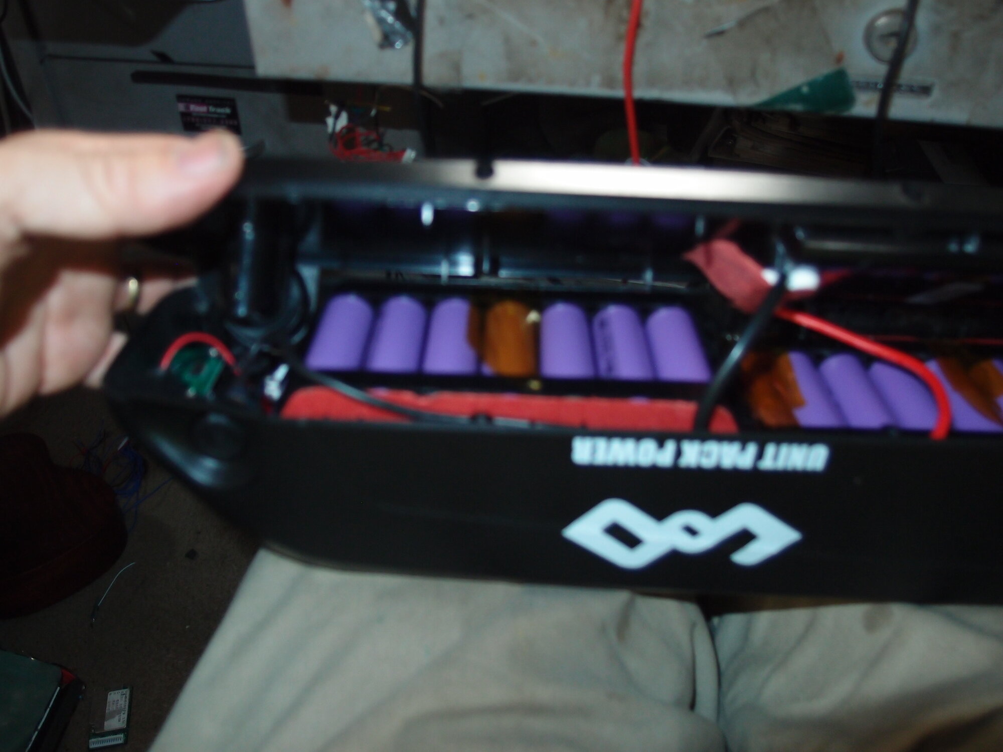

I bought a UPP Hailong pack (48V $240) last Fall, but had it in the box for five months. Charged it for the first time this month. Took my first ride and every time I hit a bump, it shut off. Having just bought the same bare case. I knew how to open it. Found the balance connector in at an angle. Reseated it. All is well.
As far as construction, they used the plastic forms you get with a Hailong kit. They put washers under the positive terminals for added insulation. The spot welds were done by hand though. There was extra insulation over areas where the cells might rub against wires, etc. It's better than my older UPP batteries.
I am disgruntled because it's a 10Ah pack (also on the outside battery label. I don't recall ordering a 10ah pack last year, but my amazon records don't show those details, I'm sure I ordered a 14Ah and the seller slipped in 10AH.
View attachment 117979View attachment 117980View attachment 117981
I would return it despite opening it if it wasn’t what you ordered. UPP batteries built in Germany are what you want.
