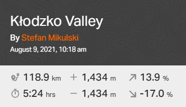

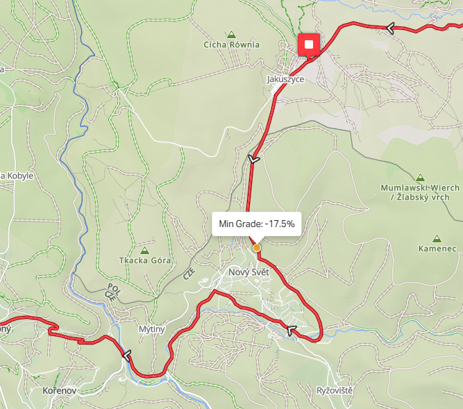

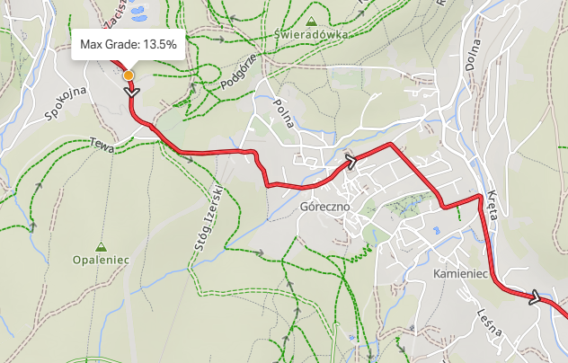

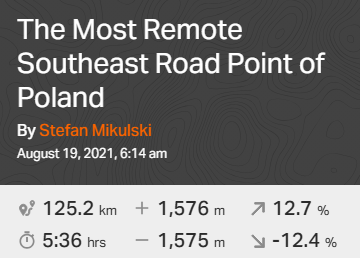

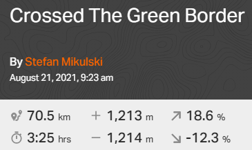

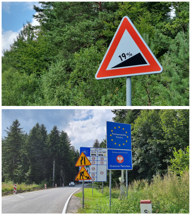

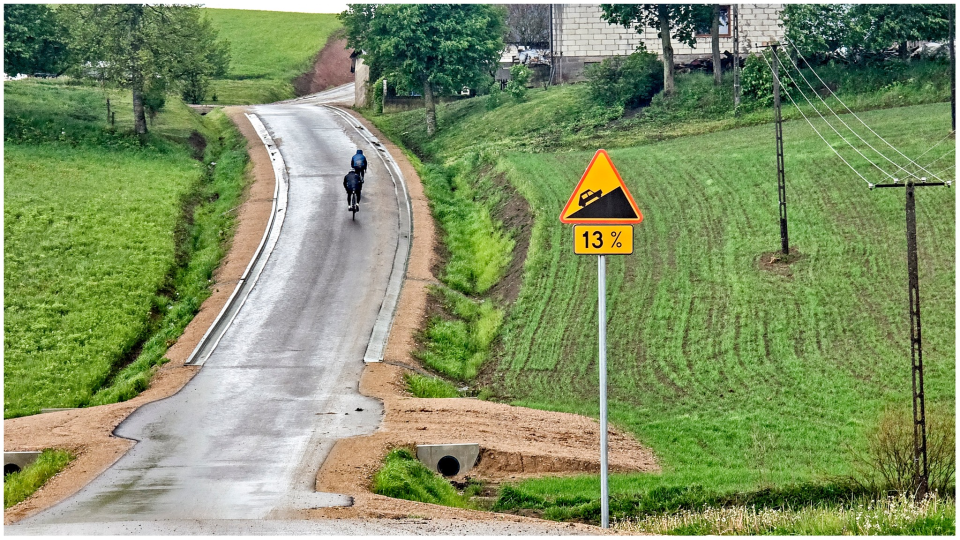

For example, some climbs and descents in Poland (and neighouring countries):
Specialized Tarmac Climb, Świeradów-Zdrój, Poland. (Jizera Mountains)
Try riding it uphill. The Harrachov - Jakuszyce segment across the Czech/Polish border. We were lucky to descend there. (Jizera Mountains)
Bieszczady Mts.
Climbing from Slovakia onto the Polish border. (Beskidy Mts)
Assorted climbs in Sudety Mountains.

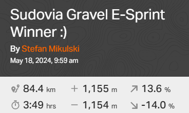

Sudovia (Poland), the area in the notorious Suwałki Gap (Poland/Lithuania/Russia/Belarus), consisting of steep post-glacial hills only. (So called Sudovia Mts).
I rode a 520 W/85 Nm Vado with mountain gearing on all those and many more rides. The photo shows me climbing up a 14% grade hill in Sudovia. I rode only 10 km/h but see how much I gained when overtaking all the traditional riders as seen in the picture! Well, x20? A joke? :D

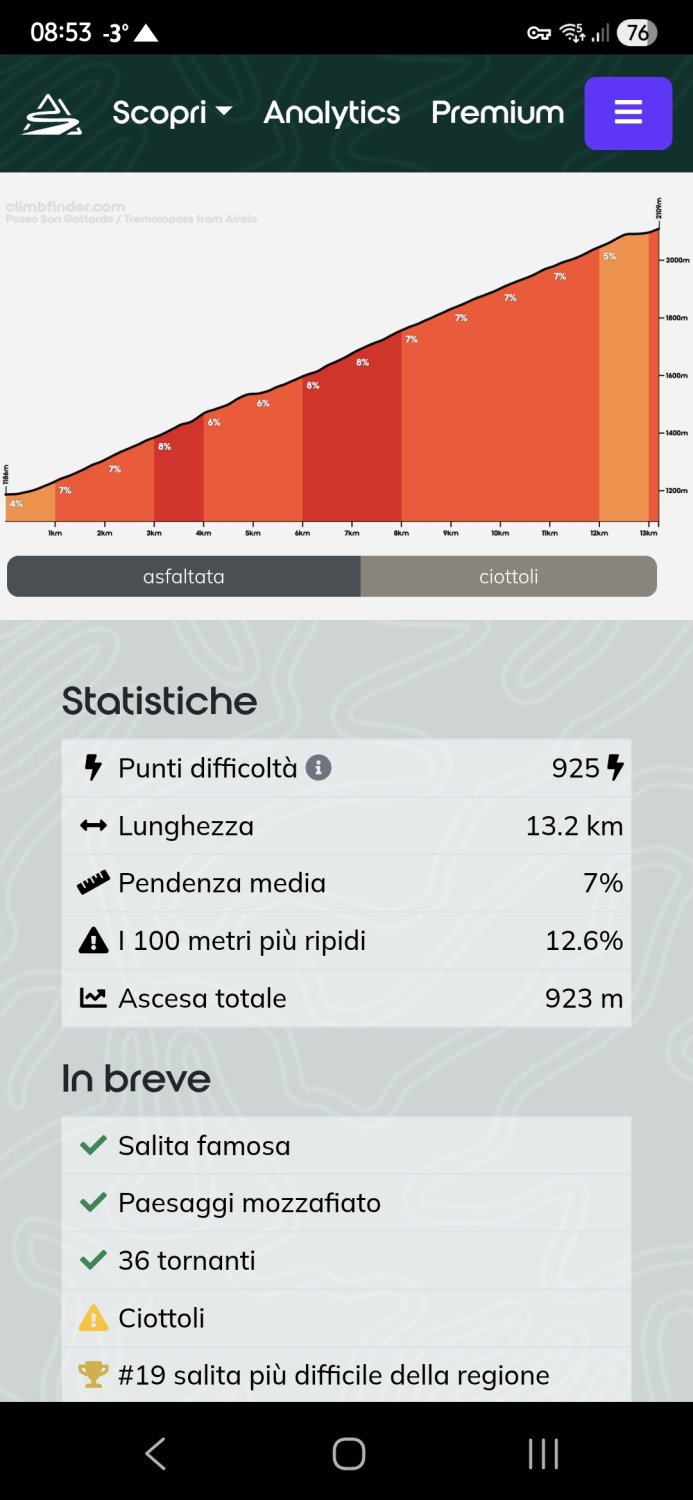

Personally I define <sustained climb> something which keep me busy/ engaged both in distance as well as in elevation gain: for example this summer I rode :
the Bernina Pass in Switzerland which is 32km long, 2.000 mt elevation gain for an average gradient of 6,5% and max 13%.
Colle dell'Agnello [ Italy-French border] which is 26km long, 1959 mt elevation gain for an average gradient of 7,5% and max 13%
Col du Nivolet [ Italy] which is 42km long, 2250 mt elevation gain for an average gradient of 7% and max 15%
