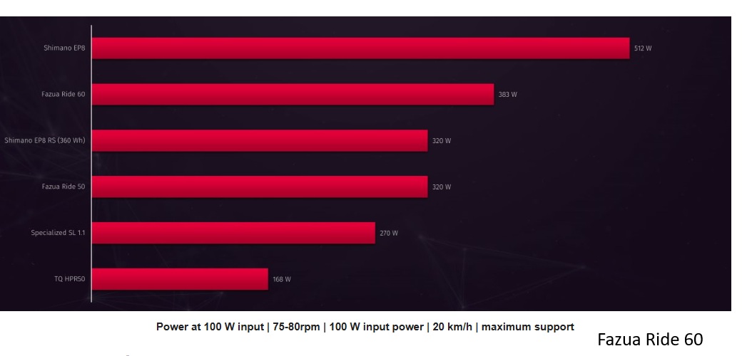

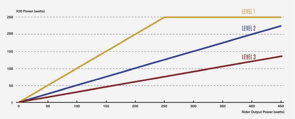

I've started contemplating a switch from a TQ HPRR50 to the Fazua Ride 60. It's my particular age (upper70s) and health (angina) that are not allowing me to draw the TQs full potential. I can't contribute more than 100W for more than a few seconds, or the angina will shut me down entirely. That becomes an issue with the TQ due to its 200% maximum support, which means I only draw a sustainable 200W from the motor, missing out on the 300W stronger riders can take advantage of. (I've pleaded with TQ to allow a 300% maximum assist, without increasing its 300W output, to no avail).
An associated issue is that I generally pedal at relatively low cadences of 50-70 rpm, mostly around 60, which is not best suited to the TQ.
The Fazua Ride 60 seems to overcome these constraints if I understand its operating parameters correctly. I'd appreciate feedback from users of the Ride 60 on whether a setup such as I might start out with is tenable at 60 rpm.
Breeze: 100W input, 100 or 125W maximum support
River: 100W input, 200 or 250W maximum support
Rocket: 100W input, 350W maximum support, possible short boost to 450W

The Avinox and Mahle M40 are both big beasts of motors so the systems will be heavier, Mahle is very new so not many brands yet and all EMTBs. Avinox has some gravel bike take up, but small brands as of yet. Orbea use the Shimano EP8 in their new gravel bike Denna, it's good on low cadences though a bit heavier then TQ/Fazua etc but has had strong reviews, and yes the Bosch SX seems designed to deliver only in very high cadences.
Any models with the TQ60 as you are familiar with that system already? Would that give you enough power?
Now that we know that he rides a road bike, I was going to suggest the Denna, even though it's a gravel bike. With Di2, you can do amazing things with the EP8, which is a great mid-drive system. Also look at the Cannondale Synapse Neo Allroad, which uses the 55Nm 600w Bosch Performance Line Sprint motor, which can be user configured for up to 400% assist. Yes, Bosch Performance Line motors like cadence, but with 400% assist, I think that would meet your needs. Worth a try.
