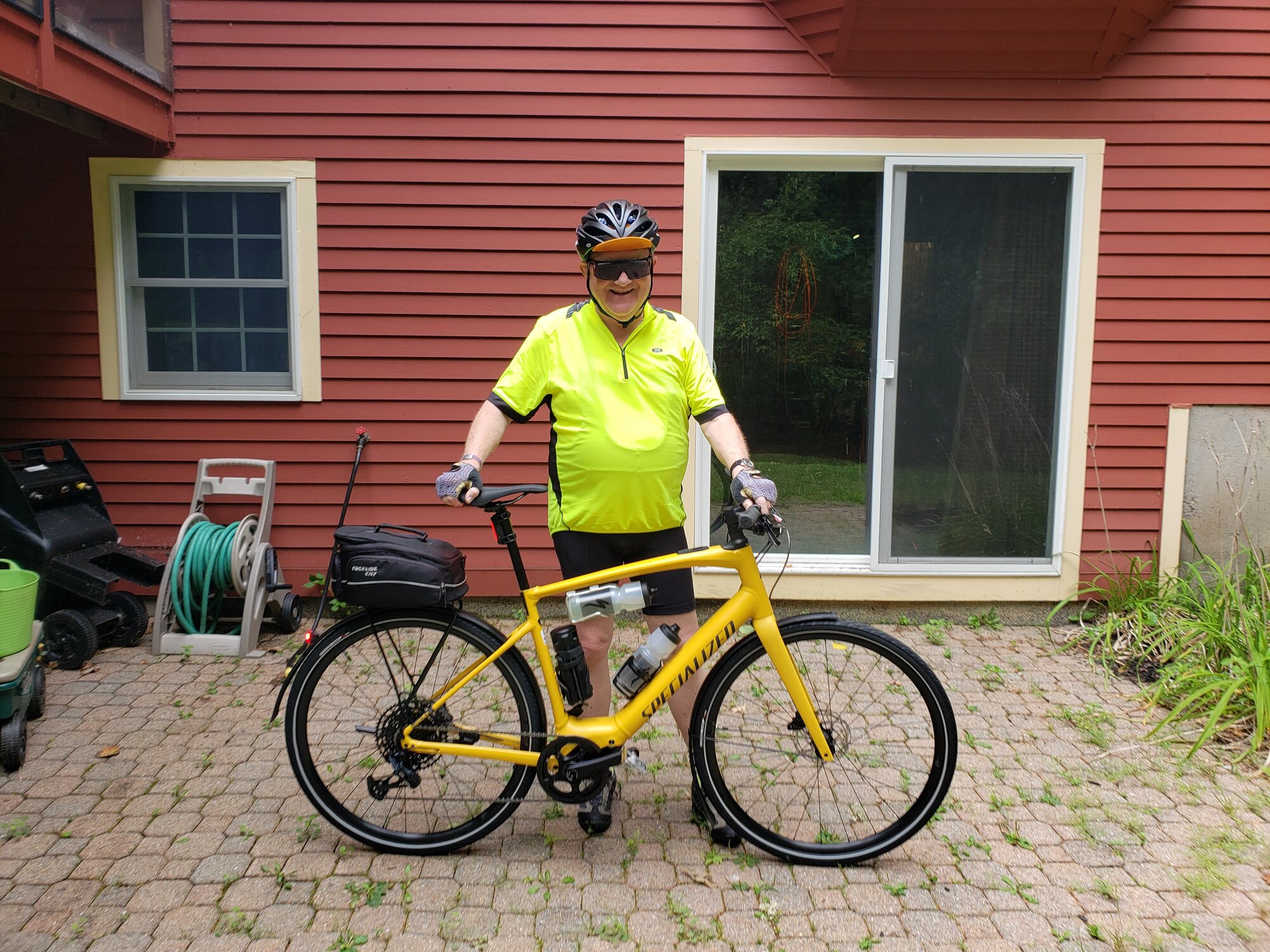

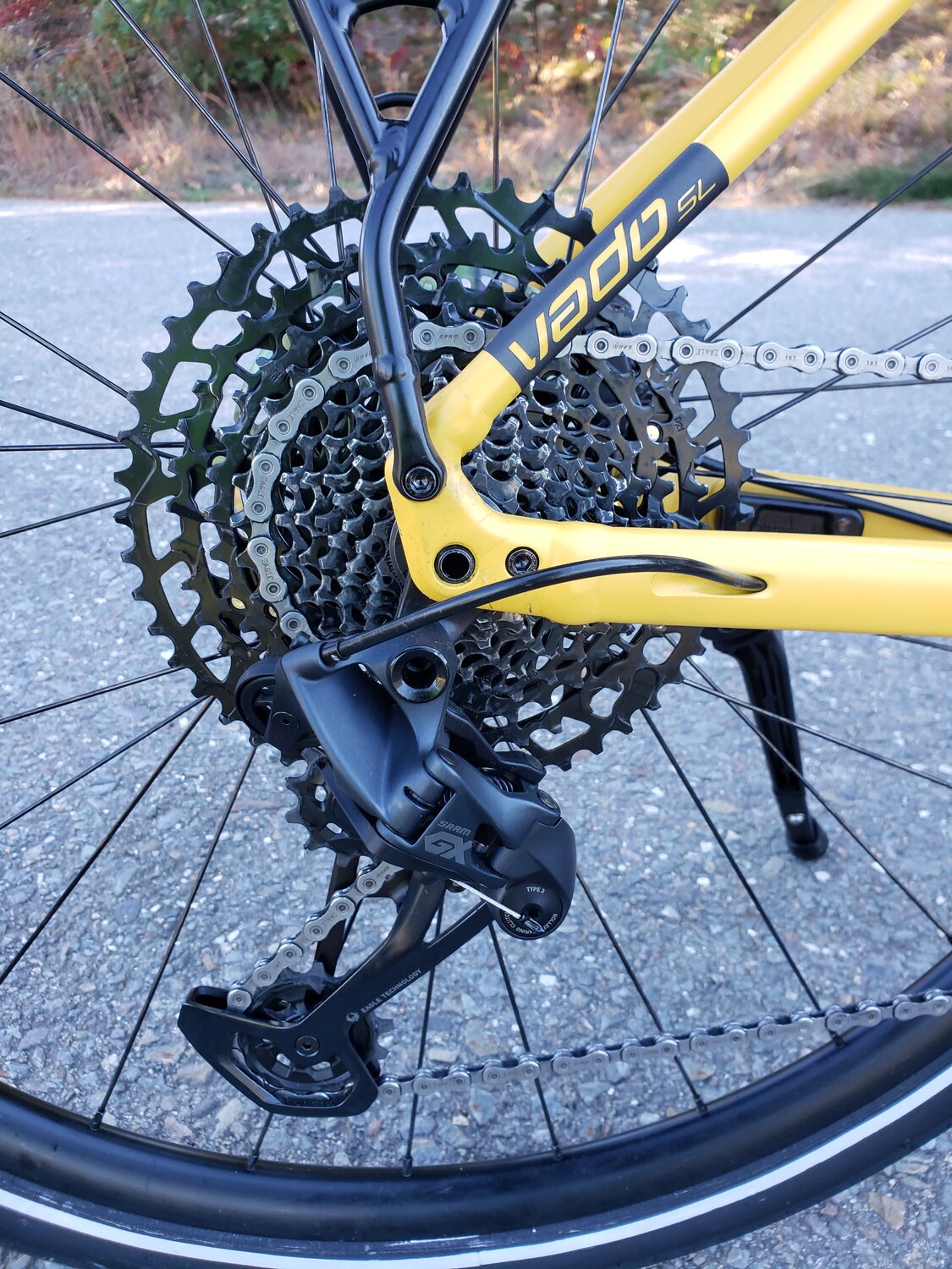

For me, the model year 2022 SL 5.0 EQ with SRAM GX is much preferable. In addition to the Mastermind TCU (which is VERY useful), it provides a much wider range 12 speed drivetrain with its 11-50T NX cassette. I upgraded mine to the newer XD drive freehub and the 10-52T GX cassette. I also upgraded to a 46T Wolftooth chain ring. This provides a max 28 mph 11th gear ratio (46:12) at a cadence of 92 rpm. I then have an even higher 12th gear (46:10) for descents. I also have a lower 1st gear ratio (46:52) for grinding out climbs.
I also bought the bright yellow bike and named it the "Flying Banana". I have put about 1700 miles on the bike since purchasing it in August 2022.
