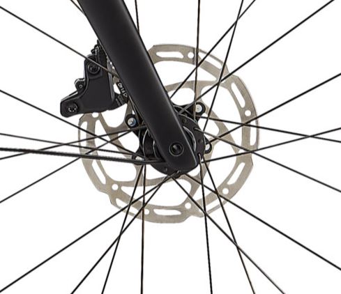

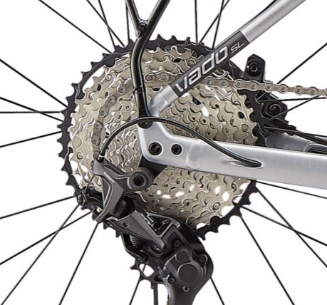

Tried a 7mm and it's still too small - unless the nut is right inside and I am not reaching it?
Wrong side. You unscrew the axles from the left hand side of the e-bike (non-drive side). Look at the bike from the side of brake rotors.
P.S. There is no nut in the thru-axle.
