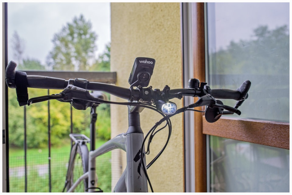

You can absolutely install a Redshift ShockStop stem and relocate the light onto a GoPro mount.
See this accessory from Redshift:
You can enhance your stem with the Utility Mount and then install a GoPro mount for the Lezyne light there.
I could do a similar thing without the Utility Mount yet:
I did this on a Vado SL 5.0

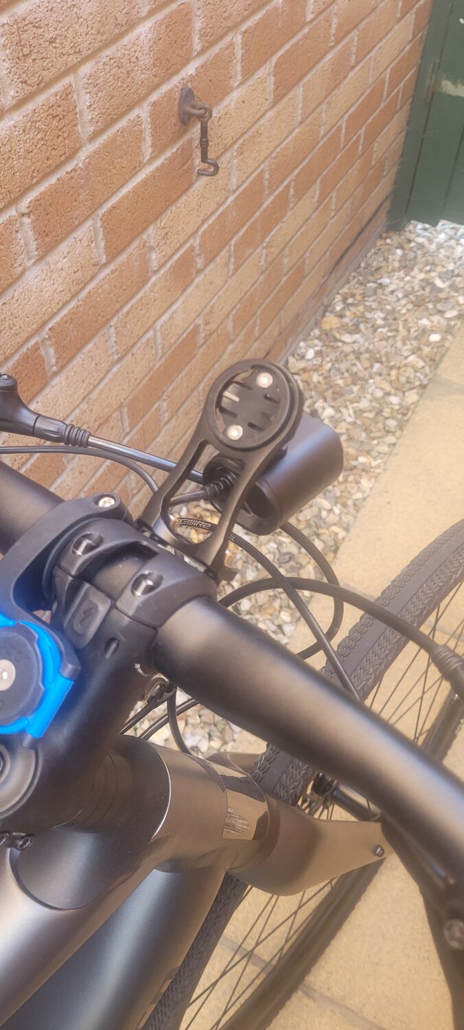

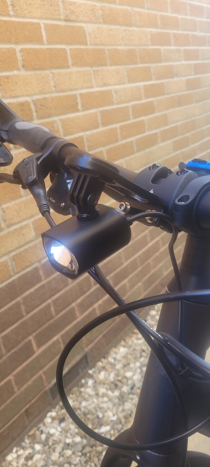

My solution to the light/cables problem, around £6 here in UK from eBay.
