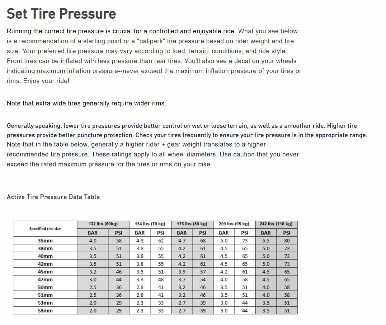

This is from Specialized and may help, inflate to your weight.
screenshot-2023-05-20-103234-jpg.154061
What is the weight specified here? I on my Vado with two panniers am close to 136 kg (300 lbs) total weight.
