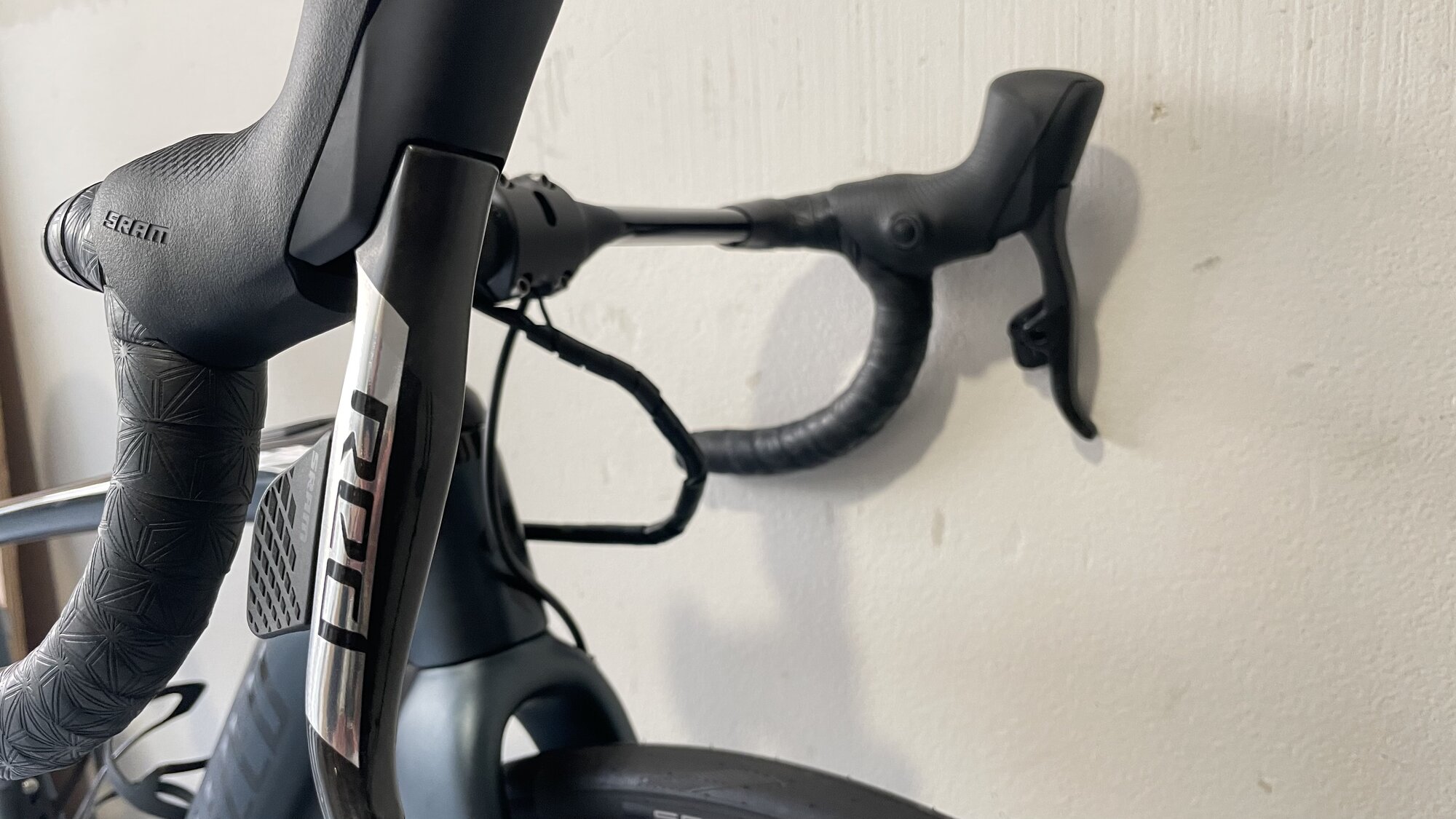

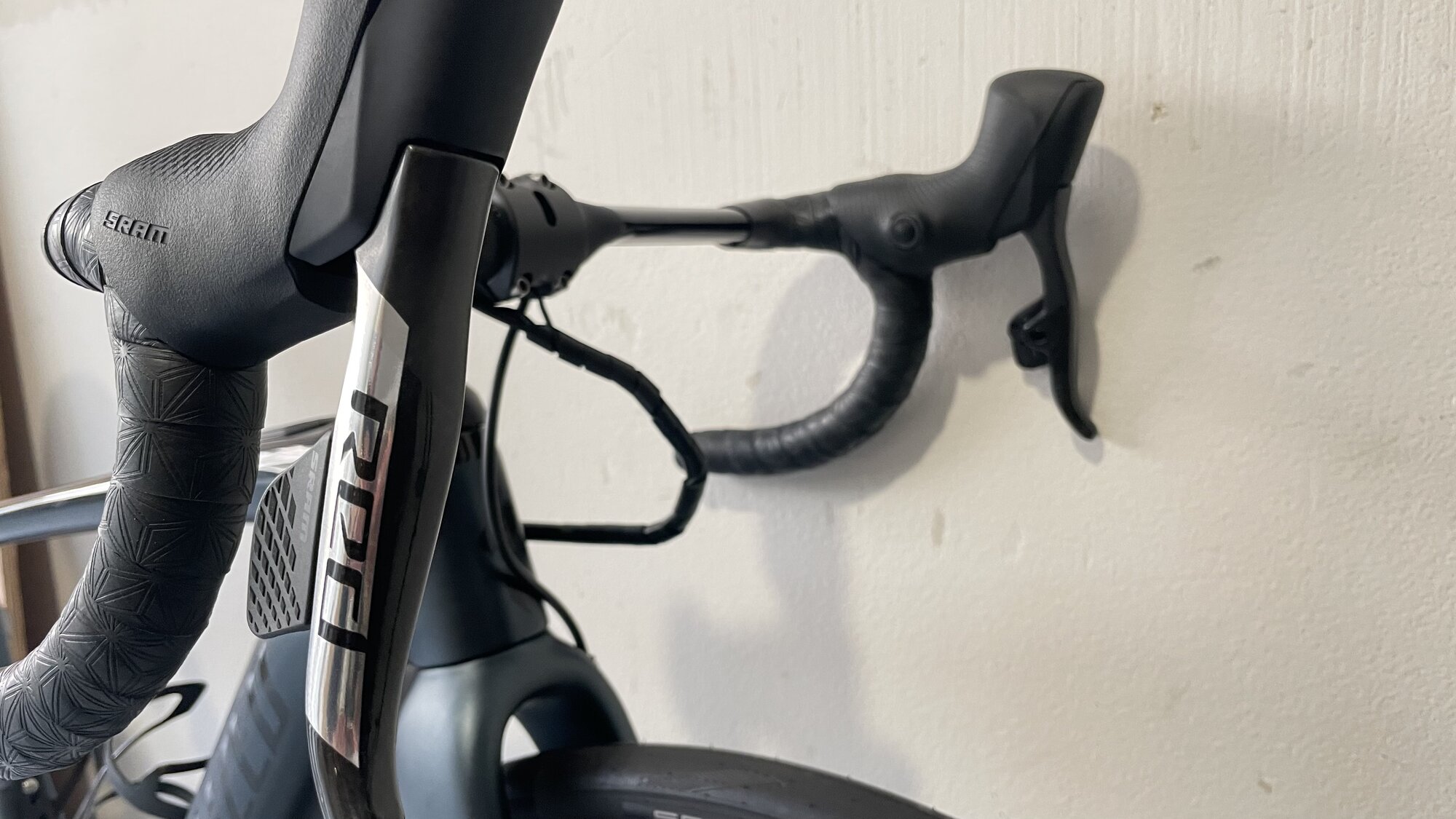

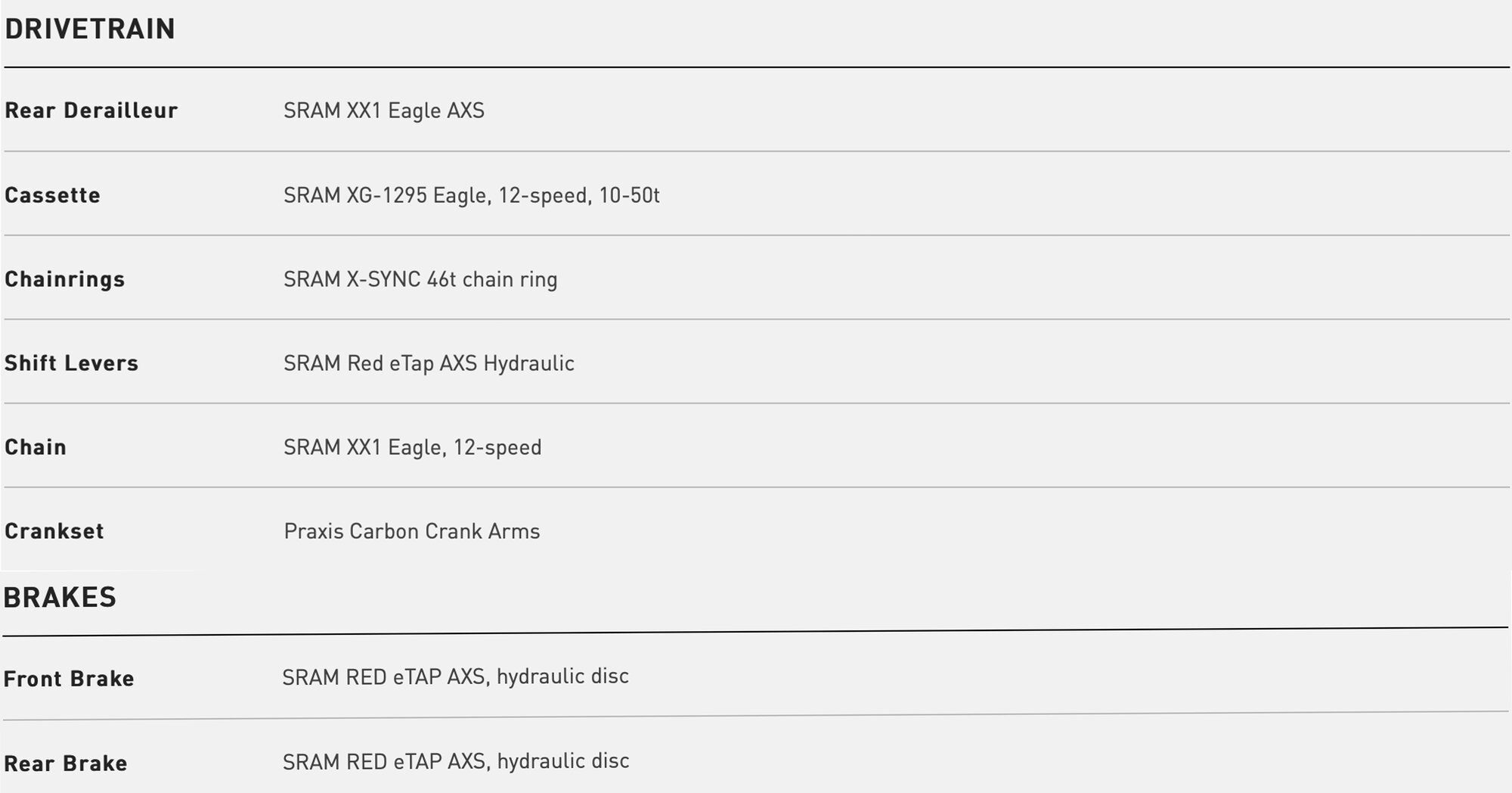

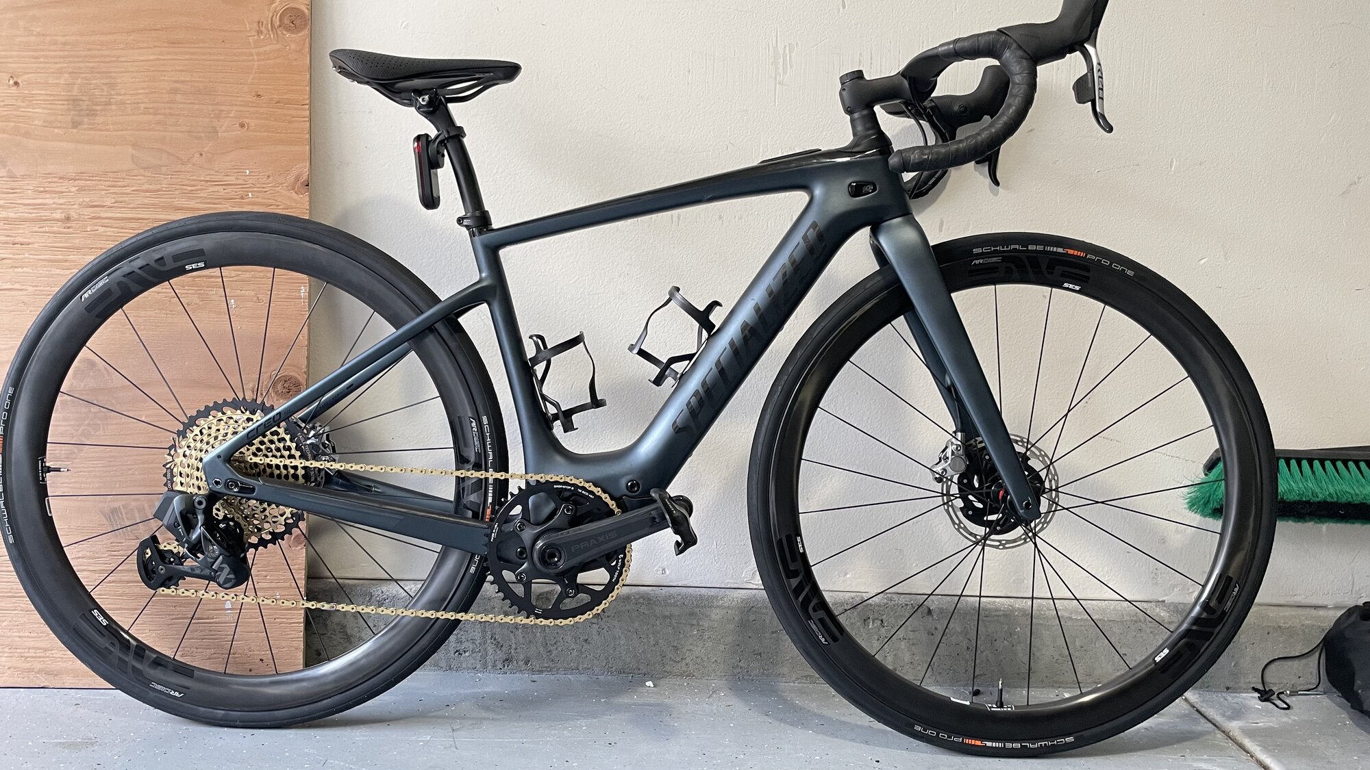

I just finished the wireless 12 speed upgrade on my Creo Comp Carbon Sl Evo. Went with eagle gt and an eagle xo 10-50 rear cassette , sram 44t front ring , rival etap shifters and sram red brakes. Works great !
Nice! Did you have to replace the crankset and/or bottom bracket? Or, were you able to mount the SRAM 44t chain ring on the one that came with the bike. I assume the Praxis, 44T, 110BCD chain ring that came on the bike was a no-go with your RIVAL derailleur - right? Thanks!

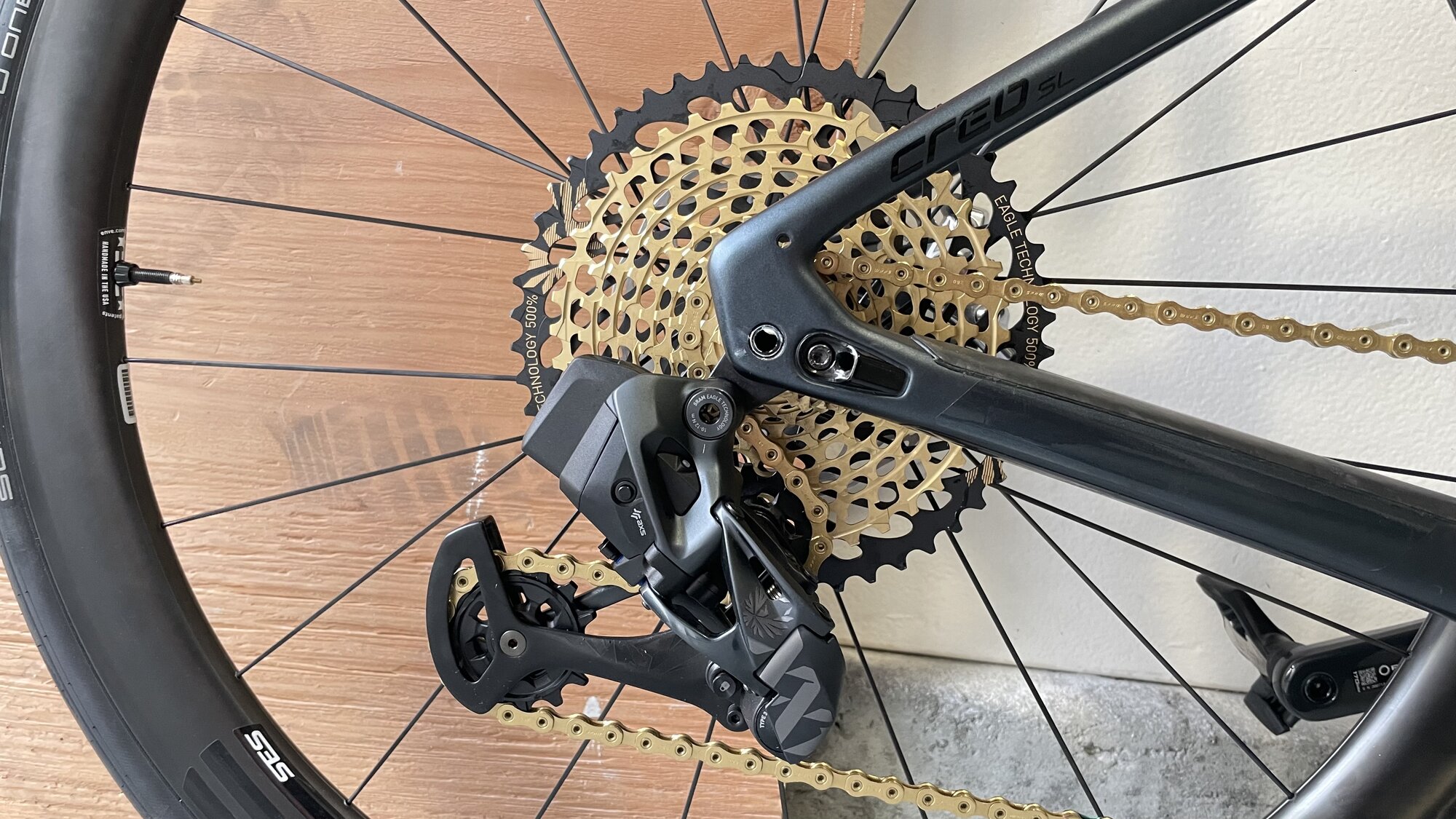

Well, I got an SRAM 44T Chain ring but the bike shop had to flip it around to align it correctly. Didnt replace the crank set. I actually got an Eagle AXS derailer and used the rival shifters. The rear cassette is a 10-50T ... I've been using this a few months and working like a champ!

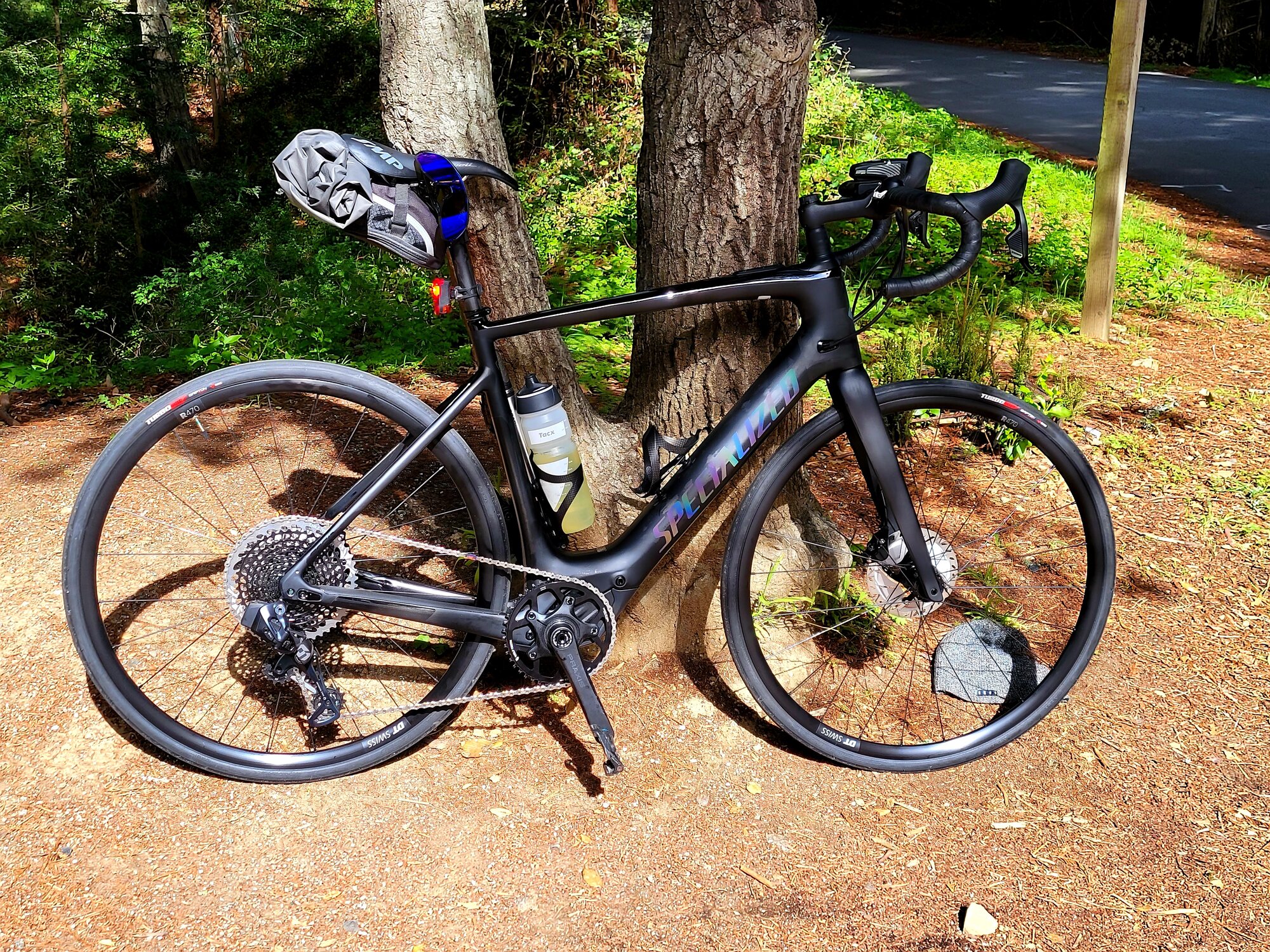

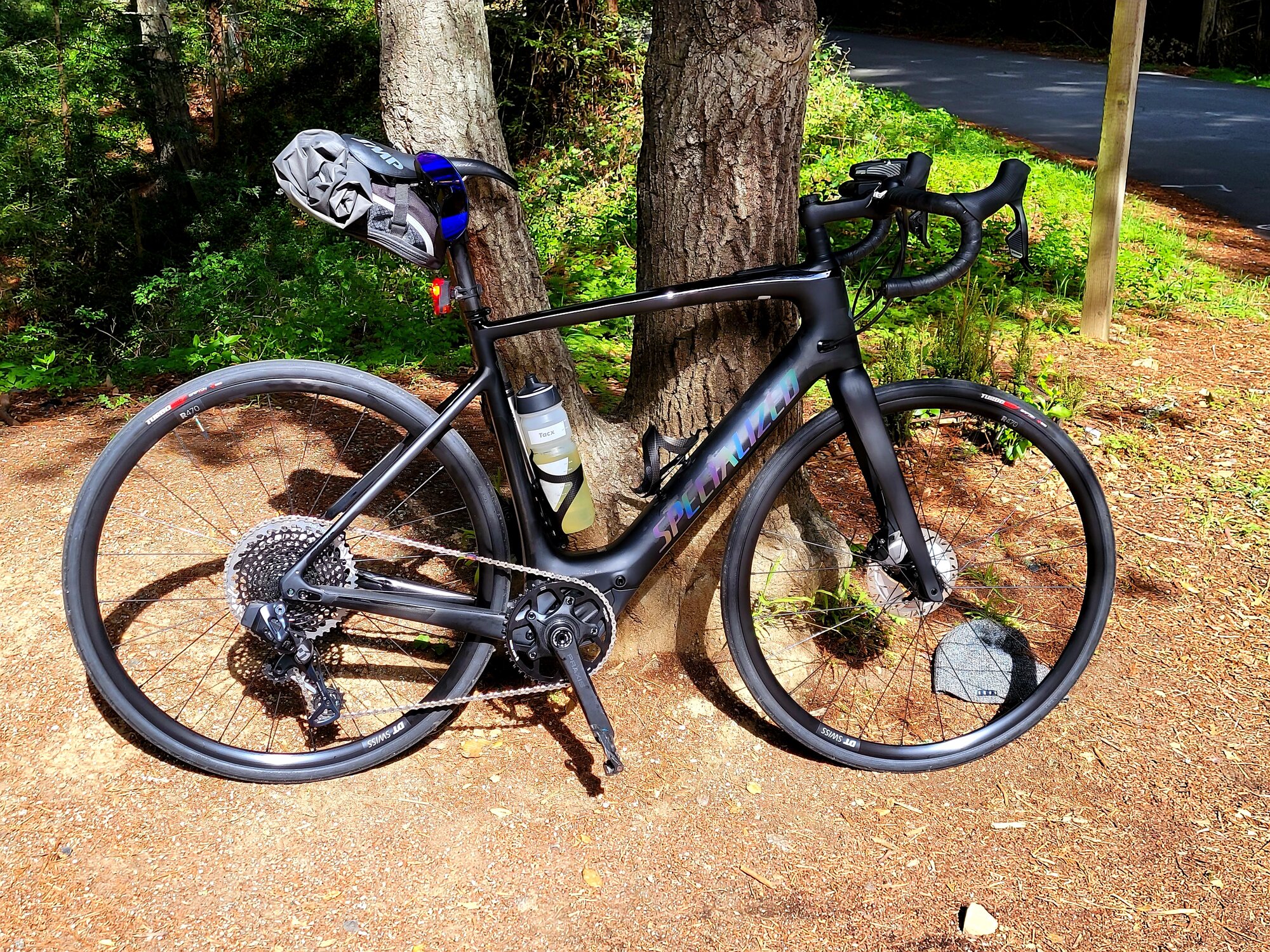

2021 Turbo Creo SL Comp Carbon
SRAM X01 drive train, Rival brakes/shifter, Turbo Remote, RideWrap.
I provided the farkles (fancy accessories, real kool, likely expensive), LBS did the set up.
First ride today - Bueno!
Thanks again for all the pointers in this thread.

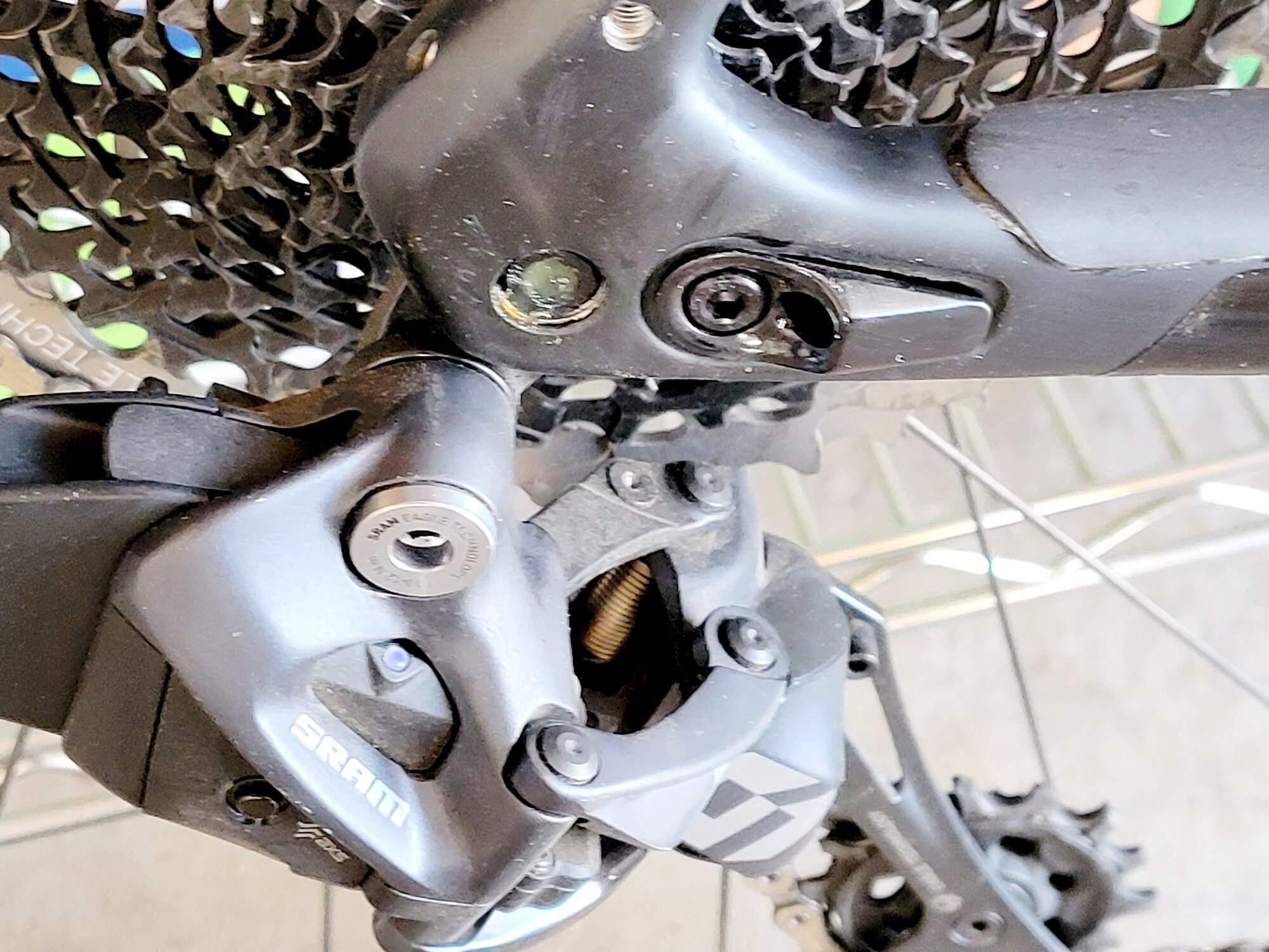

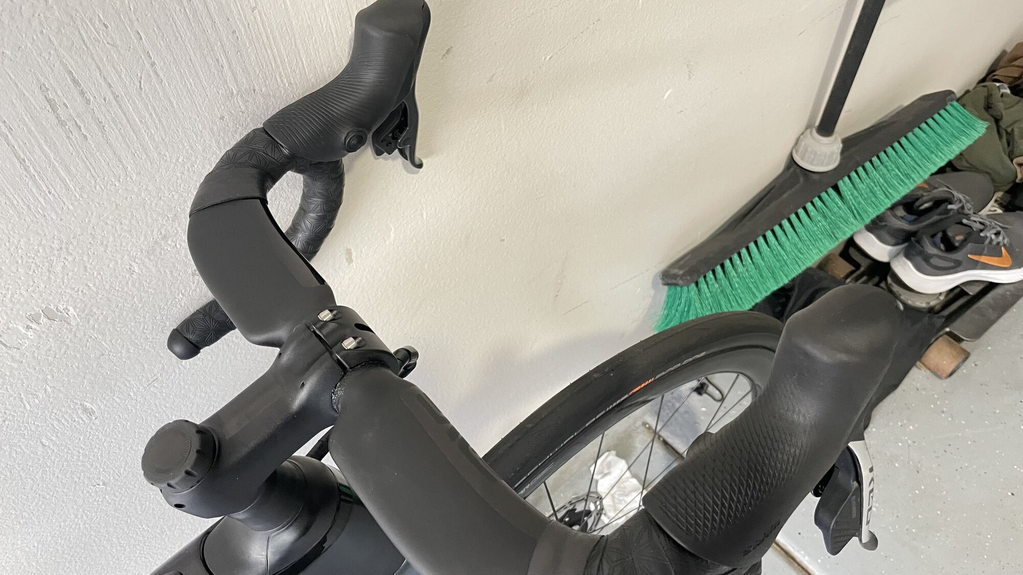

Having upgraded from wired to wireless, I'd like to seal the opening where the derailleur cable exited the frame. Small detail, I know, but there should be a Specialized part for doing it. Anyone know the part number? Thanks.

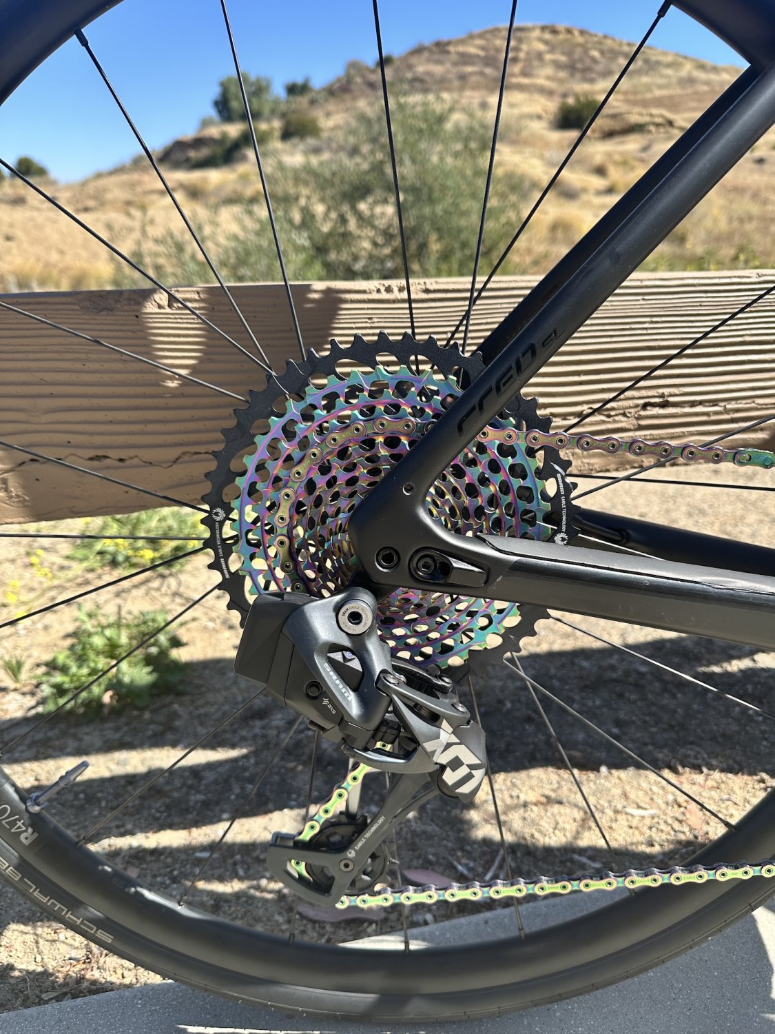

I've collected my parts and getting ready to drop at my LBS for assembly. I went with:
SRAM Force AXS 12 speed shifters and calipers
SRAM X01 rear derailluer (52T max)
SRAM XX1 10-50 cassette
SRAM XX1 chain
Praxis 46T chainring
SRAM XR centerline 160mm rotors
Thanks to all on this thread for the inspiration and guidance. Can't wait to get out on the upgraded ride!
Very nice list of components. Most of us have switched to Wolf Tooth (NA) or Gabaruk (Euro) chain rings to avoid chain drops. I don't even have a chain keeper on my Creo 1 with a similar SRAM setup. You can save a bit on chains by going to the X01 instead of XX1. It has the same hard coatings and durability especially if you are waxing. Chain maintenance is important to protect the expensive cassette

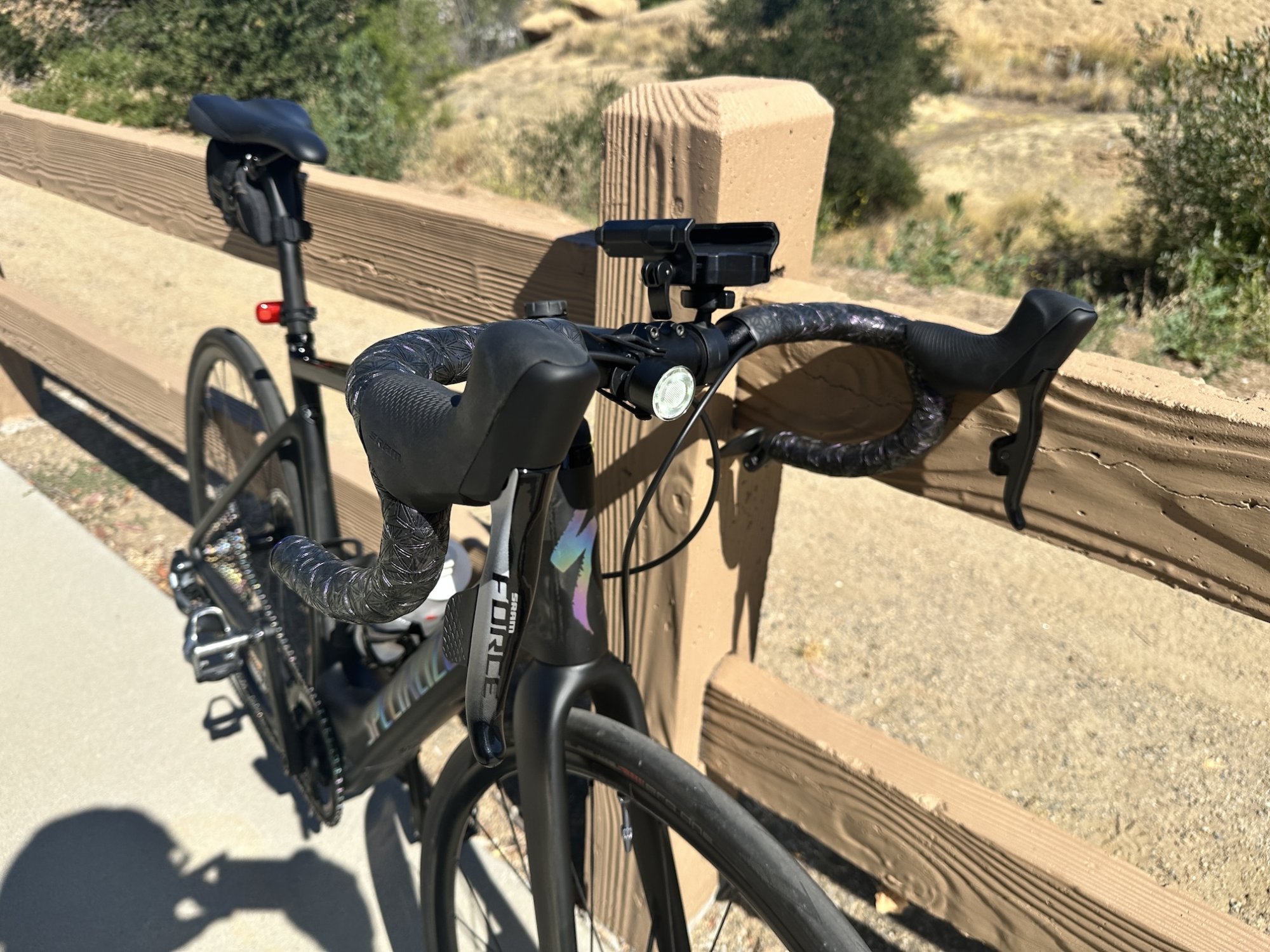

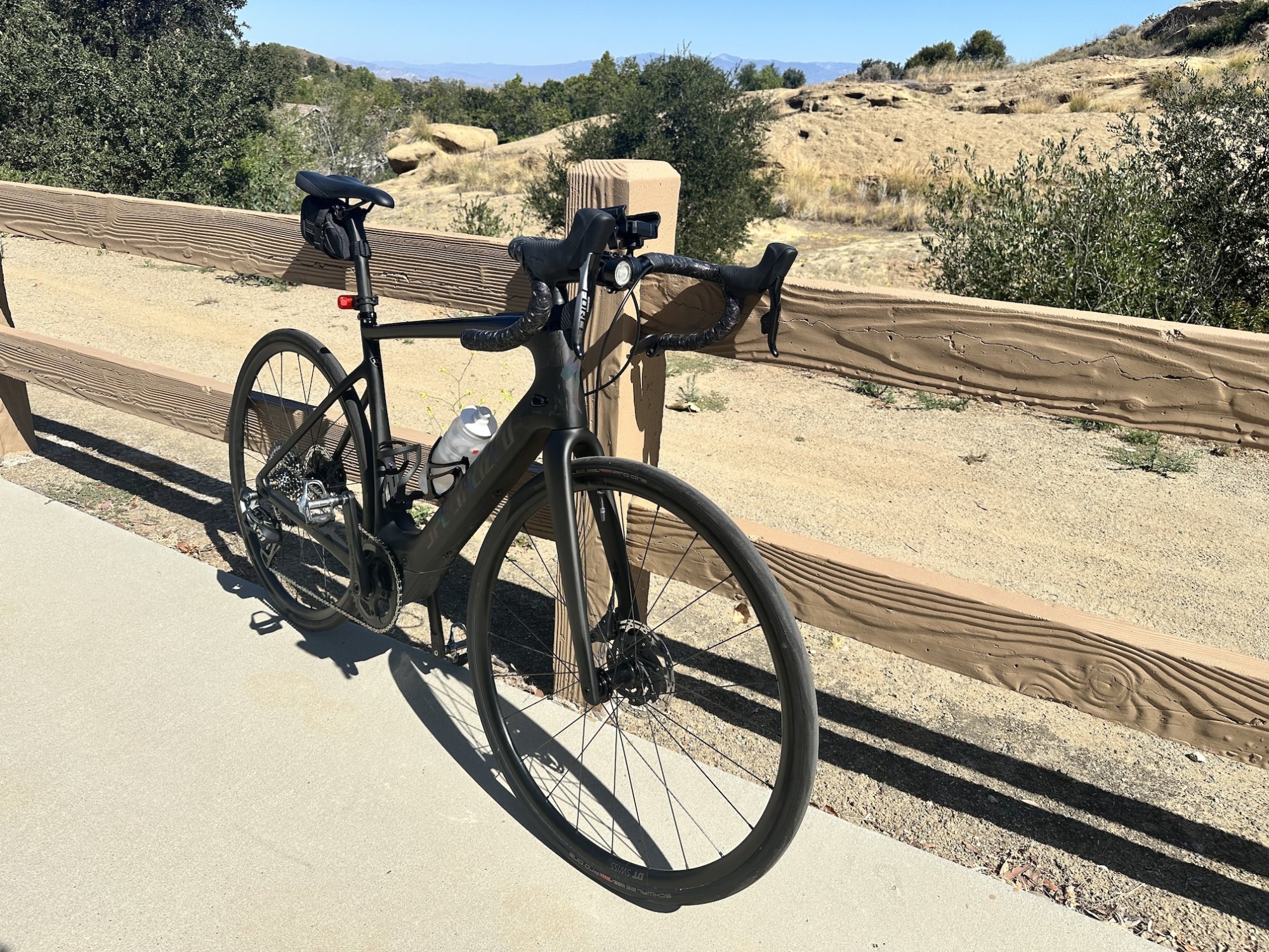

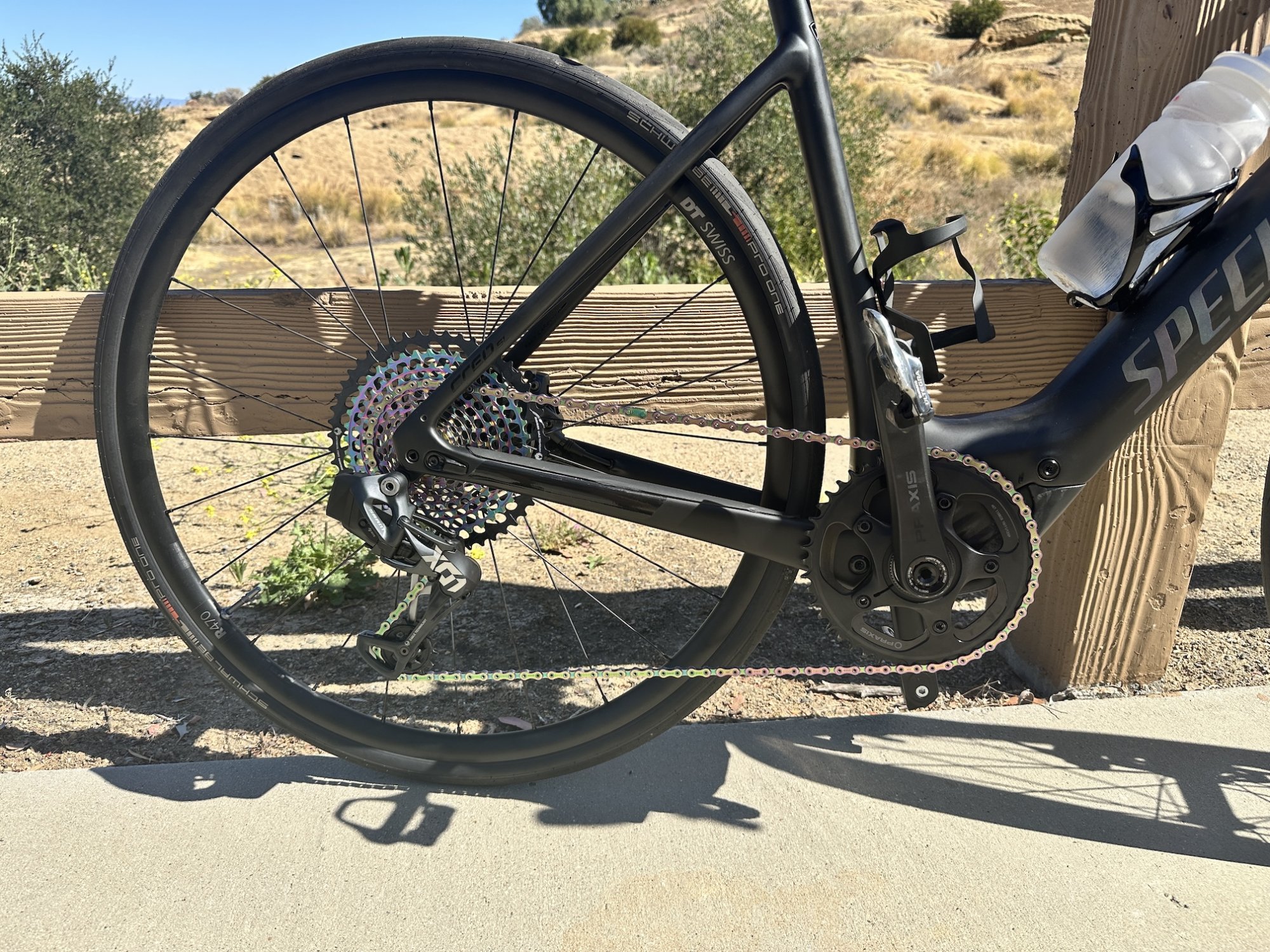

Here she is. Did a nice 20-mile shakedown ride yesterday. Everything works perfectly and shifts are quick and sharp. My LBS is an authorized Specialized dealer so they also did a full tuneup including battery testing and stabilization updates, firmware update etc. It rides better than new. I went with the rainbow chain and cassette for a splash of color and it's also a pretty good match for the Specialized logo on this model. The bar wrap is called Oil Slick and also has a nice purple/green effect.
