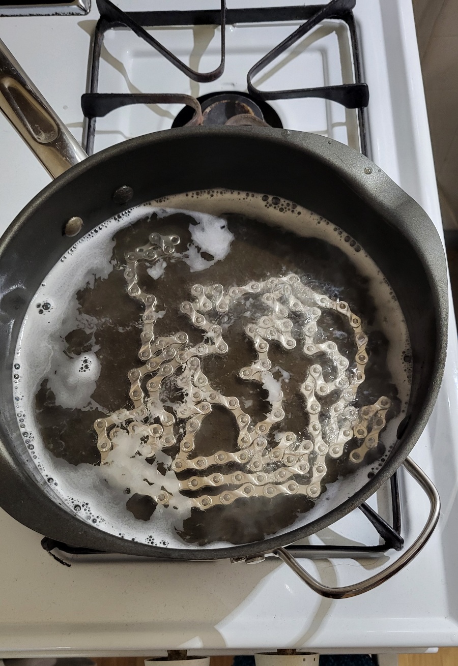

I have a $13 mini crock pot with wax. The unwashed new chain goes in and cooks.
You don't clean the factory grease off the chain before you put it in the wax?
I started with hot water and Dawn detergent in the sink, then dried it, then rinsed it in Naphtha, then Dawn again and dried again, then Acetone and dried again, then a final hose down with Brake cleaner outside on the back porch.

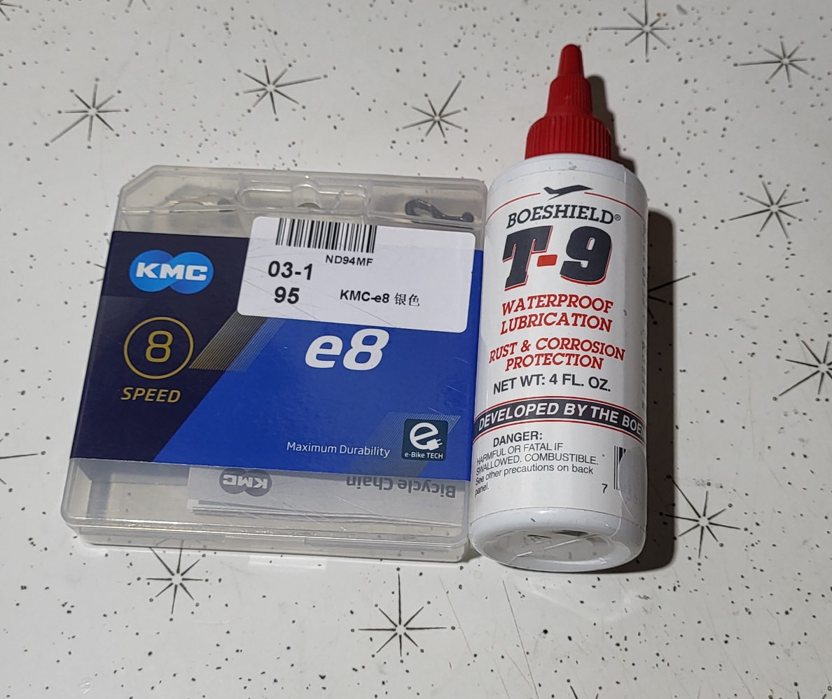

I just ordered the new KMC e-chain. It is pricy yet fits the need. It arrives sometime Monday. I will boil it in wax and ship it. The number of links should be just right with no cutting. You may be able to Insall it yourself. You will need to break the existing chain and that takes a special tool, a type of plyers you may already have on your multi-tool. Or I will send it ahead to a shop.
Patrice,
As Josh knows, I boiled your original chain in wax. All the bubbles come out between the pins and rollers. It stays smooth and clean for its entire life when wiped. Chains new ship are covered in shipping gunk. The last bike shop in Grand Rapids replaced it with that gunk as a lazy standard. You don’t want to touch it. Gross. Yucky. Your needs for this ride are not standard. You are on an epic continental ride. Can I make a chain that is just right for you and ship it ahead to any designated bike shop? Give me about four days lead time. Automotive brake cleaner can remove the gunk, but it is smelly, makes a mess, and the residual gunk can foul the breaks. It does not penetrate the pins and rollers like boiled in wax. I would love to create a chain that is exactly correct for you needs. I only wish that I were there to install it and meet with you.
,. I will boil it in wax and ship it. ,
As Josh knows, I boiled your original chain in wax. All the bubbles come out between the pins and rollers,..
Sure,..
I boiled my chain in wax, but I cleaned it REALLY Good before I put it in the hot wax.
Wax won't bond to metal unless it's completely parched of all grease and oil.
And I pulled it out at the proper temperature this time,..
