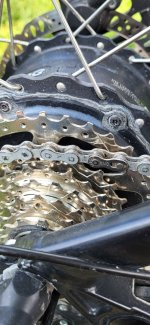

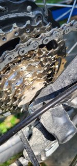

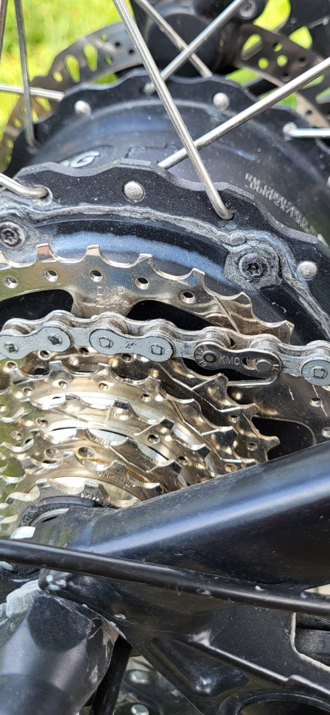

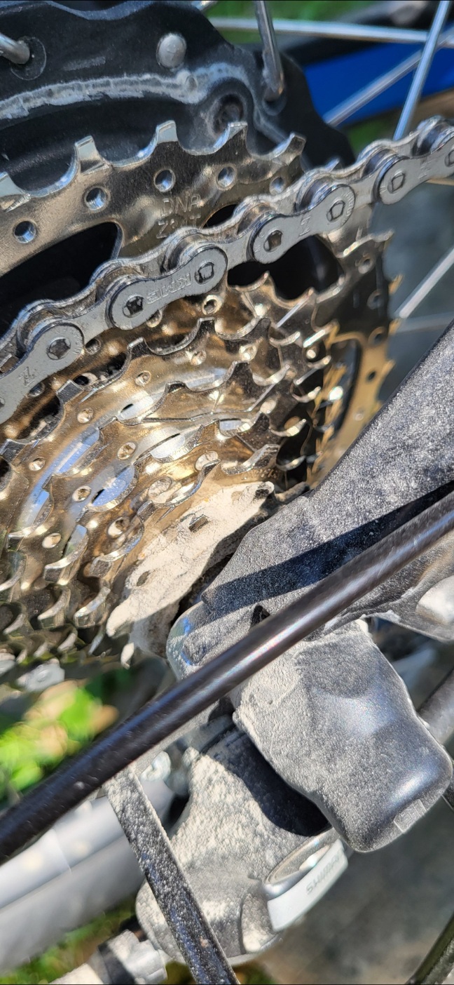

This is my waxed chain on my freewheel with 7th gear completely covered in dust,..
The dust just rinsed away easily.
If I had been using any kind of oily type lube, the dust would have turned into a black oily paste all over the freewheel and especially the derailleur cog wheels.
"When applied to the chain it dries, leaving a microfilm of wax that is dry and water repelling. It does not attract dust or debris and stays clean. Unlike oil-based lubricants, Squirt does not form a black paste that causes long term damage to a drivetrain. It stays clean in all conditions, ideal for road, TRI, gravel, XC, trail, enduro, commuting and cyclo-cross."
