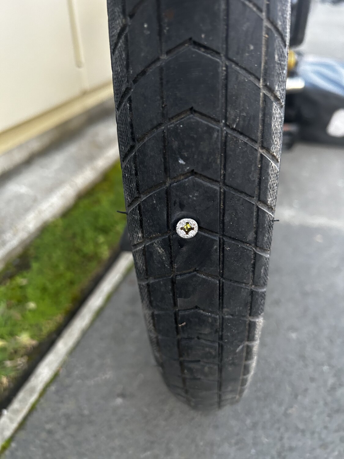

So this happened to me on my commute home yesterday:
Instant deflation - was riding on the rim before I could even come to a full stop safely - not good!
I'm running tubeless on my gravel bike and eMTB now and got me thinking about going tubeless on my SuperCharger 2. I have really liked the Schwalbe Super Moto X tires and would like to stick with them but a LBS said these are not designed for going tubeless and recommended an alternative tire instead.
What was new to me was they also said they see tubeless commuters lasting around 3000km vs tubed commuter tires around 8000km on average (I'm at 9,761km on this set!)
Would be interested if others have gone tubeless on your R&M?
