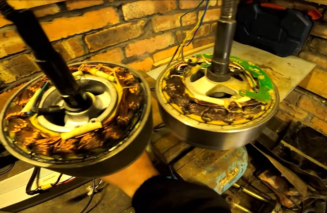

This is the full G06 750w on the left with the 350w in the vice , the 350 deglued its magnets at 2KW, the 750 survives to this day.
The 750 is almost an inch wider
