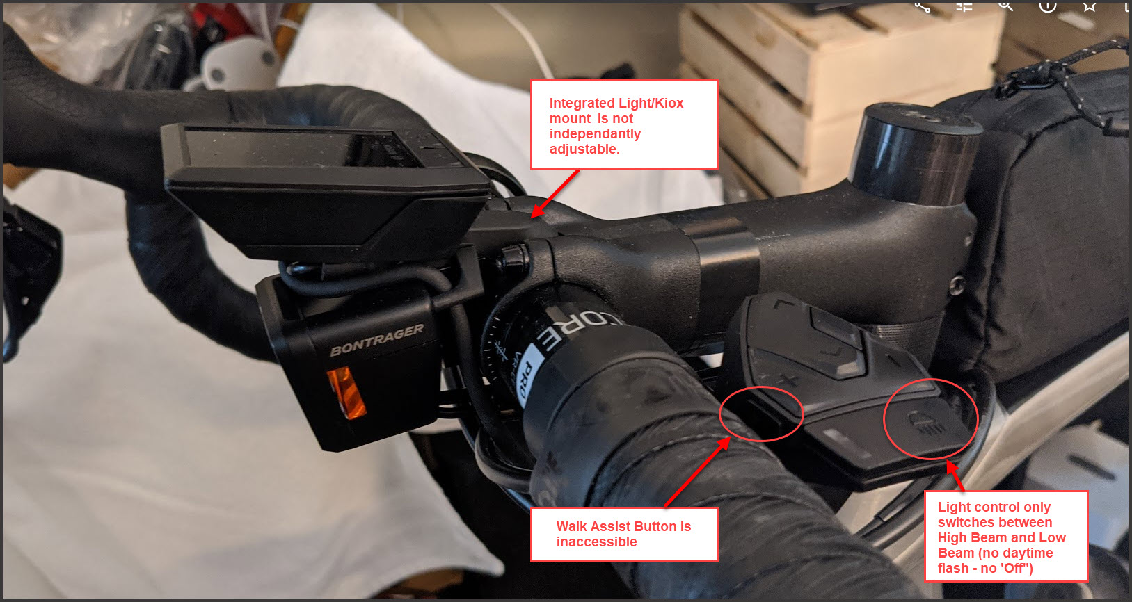

I have a Trek Domane+ HP7 with the Bosch Performance Speed Motor, and an integrated proprietary mount (Blendr type thing) that is clamped to the handlebar between the stem bolts.
I love everything about the bike except.
1. The fact that the Kiox is bolted directly to the front light 'blendr' mount means it's not possible to adjust the viewing angle of the Kiox display independent of the light beam angle. I'm fairly sensitive about making sure I have my very bright front light angled in such a way as to not blind oncoming riders (on the trail) or drivers (on the road). Unfortunately, this puts the Kiox at an angle that makes it difficult to see in some lighting conditions.
(PS: Please ignore the annotation about the inaccessibility of the Walk Assist button. Although it is annoying, and obviously poorly designed, it is not a big issue for me as I rarely if ever have need for it - I also used this image to show some of these issues to the management staff at my bike shop while in home isolation).
2. The Kiox lighting control is limited to switching between 'high beam' and 'low beam' using the Kiox control pad. I need to have a flashing daylight 'see me light' mode and want the ability to turn the light off completely when it's not needed at all (riding on a rural bike path on a sunny day, working on the bike in the stand, etc...) . I'm not sure if this is something that could be changed in the software the dealer has (if it is, they aren't offering), but I don't see any options to change these settings in the Kiox menus or the phone app (connected via BlueTooth).

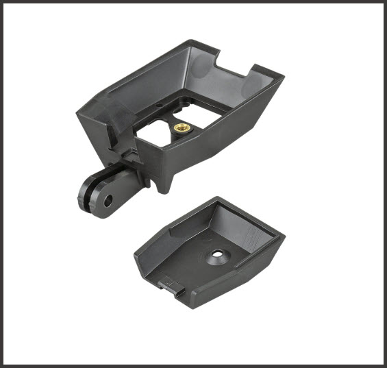

I've done a lot of digging around looking for alternative mounts that will separate the Kiox from the light so I can adjust them separately. So far the only solution I've found (that I can actually get in the US anyway) is the Blendr Kiox Mount from TrekBikes.com.
I have ordered one of these, but I don't actually have it yet. I will likely end up using this solution though.
There is one other option, and that is the standard 'Stem Cap' Kiox mount, which is used on many MTBs.

Unfortunately, using the Kiox Blendr Mount will mean that I have to use a different front light, as the Bontrager light's housing is integrated into the Blendr mount (hard to see in the picture).
I've been looking around at lights, but it's so very confusing. Bosch says any 12V light with max 1500milliamps output will work. I don't know if that is combined output, or applies to front and rear independently. I don't ride in pitch black conditions, so I don't need a mega bright light. Enough light to light the paved path in front of me at a safe distance is fine. I do want to replace both the front and the rear light , as the current rear light is mounted under my seat and is not visible with my commuter bags attached, so I need an alternative there as well.
