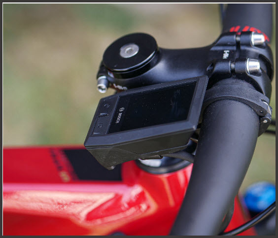

Re: Alternative Kiox Mounts. I've found some online. Most of them are only sold in Europe. I saw one I rather liked on Moustache Bikes website, but they don't sell them online and suggest to 'contact a dealer', of which there are none in my area.
I tried the stem cap mount found on many MTB's. On my setup, with a 120mm stem angled down, the Kiox just sits up too high off the top of the stem (sorry, I don't have a picture). I do need to cut a centimeter or so off my steerer, which would help some, but I'm not planning to do that in the short term, until I'm sure about my fit.
The one shown on Moustache Bikes website would work pretty well I think, as I could mount the Kiox alongside the stem as shown above, and use the Trek Dual Blendr mount to mount my main bike computer (Wahoo Roam) on the top half, and have the new front light, whatever that ends up being, hanging from the lower mount.

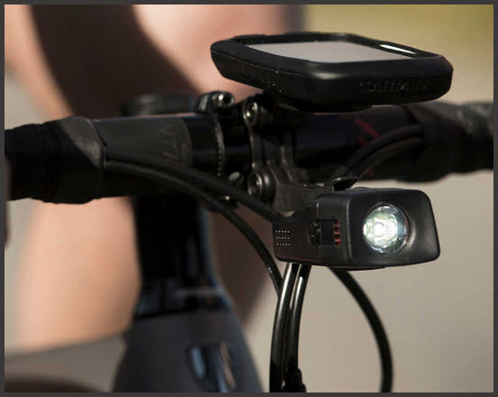

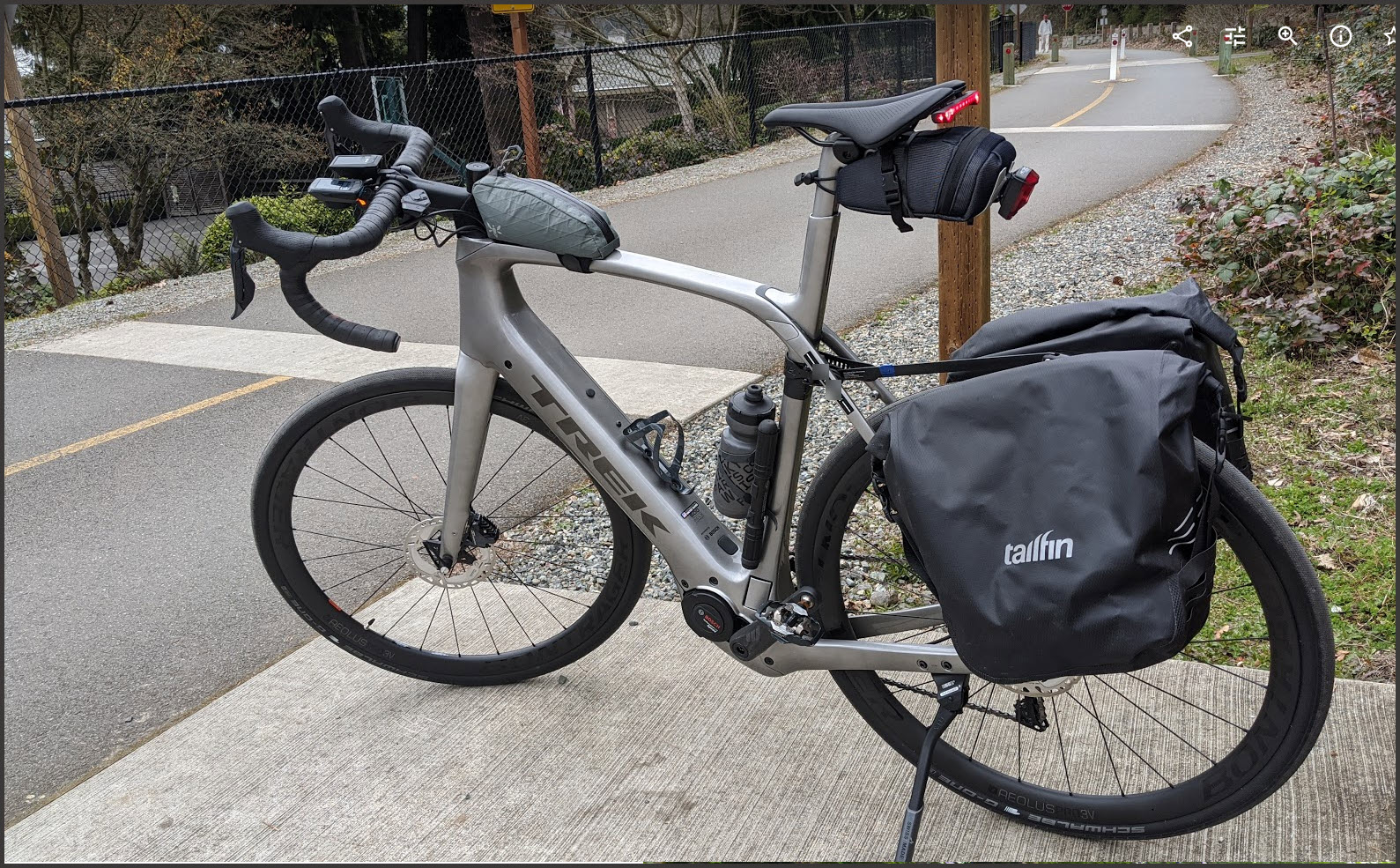

FWIW, here is a picture of the subject bike on it's shakedown ride. There are a few things changed or missing here. The stem is now angled down. The Elemnt Bolt is now a Roam, and not shown is the Tailfin Trunkbag, which sits on top of the two panniers attached to the seat tube, which carries a second battery nestled into some Kaizen Foam to keep it safe.
I get about 80-90 miles of range on this, which is not too shabby considering the hilly terrain I ride in the Seattle area, and the system weight, with the 60cm bike, two batteries and my fat butt is pretty significant. :cool:

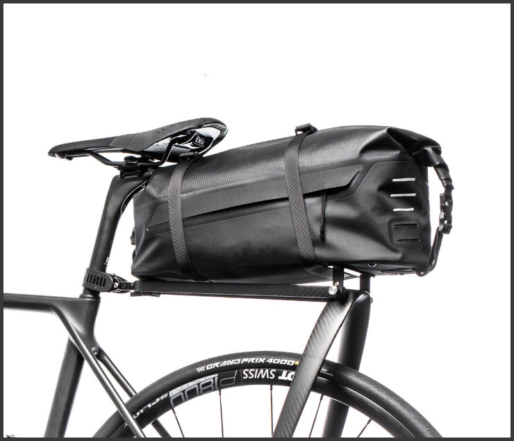

Here is the stock photo of the Tailfin Trunk Bag, which I use with or without the shown panniers to carry the second battery.

That Moustache mount you posted is one of the ones I was thinking of. I feel like Stephen somehow ordered that one, or one like it for shipment to the US, but I'm not positive. I'll try to find some more info.

I have the Acid one you linked above---really good mount. You would need to keep the high/low beam light switch because built into that switch is placement for the Kiox remote. If you removed that high/low beam switch, there is no spot to mount the remote.
The Moustache one pictured above will not work if the high/low switch is removed. That picture is for a mountain bike setup they have so there is a 22.2 mm section of handlebar for the remote to be attached. I have attached a photo below, this is of the Moustache Dimanche 28.5---that would be a solution as they have incorporated a section for the remote. Note, that was the best picture I found of their setup

My plan would require replacing the Bontrager lights (at least the front one) with the Light and Motion Nip 800 (and possibly Tuck in the rear).
I would start by removing the proprietary Bontrager light/Kiox mount from the center of the stem, and replacing it with a Blendr Dual mount like the one pictured.
I would put the Trek Blendr Kiox Mount on the top mount point, and hang the L&M NIP800 from the bottom. Then put my Wahoo Roam on it's own mount off to the side.
I don't consider this ideal, as my Roam is my primary display. I really only need the Kiox there to turn the system off and on, and know what mode I'm in.
Ideally, I would like to move the Kiox behind the bar using the Acid Mount and put my Roam on the top mount point of the Blendr Dual. If I lose the functionality of the proprietary light button the Kiox switch, and or the light on/off on the Kiox itself, I'm ok with that, as long as I can turn the lights off and on, and change modes using the button on top of the NIP800.
Of course all of this depends on the compatibility of the NIP/TUCK light system (or another if necessary) with the Bosch/Trek motor (and the funky custom Trek switch on the Kiox switch).
Does my plan seem viable?
