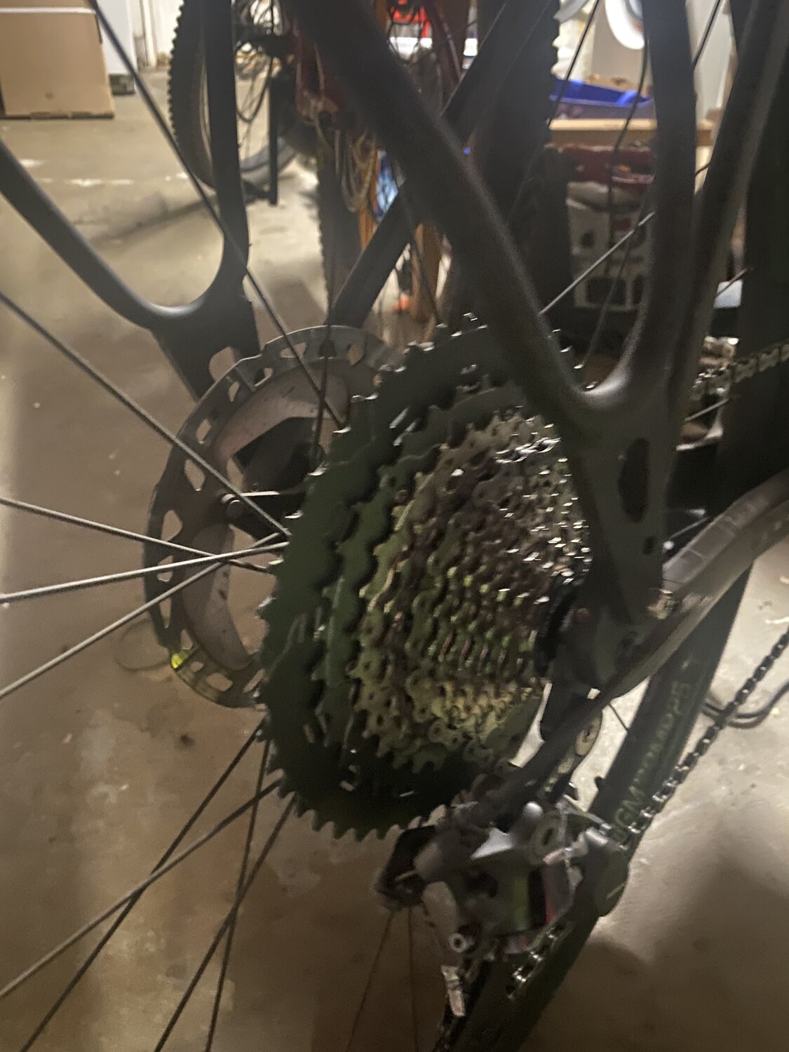

Now for a biggie, about 3 weeks ago I had Trek install a goatlink / wolftooth with a new cassette for improved hill climbing ability. WOW what a difference. 11-46T now sits on the bike. The Domane is now so much more efficient for me to ride, which means improved battery performance. This is pretty cheap swap of parts about 200 dollars with installation and I am able to climb stuff where I had to use eco before and now its not problem. I live in Southern California and go up and though the Santa Monica Mts all the time. For me this is a great update and wish I had learned about it earlier. With that in mind, If you're not concerned about speed, one could consider a smaller front chain ring too.

I included here some photos of the new cassette for hills, it really helps to decrease battery usage.

This is a very exciting update to hear that it is working well. As Bosch won't allow motor assist tuning with the Kiox, I have to go out of ECO mode when climbing in the 42T (depending on the hill), but then I have more power than my fellow riders and go too fast. I think the 46T in the rear will help me balance this out for a wider range of situations.
Do you hear any grinding when in the 46T rear cog?
Do you have in trouble shifting into the 46T from the 37T which is the next (big step) cog down?

Hi nope there is no grinding and shifting is fine, perhaps a little less refined but that’s really subjective. I haven’t had any issues honestly. Now I want to find a way to get a bigger gear on my 2009 Roubaix 😂.
