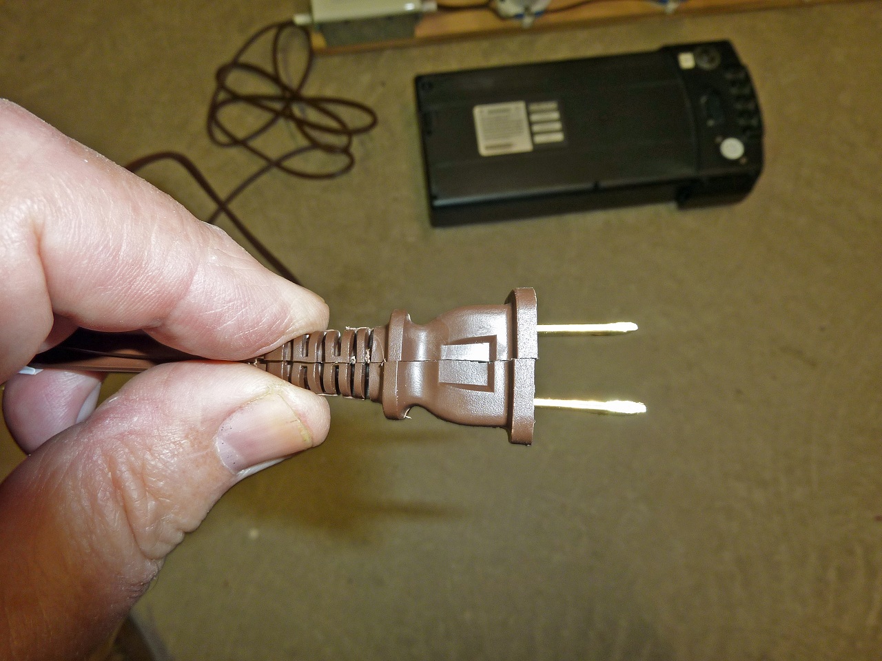

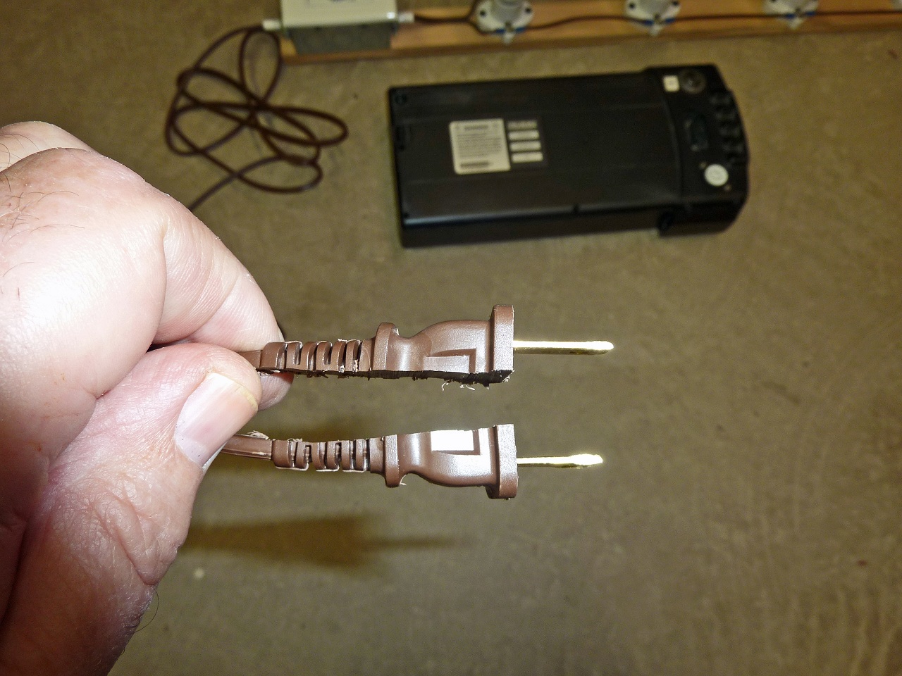

What type battery is it? what does the discharge connector look like? If you can safely access the contacts, a simple discharge rig can be made using a lamp with an incandescent bulb.
Many batteries use spade connectors that can be accessed by cutting the plug in half on an old extension cord:
Insert the plug halves into the battery and plug the lamp into the extension cord. The higher the bulb wattage, the more current it will draw.
If you're careful, you may be able to use this idea with other battery connectors as well.
The main reason not to do this is just the unnecessary wear on the motor, internal gears (if any) and bearings.
View attachment 203092 View attachment 203093
