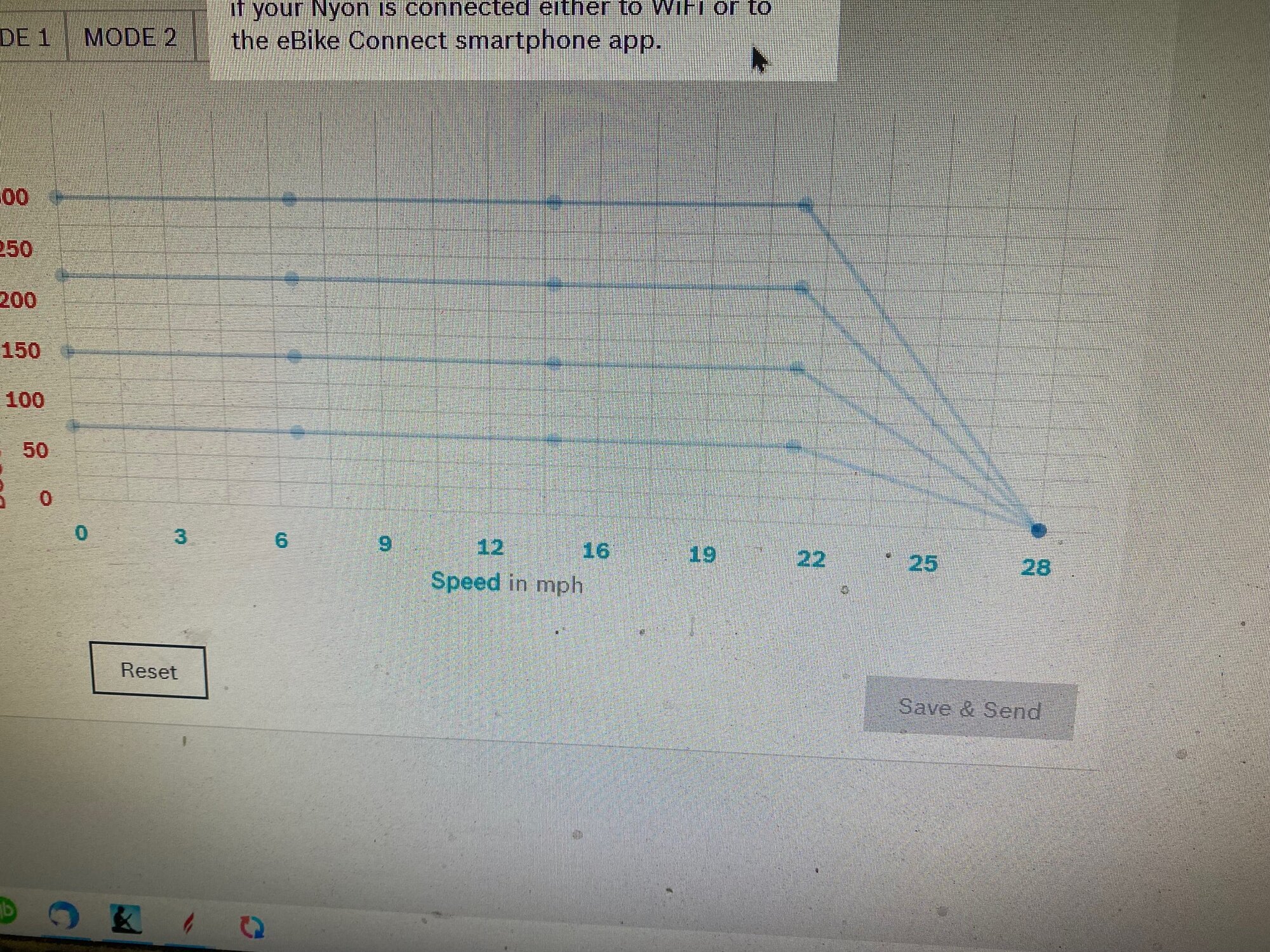

I have a domane hp + and Trek just sent me a replacement. I have had trouble with incorrect speedo and odo readings. The bike computer registered fast compared to my garmin and other riders. My assist cut out at 26.5 mph. Trek tried to fix it. When unable, they found a newer bike in stock and swapped me. Unfortunately the problem is the same. Anyone else have this issue? Am I the only one with a garmin on my bike? Otherwise I would never have known. Except the bike shows .5 miles more than anyone else on a 30 mile ride.
you cant go by garmin for speed. but this is typical of bosch. you can change the wheel daimiter to smaller to get it closer. but the motor cutoff is the main issue
LBS changed wheel size. Got speed closer, but made cutout lower. And they had to change the size by 2 inches.
