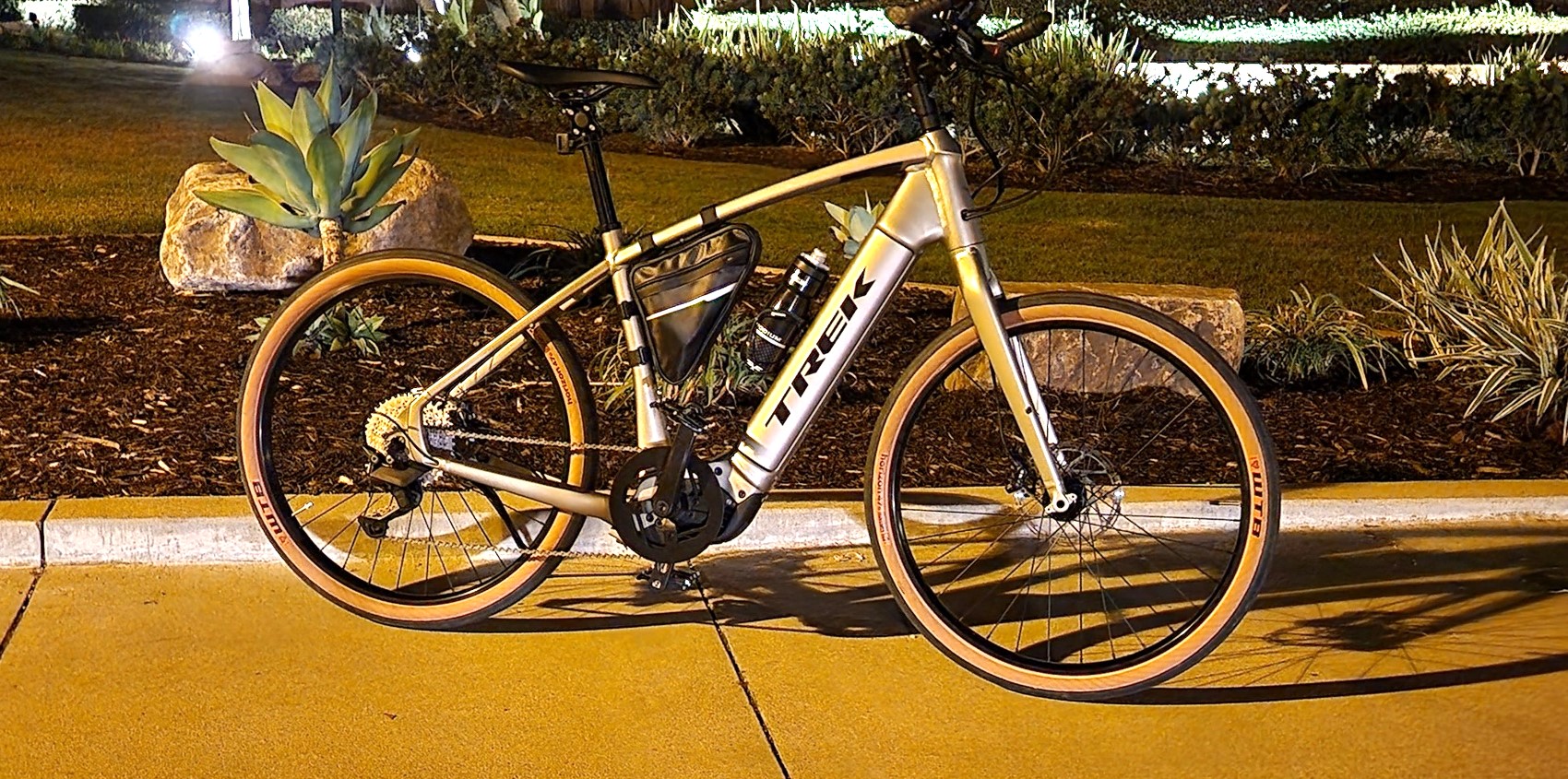

Trek Allant+ 7S: Slight Vibration Emitting from Bosch Performance Speed motor
It's very difficult to describe a problem that does not seem to have a definitive pattern to it.
He tried to explain it, with what seemed like a bit of panic about his purchase :)
