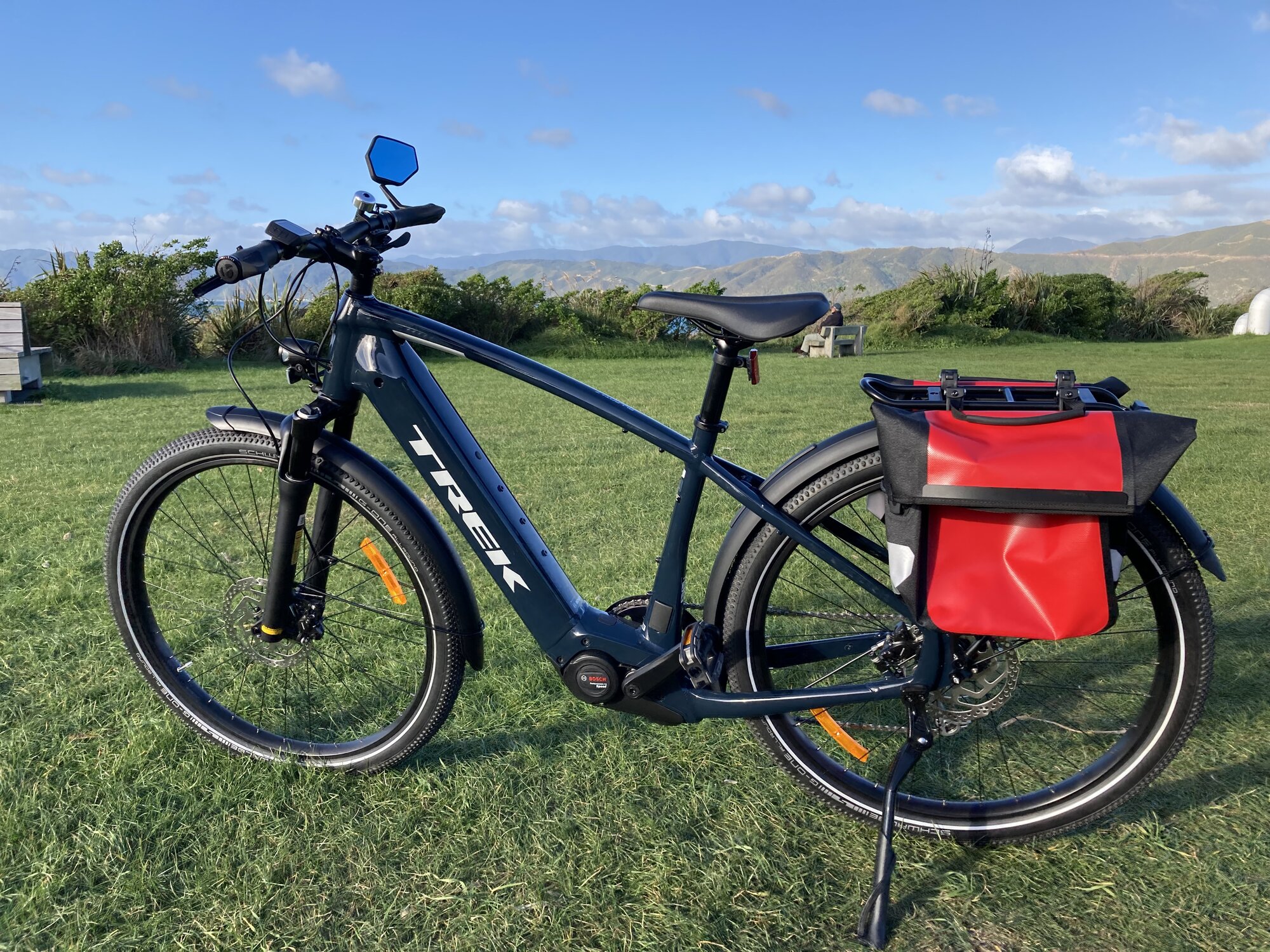

Trek Allant+ 7S: Slight Vibration Emitting from Bosch Performance Speed motor
More data- downhill in top gear & touring mode going full tit around 45-50kpm. Vibrations through pedalS bigtime.
Then on the flat in Sport going full tilt pedalling at around 45kpm bad vibration, then head wind hit and slowEd me to 35. This increase of torque immediately stopped vibration. Spent rest of commute tested gears, modes & turning motor off while riding.
Summary, the increase of resistance seems to decrease or remove the vibration, but on a bike that is designed to go fast and you have good air & road conditions you will get major vibrations at speed.
So if you ride like an old nana then no problem, buy one. Unfortunately after 46 motorcycling I feel the need for speed 🙃

As far as I’m concerned, it’s just the way it works. It’s never affected the operation of my Allant+7 in any negative way and I only ever noticed it because others here have complained about it. Every vehicle I’ve ever owned has had its idiosyncrasies and that’s all it is to me. Kinda like how the Bosch makes more noise than some other motors. If it bothered me, I’d take it in for testing.
Well taken bike into store, the mechanics feel the vibrations and are going to ask Bosch about it. But I have just had the chance to test ride the same bike in another store and it is as horrible as mine with the pedal vibration at speed and reduced torque. When I mentioned this to the guy there they said “oh that’s the Bosch motor for you”. So I’m going for a refund as every other electric bike I’ve ridden is sans pedal vibration and a different motor manufacturer.

Can you post some pictures of the drivetrain side of your allant at different angles?
This way we can visually inspect and confirm if anything like the derailleur needs a simple adjustment or if your chain is perhaps too short or not well maintained.

I stand corrected further research shows Bosch has acknowledged this noise/vibration issue to their new motor -
This explains why the Trek Allant 7 could be unfortunately particularly sensitive to picking up and amplifying this motor noise. So really a design flaw from Trek to not make allowances for this Bosch feature.

Talking about noise, the absolutely biggest downside of Bosch’s latest design is a metallic clacking noise when the engine is unloaded and rolling over uneven ground, not unlike that of bad chain slap, coming from the motor itself – something I’ve never experienced with any competitor’s product. On some bikes equipped with the new Performance CX it’s more noticeable than on others. We checked in with Bosch and got the following explanation:
When encountering technical terrain on an eBike or eMTB, a vibration of the chain/chainring can occur. Those vibrations can be transferred to the frame, the drive unit and to the inner gear wheel (inside the drive unit). How much vibration is transferred depends on the type of bike (for example hardtail vs full suspension and aluminum vs carbon). In some cases, when freewheeling a metallic sound can be generated when the inner gear wheel is not under the stress of pedaling.
We have been able to recreate this occurrence with different drive units – both from Bosch and competitors of Bosch. The new Performance Line CX is possibly a little more sensitive and the noise is slightly louder than the noise of the other drive units. The CX has a high power density, a highly efficient gearing mechanism and incredibly smooth-running gears. Paired with reduced weight, lower wall thickness and improved heat release it is easier for mechanical noises to be omitted. But performance, efficiency, heat removal and heat-resistance are more important to us.
Usually this noise is drowned out by the sounds of the bike on the trail when descending. Knowing the occurrence, it is easy to reproduce the noise, but the noise does not have any influence on the performance, functionality or reliability of the motor.
Event though this noise is not at a level that would cause me to not ride a Bosch equipped bike anymore, you simply cannot unhear it. With every development from derailleur to chain protector over the past few years to keep a bike as quiet as possible, hearing the clacking noise when rolling over uneven terrain without the motor being engaged is simply annoying.

You seem to have difficulty with English comprehension and apology accepted for accusing me of lying about ownership, would you like a copy of the receipt or was the picture sufficient?
If you read the posts and understood them you would see I clearly stated, after getting the technical data available to anyone else here, that I posted-
“I stand corrected further research shows Bosch has acknowledged this noise/vibration issue to their new motor -
This explains why the Trek Allant 7 could be unfortunately particularly sensitive to picking up and amplifying this motor noise. So really a design flaw from Trek to not make allowances for this Bosch feature.”
I now know the motors are sound, very good in fact, as I bothered to investigate instead of pontificate. I just don’t like the clacking motor noise and I feel Trek should have done a better job in toning this down.
I have provided an answer to the threads initial question that is backed up by research, personal experience and manufacturers own data. As far as I’m concerned that ends it for me. I certainly hope anyone buying a bike with this motor does a test ride to see if it falls within their comfort zone & when they get one without a test ride and wonder WTF is going on they’ll appreciate what they learn here.
