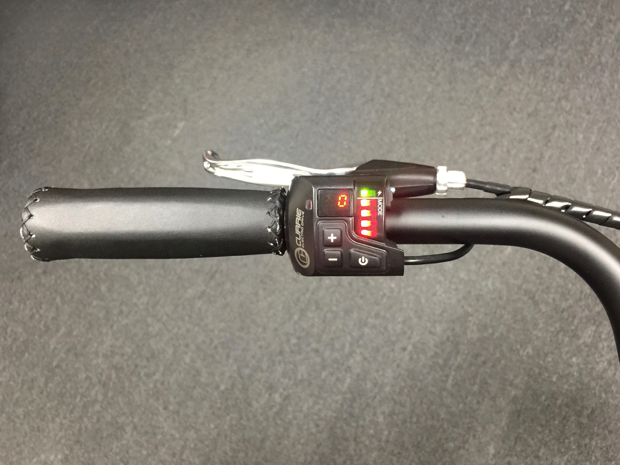

While this display is not removable or easy to swivel, the screen is very small and does not present the same glare issues as many larger screens. I really appreciate how this control pad features water-sealed buttons, a bright numeric readout, and includes a Mini-USB port on the right side. This port probably outputs 5 amps at 500 milliamps for use with portable electronics and smartphones. I did not love how you first have to activate the battery pack before turning the display on. This two-step process takes more time and could require some bending and reaching if you forget to activate the pack first before mounting the bike. I also feel that the three-color battery indicator is not nearly as precise or easy to interpret as an LCD infographic or percentage readout.

- The battery level is indicated by one of three colors: Green for full, Yellow for half-full, Red for nearly empty
- The current level of assist is indicated by four red LED bars
- The buttons on the remote button pad include: +, -, and Power but you have to power the battery pack on before the display will activate
