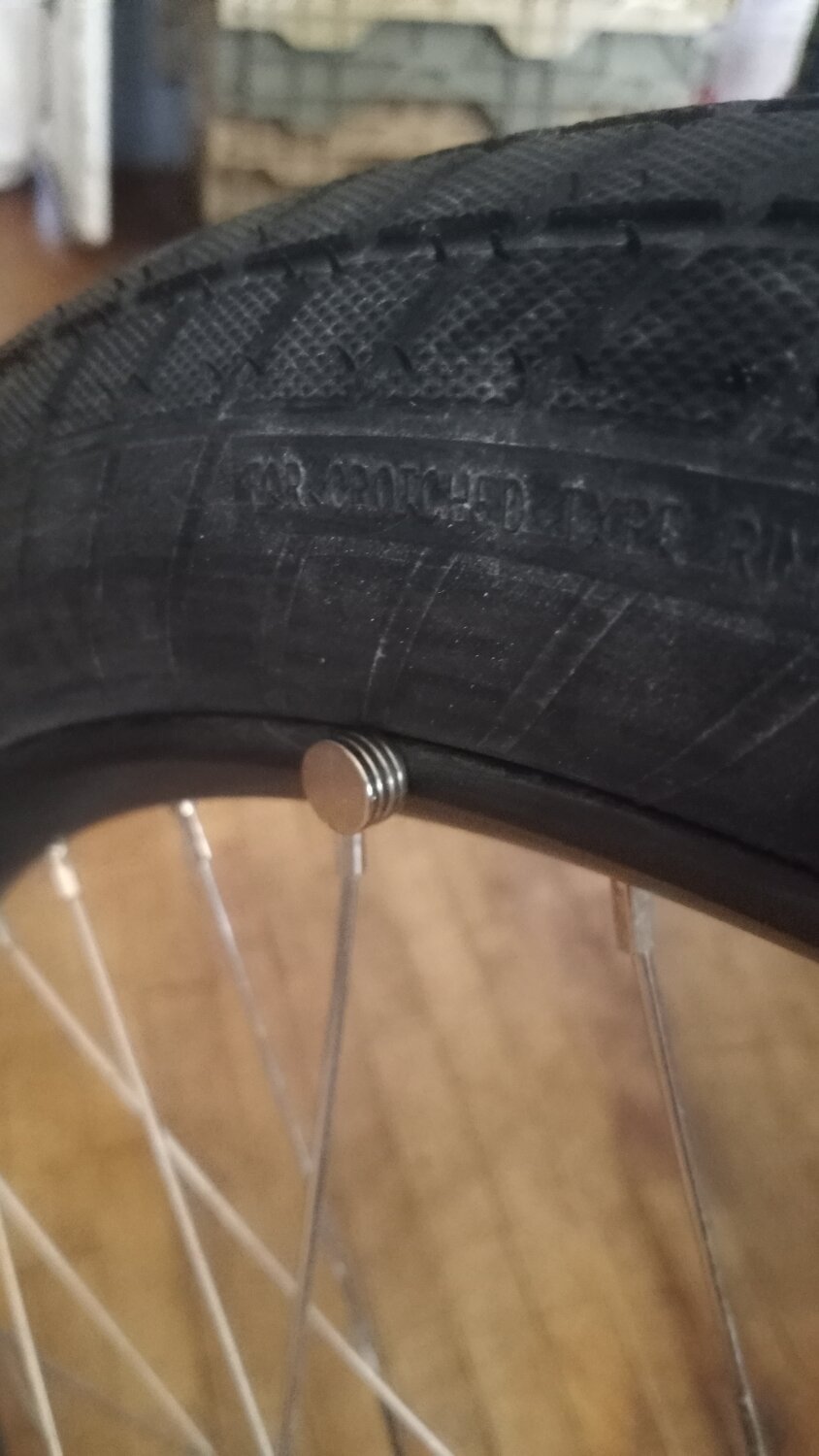

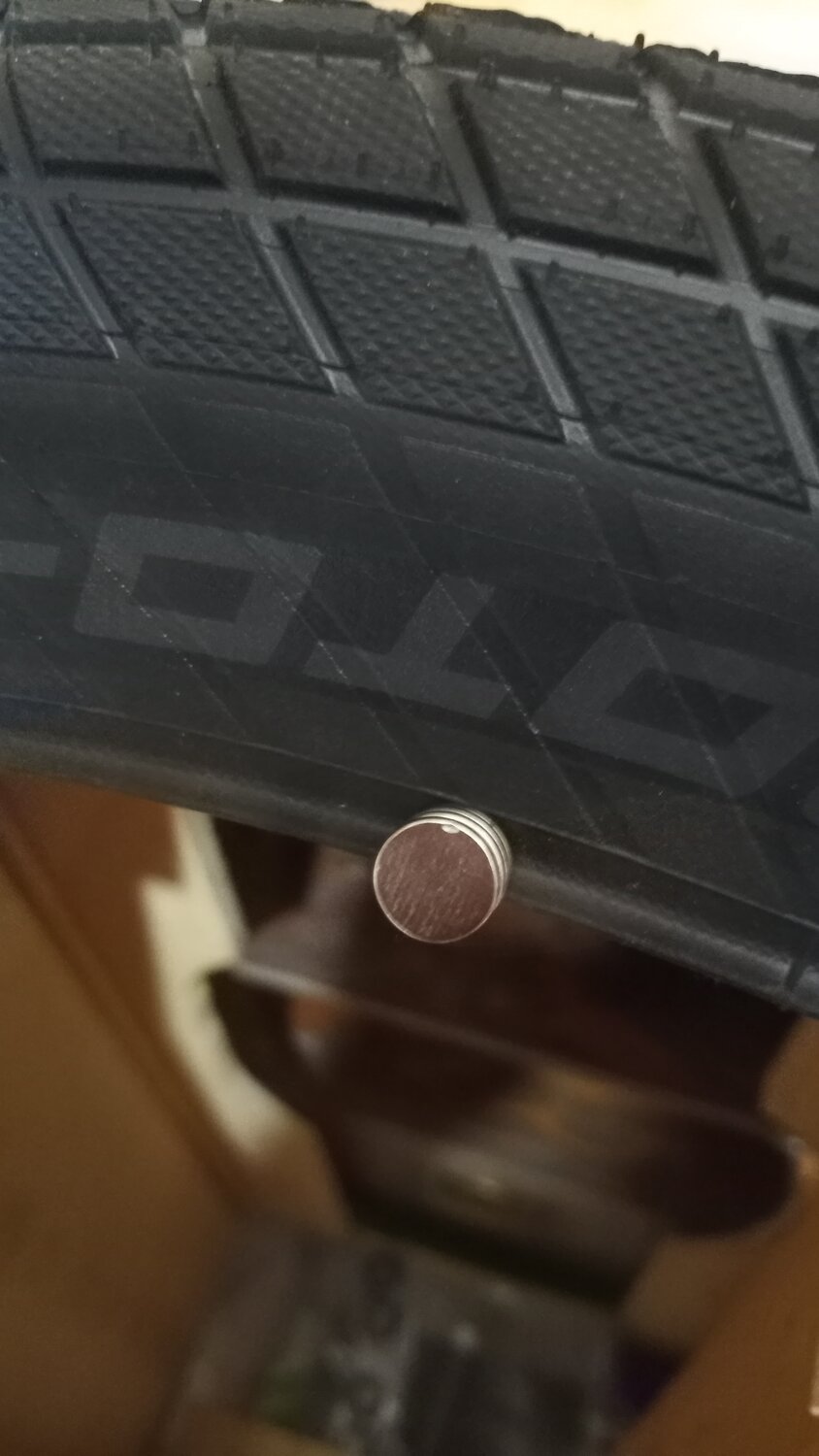

If you have alum rims, can't you use a magnet to see if it sticks ?
Well Holy s*it !!!
And the magnet doesn't stick between the spokes.
Only at the rim.
I wonder if I ever would've thunk that up on my own ??
Maybe if I smoked a Vado first ? 😂

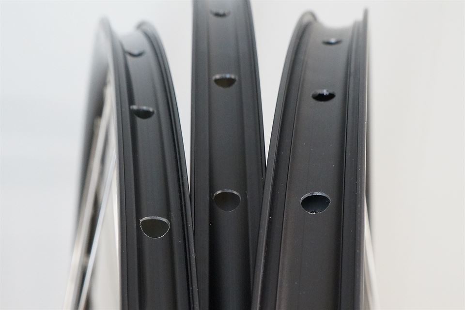

The whole 'crotched rim' thing is a bit overblown. You can expect almost (!) every rim to have at least some form of depression in the center to allow the bead to be moved to the middle and allow you to get the tire on/off as a result. And its not just wire beads that are affected by this. Folding bead tires have ... beads that fold. But that doesn't mean they stretch. Folding beads are often made with kevlar fibers and as you probably know that is less stretchable than a metal/wire bead. You need a depressed rim center to get even tubeless tires onto a rim.
I would investigate this as noted above... but don't worry about it. Chances are vastly in your favor that your rims will work fine with ANY bead of tire. Also FYI wire bead vs. folding bead just means you can stuff a tire more easily inside your kit and carry it with you. Means nothing with regard to fitment. I mean... if we get really deep into the subject a tubeless-ready tire *might* be a little tighter fit for reasons I won't get into... operating at your level with your machine-made rims, this is not something I would worry about.
here lookit: Old school road bike rims. Crotchless. But also concave. Same benefit.

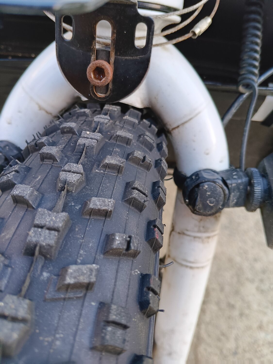

oh and also remember that as a tire's width increases, so does its outer diameter. A 20x2.3 tire's outer diameter vs. a 20x3.0 can be enough that the tire no longer fits under the fork., So don't just keep an eye on the fork width.
This pic is me learning this the hard way so you don't have to (the 20x3.0 tire actually fit but with ZERO extra room). Notice how the fork width is just fine. The knobs at 2 o'clock rubbed and I needed to file them down.

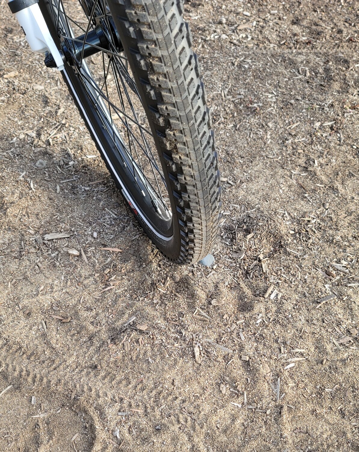

How about a hybrid tire with side knobs around a much smoother center tread for mixed offroad and pavement, respectively?
These are my ebike-rated 27.5 x 2.3" Specialized Crossroads Armadillos. The tracks show how the side lugs engage soft surfaces. The "Armadillo" indicates Specialized's highest level of puncture protection.

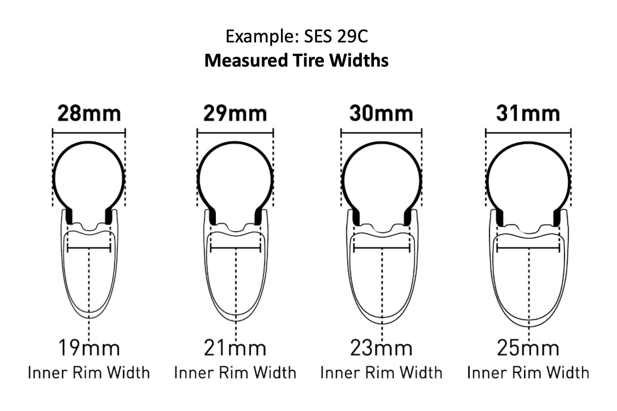

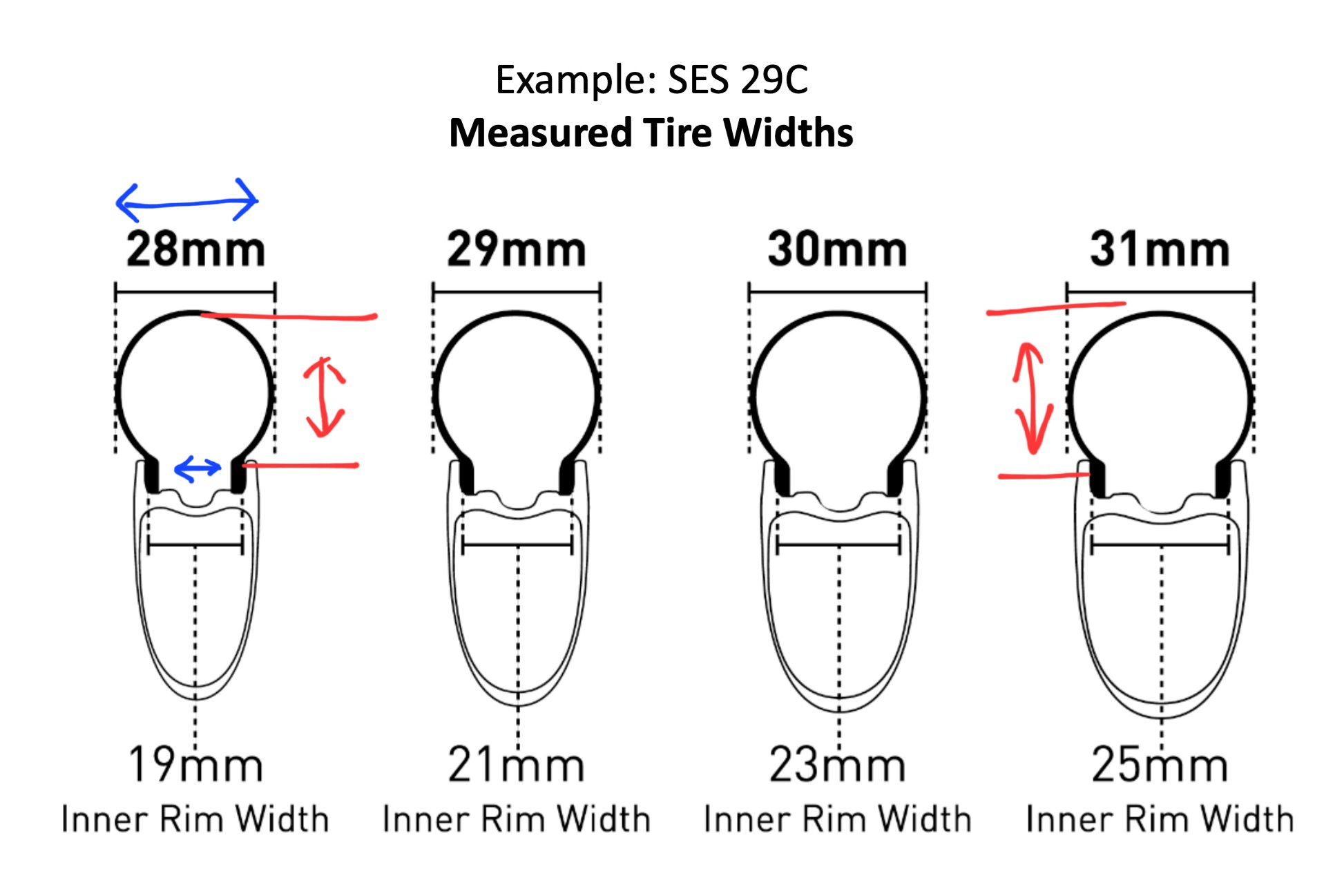

Another thing that I'm pretty sure is going on, is that the same tire is taller on a wider rim,.. ??
Installing the same tire on a wider rim should increase the overall circumference of the cross section and make a taller wheel ?
Like opening up a hose clamp.
And, I figure the narrower the rim, the more the tire would be inclined to roll sideways with lateral forces like when your cornering?
I figure that a tire can feel and ride in a very different way depending on the rim width?
Yes thats right. The common phrase I have heard for a tire that is on a too-narrow rim is a 'light bulb' profile.
Oh my yes. I decided to try and push that envelope a bit once - and I knew better but tried it anyway - and had exactly that happen. I had a 700c wheel and I tried to go a little bit too gravel-sized on it. Tire was fine on straights and higher speed cornering but I tried a slow dawdling corner at a residential intersection and the fokker folded right over, peeled off the rim and the under-pressure tube went kablooie. No saving that exploded tube and I walked home. This might have been the lesson that finally taught me to always carry a spare tube in addition to just the patch kit.
Maybe. I don't know if I would say "very" differently. Certainly if you go too-wide on the rim (which is one hell of a lot safer than too-narrow) you change the tread profile so the cornering knobs are perhaps now a part of thenormal straight line tire patch.
There is a school of thought on wheel and rim fitment (and I am partial to this thinking) that says its better to go on the wide side for the rim. Move the tire a bit further to the bell shape rather than the round shape. But not too much. You gain tire stability and reduce tire squirm. So long as you don't overdo it, you end up with a more stable platform. But go over the (invisible) line and the tire ends up with less ability to absorb impact, and less cornering control (particularly at lower pressures lke you would find on a singletrtack bike).

Outside rim width is meaningless for tire compatibility. You have to have the inner rim width which is between the hooks on the rim. And it needs to be in mm.
With that said, a 1" width in mm is 25.4mm. Lets call it 25mm. Thats pretty damn narrow. Figure we lose 6 mm of rim wall/hook at the least, and you are down to a 19mm rim (which sounds about right). Check the Schwalbe tire/rim compatibility chart, or the DT Swiss Tire Pressure and Dimension chart which is the one I prefer to use. On the DT chart, for a 19mm rim, a 2.00 tire is right on the edge of compatibility. But a 2.25 is just a bit past the ragged edge. It seems to me even a 2.00 tire is either compatible, or NOT compatible. You won't know until you pull that tire off and measure the inner width. How wide your forks are aren't the thing you want to care about. ESPECIALLY since now we know your rim is only 25mm wide on the outside. Incidentally, too-narrow rims are typical for storebought bikes. Its most of the reason I go to the trouble of having custom wheels built if I am doing a conversion on a complete bike. The narrow wheels are dealbreakers to me.
