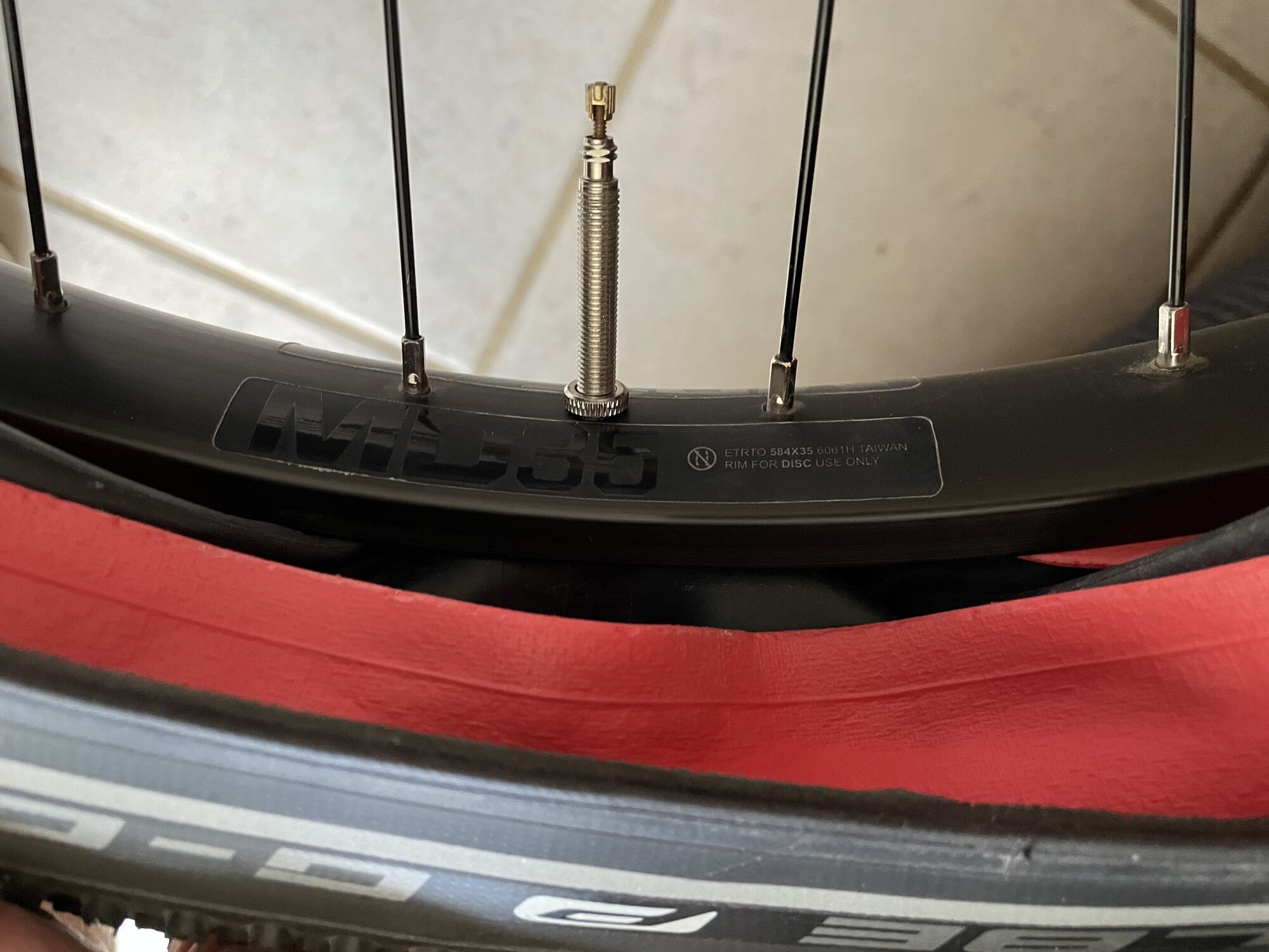

FWIW…I had three flats with my rear SCHWALBE G-One in less than a year and have added Tannus Armor to both of our my Allant+7. I discovered one more flat in the garage one morning after more than a month of use. I checked it carefully and realized I’d left a patched tube in it. One new tube later and it’s been about two months with no leaks or flats. Best of luck.
FWIW…I had three flats with my rear SCHWALBE G-One in less than a year and have added Tannus Armor to both of our my Allant+7. I discovered one more flat in the garage one morning after more than a month of use. I checked it carefully and realized I’d left a patched tube in it. One new tube later and it’s been about two months with no leaks or flats. Best of luck.View attachment 96167

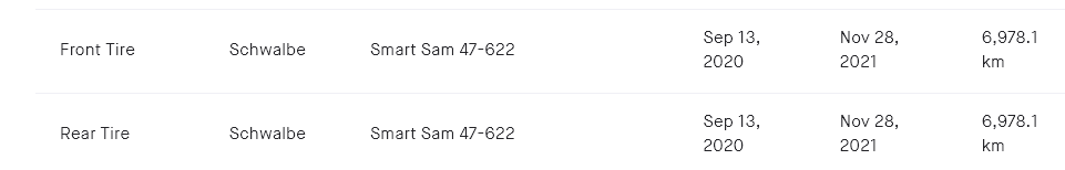

My Schwalbe Smart Sam 47-622 have been ridden for 7,000 km (4350 mi) without any noticeable wear.
I replaced them today only because I swapped them for winter tyres. Will re-use them in the Spring.
