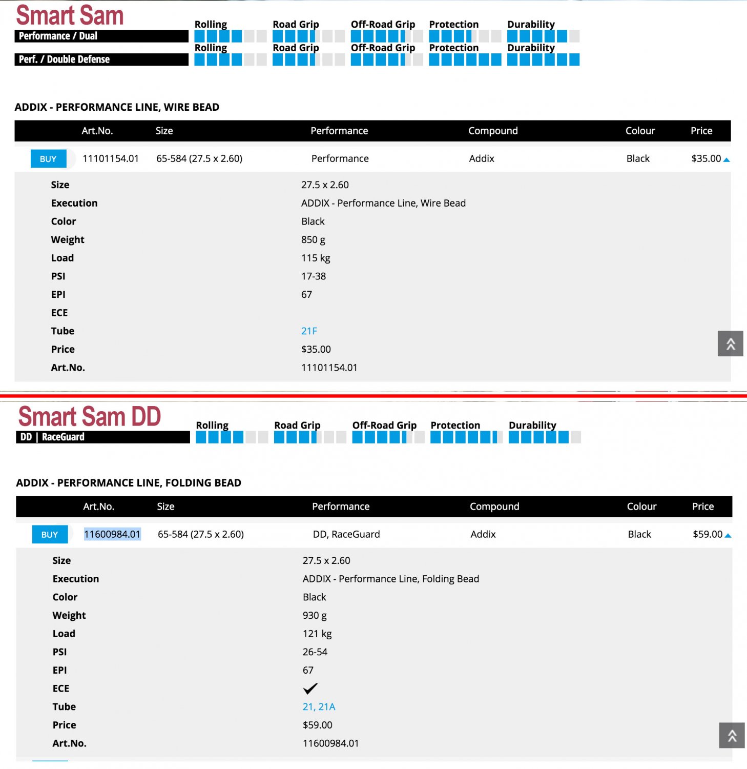

I'm currently thinking of Smart Sams. Here are the choices in our size:
Since we'll be using Tannus Armour, I'm not concerned about flat protection (hence I don't care about the Smart Sam Plus and beside they don't come wide enough). Do I care that much about wire versus folding bead? It's not like we're going to be carrying spare tires with us.

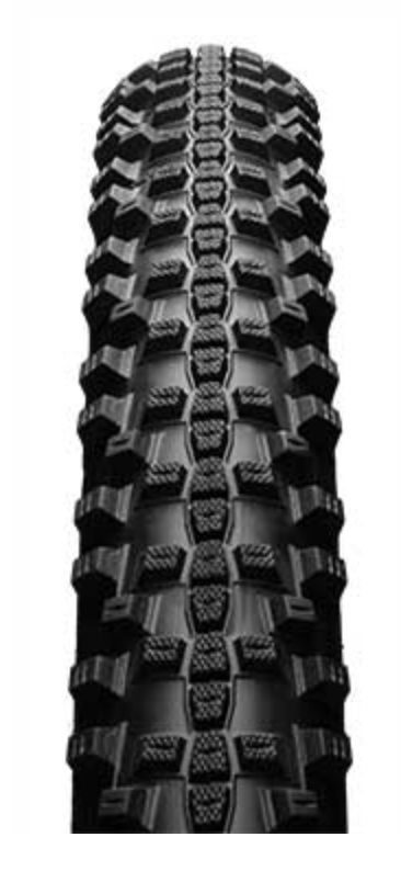

Here's what the tread looks like:
The continuous center bead helps keep them smooth on the road, while the knobbies just off center help with off-road traction.
