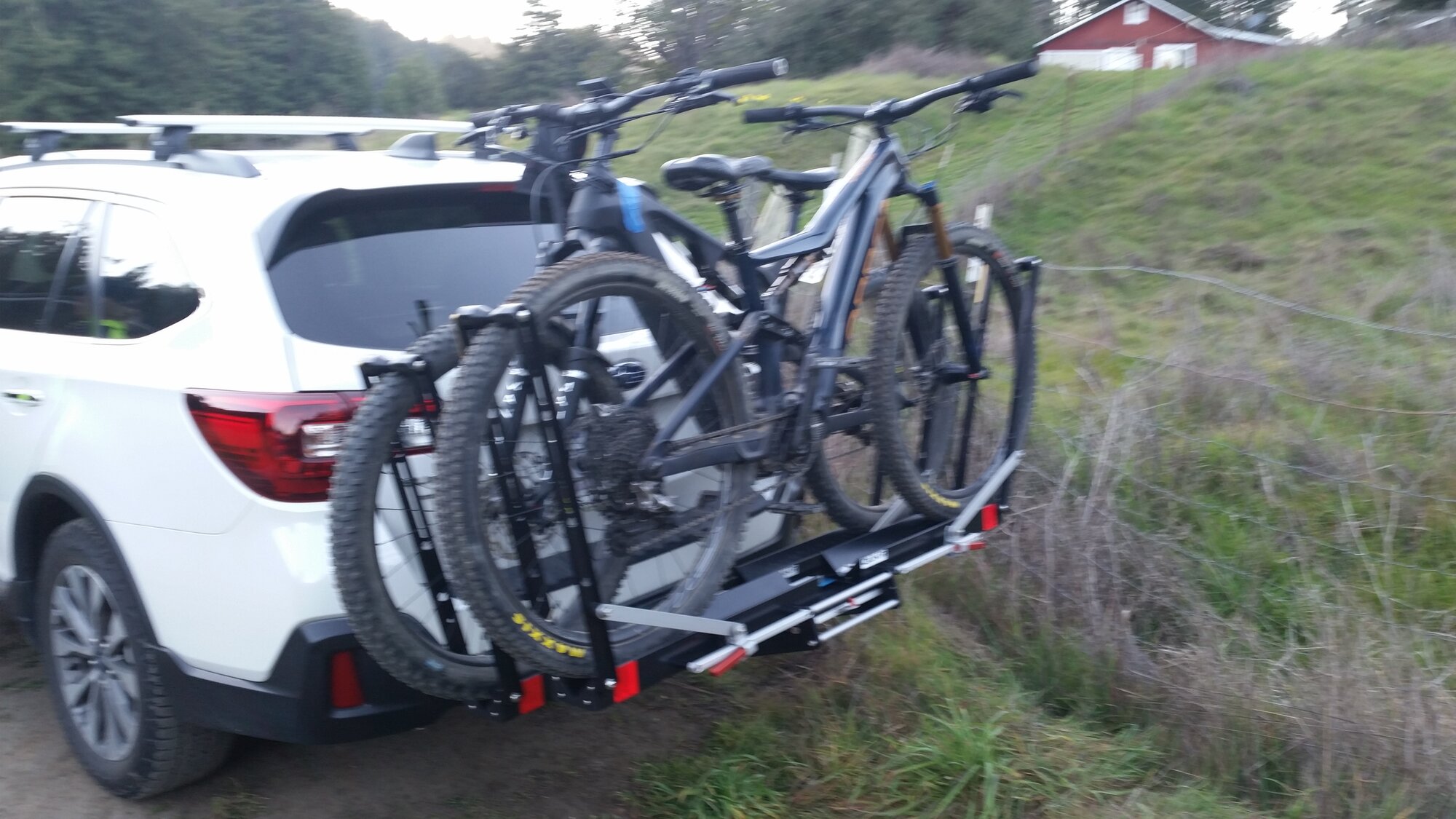

I have the OneUp Super Duty double rack and it is OK with the modifications I needed to make to have my license plate visible and to attach a motorcycle ramp for loading very heavy 70 lb. bikes (this is where walk mode is very helpful). If it gets stolen I will replace it a different rack.

I traded in my SUV with Stealth hitch and sold my 1 Up Super Duty w the extra rack. I am getting a new 1.25 hitch on my new e-car and am going to buy the 1up Quick rack 1.25 to carry my Sport. 1 UP is rock solid...

The only racks that have integrated ramps are the ones from Thule and Yakima. The 1up has an available ramp but it is short, prevents using their license plate holder, it does not securely attach to the rack and flips over with wide tires, and as it is only 3" wide it does not work with wider fat tire bikes. I bought a Motorsports folding motorcycle ramp for my 1up Super Duty double rack.

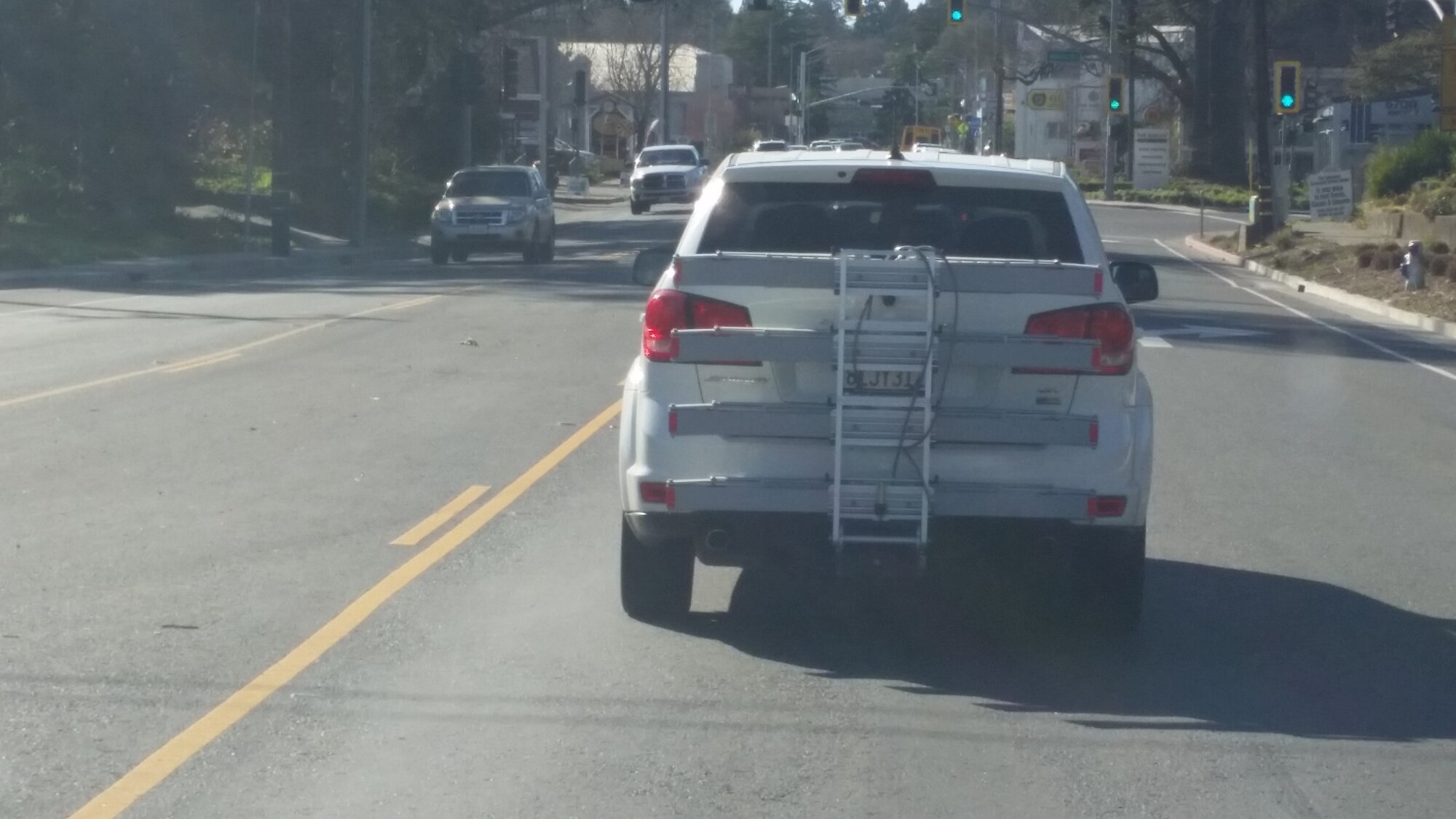

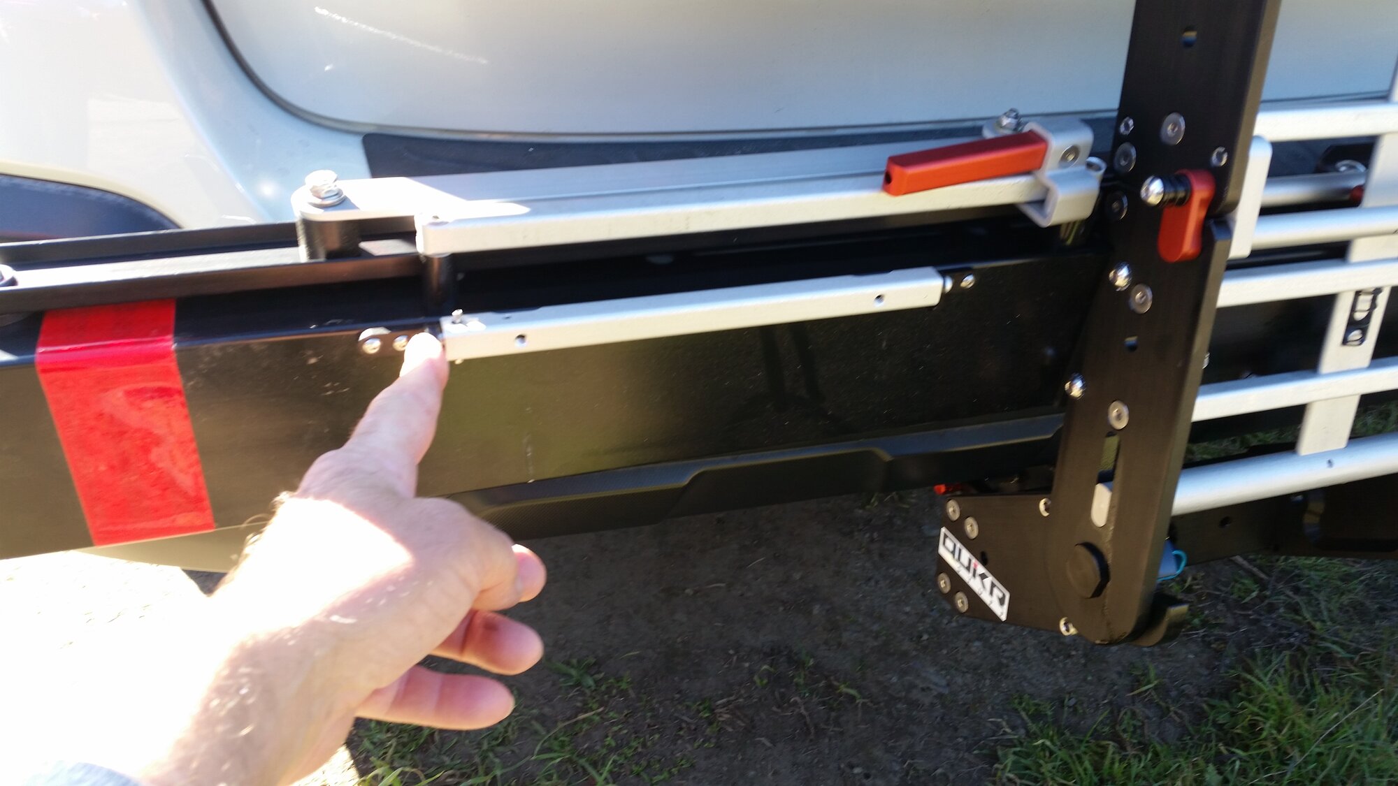

I was following this car with what I believe is the One Up rack. The whole time I'm watching the four bike rack sway back and forth from side to side. And I was thinking of some of the other features the QuikrStuff rack has. They seem to be a big plus in my mind - I know some people here have one coming - including a handle to crank up internal tension in the hitch so that your rack doesn’t move back and forth.
You can barely make out an out of focus blue handle between the bike tires. That's what you turn to tension up hitch tongue in reciever.
