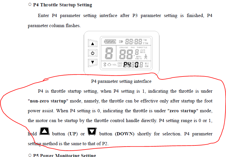

On my wife's controller (KT-LCD7):
So I googled KT-LCD5 and got to THIS pdf.
It looks like it has the same options - but of course, I am guessing on your setup a little bit.
Good luck
