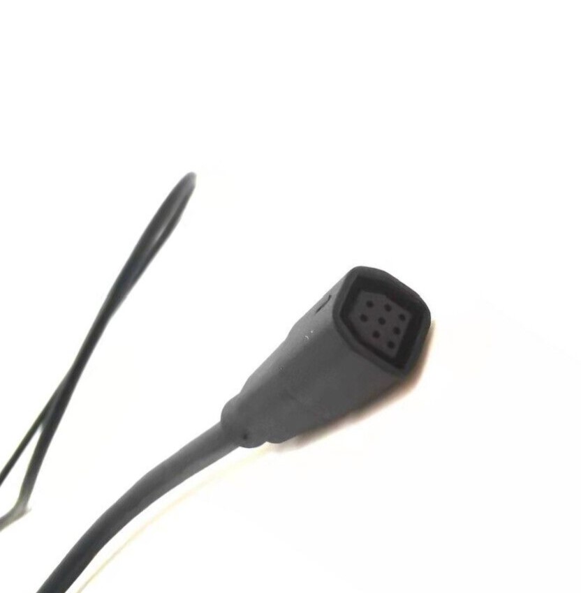

I am also looking for the proper cable to install the throttle on my Current.

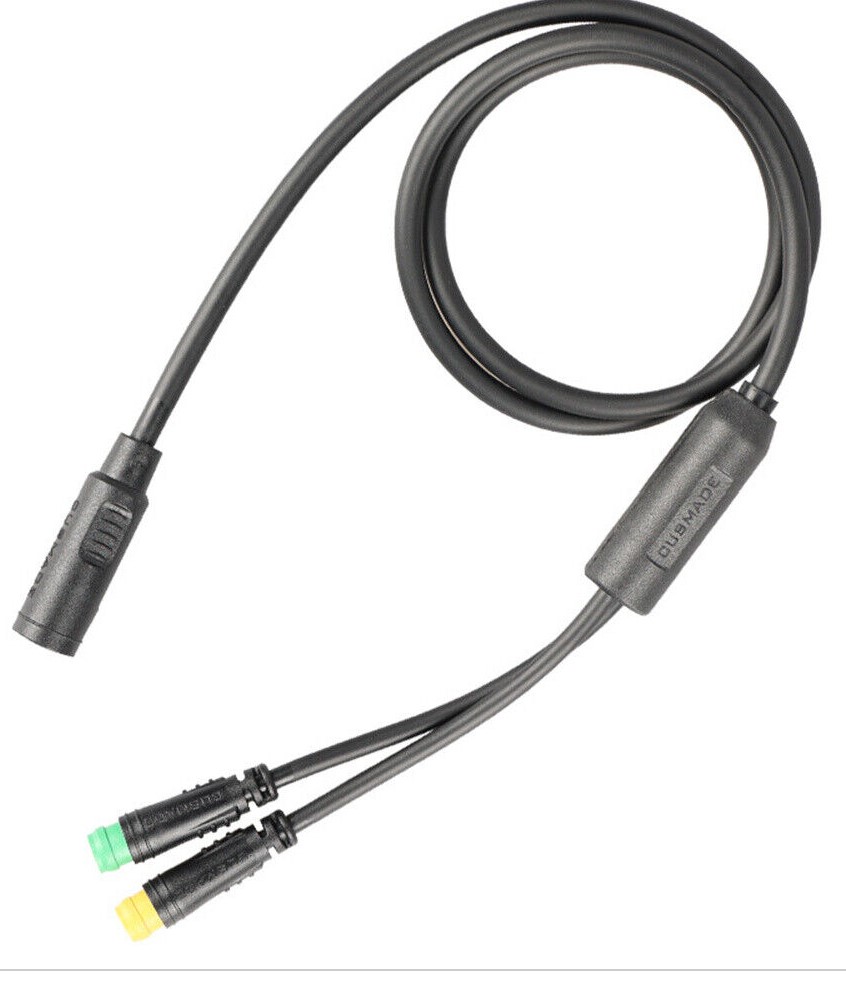

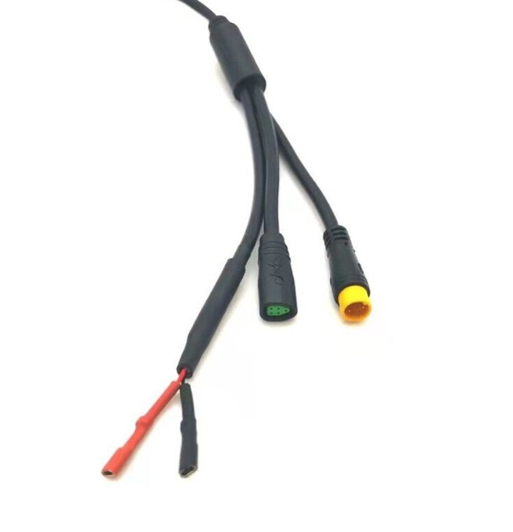

What I found on ebay are two cables:
- one has the apparently proper connector for the controller but an incorrect green one for the display. It also has 2 wires for a light but that could be cut off.
- the other one is the cable for the BBS02 with proper connectors for display and throttle but the wrong one for the controller.
Is it just too easy to think I could cut and splice them, after first establishing the correct pinout for both ends with a multimeter?

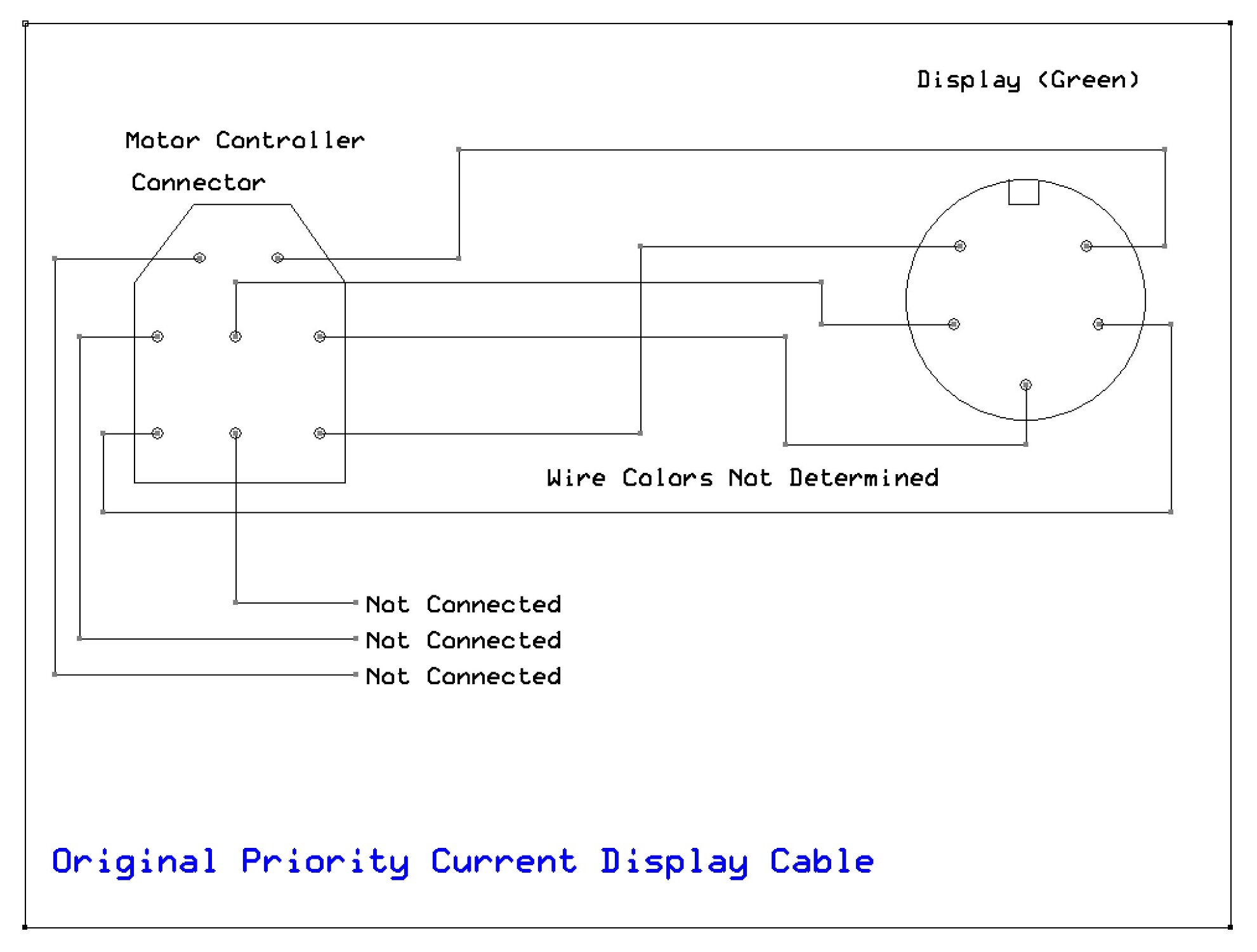

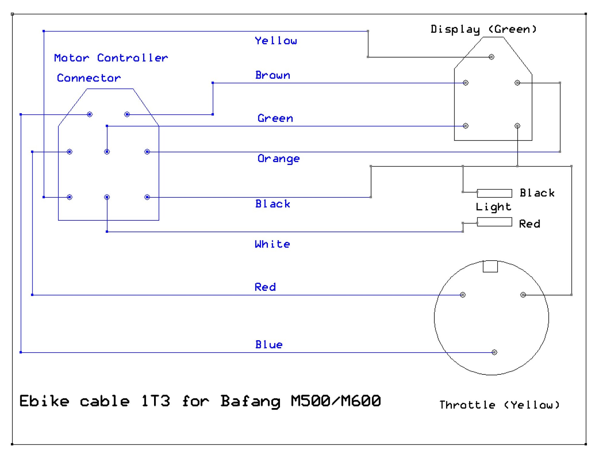

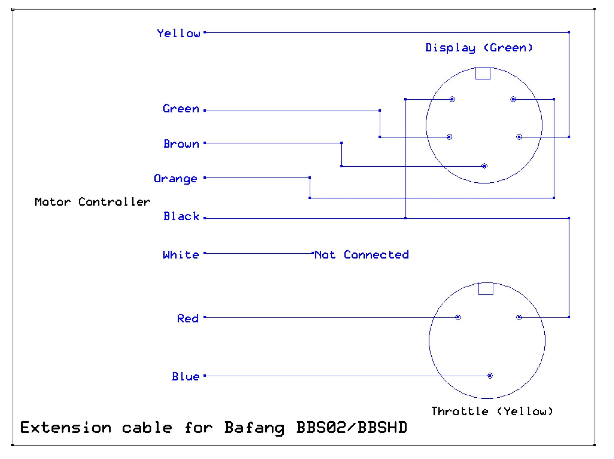

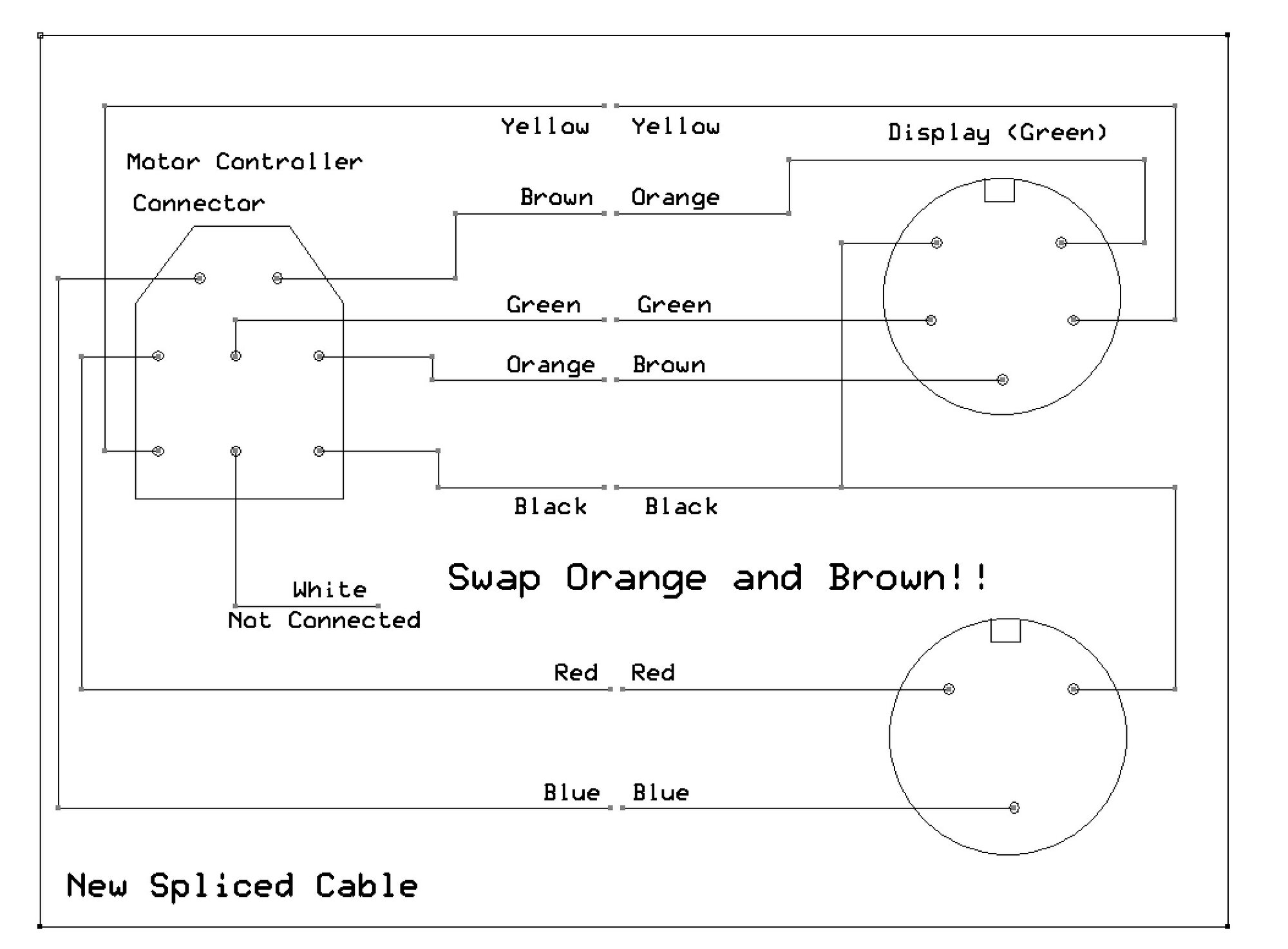

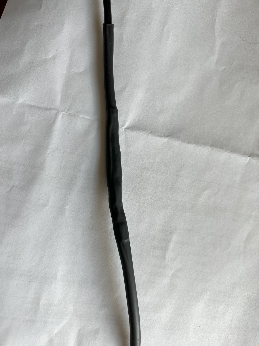

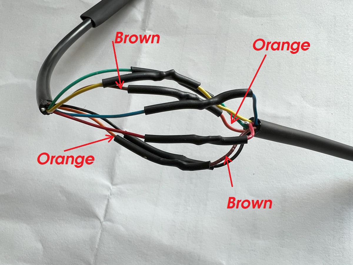

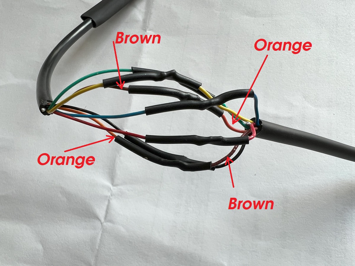

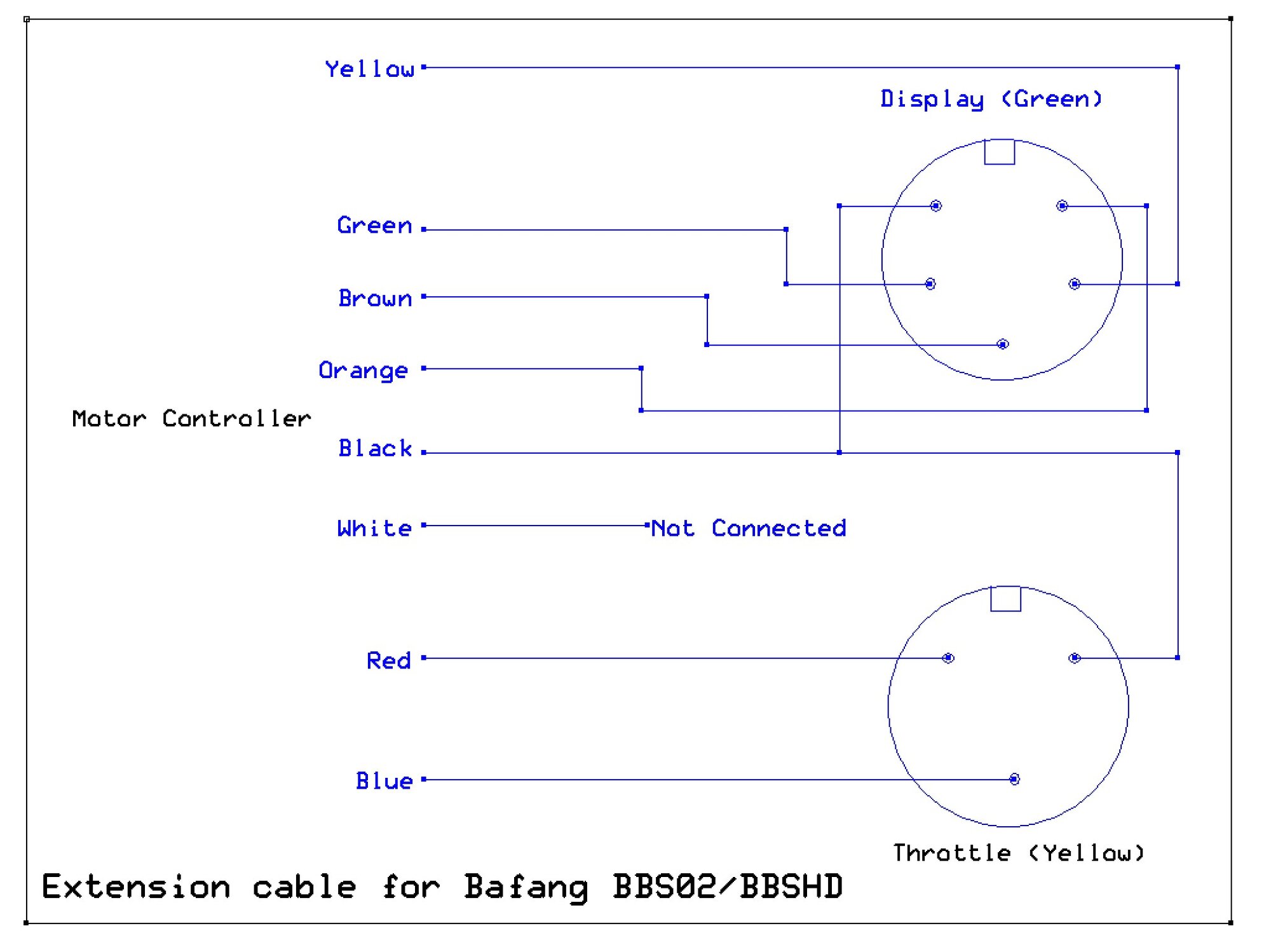

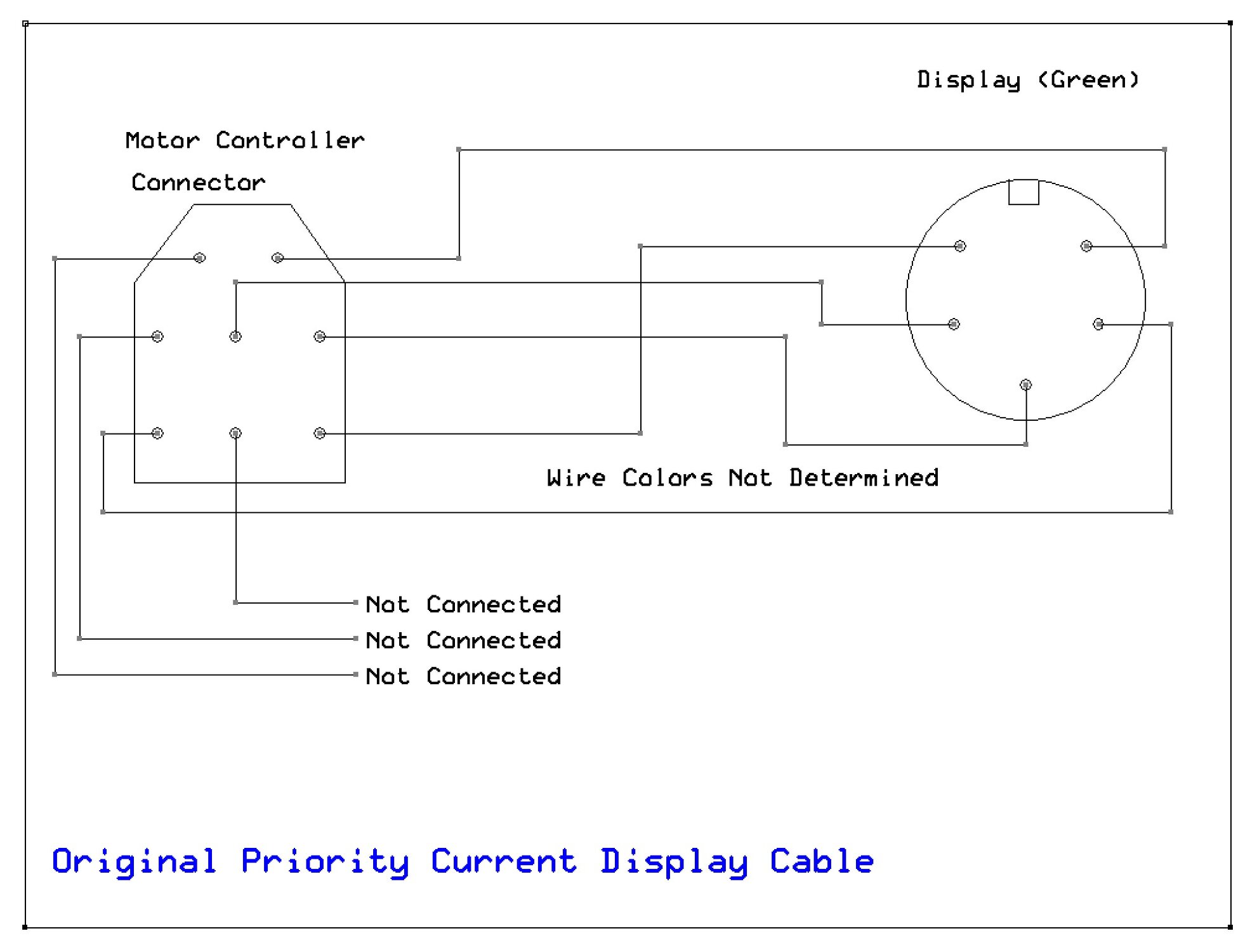

So, I did get it to work. I checked the pinout of both new cables and the existing Priority cable and sketched the wiring, see below.

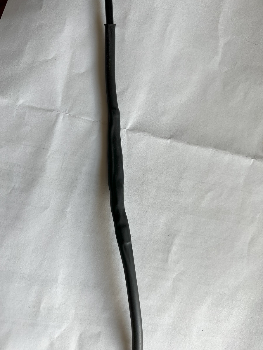

I spliced the 2 cables together, plugged it in and....it works. Display still operating and the throttle make the rear wheel spin.
That was maybe an hour with the multimeter and another hour to document and splice carefully.
Now comes the difficult part, to route it through the frame according to the YouTube video in the first post.

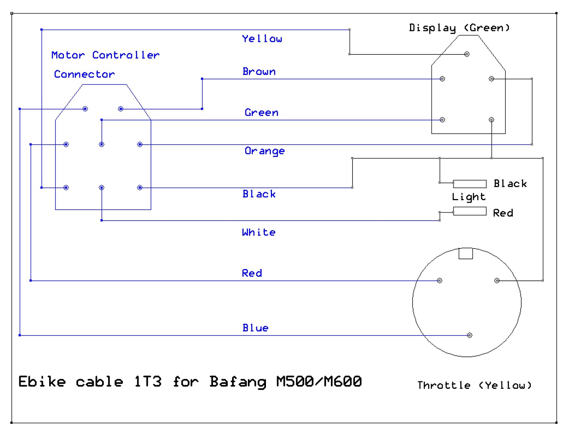

This is the wiring of the cable with correct motor connector but wrong display connector (https://www.ebay.com/itm/275802118356). I used only the motor side.

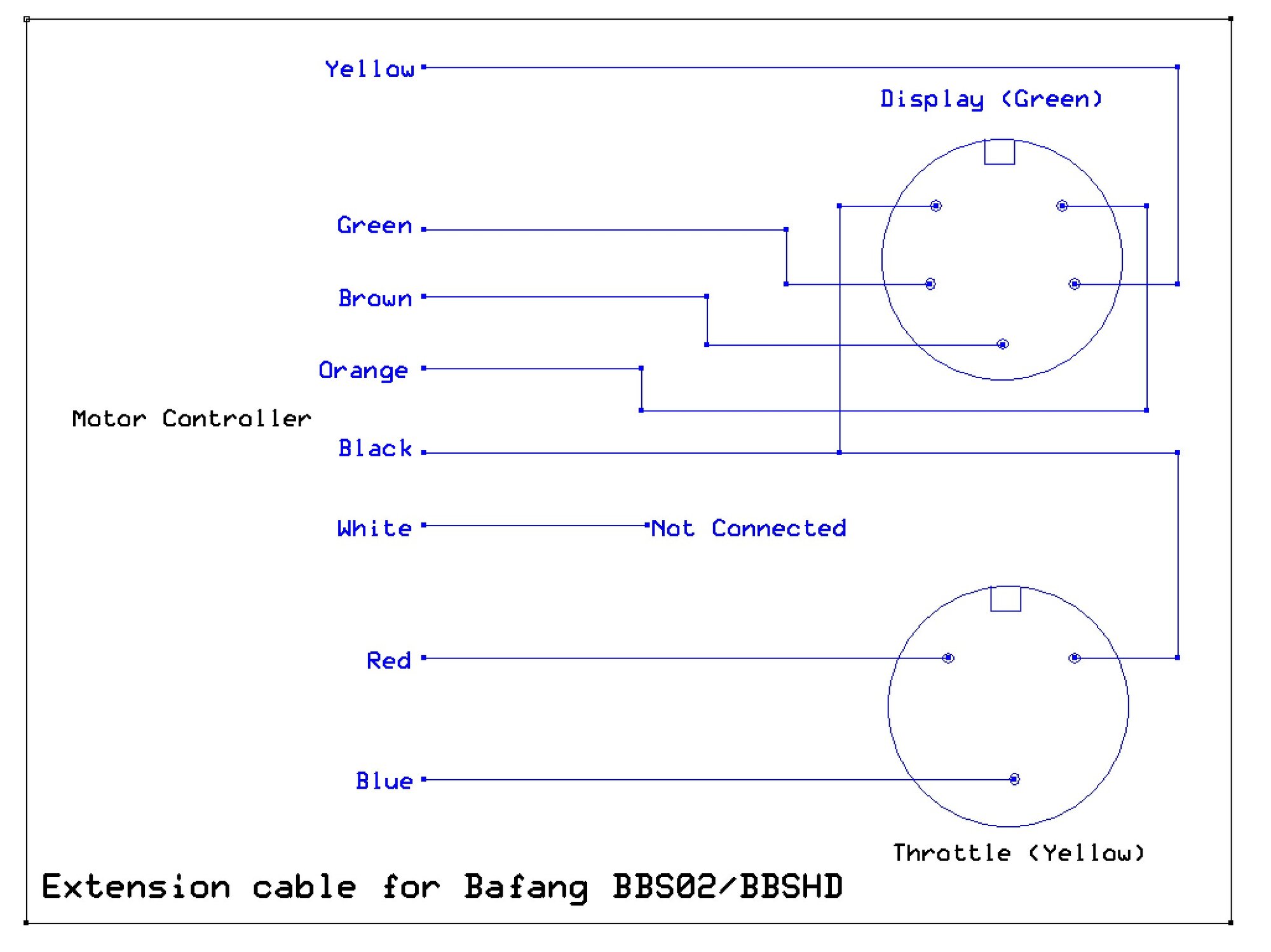

This is the cable with correct display and throttle connector, but wrong motor connector (www.ebay.com/itm/334811815937). I cut off the motor connector.
This is the original Priority Current display cable. I made sure, the motor/display connection was faithfully copied.

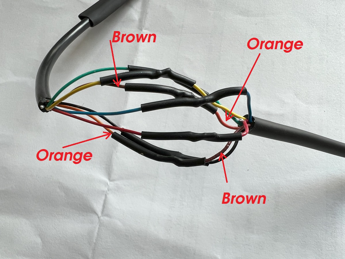

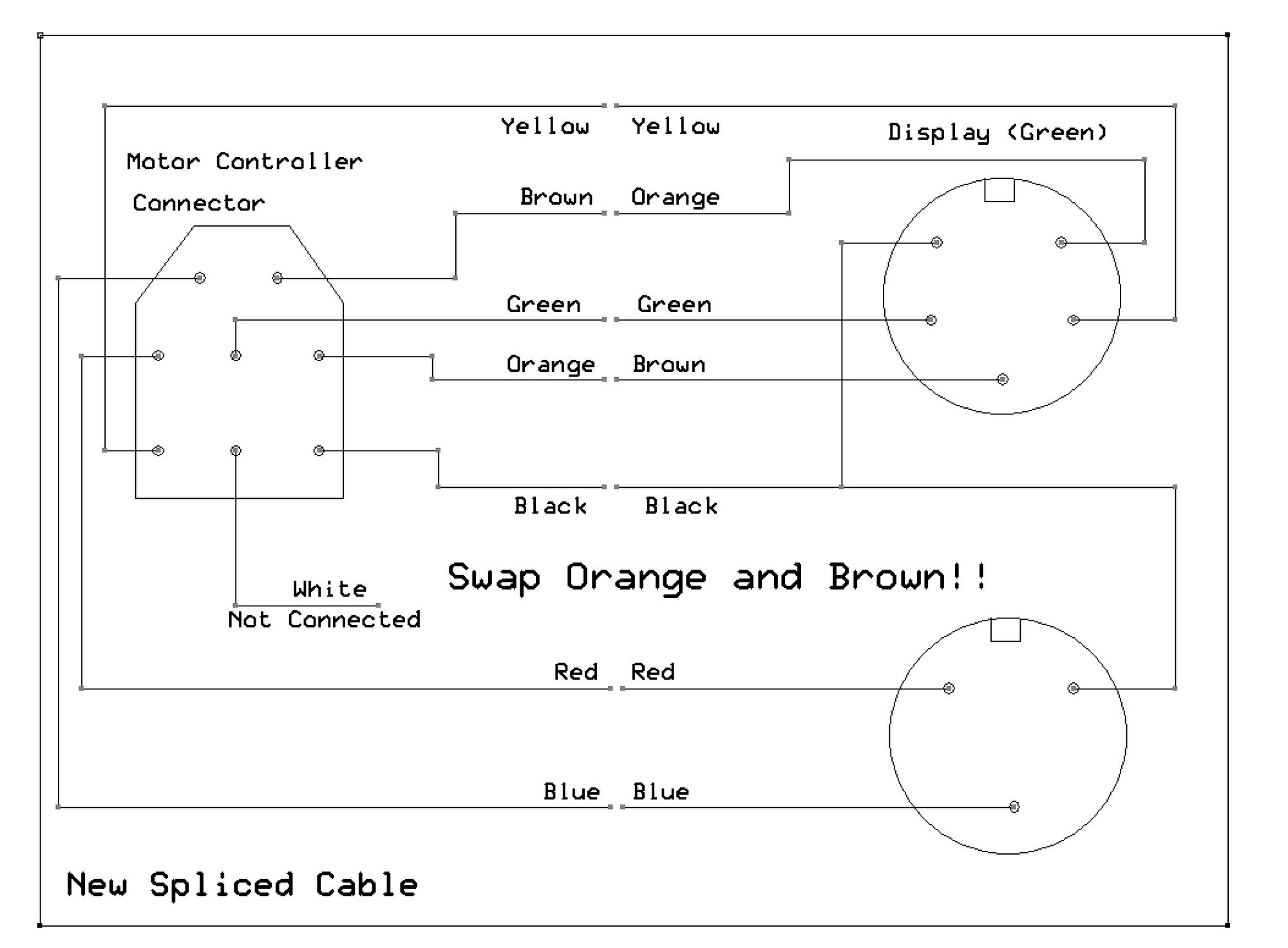

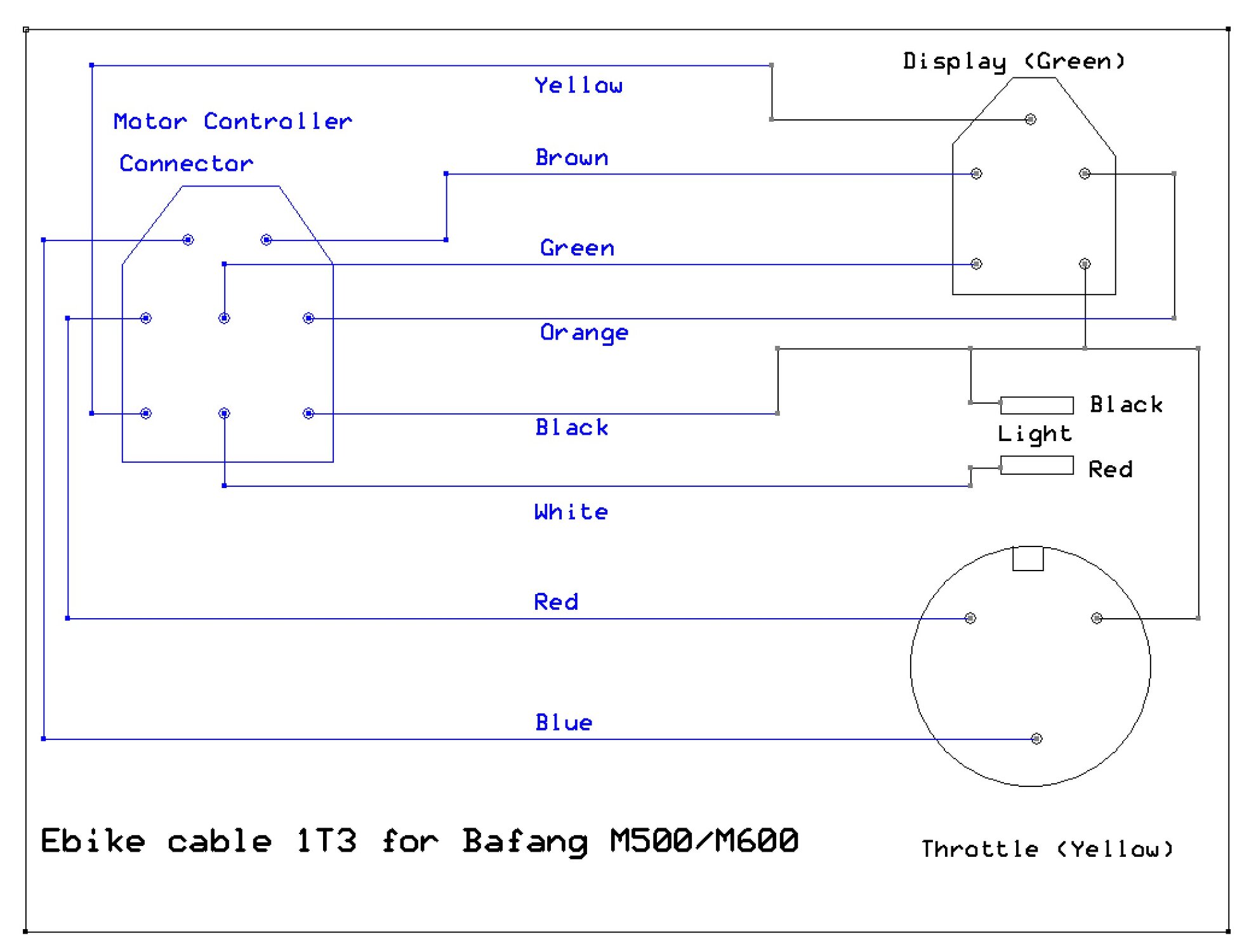

Finally, the wiring of my newly spliced cable. Most wire colors match, however I had to swap the orange and brown wires.
View attachment 156394View attachment 156395View attachment 156396

Jerry this is just fantastic--thank you for taking the time to create the drawings so we can all benefit! Curious if you considered splicing into the green display connector (instead of the controller connector), or if you looked for an adapter for either?
...... Curious if you considered splicing into the green display connector (instead of the controller connector), or if you looked for an adapter for either?
Yes I could have done that but then the splice would have been outside exposed to weather and I would have had to cut off the two light wires. But definitely doable and only 5 wires to splice instead of 7.
