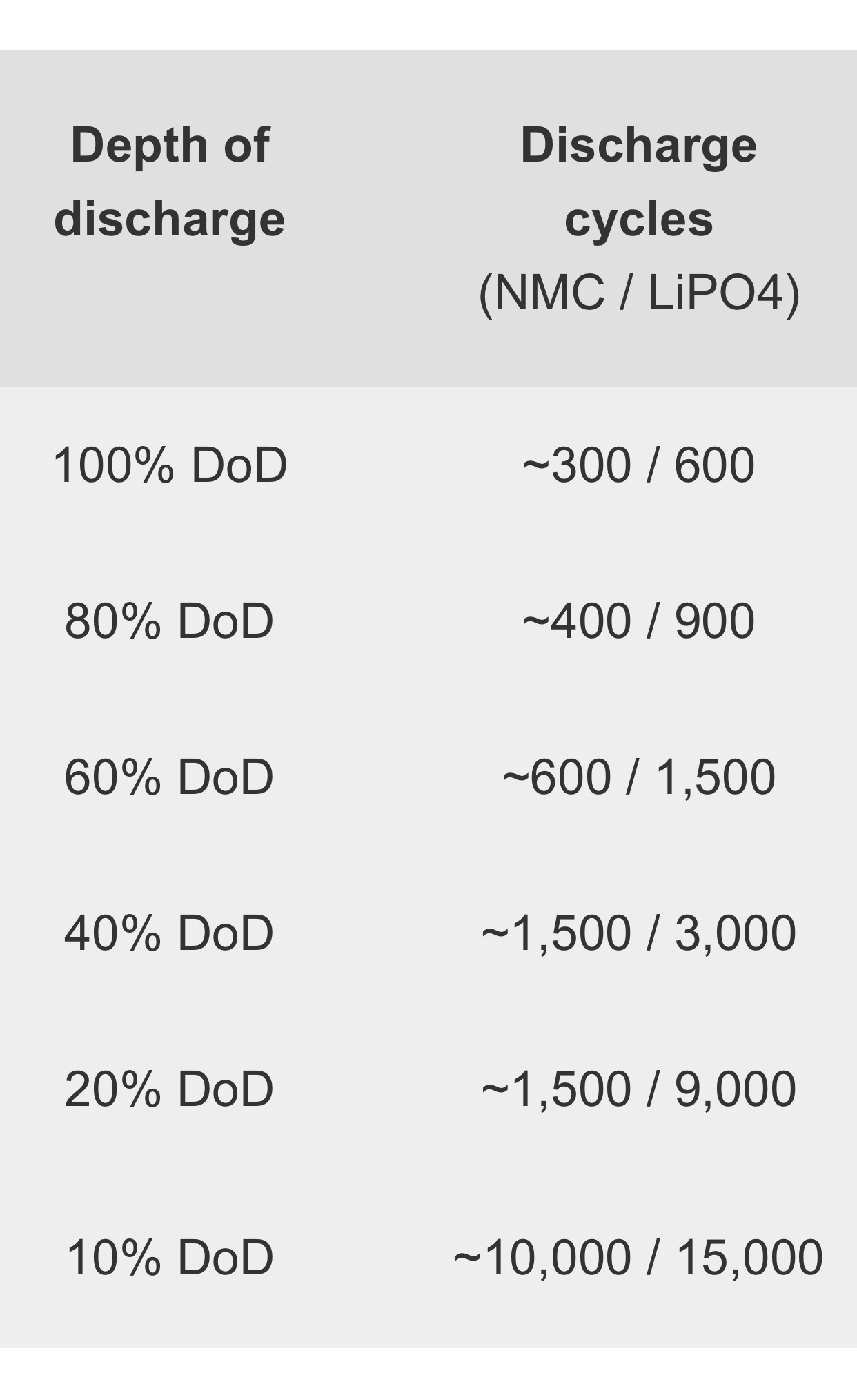

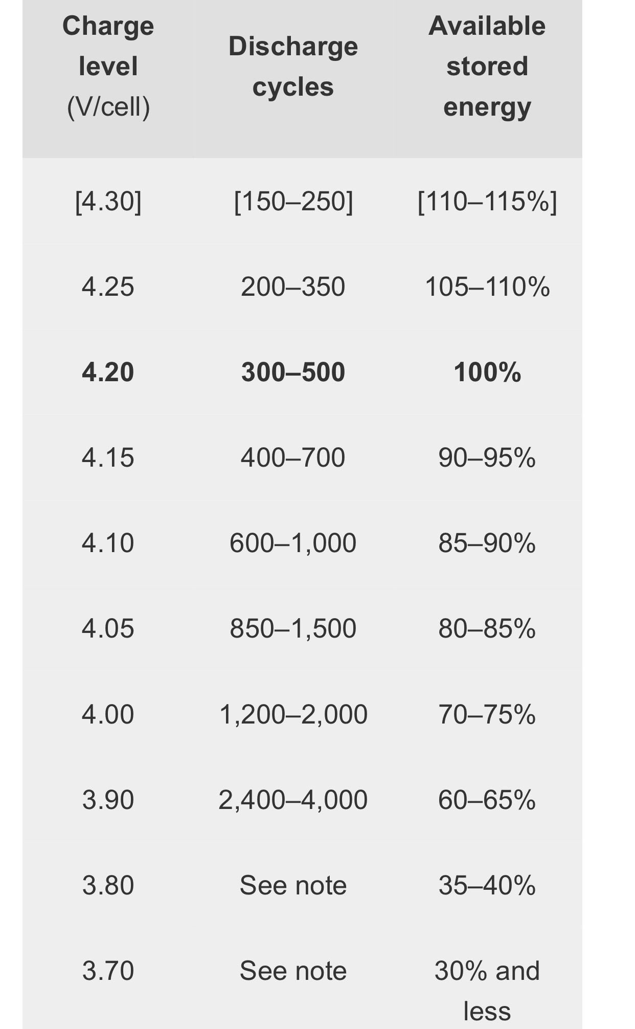

I completely disagree with that statement. It's well known that with LiPo batteries a sustained full charge or deep discharge will reduce the lifespan of the battery. It is true that they don't have a memory effect. I think general consensus is to avoid discharging a pack below 20% and above ~80%ish to prolong pack life and get the most cycles from it.
Really good info here: http://batteryuniversity.com/learn/article/how_to_prolong_lithium_based_batteries
Cliffs Notes:
Most Li-ions charge to 4.20V/cell, and every reduction in peak charge voltage of 0.10V/cell is said to double the cycle life. For example, a lithium-ion cell charged to 4.20V/cell typically delivers 300–500 cycles. If charged to only 4.10V/cell, the life can be prolonged to 600–1,000 cycles; 4.0V/cell should deliver 1,200–2,000 and 3.90V/cell should provide 2,400–4,000 cycles.
In terms of longevity, the optimal charge voltage is 3.92V/cell. Battery experts believe that this threshold eliminates all voltage-related stresses; going lower may not gain further benefits.
Similar to a mechanical device that wears out faster with heavy use, the depth of discharge (DoD) determines the cycle count of the battery. The smaller the discharge (low DoD), the longer the battery will last. If at all possible, avoid full discharges.
Cliffs Notes:

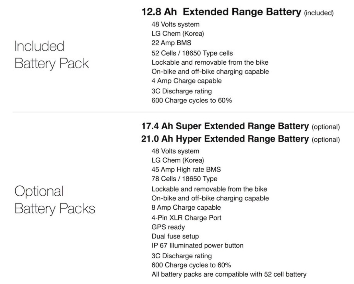

It sucks a little to only get 13 Ah out of a 20 Ah battery but then again its $1400 to replace and if I baby it like that it "should" last for years and years.
I would just follow the advice in the CrossCurrent owners manual and recharge the battery after every use, ready for the next ride. You don't want to run low on power on the way home. I'm sure Juiced Bikes and the company that makes the batteries feel confident in advising people to do that, otherwise they wouldn't have it in the manual. It's true that maintaining lipo batteries continuously on a high charge shortens battery life. But that's not what you are doing if you are charging and discharging every day.
Obviously people are free to do whatever they want but I still think that's bad advice. Juiced website says it's battery packs are good for 600 charges to 60%. How many less charges do you think you'll get from 100% charges. Just look at my photos in above posts. This data isn't for storing a battery at 100%, it's simply charging it to that level.
