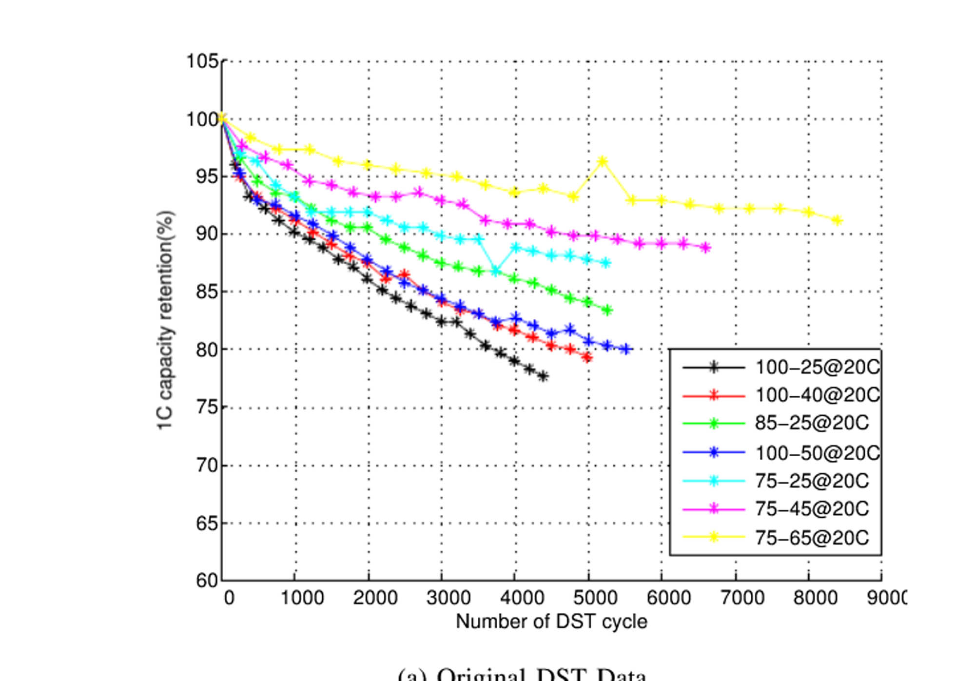

For you scientist types, here's the paper that studied the effects of charging.
Let's look at one of the more famous charts from this paper. They show the loss in capacity for various discharge cycles, ranging from 100%-25% down to 75%-65%. Looks like people like me who do 100%-50% need to get onboard.
But look at the horizontal curve, At 1000 DST's, which is a discharge cycle, the 100-50% crowd is down to 91% capacity. The 85-25% advocates are at 93% at 1000 cycles.
It's like three years of riding 6 days a week to get 1000 cycles. That 2% difference isn't worth it to me.

The catch is in the Y-axis.
It is at 1C. Everything works super well at 1C and 20'C
But very few E-bike riders deplete their fully charged battery in 1hr. Most people do it 0.2C and at that point, the effects are a LOT different.
This is why you should look at several factors not just discharge at 1C and 20'C.
View attachment 121664But look at the horizontal curve, At 1000 DST's, which is a discharge cycle, the 100-50% crowd is down to 91% capacity. The 85-25% advocates are at 93% at 1000 cycles.
