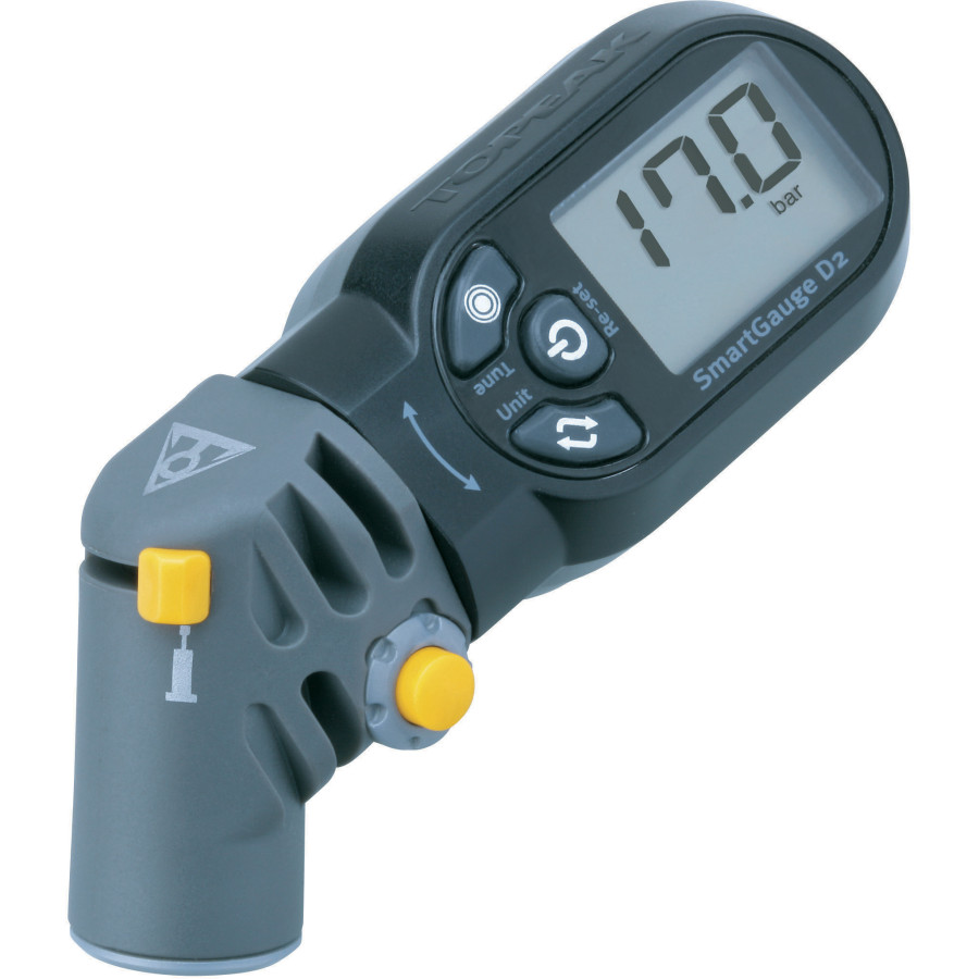

I use this gauge, works on presta and schrader, a little pricey. Work great on car tires as well
I did check this gauge against a friends longacre pro precision 4 gauge (used in motorsports) and it read the same (with 1/2 psi)

My 20 year old accugauge was 2psi low (not surprising). My cheapest floor pump gauge matched this digital gauge within 1 psi. My more expensive floor pump gauge was off around 5psi.

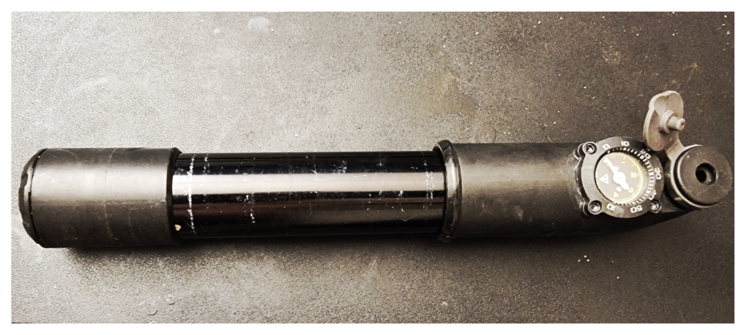

Just by comparing the read-out with the large pump's manometer. The MTB mini-pumps are quite accurate at the low pressure end because MTBers typically ride at low inflation, which is acceptable for tubeless wheels. It is, for instance, allowed to run a 2.6" tubeless tyre at as low as 20 psi.
For me, it is not a rocket science. You need to know the low value (as not to pinch the inner tube) and the high value (as not to blow the tube). For my Vado, and 1.75" Smart Sam tyres (tubed setup), I ride at 40 psi in rough terrain (sand, forest with tree roots) or at 60 psi when I expect a long trip on asphalt.
No seriously Stefan, I've never seen such a pump. Just a link, please.
MTB Mini-Pump
The feature of MTB mini-pumps is their capability to deliver huge volume of air fast at the cost of lower maximum pressure than floor pumps can deliver (60 psi max here). I had a nasty puncture of my 2.6" tubeless off-road tyre out in wilderness last Summer. A bit of quartzite made so large hole the sealant could not repair it initially. I rode a mile or so back to a camping place and waited (thinking how to come out from the situation). Meanwhile, the sealant worked (I was even not aware of that). Yet I took the pump from my backpack and reinflated the tyre - many strokes were needed but re-inflation was surprisingly fast. Eventually, I could continue the trip :)

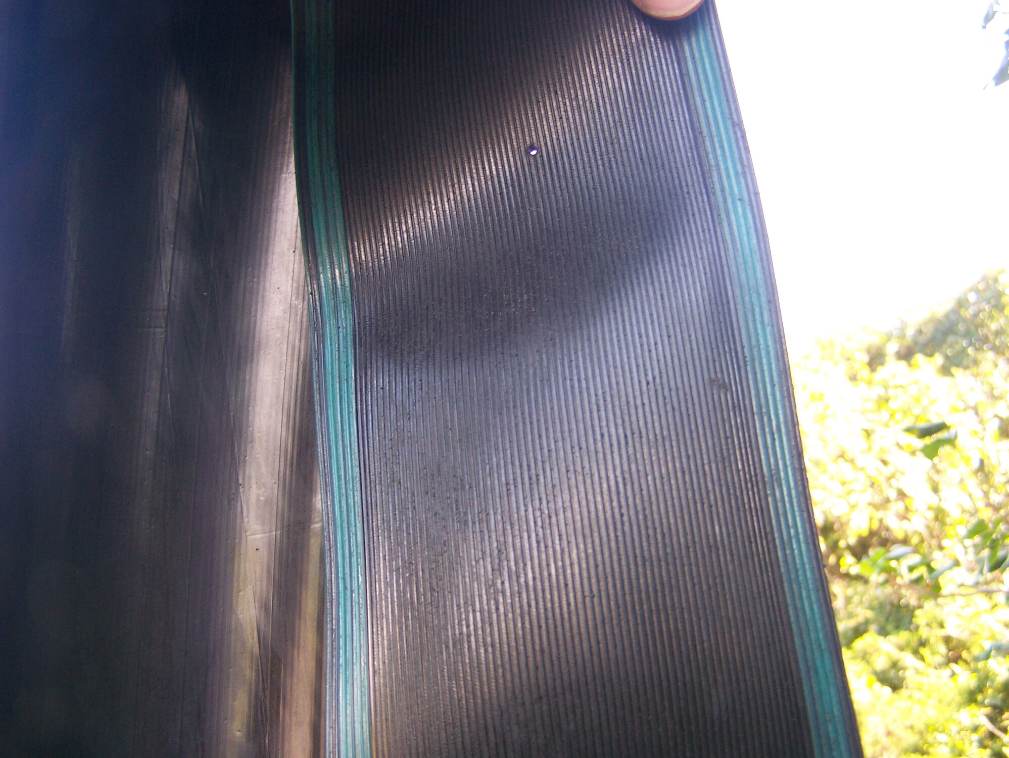

This here's a story about the time I did "The ole hand squeeze tire pressure guage it's good enough" test out on the road.......10 miles from Homebase. And no telly phone cause I just don't carry one. I bet you can see where this is going?

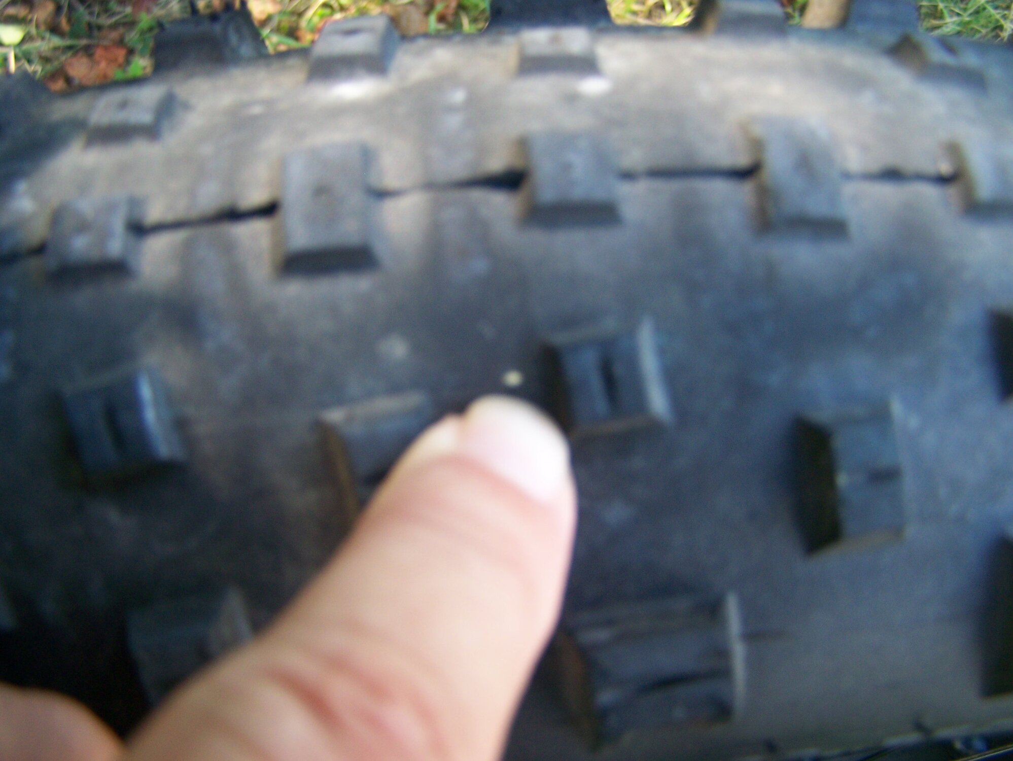

10 miles from home and I catch two quarter inch thorns that go right through my rear tire, through the Mr Tuffy Tire Liner and puncturing the tube. As this is old hat, just a simple tire patch job and I'll be one my way. Fatal Mistake Number One: No cell phone. Fatal Mistake Number 2: I left my spare, new tube at home, too. Probably next to the cell phone.....
Here's one of the two blasted devils right here. I've had back to back to back days catching thorns like this and it's usually on the Canal Towpath trail I ride on, closer to home. This time, I caught it on the shoulder of a road.

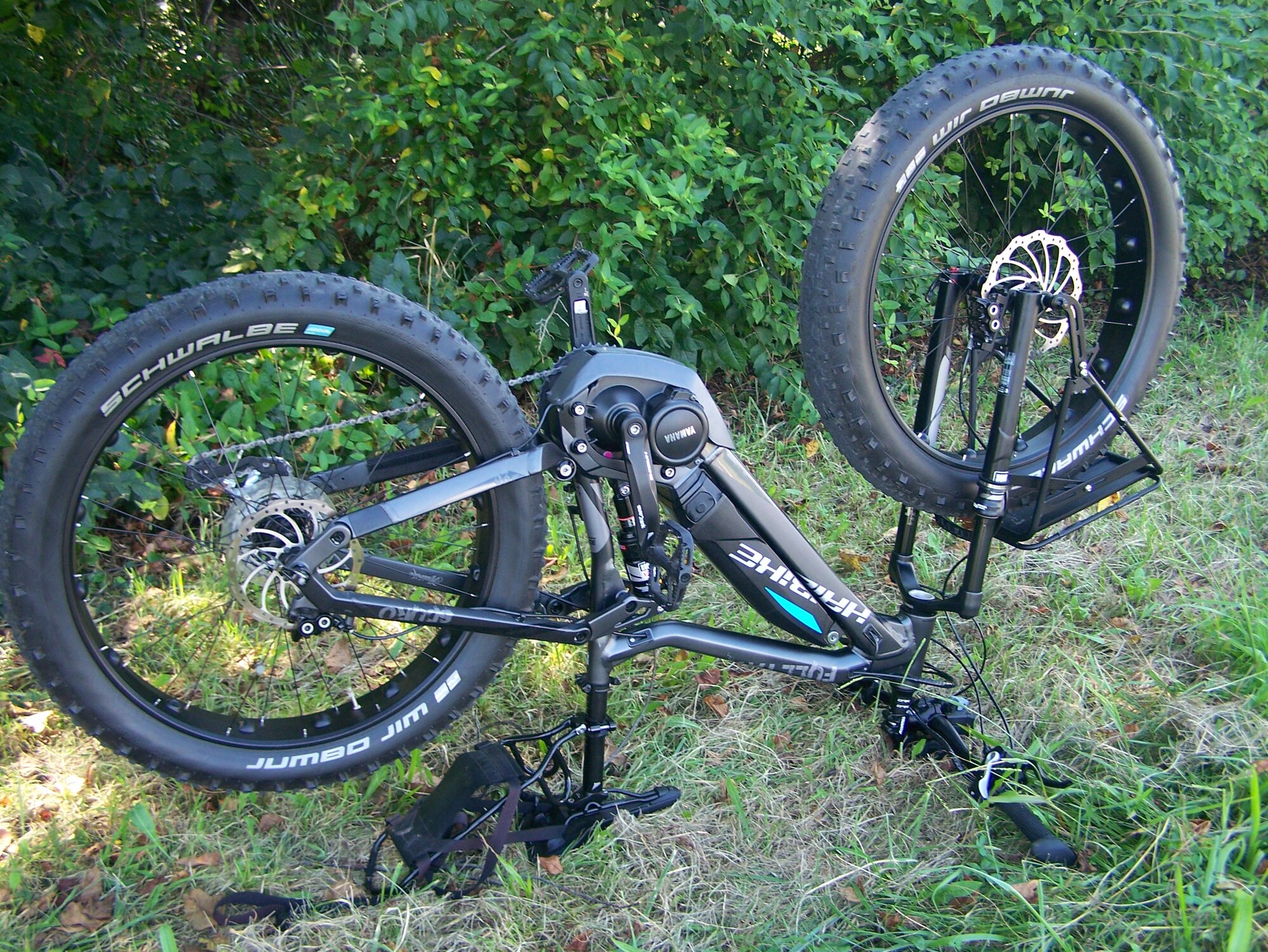

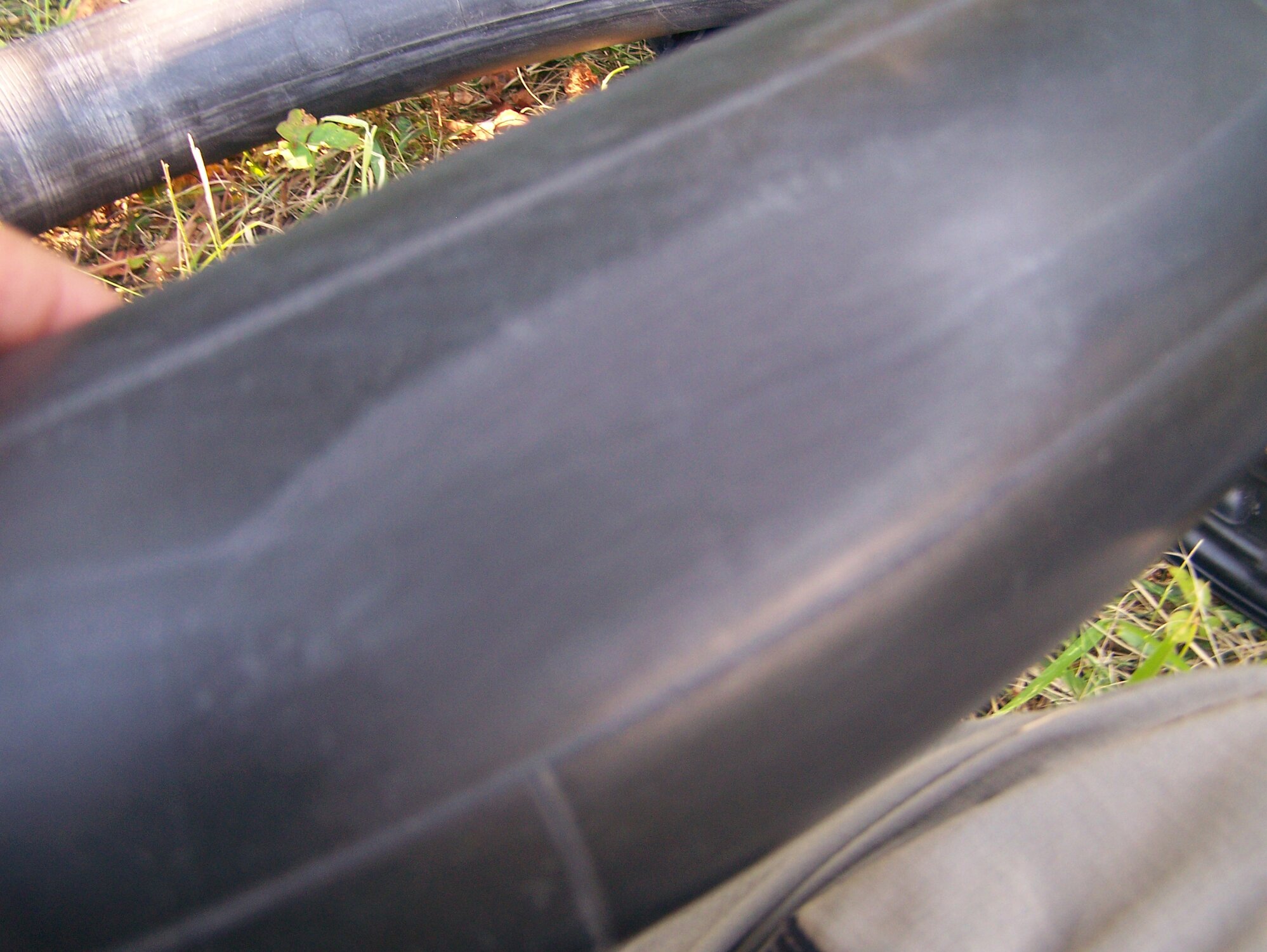

First order of business, take off any rear bags, your ebike drive display and flip the bike on it's saddle and handlebars. A spare rag is handy to protect your expensive saddle if you are in dirt or concrete. Remove tire and tube, then set about trying to find the near microscopic pin hole. Prep with a piece of sandpaper in your roadside flat repair kit.

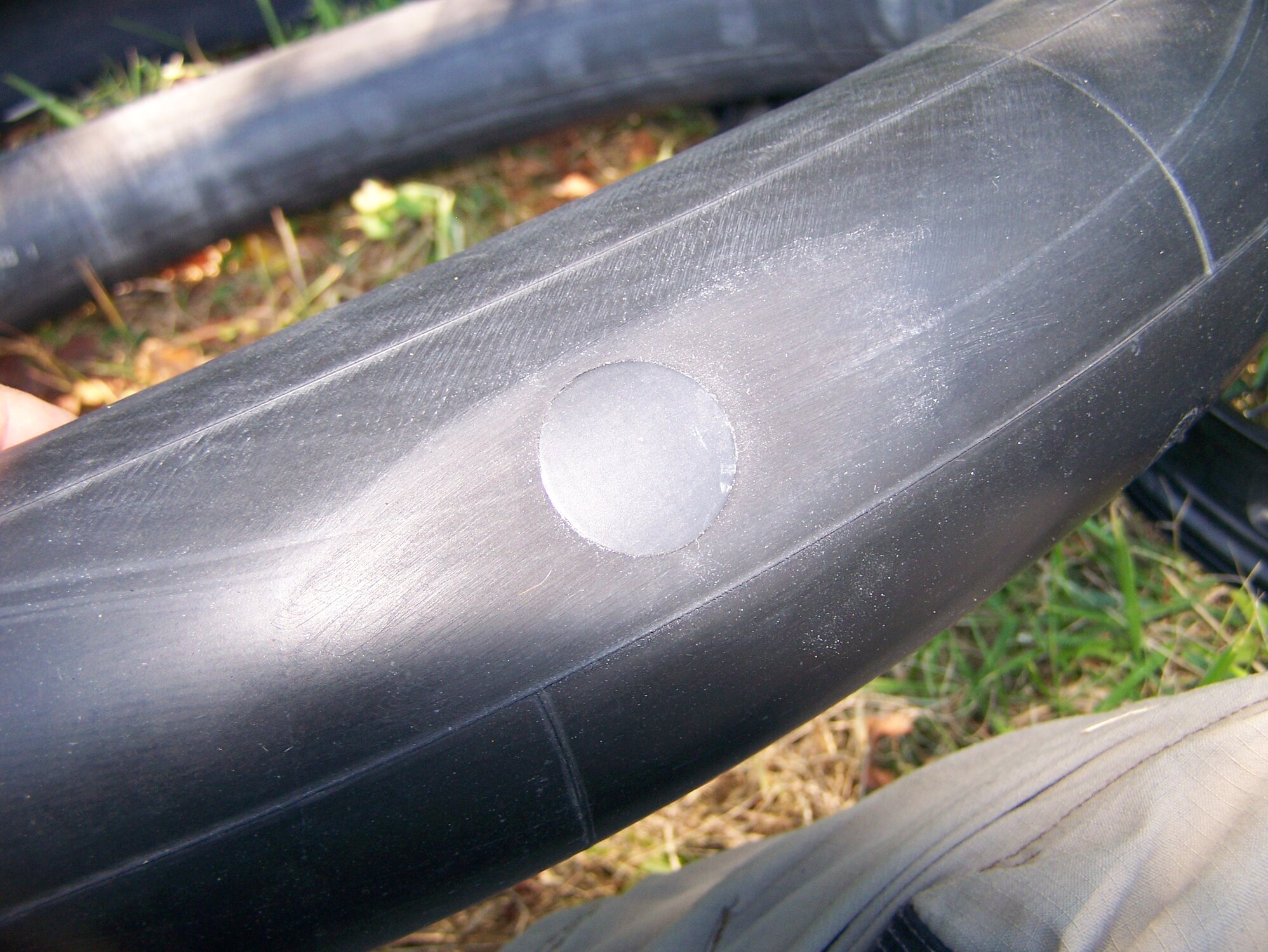

Over the years of fatbiking and e-bike fatbiking, I've had alot of great luck with the stick-on tire patches. They hold up nicely but keep in mind if you are constantly raising and lowering your tire pressures to meet the road conditions in front of you (hard asphalt or deep sugar sand); then you might be better off with a patch and glue kit.

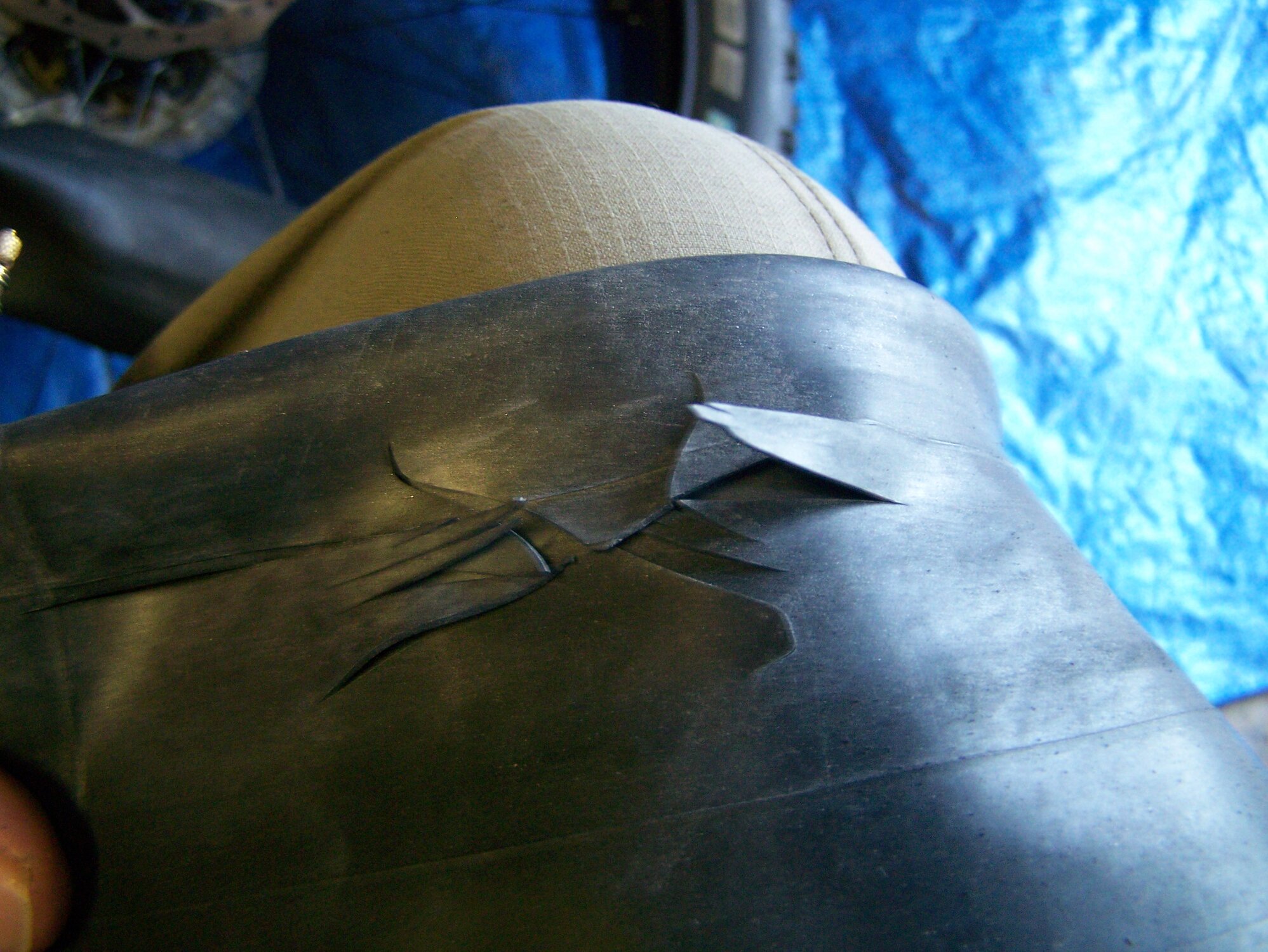

Fatal Error Number 3: I reassembled everthing and pumped up my rear tire. But instead of carrying my 0-30 pound AccuGage tire pressure guage, (I left it home-Fatal Error Number 4); I just used the "Ole Hand Squeeze Tire Pressure Guage" to what I guestimated to be somewhere between 25 and 30 psi (max pressure on a Schwalbe Jumbo Jim tire is 30 psi. Then I set off. Early Sept sunny Sunday road temperature had to be over 100 degrees.......and with a guestimated tire pressure squeeze test rising within the tire, well, the tire let go with the sound of a 12 guage shot gun. The tire was damaged beyond repair as the kevlar bead was damaged. And so was the tube. Which was perfect, being I had no spare tube, let alone a spare tire. The good news is, I was a 4 mile walk to my niece's home with the great fortune of her husband being home. He felt pity on me and was able to transport me back to Homebase.
Aftermath of guestimating my tire pressure instead of just using my tried and true AccuGage. Never again, is the learning lesson for me. YMMV and good luck to you and you and you!!

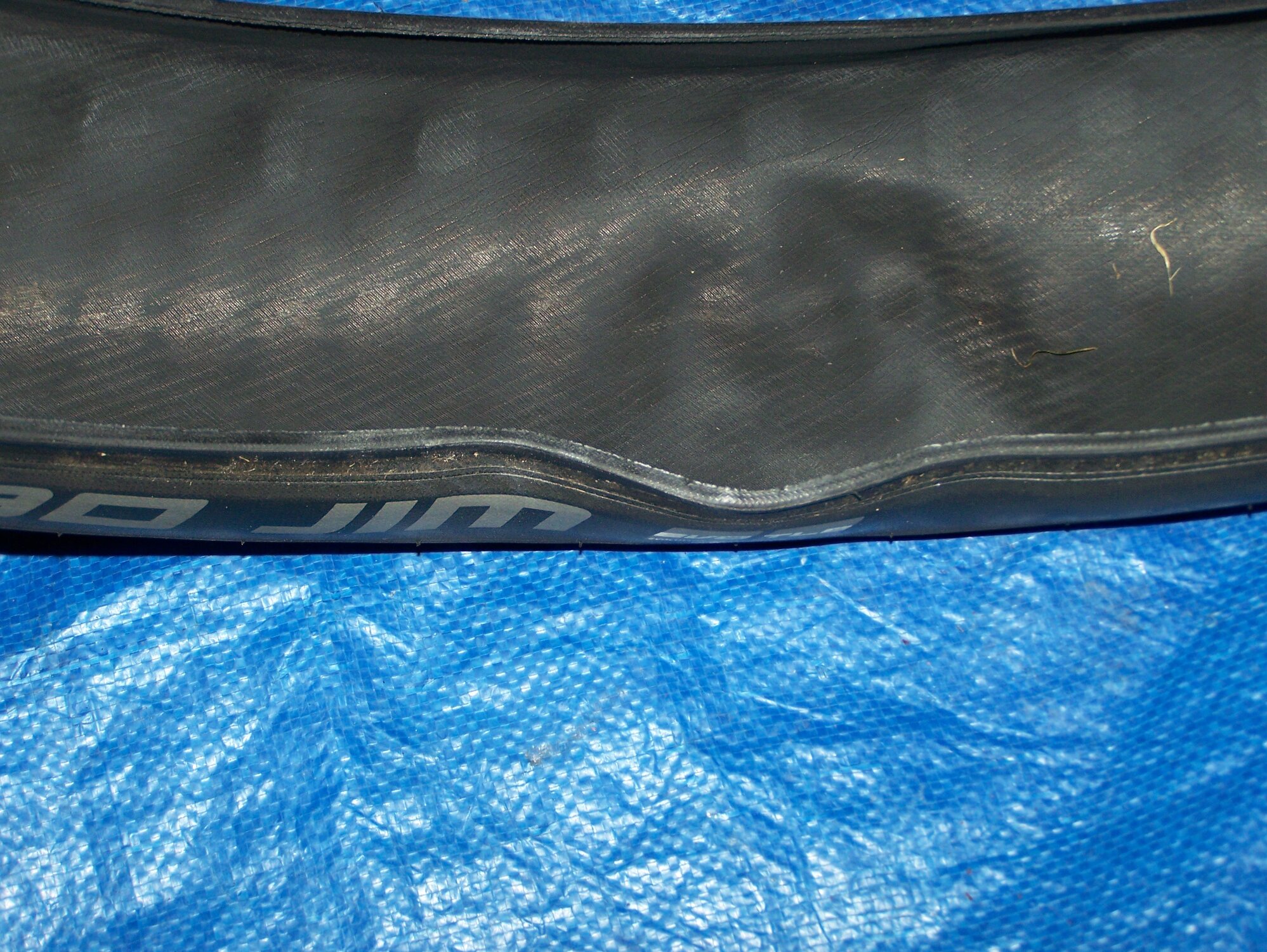

Here is the spot where the tube exploded; destroying the tire's kevlar bead in the process. This tire could never be trusted to seal against the rim ever again.
Thanks for sharing! How the heck is your bike so clean after 10 miles on a trail?
BH-That run was all on asphalt shoulders of local, county roads. Anyways, in the warm wx months, I make it a point to spritz the bike down with auto detailing spray and wipe her down, gives me some good bike bonding time, looking for loose components and what have you!
