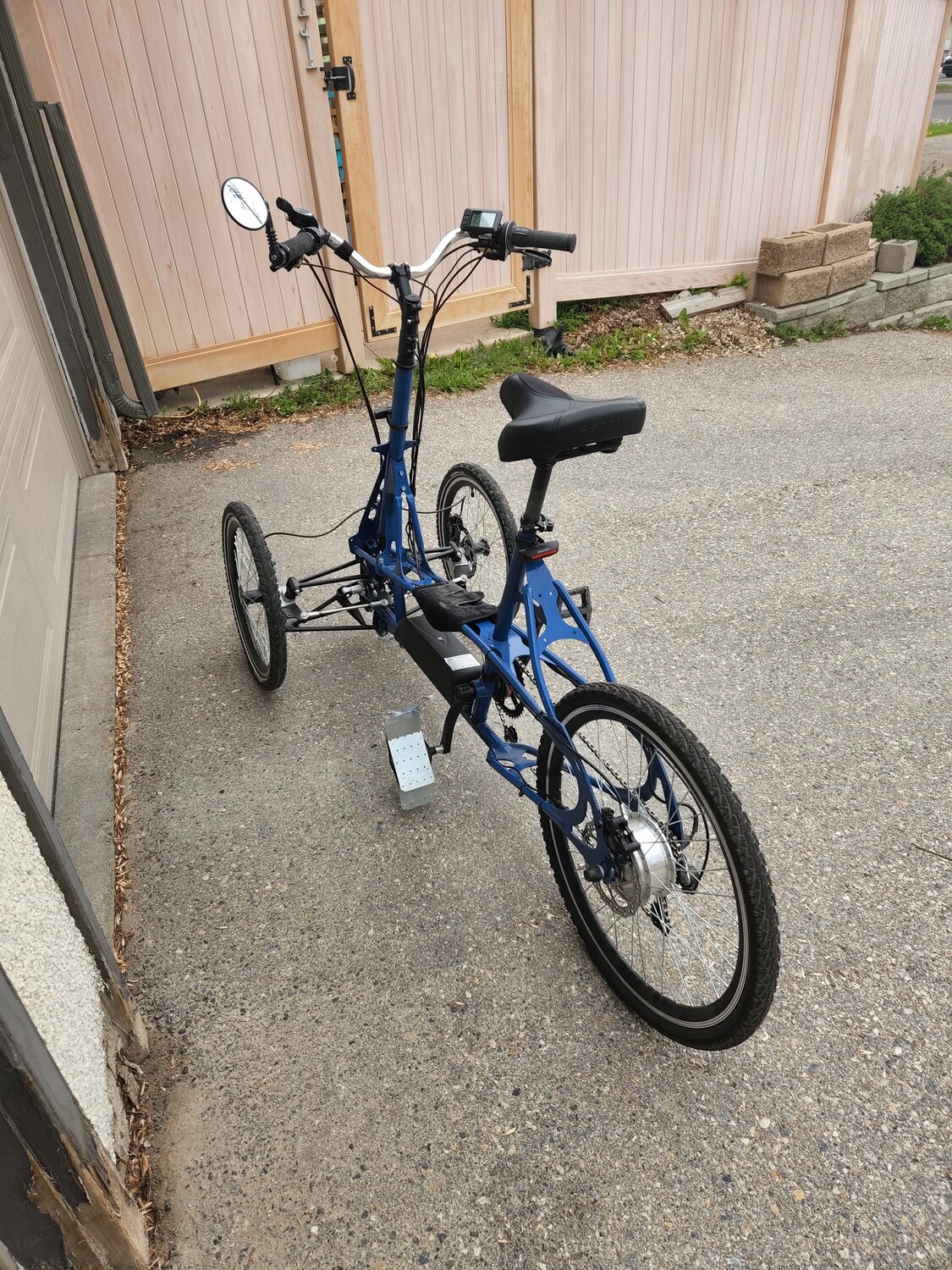

Well, it's been a while but my wife's trike is upgraded and has been ridden (albeit just a short test ride).
She had her personal upgrade in the fall (new knee) so it was time to proceed.
Looks like we are almost there!
As it came from the factory, there were a few features that just didn't suit the purpose.
As listed previously, this was not necessarily the fault of the builder, but I think they've learned a bit from the process.
The needs of disabled riders has to be taken into consideration when making certain choices in regards to controls.
Bringing it home from a local e-bike mechanic who, at a VERY reasonable price, replaced the controller and hooked up brake cutouts etc.
Once it was home, we tested out ergonomics once again, and decided to change stem and bars to gain another inch of height.
Can't go any higher without a new front brake hose.
Originally, the throttle was a twist grip on the right. It is now a thumb throttle on the left (which is her better hand).
The lever on the left controls the front end lockout (this trike has an articulating front end as posted earlier).
On the right, it is now a twist shifter and the location of the e-controls.
It's not perfect of course, as the buttons are on the left side of the screen, but she's not going to be doing a lot of assist level changes on the go, nor changing the screens on the fly.
I wrapped the new controller and wiring with a neoprene knee brace to keep it organised - it's going to be a "Fair weather" cycle.

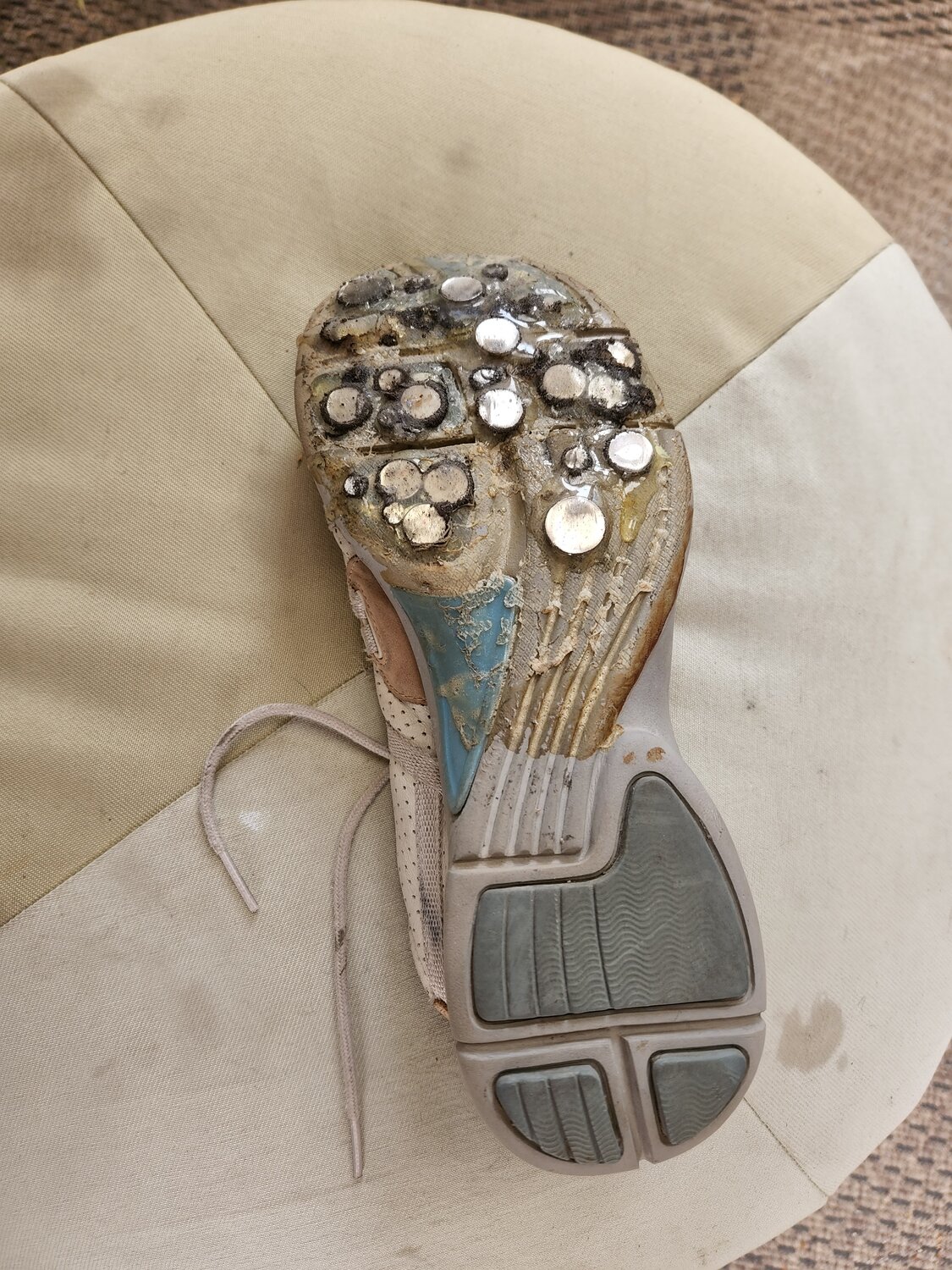

You may notice a weird pedal on the left.
It's something needed for my wife's "drop foot" - as it doesn't want to stay on the pedal, but we certainly don't want it locked in.
Here's how it works:
Rare earth magnets embedded in shoe:
Pedal (cheap takeoff from my Intrigue) with knubbies ground down and metal construction plates attached with pop rivets.
The front toe stopper helps position the foot on the pedal.
I built the one side for fit - then replicated it on the other side for convenience.
Lessons learned from a previous installation on a Townie dictated dual sided pedal - the weighting or the metal would always have the heavy side down (can't fight physics!)

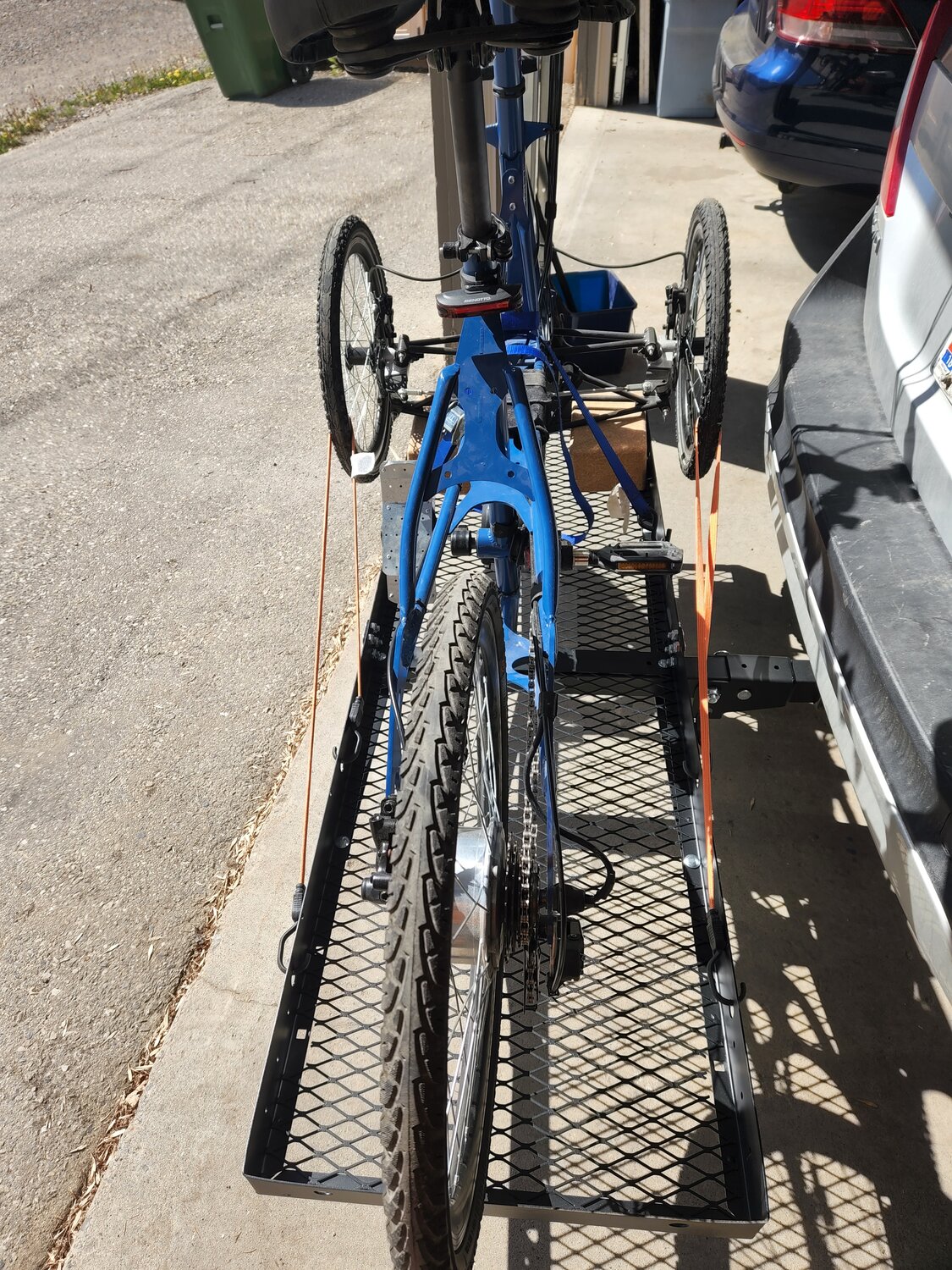

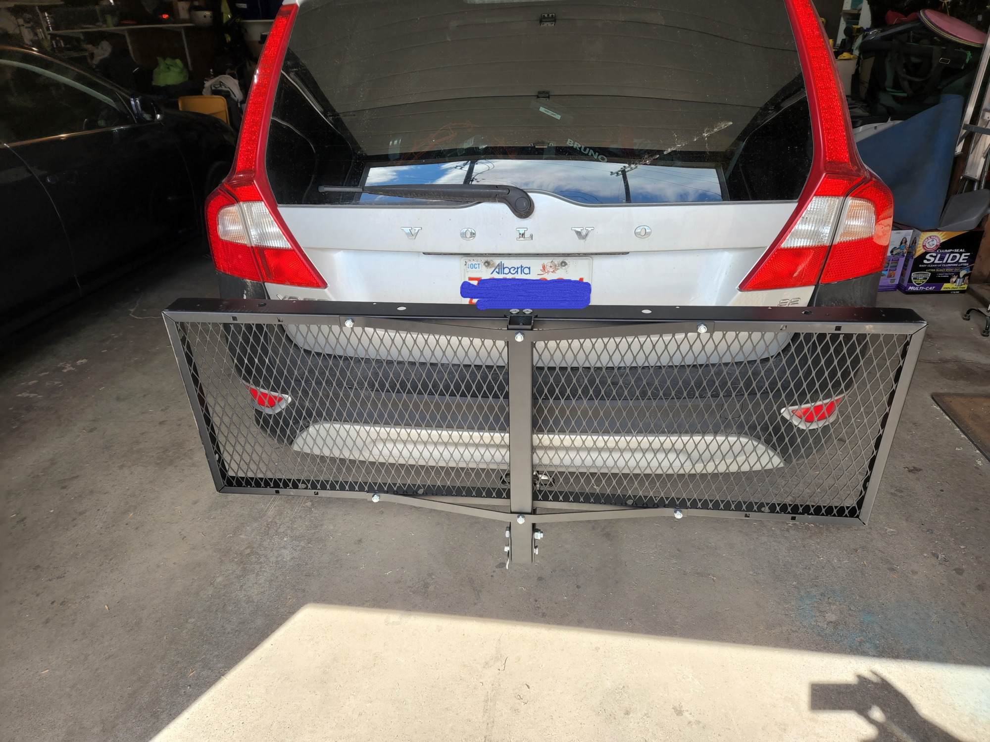

On another note - we will want to be able to transport the trike to more interesting locations to ride - like @Prairie Dog posted lately.
I purchased a hitch mounted cargo carrier for when I can't borrow a pickup - it's rated for 500 lbs.
It's not fancy but it was REALLY reasonably priced ($70) at Princess Auto (Canadian)
My bike can go in the back and her trike can go on the carrier.
This is obviously NOT a finished build!
I considered getting trays for the 3 wheels, but the front end sits solidly on my temporary cork blocks.
With proper cargo straps and some permeant blocking, it should work fine.
The orange bungies were to keep wheels straight.
Feedback from current setup after a brief local ride yesterday evening:
- Need more tweaking of seat (move it back and tilt nose up)
- Brake cutouts are an imperative on a bike with a throttle - disabled rider or not
- Loads of assist! She was riding on level 3 of 5 and she felt she wasn't adding any power herself.
- moved down to 1 for level riding
- Custom pedal is pretty close - may need to adjust toe bumper to allow more twist for release scenarios
- Will be a while before she'll use the front end unlocked - hasn't ridden for 5 or 6 years
- Trikes don't handle cambered surfaces like bikes do - it takes some getting used to when riding with front end locked
- I am of the opinion that once she get's confident enough to use the front end un-locked, she'll be more confident (this will be the tricky one to achieve)
- "I can do this - but I'd feel more confident with elbow pads on!"
