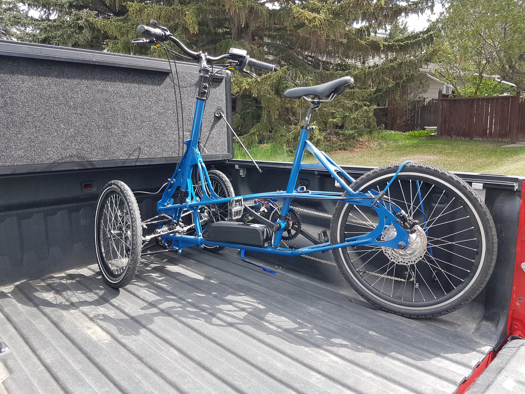

As it came from the factory, there were a few features that just didn't suit the purpose.
As listed previously, this was not necessarily the fault of the builder, but I think they've learned a bit from the process.
The needs of disabled riders has to be taken into consideration when making certain choices in regards to controls.

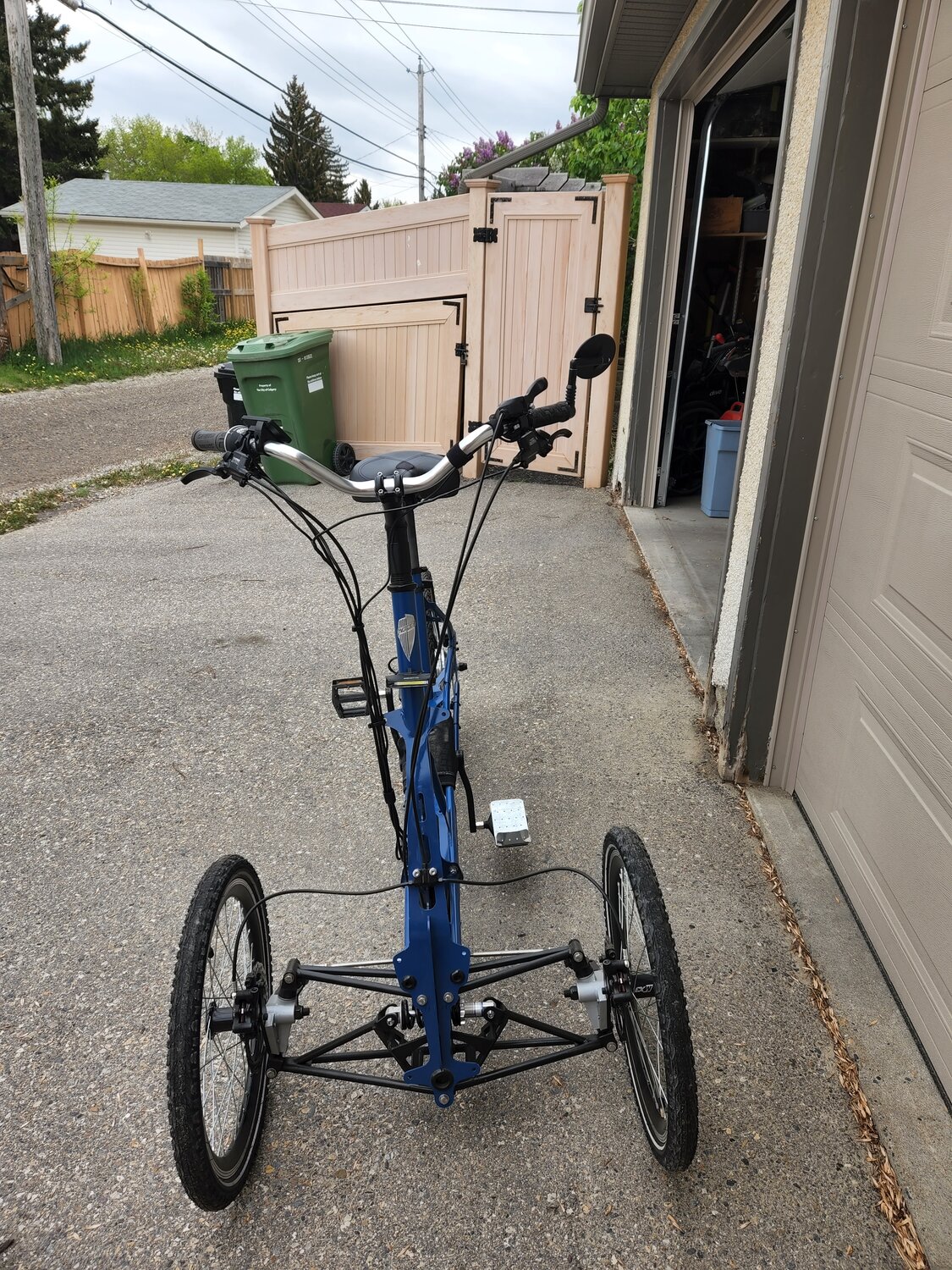

Bringing it home from a local e-bike mechanic who, at a VERY reasonable price, replaced the controller and hooked up brake cutouts etc.

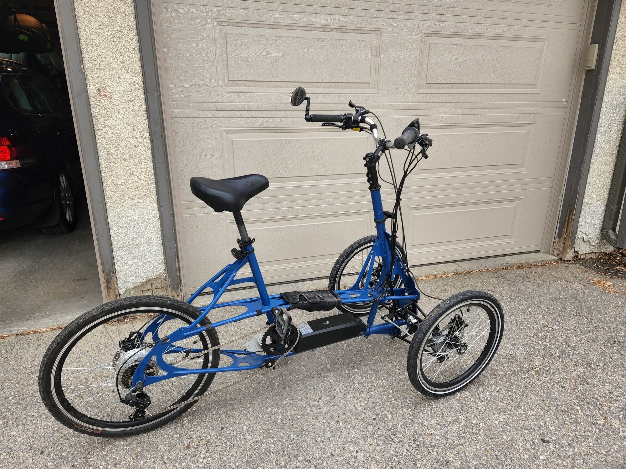

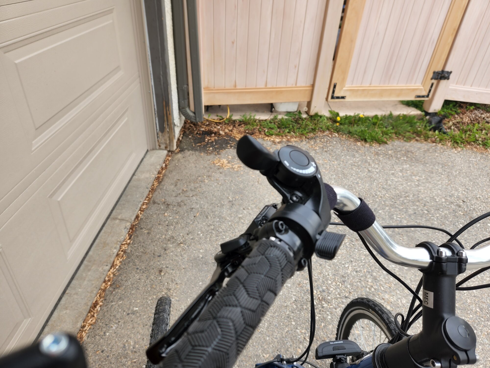

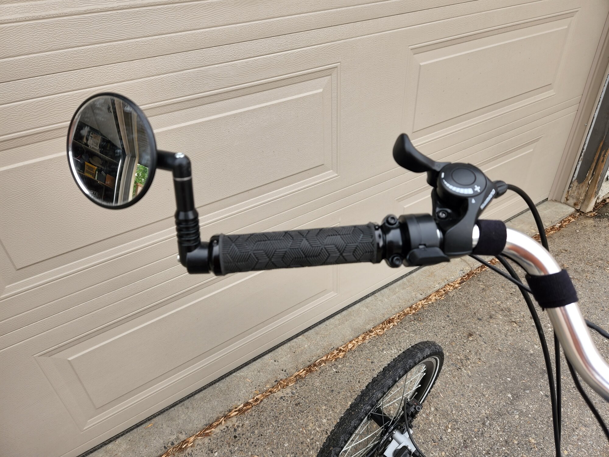

Once it was home, we tested out ergonomics once again, and decided to change stem and bars to gain another inch of height.
Can't go any higher without a new front brake hose.

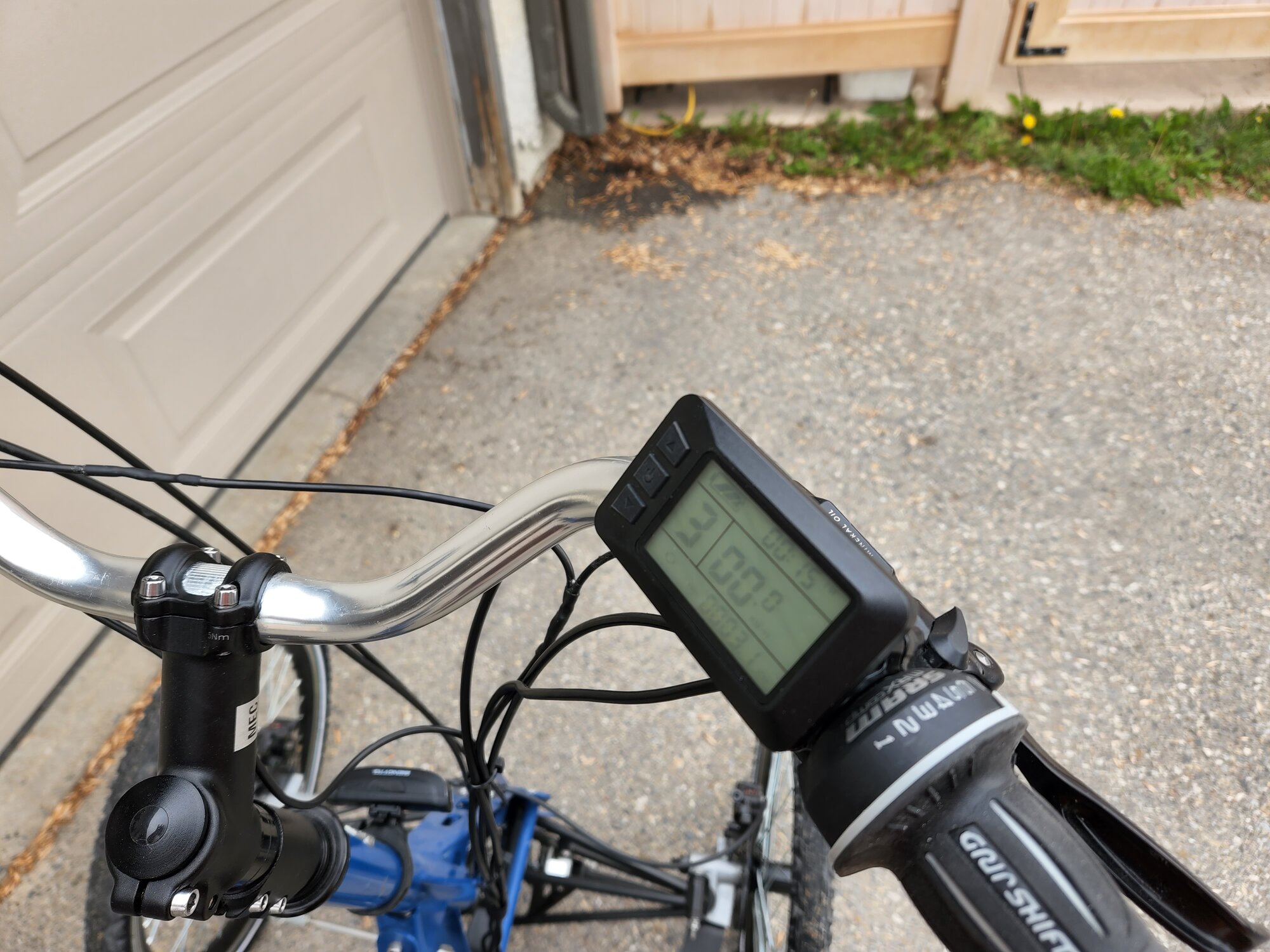

Originally, the throttle was a twist grip on the right. It is now a thumb throttle on the left (which is her better hand).
The lever on the left controls the front end lockout (this trike has an articulating front end as posted earlier).
On the right, it is now a twist shifter and the location of the e-controls.
It's not perfect of course, as the buttons are on the left side of the screen, but she's not going to be doing a lot of assist level changes on the go, nor changing the screens on the fly.
I wrapped the new controller and wiring with a neoprene knee brace to keep it organised - it's going to be a "Fair weather" cycle.

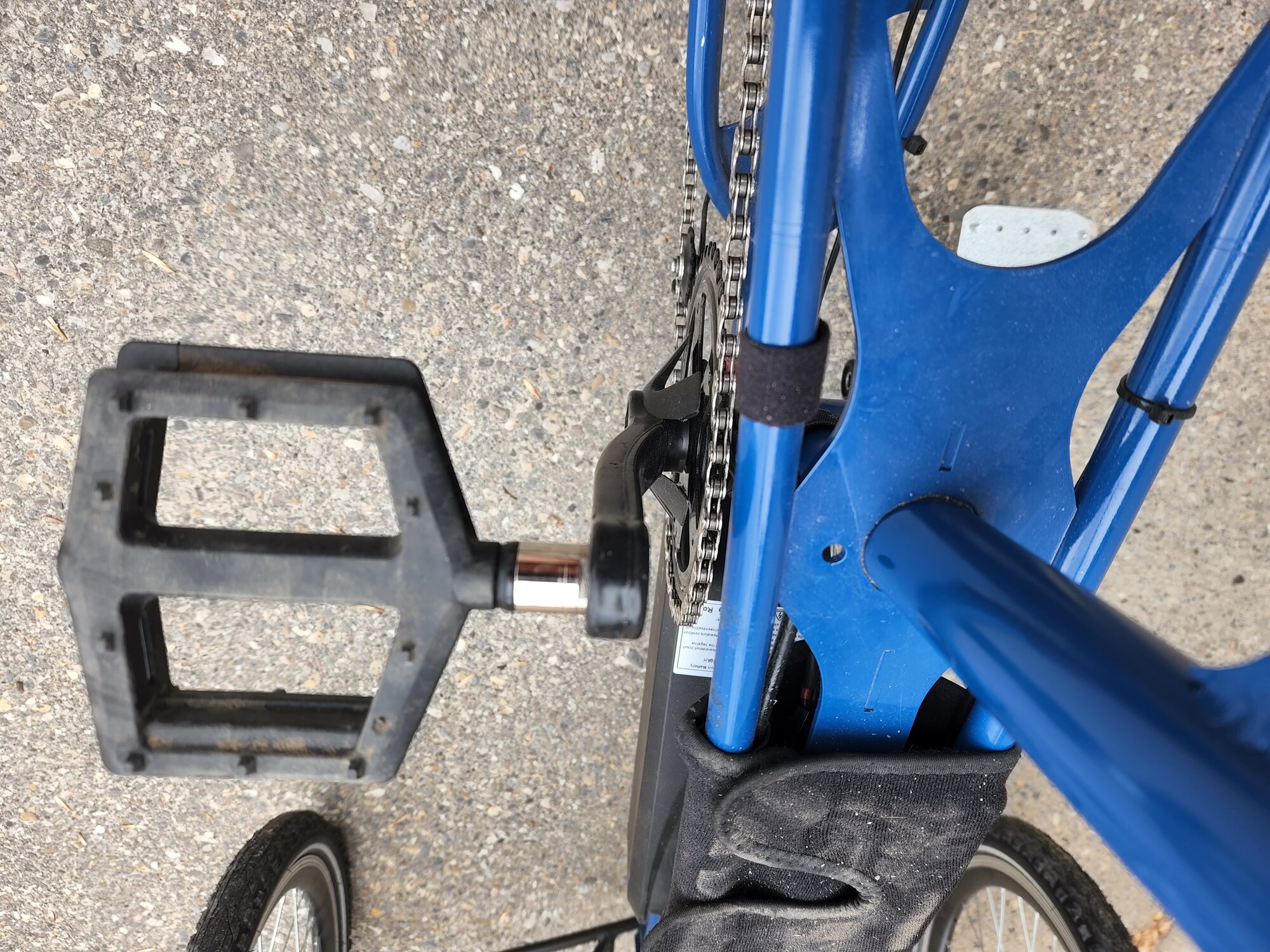

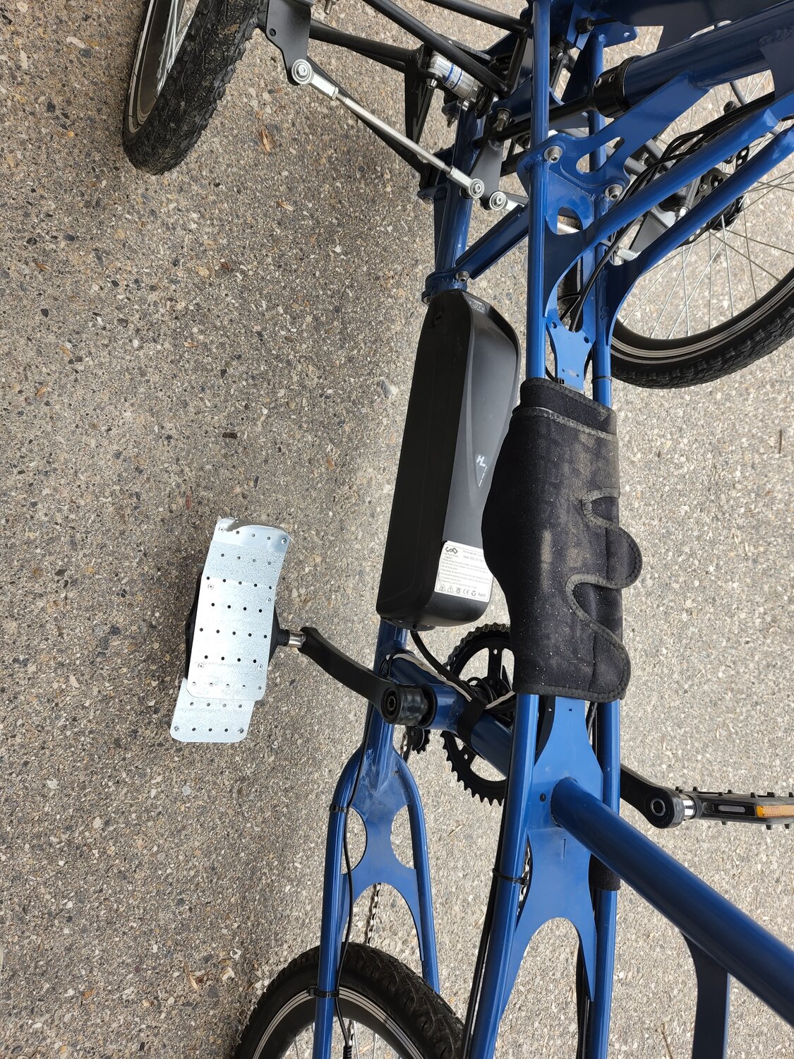

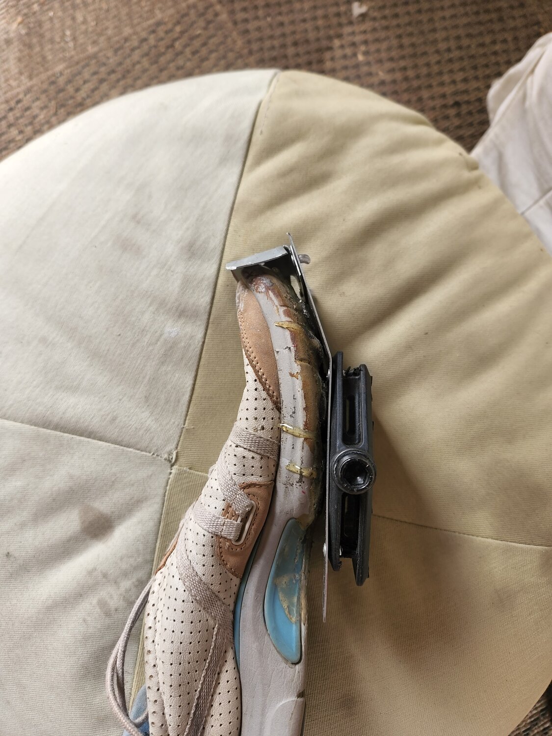

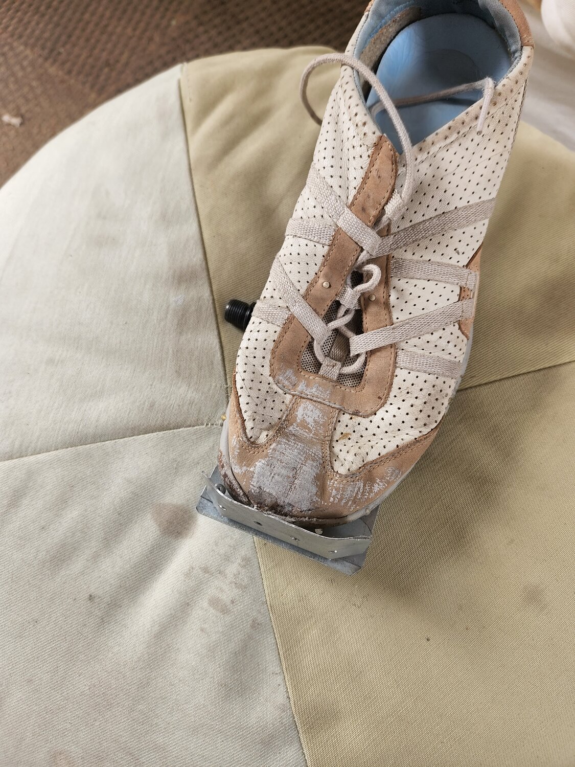

You may notice a weird pedal on the left.
It's something needed for my wife's "drop foot" - as it doesn't want to stay on the pedal, but we certainly don't want it locked in.
Here's how it works:
Rare earth magnets embedded in shoe:
Pedal (cheap takeoff from my Intrigue) with knubbies ground down and metal construction plates attached with pop rivets.
The front toe stopper helps position the foot on the pedal.
I built the one side for fit - then replicated it on the other side for convenience.
Lessons learned from a previous installation on a Townie dictated dual sided pedal - the weighting or the metal would always have the heavy side down (can't fight physics!)

  • Custom pedal is pretty close - may need to adjust toe bumper to allow more twist for release scenarios

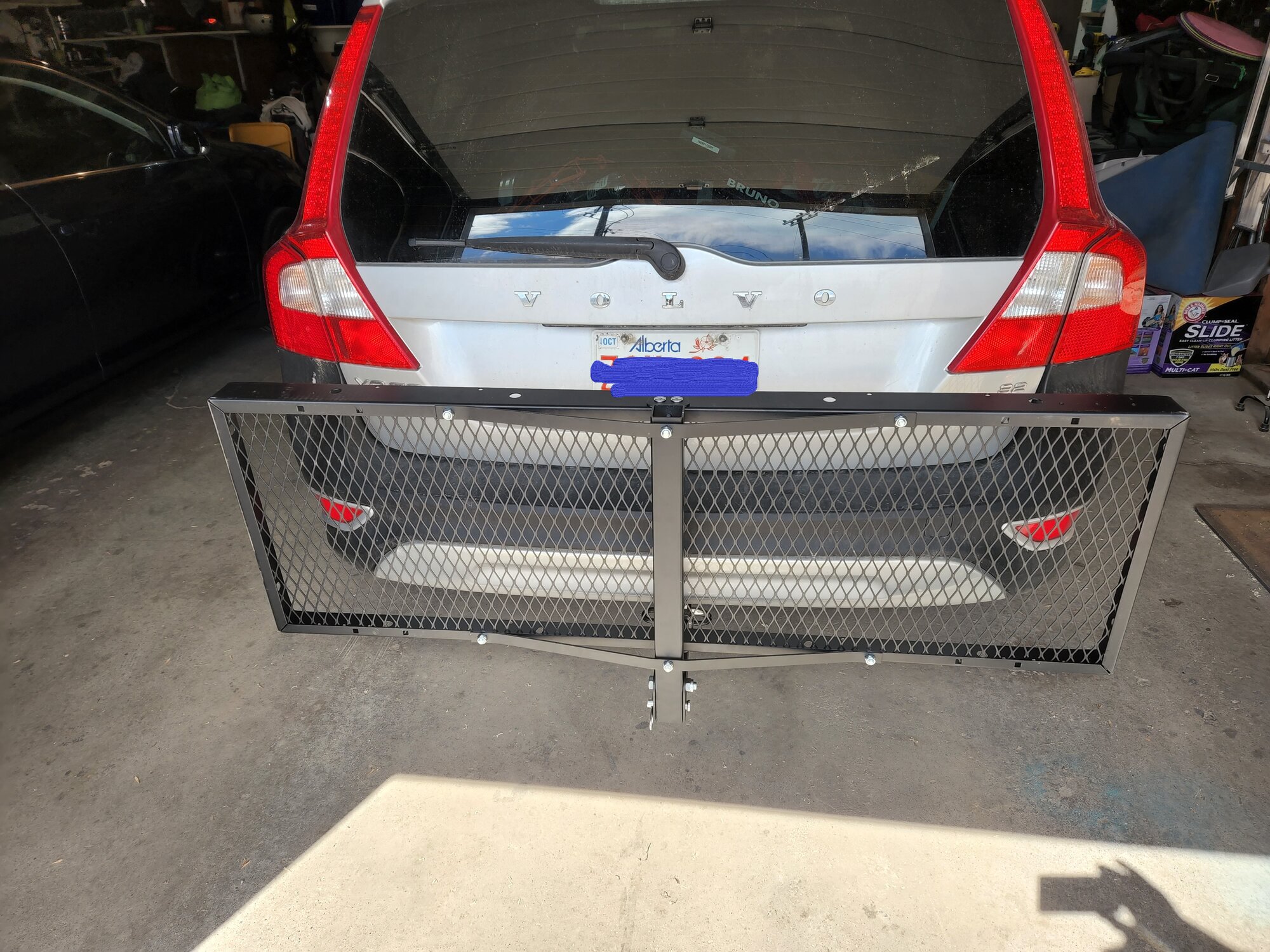

On another note - we will want to be able to transport the trike to more interesting locations to ride - like @Prairie Dog posted lately.
I purchased a hitch mounted cargo carrier for when I can't borrow a pickup - it's rated for 500 lbs.
It's not fancy but it was REALLY reasonably priced ($70) at Princess Auto (Canadian)
My bike can go in the back and her trike can go on the carrier.
This is obviously NOT a finished build!
I considered getting trays for the 3 wheels, but the front end sits solidly on my temporary cork blocks.
With proper cargo straps and some permeant blocking, it should work fine.

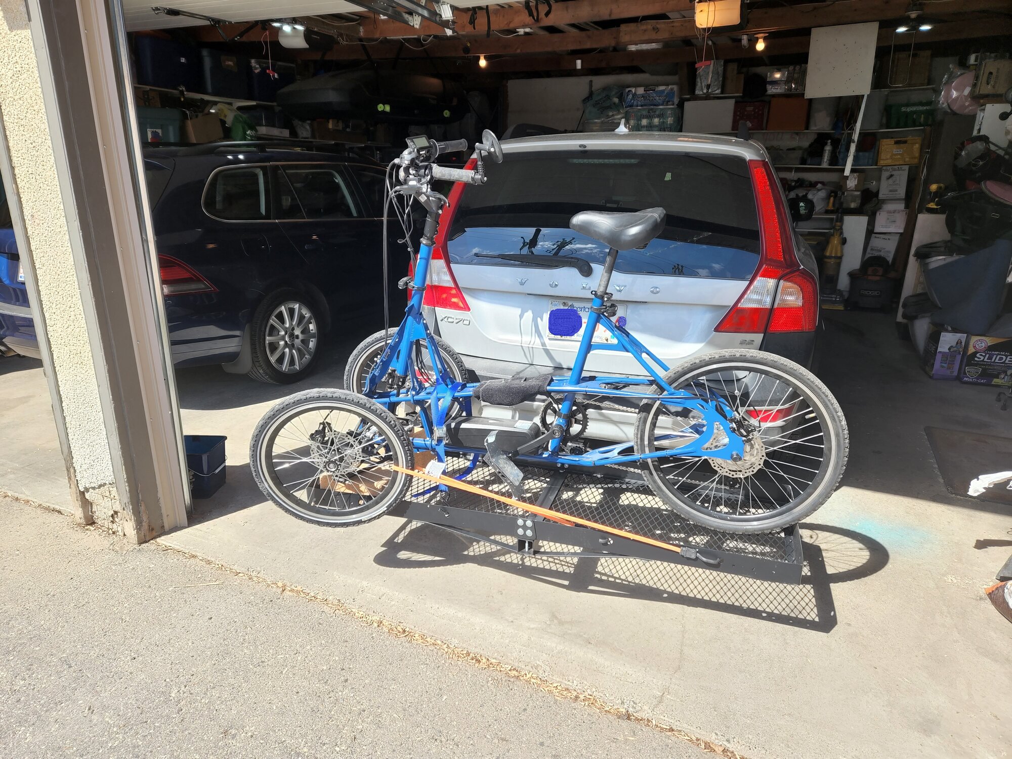

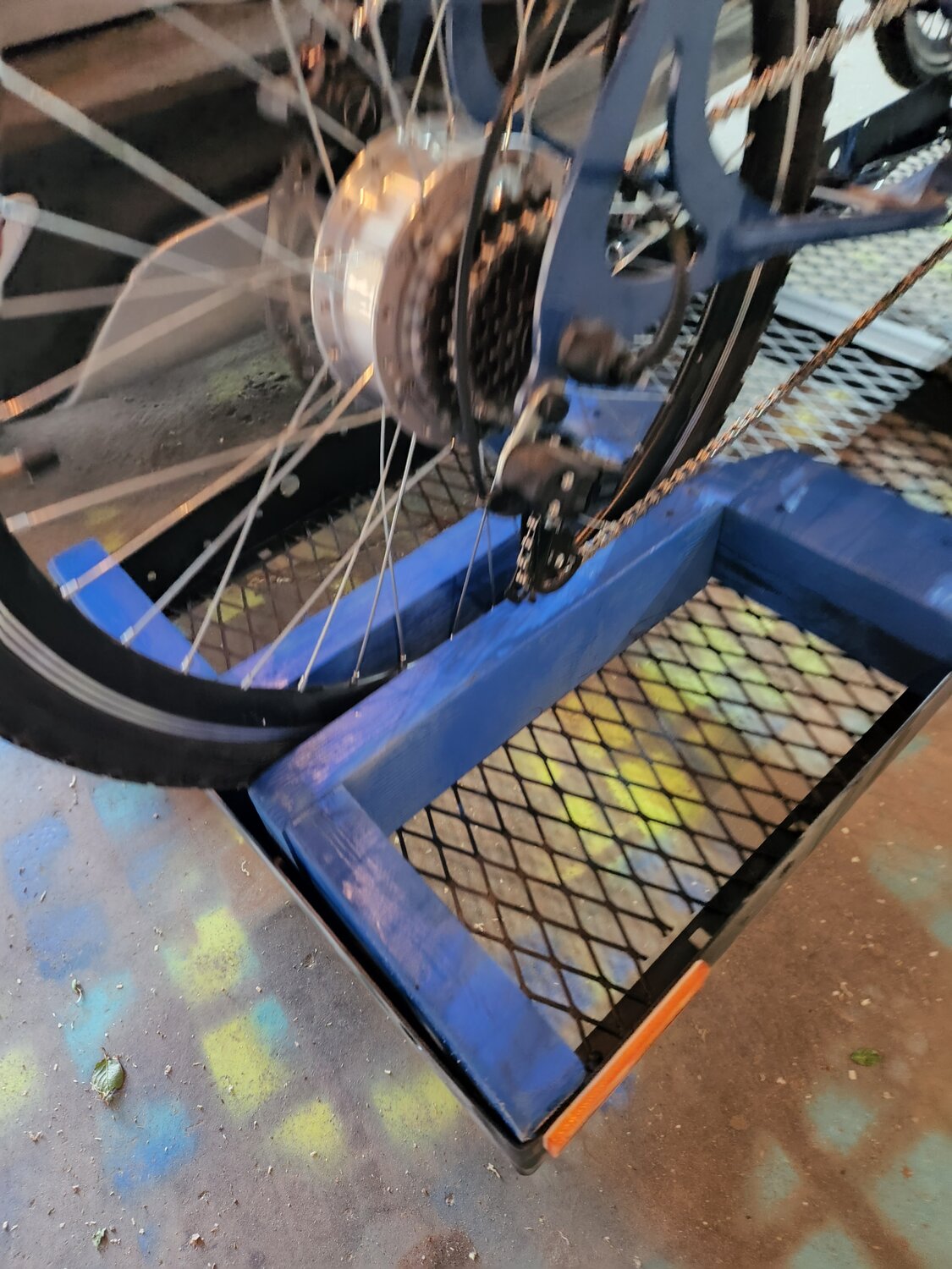

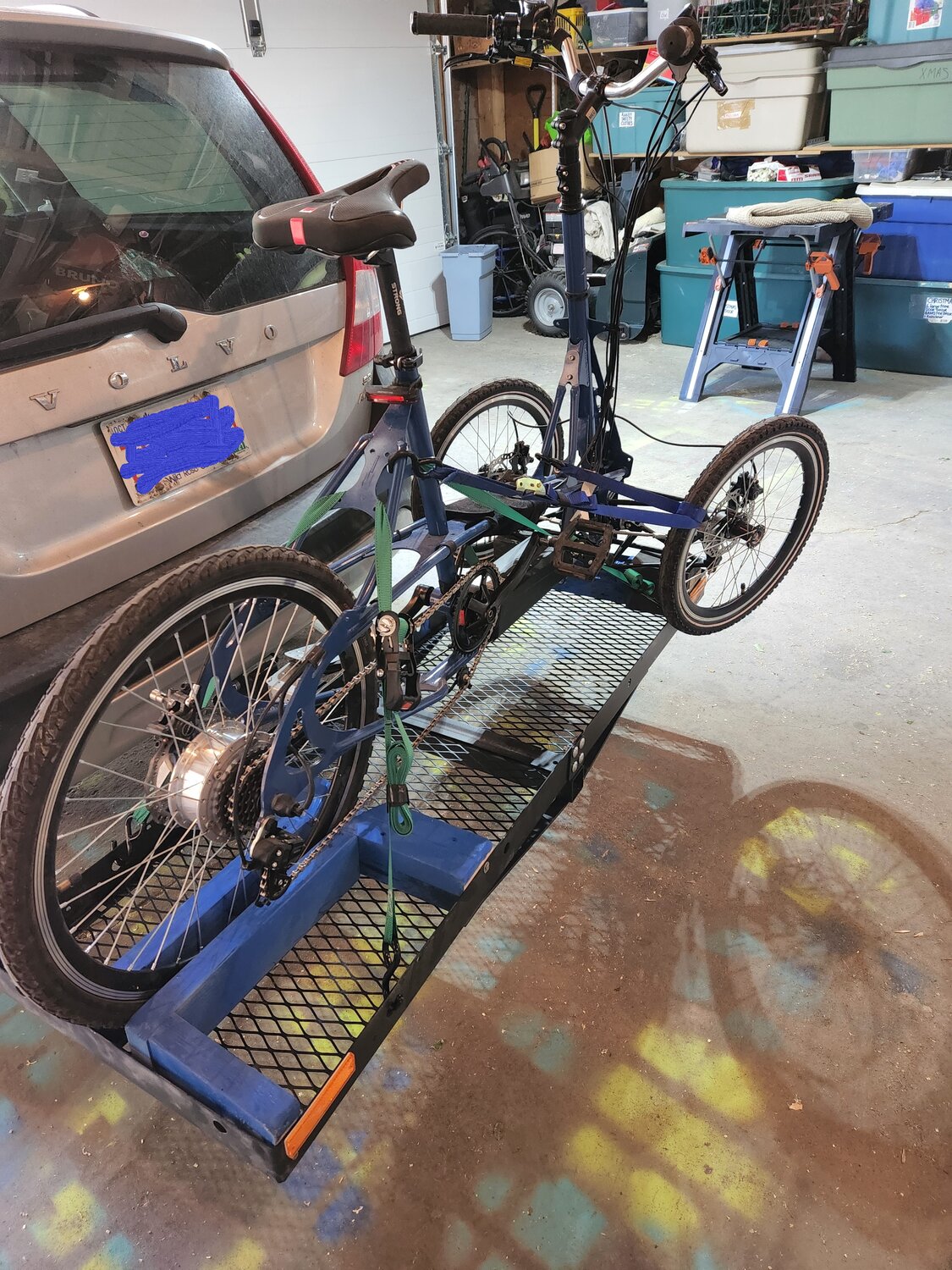

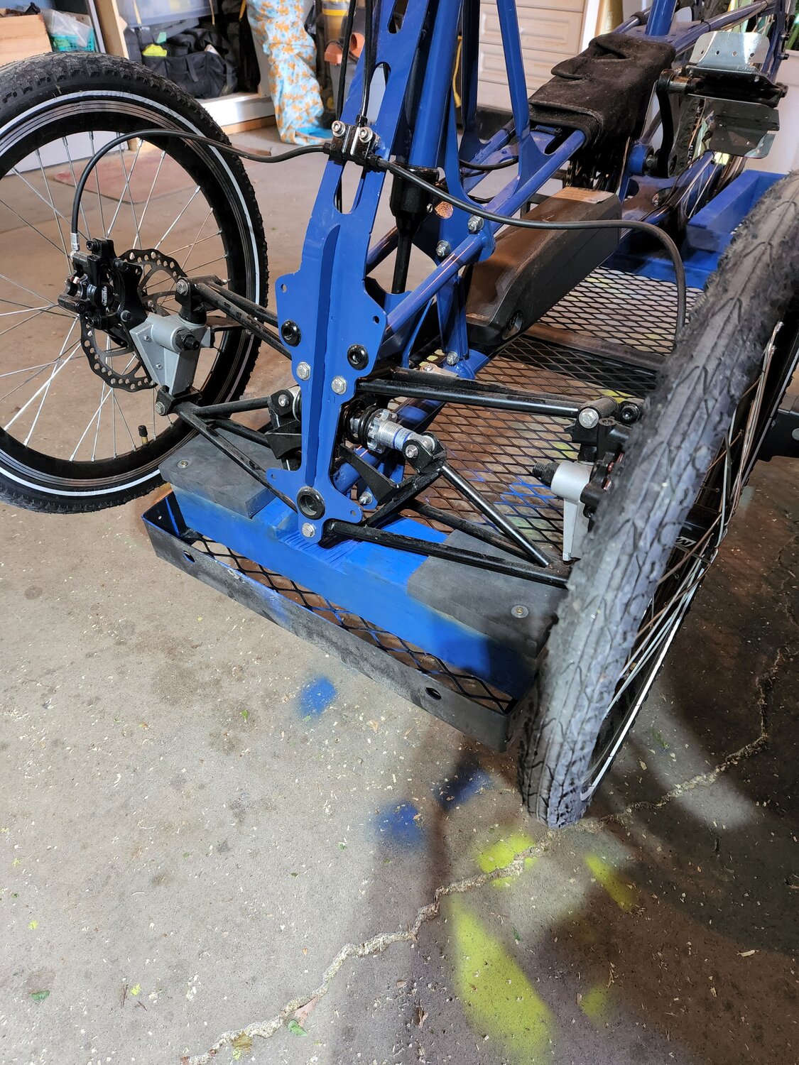

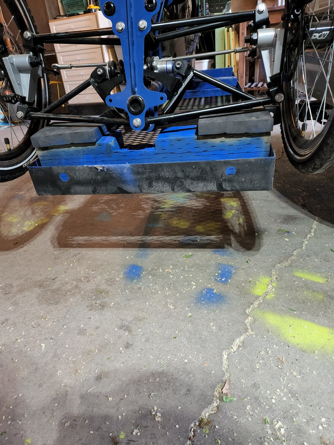

Finished the carrier with some spare lumber and paint (and some reflectors), and the trike is loaded to go for a test ride.
I reconsidered my original layout as I had the front on the exhaust side of the car.
As the wheels hang over the side of the carrier, I decided to reverse the layout and put the single rear tire at that end instead.
Rear end:
Front end - I had some dense foam pads I used for the trike to rest on:
Loaded - test drove it around the neighborhood and nothing budged.
Blue strap is to stop the wheels whipping back and forth.
Loading was easy - with rear tire against the front end side of the carrier, I pick it up the tire and roll the trike onto platform.
Then go to front end and pick up by the two front tires and walk the trike into position. No heavy lifting - as it's not a light trike.
Unloading would simply be the reverse...
I am still tweaking my strap down plans, but it's going to be pretty secure before it goes on the road!

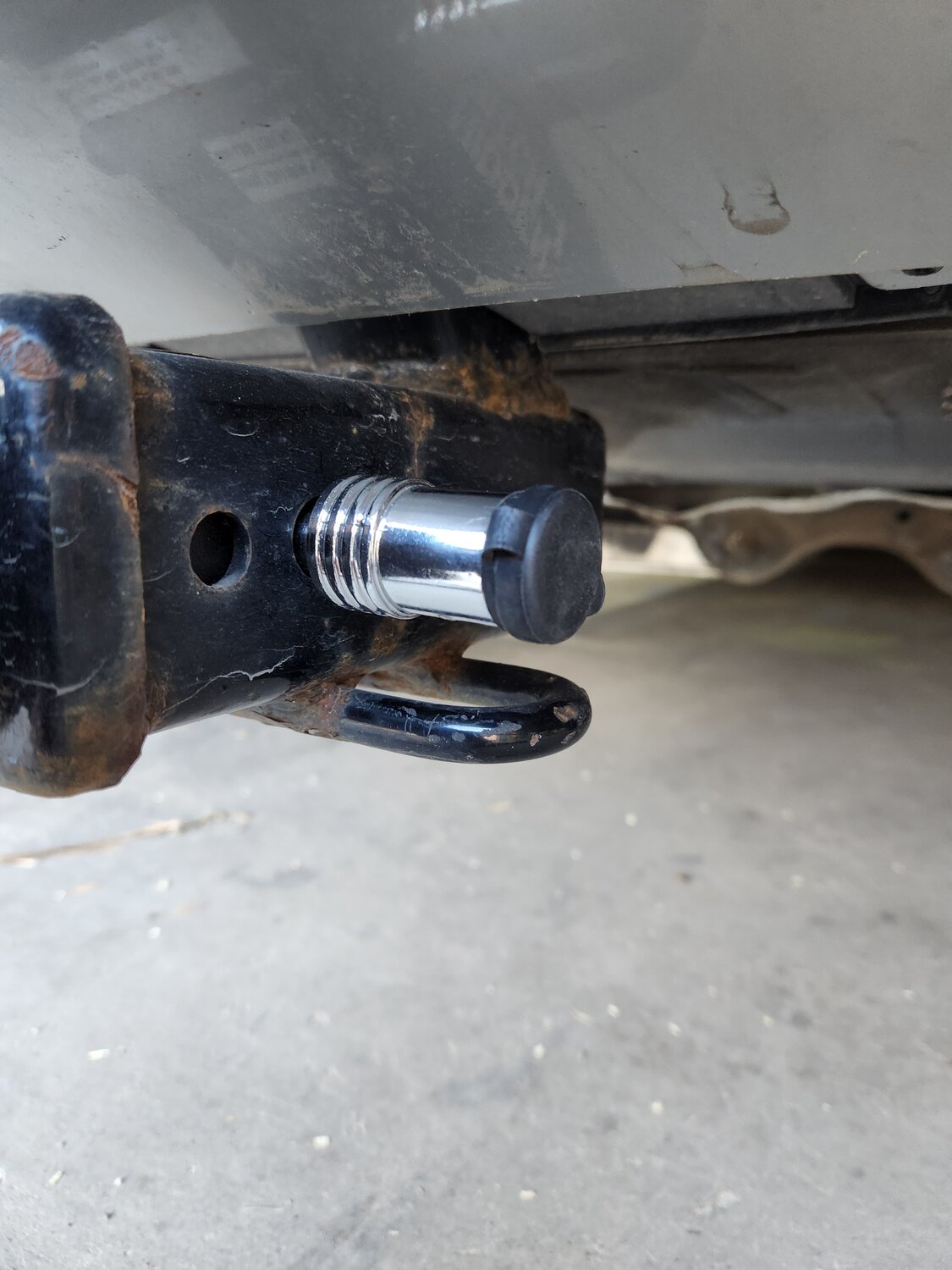

Last but not least - a locking "anti-rattle" hitch pin.
Coming back from an extended ride to a missing carrier would not be optimal!

Regarding the pedals:
The solution I made for my wife's bike (MS also) was to simply screw a metal plate (mending plate from Home Depot cut to size) onto a standard pedal and modify her shoe.
We then took a pair of old shoes and cut away at the sole. We epoxied rare earth magnets into the the void we created in the sole. It worked pretty well to keep her bad foot in place without being clamped in.
