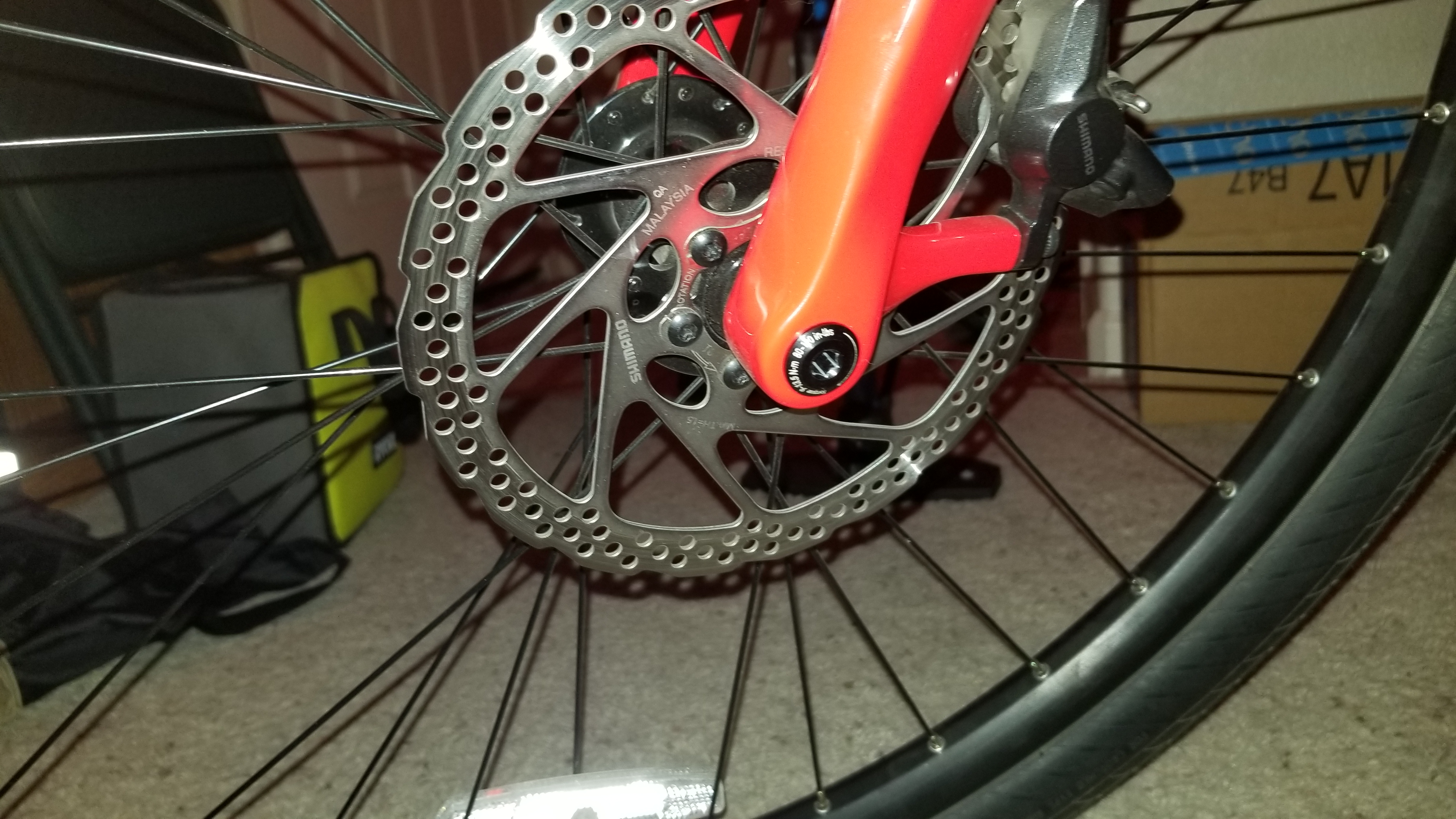

Looks like mine may be 2017. I did get it for 4k, it was new with 2 miles on the odo. Looking at your fork, however, I think they are the same. 2018 just used different axle design. Either way glad we figured it out ;)

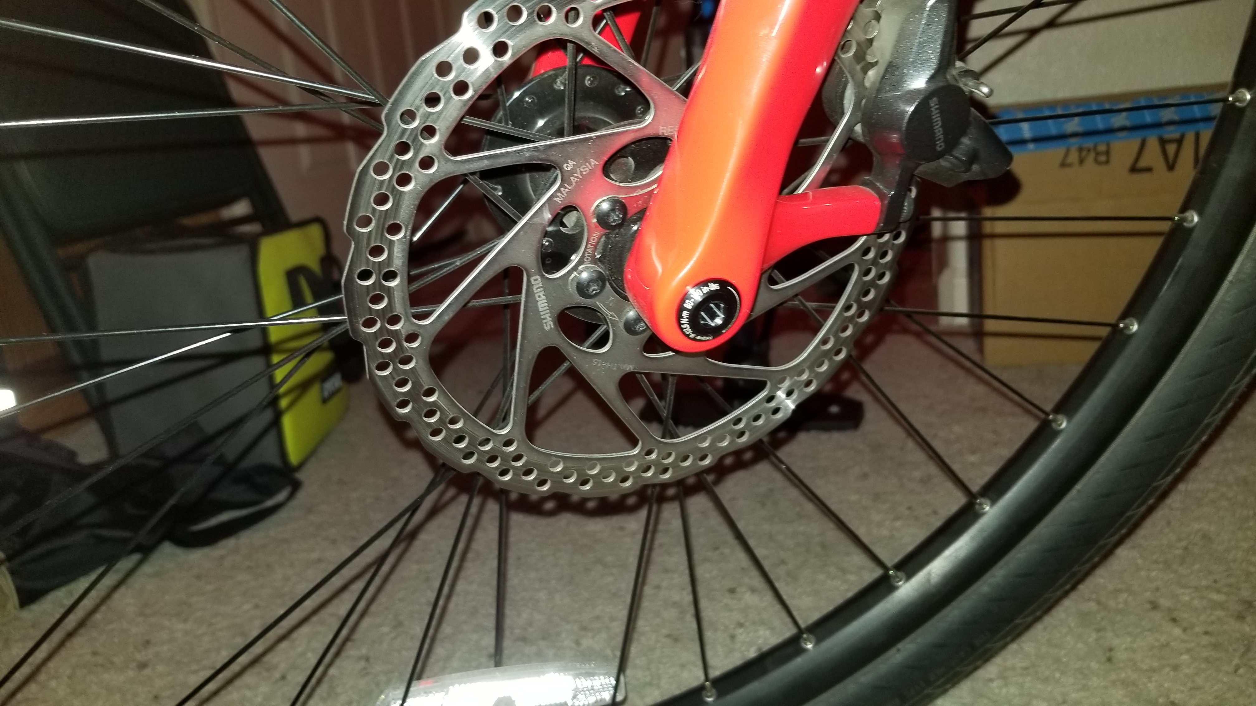

I bought my bike brand new a few months ago, so pretty sure my bike is a 2018. The thru axle is stock, and it looks the same as the one in your photo to me. Here is a close-up of the front thru axle.
You can call Trek with your serial number and get the year. I purchased an XM 700 in June of 2017 from a local bike company with 5 stores that sold Treks. I checked with Trek and it was a 2014 model!

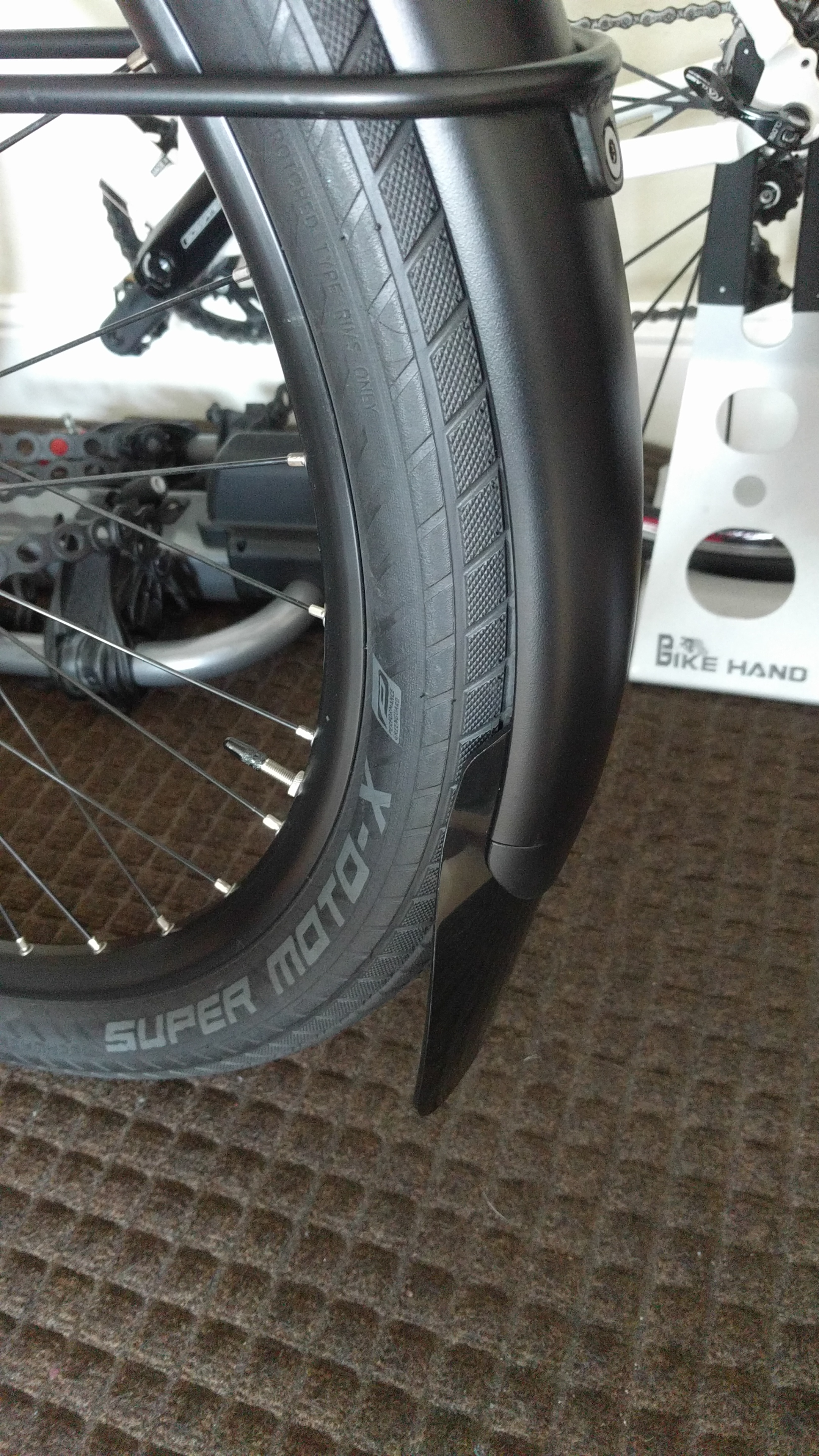

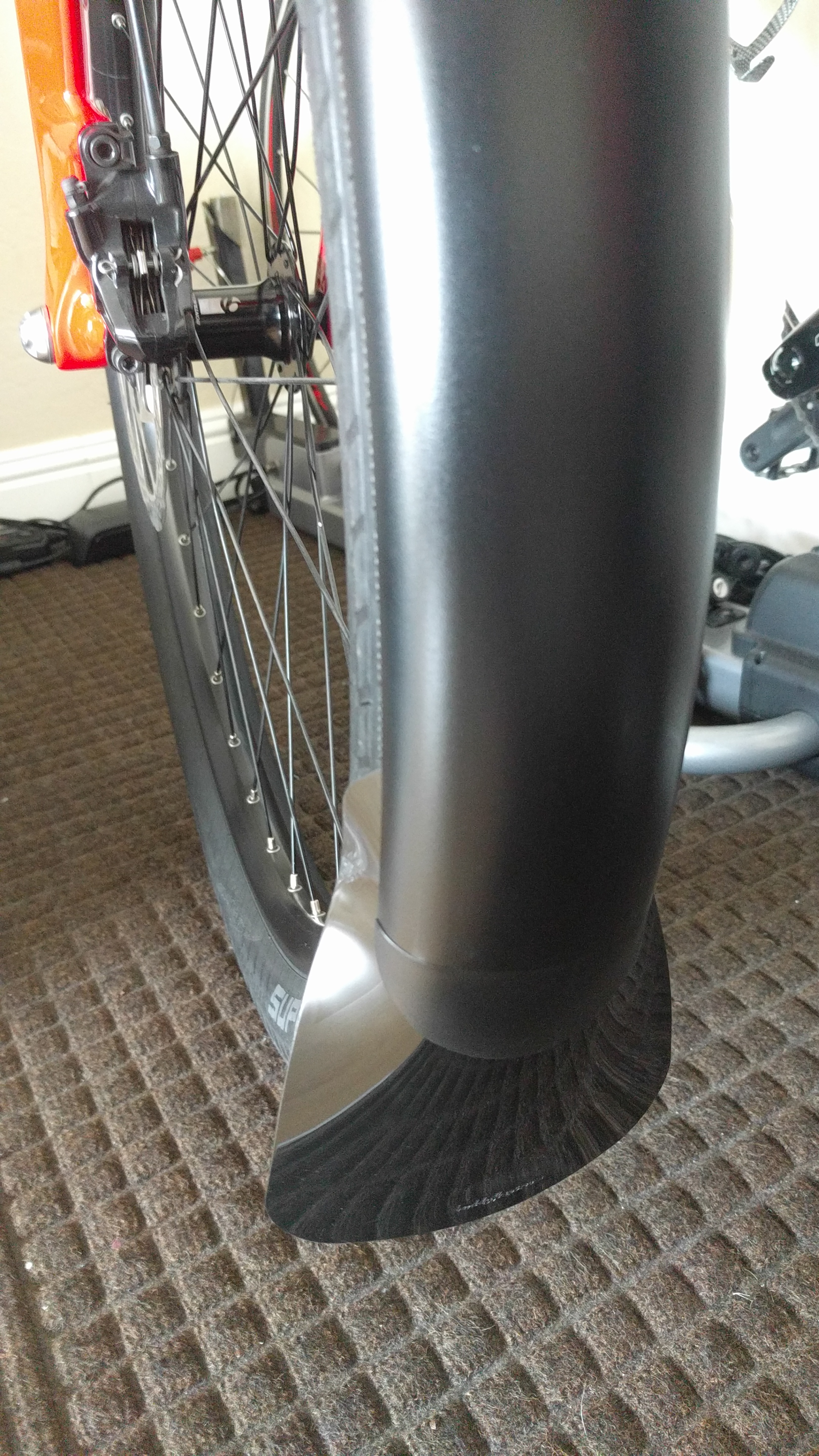

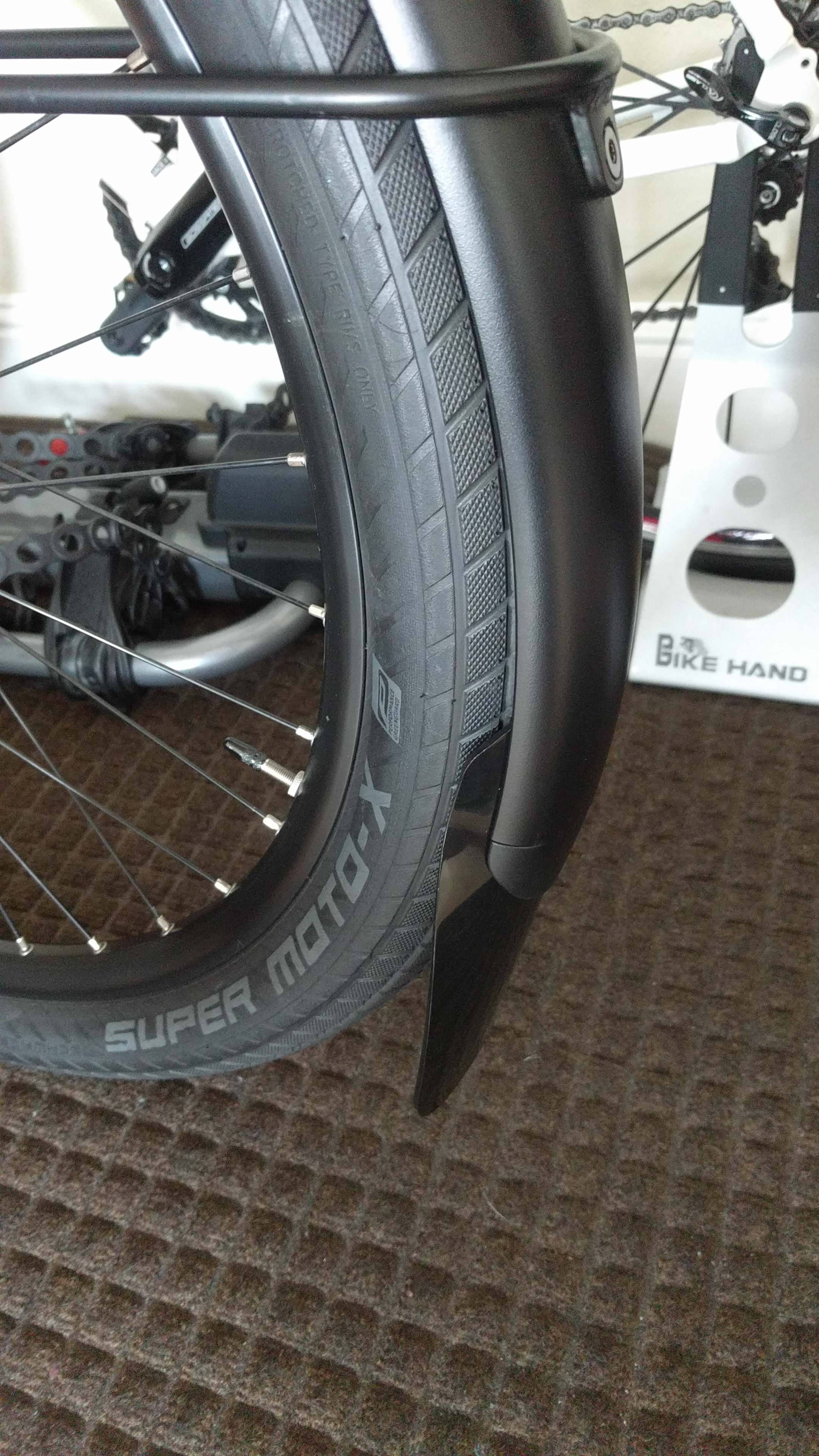

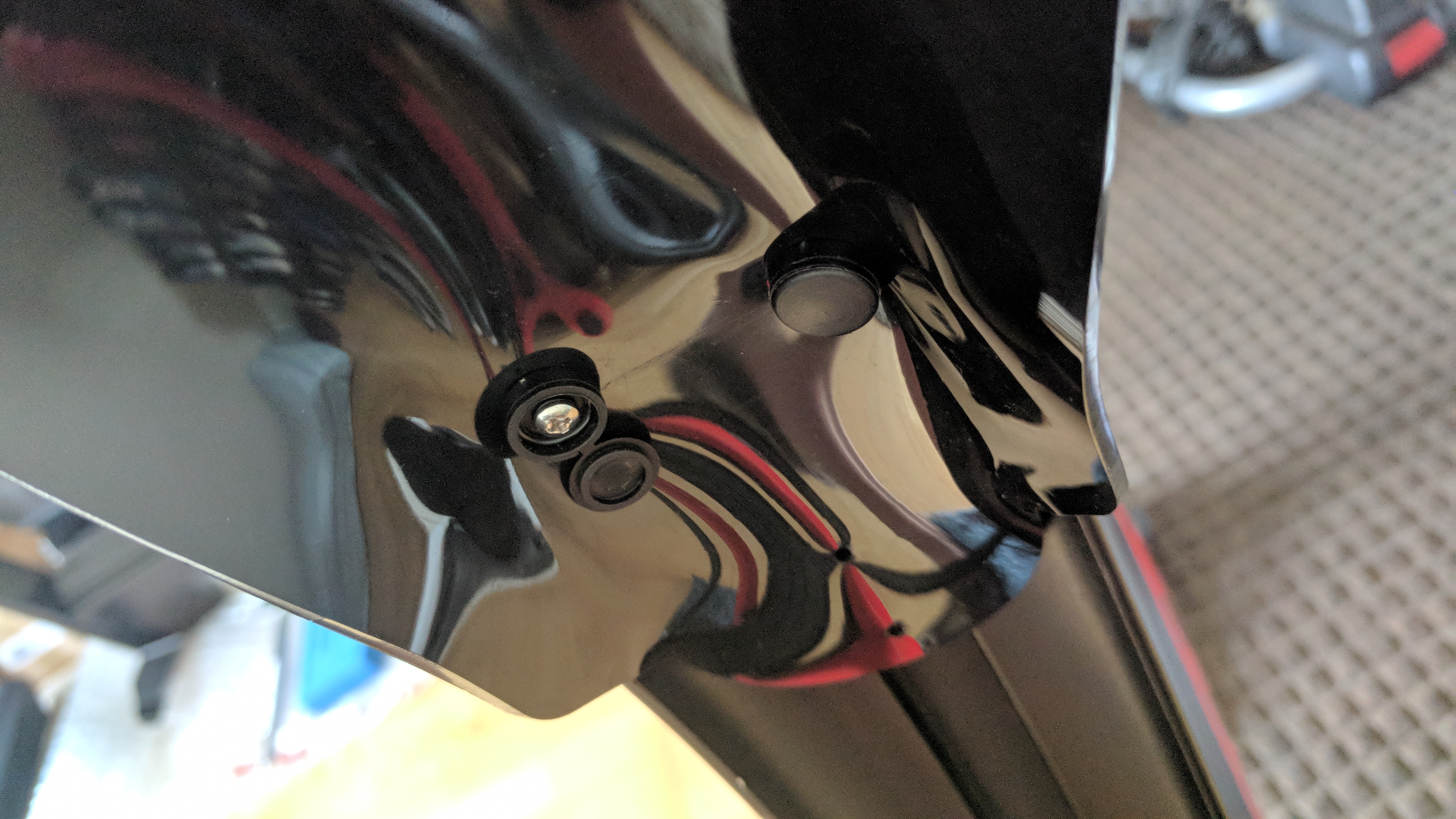

With more rainy days on the horizon, I finally got around installing http://buddyflaps.com
I was hoping to reuse plastic flap mounting points and it turned out as I planned.
Just had to use a bit longer screws and decided to go with plastic caps which also work as flat washers to spread out the load towards the outside of the fender to press the buddy flap against the fender's contour.
Hope someone finds it useful.

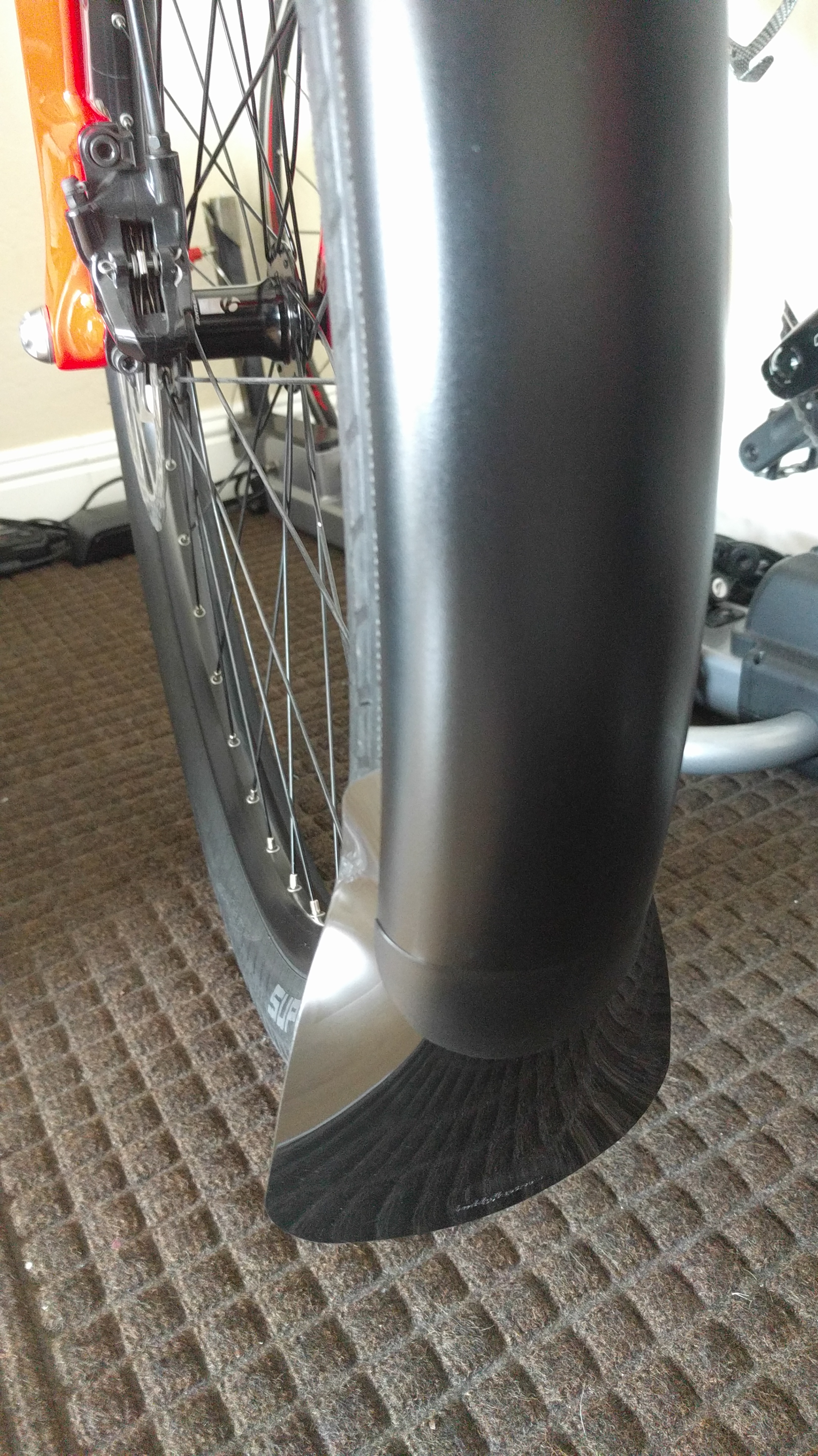

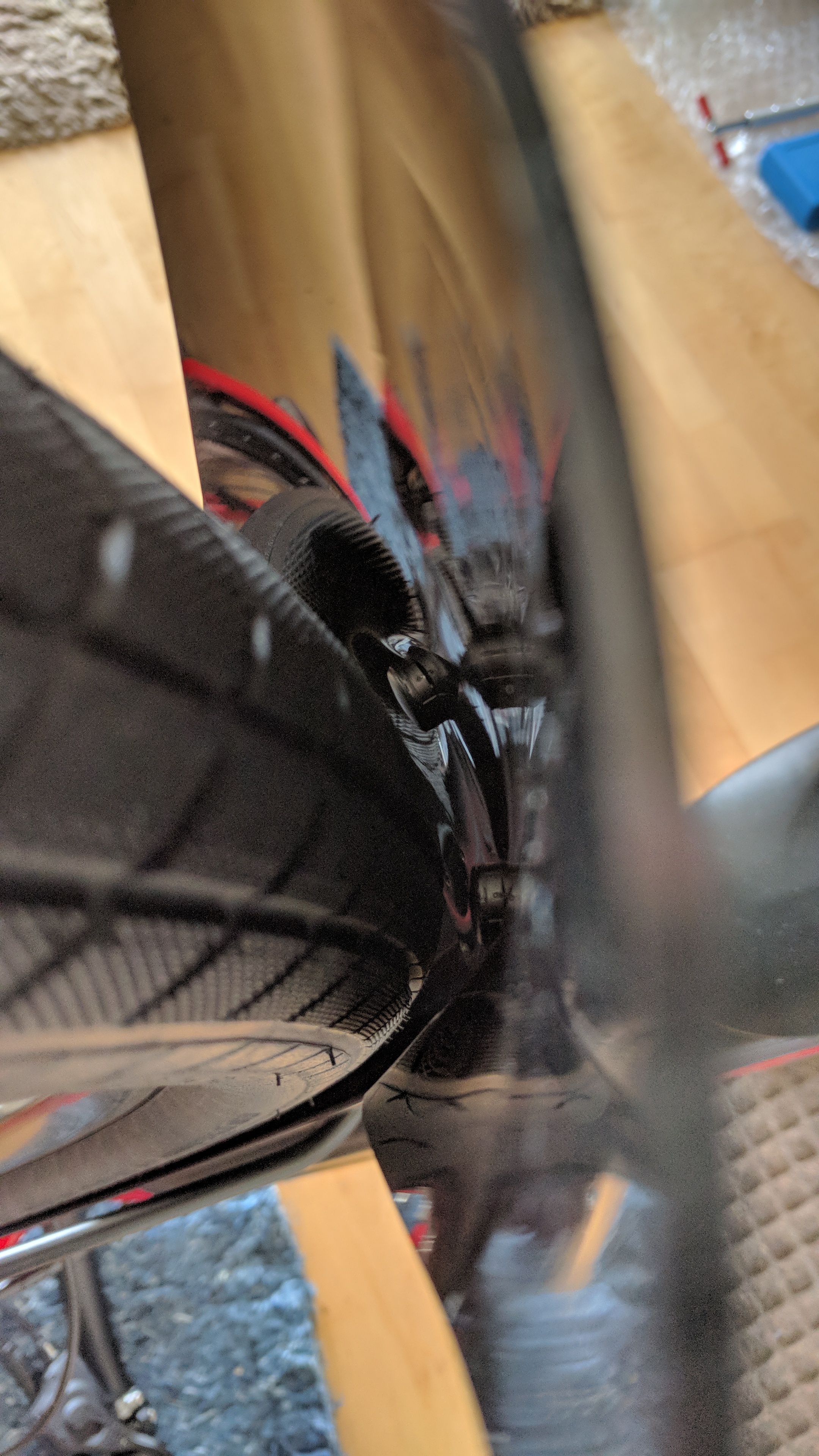

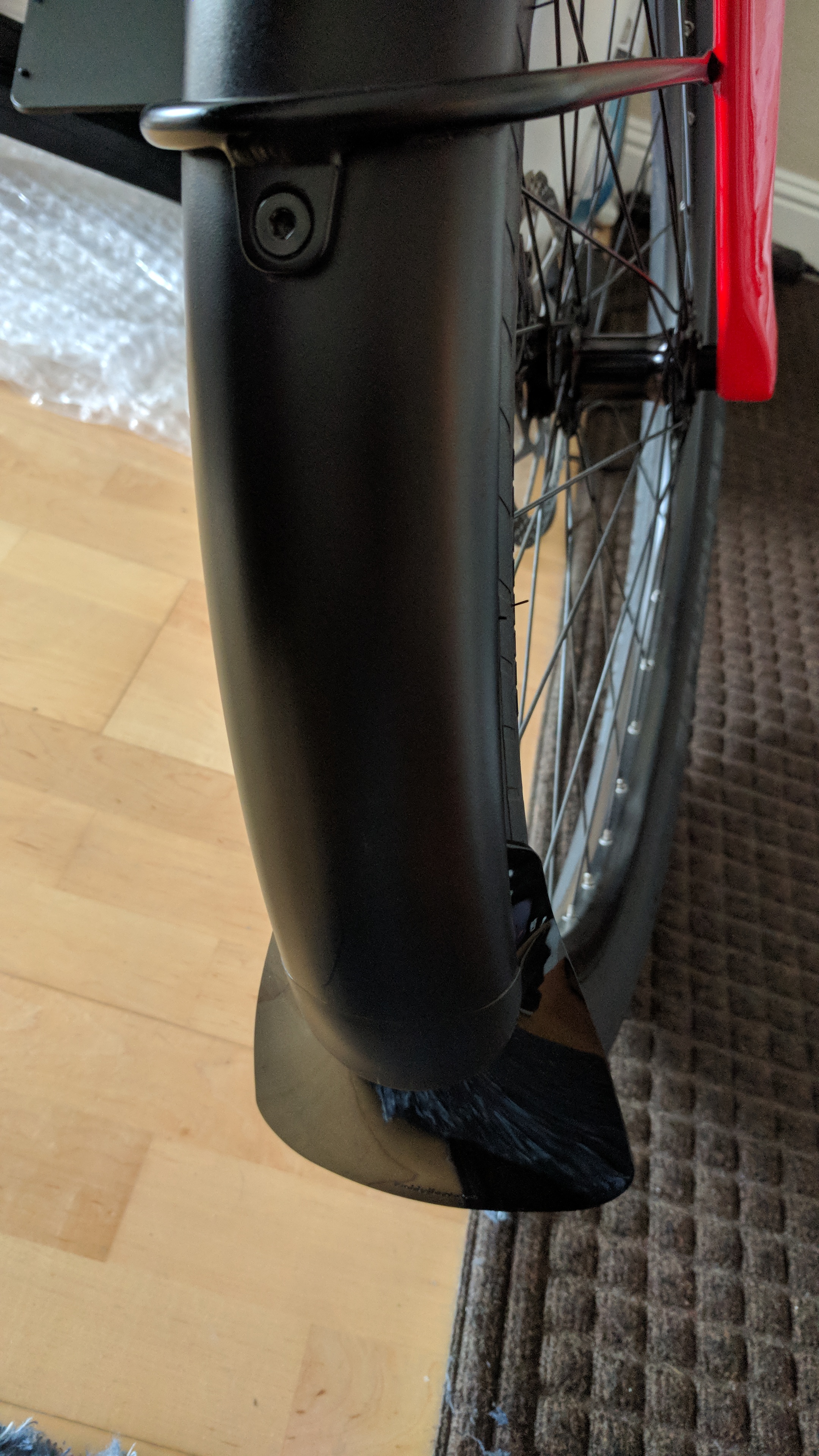

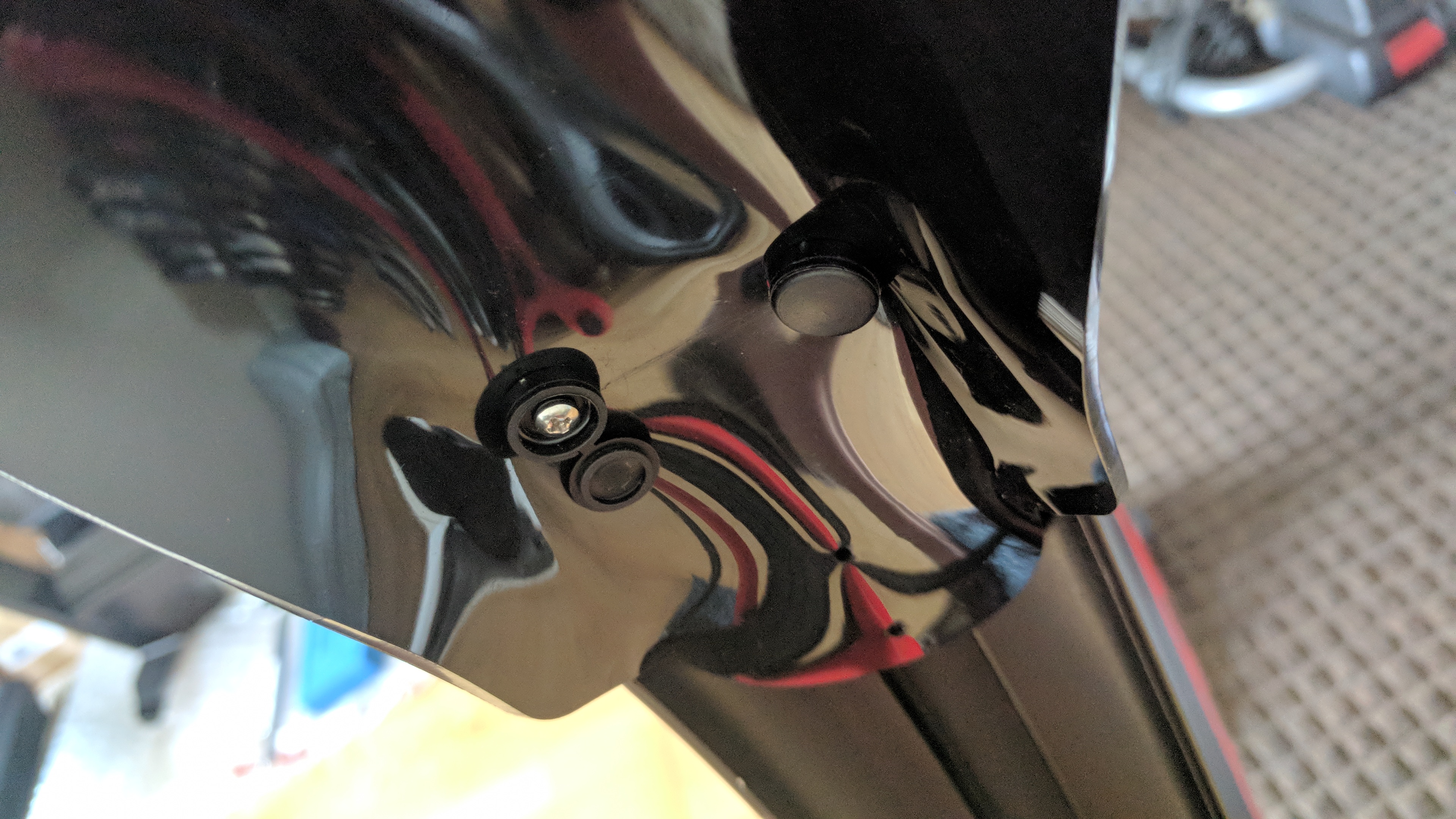

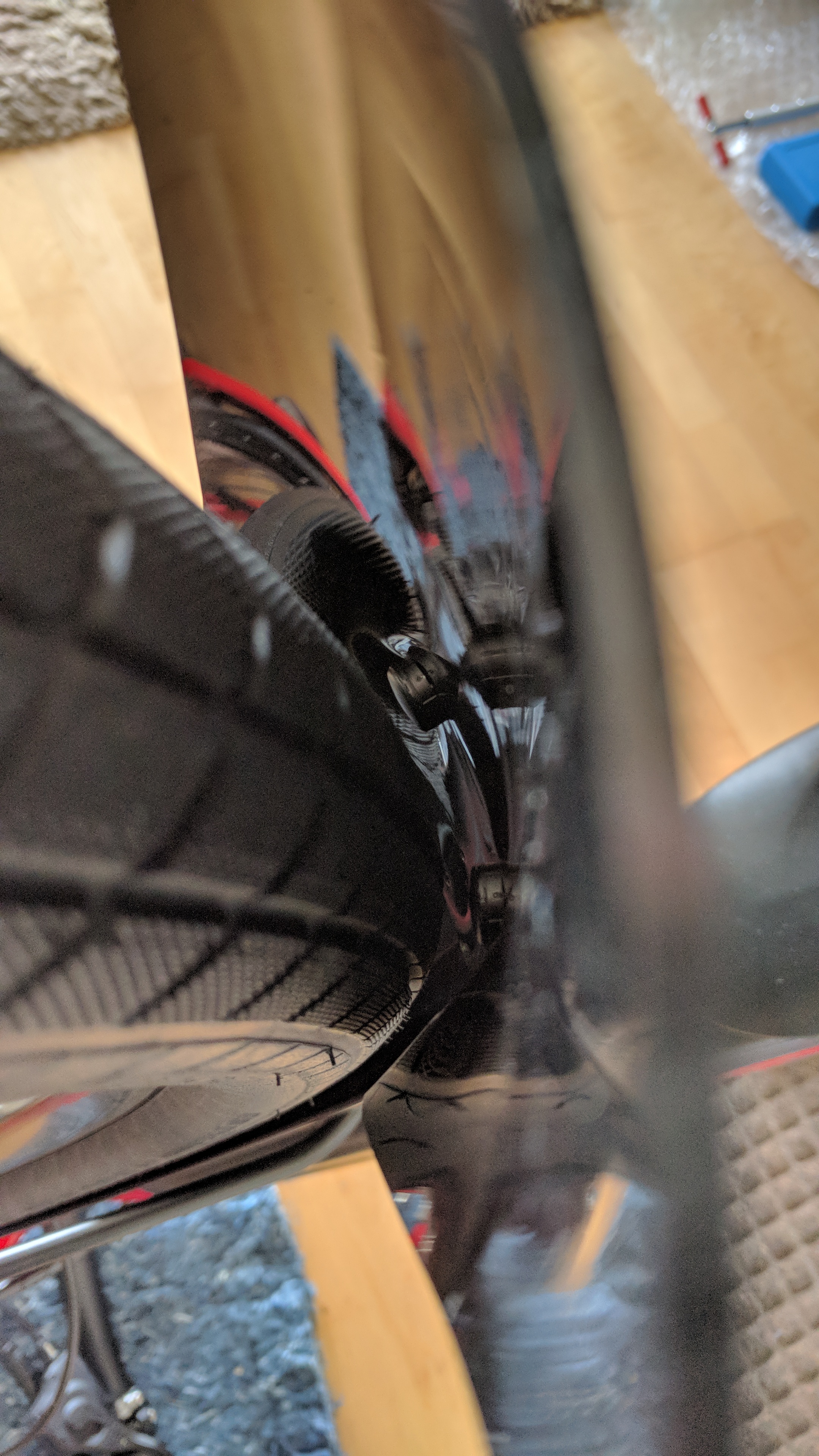

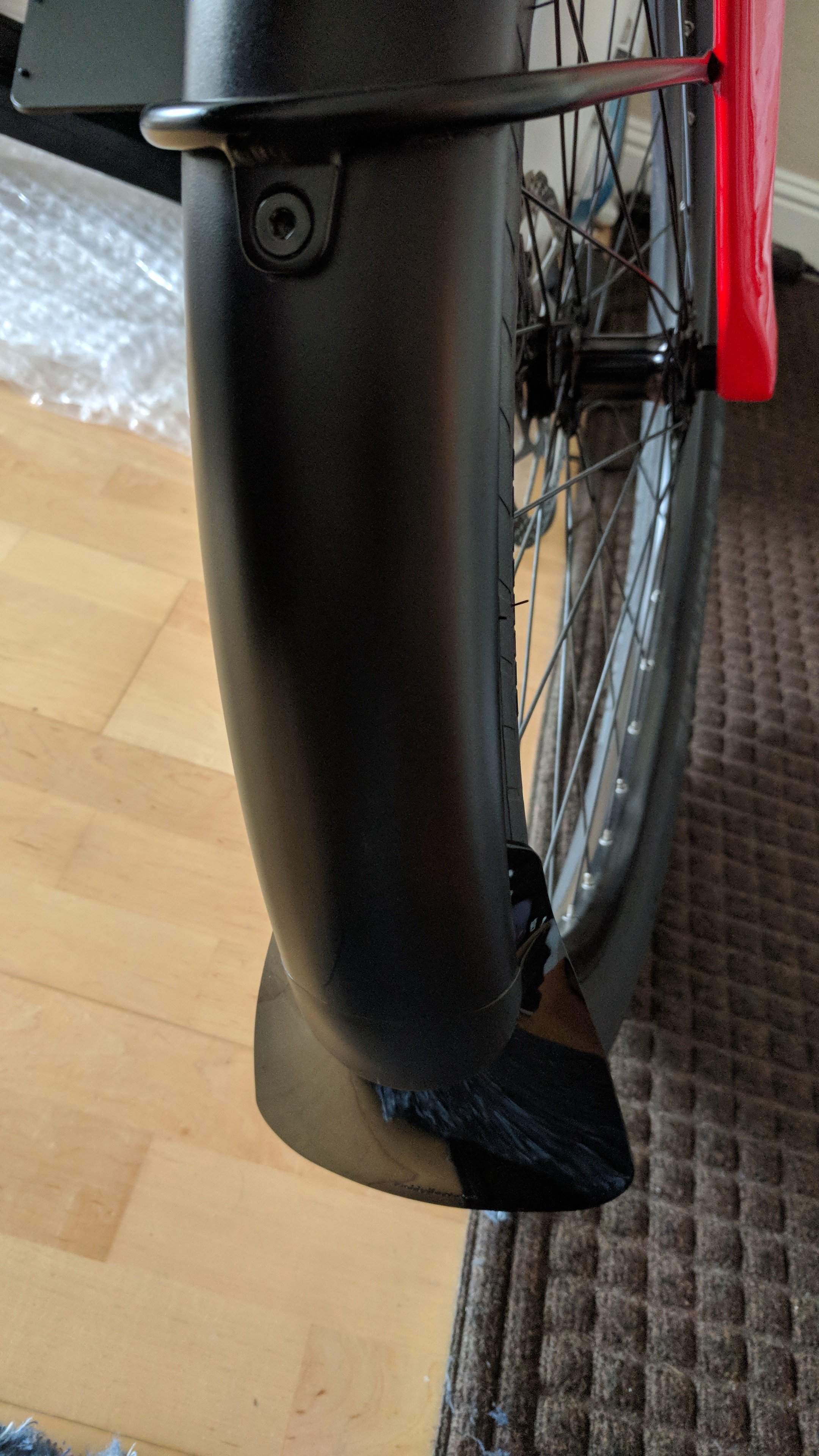

View attachment 33347View attachment 33348View attachment 33349
View attachment 33350View attachment 33351
