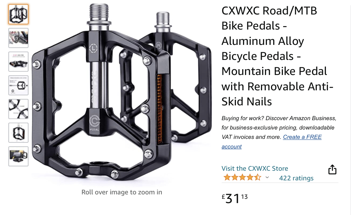

I changed mine on my Nevo3 GT Vario GX. They were a plastic material with moulded studs on them. However, these had started to wear away.
Changed them for the following, which are Aluminium with screw-in steel studs.

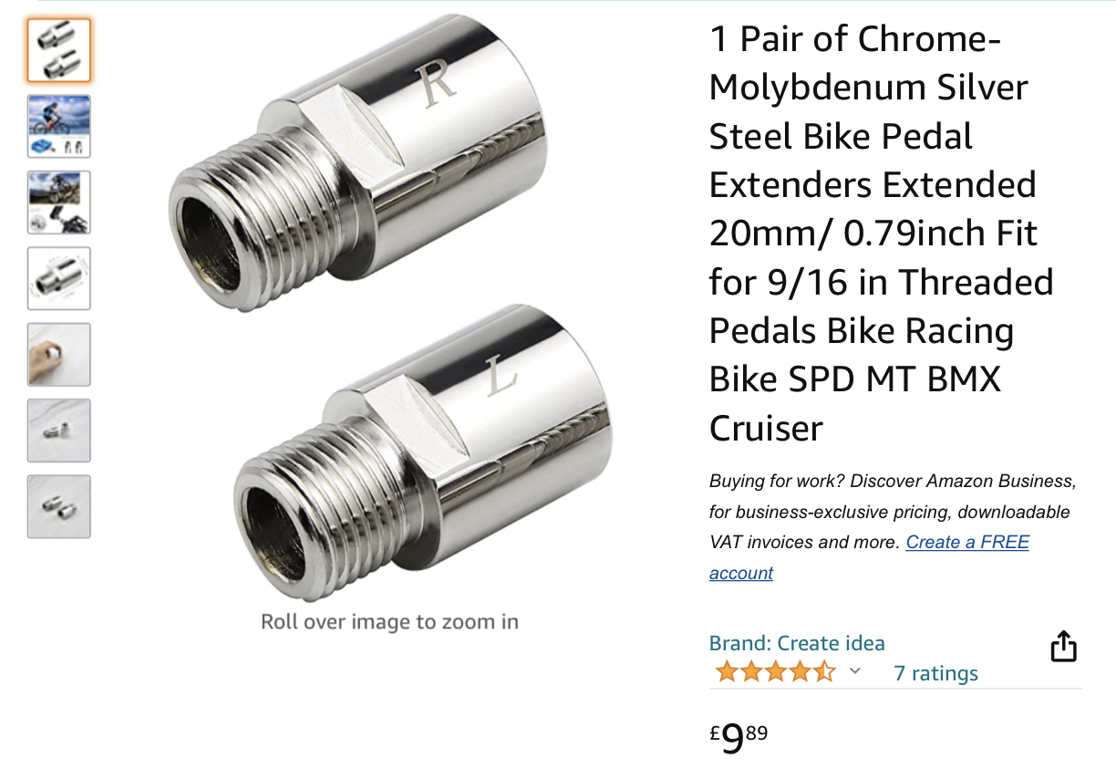

These are slightly bigger all round as I have size 13 feet. I have also added a set of these pedal extenders to take them further away from the frame as my heels we’re catching the frame.
Both were very easy to fit, needed a 8mm Allen key for the pedals and the extenders are hollow, so the Allen key fits through them. Consequently, when you tighten the pedal up, it also tightens up the extender also.
