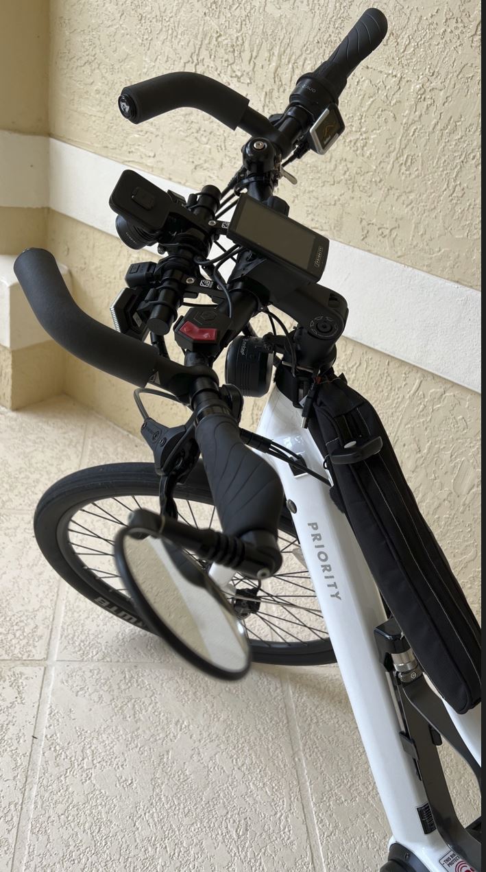

Really interested in doing the Como handlebar swap as well. How are you liking it? Did it give the bike a lot more of an upright feel? Would you be able to post a picture from the side of the bike? Thanks!
I'm loving the Como handlebar. The 30-degree back sweep of the Como handlebar with the appropriate seat post height and adjustment of the Current adjustable stem should allow you to achieve a comfortable moderate to fully upright riding position. I won't be able to post a picture until next week as I'm traveling this week.
Better late than never! Here is a picture of the Como handlebar on my bike from a side view.
