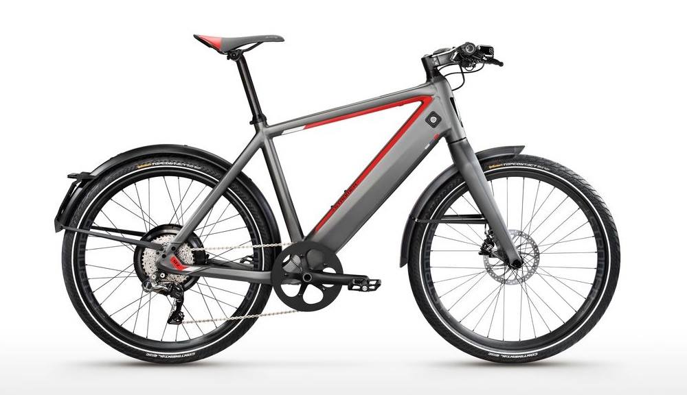

Here is a pic of the 2016 Stromer ST2.
@bluecat 's predictions are absolutely correct :)
Here are the upgrades: (feel free to add more if I missed)
~1000Whr battery ( AWESOME! )
Shimano Di2 electronic shifter
Dual beam headlights
A nice brooks cambium saddle
Magura MT5 dual piston calipers
New color, rims and decals
Nice to see them getting a little more sporty with the styling. Would love multiple style/color options.

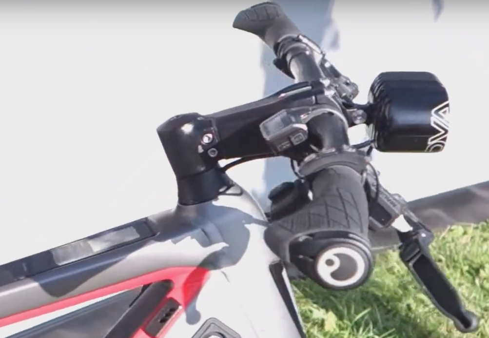

Is the device mounted to the handlebar, near the stem, meant to control the light?

I have to apologize for my misleading screenshot!
Indeed, you're right. The tiny device is the gear display, the M99Pro is switched with the usual button. A you expected, an new firmware (2.0) allows toggling between daylight, low + high beam by pressing the button longer.
