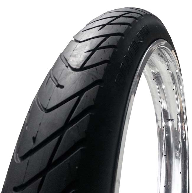

Street or less rolling resistance Replacment tires ? for the fat rims...I'm in Canada
This is from Duro site and it is on a 100mm rim 😲
Dono Be - thanks! That's just what I wanted to know. I was concerned about the bead seating properly; didn't really think about how it would spread out the tread against the road. Or the sidewall. I was also concerned about the reduced height of the whole wheel compared to the 4" knobby. Was thinking it would drop the height by about 2". I'll report back if I put it on. Thanks again.

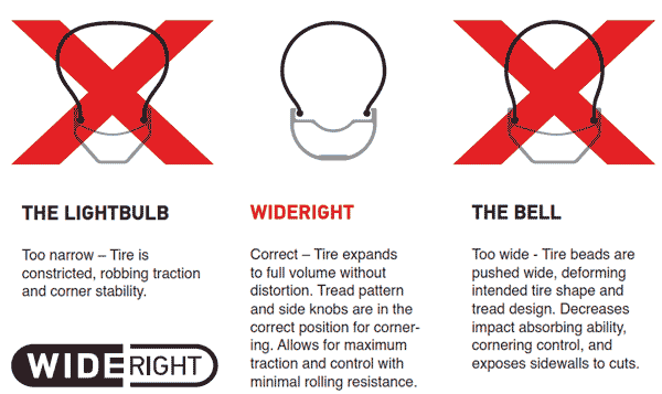

Jeff, I don't think the tire/rim tables really address your specific combination.
I would recommend mounting the new tires and then checking the profile.
You want a nice round shape... try to avoid a lightbulb or bell-shaped profile.
I hope this helps... take a look at the referenced article for more details. ;)
FlatSix - thanks, thats very helpful. Looks like the 3" tire might work but not be ideal.

Here is a Tire and Rim chart that may prove helpful... ;)
I would recommend a minimum tire size of 3.8" if you have 65 mm rim.
This is an estimation of rim width tyre size chart to help identity what rims you should look at,
however tire brands will have their own recommendations which should be adhered to. This information can be found on the sidewall of your tires.
Generally speaking, if your tire is narrow compared to the rim, you risk pinch flatting and damage to the wide rim.
If your tire is too wide compared to the rim, you risk burping/excess tire roll, and poor stability.
