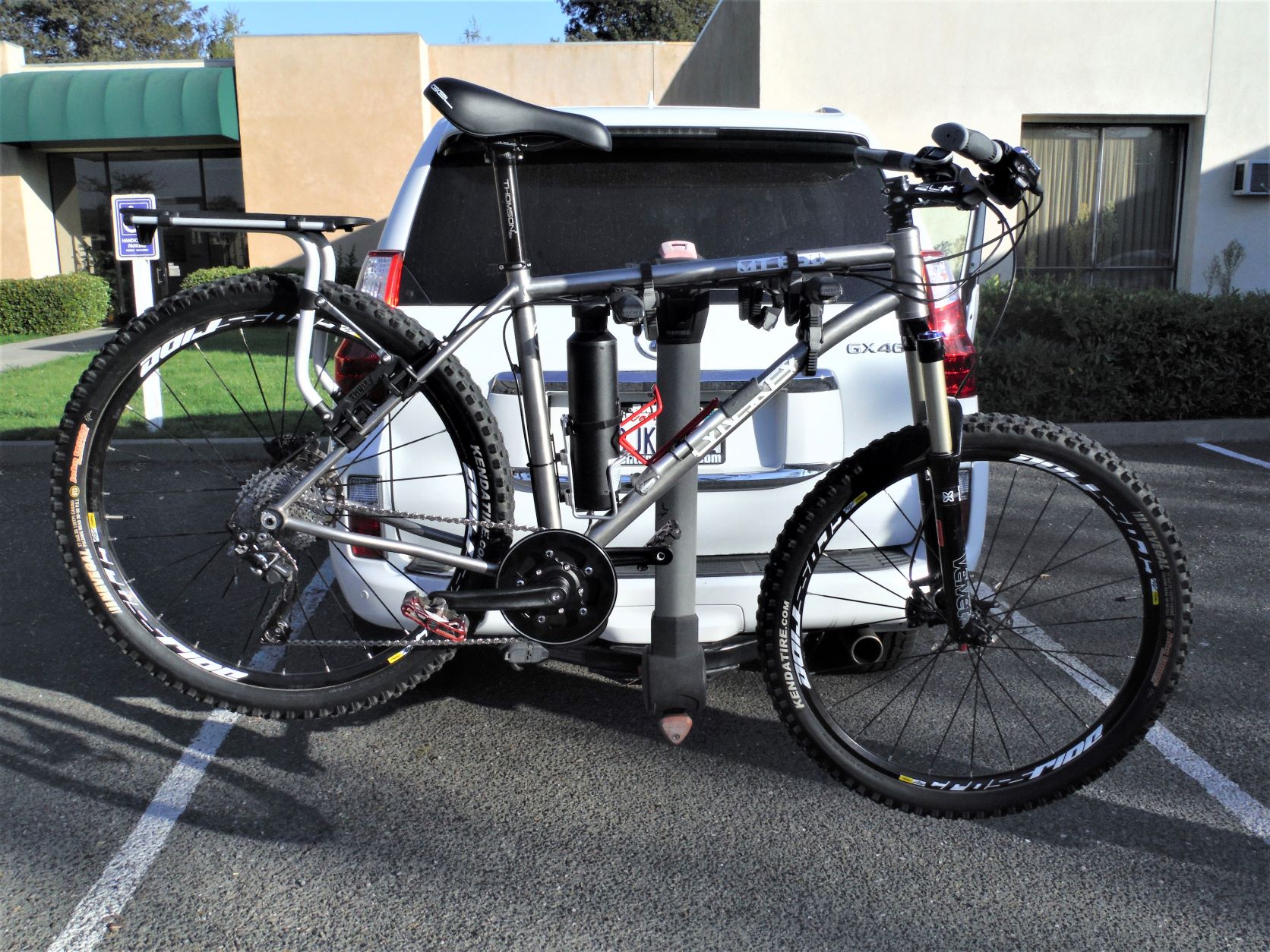

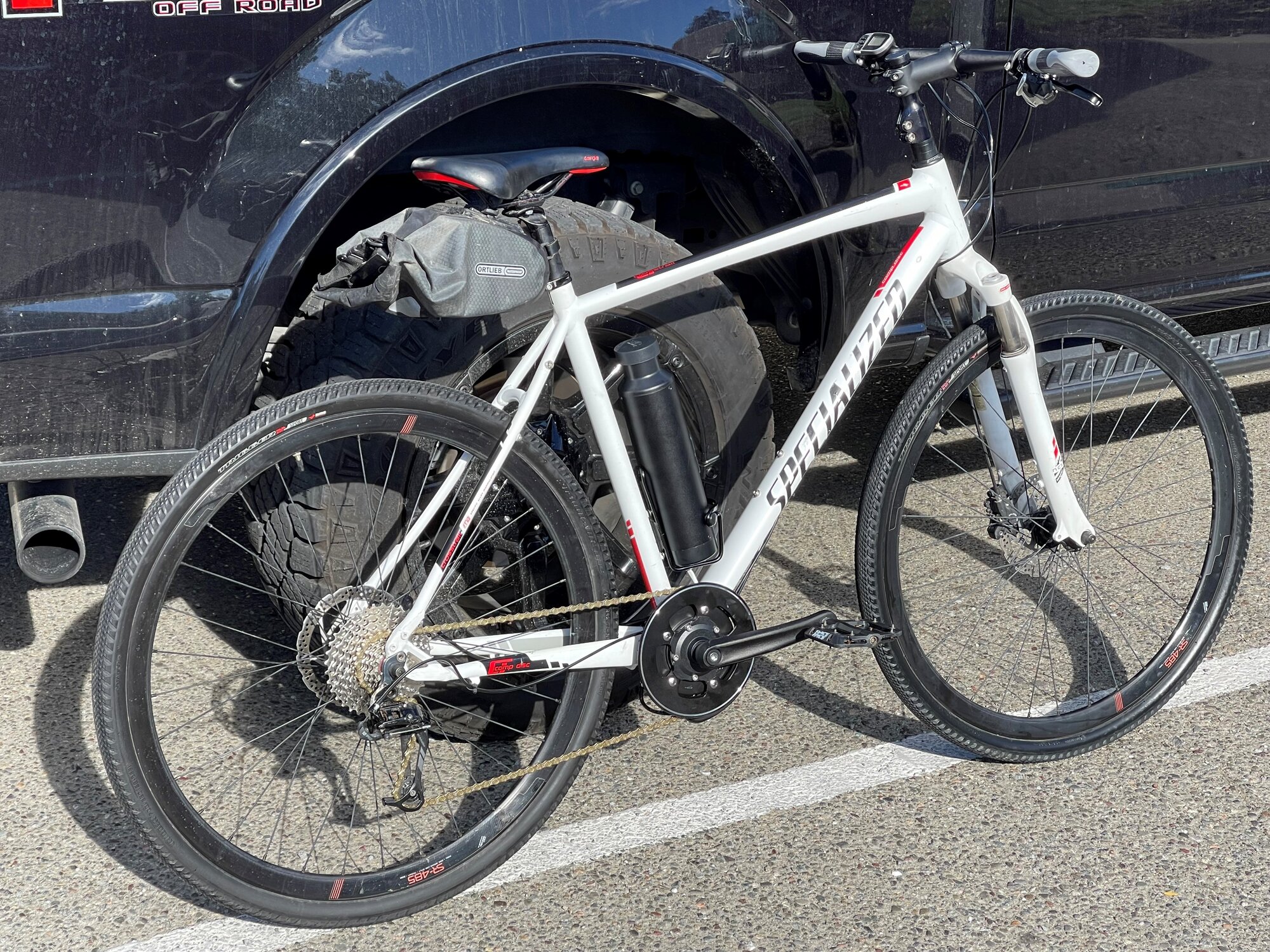

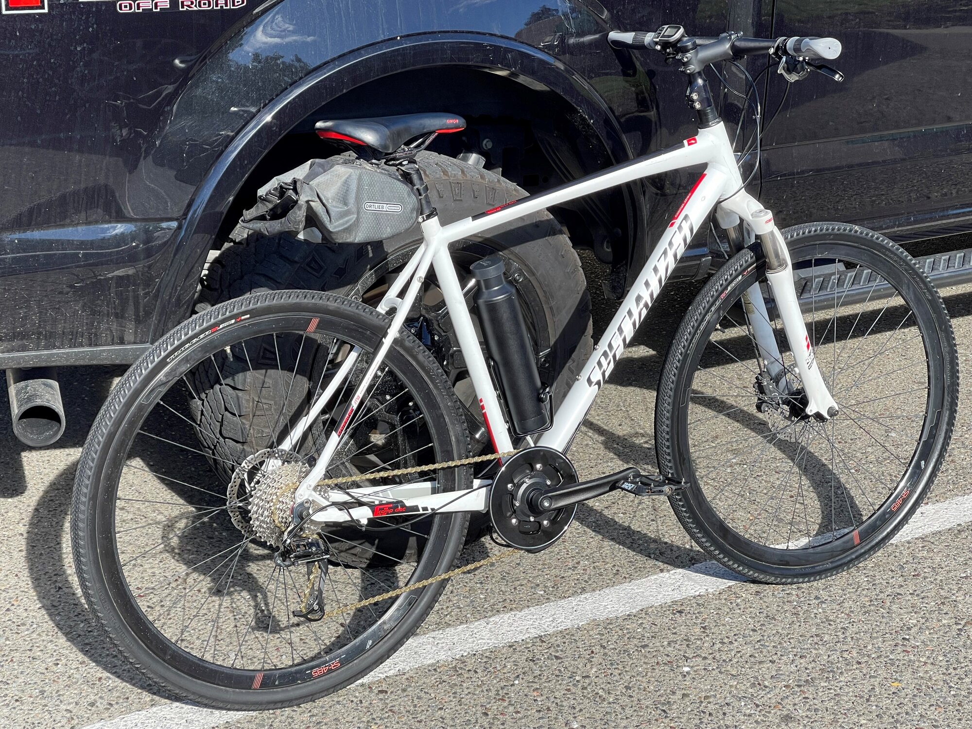

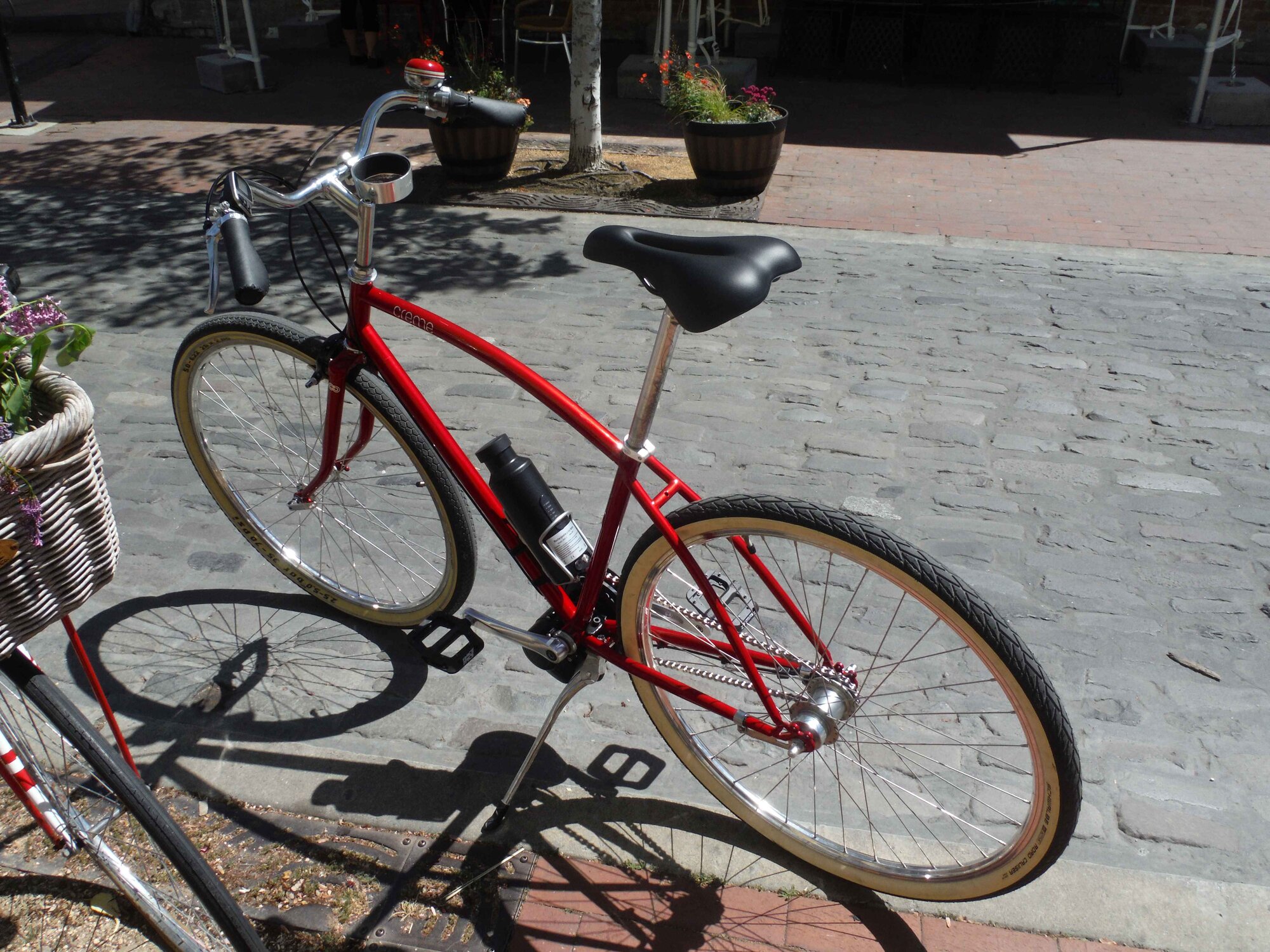

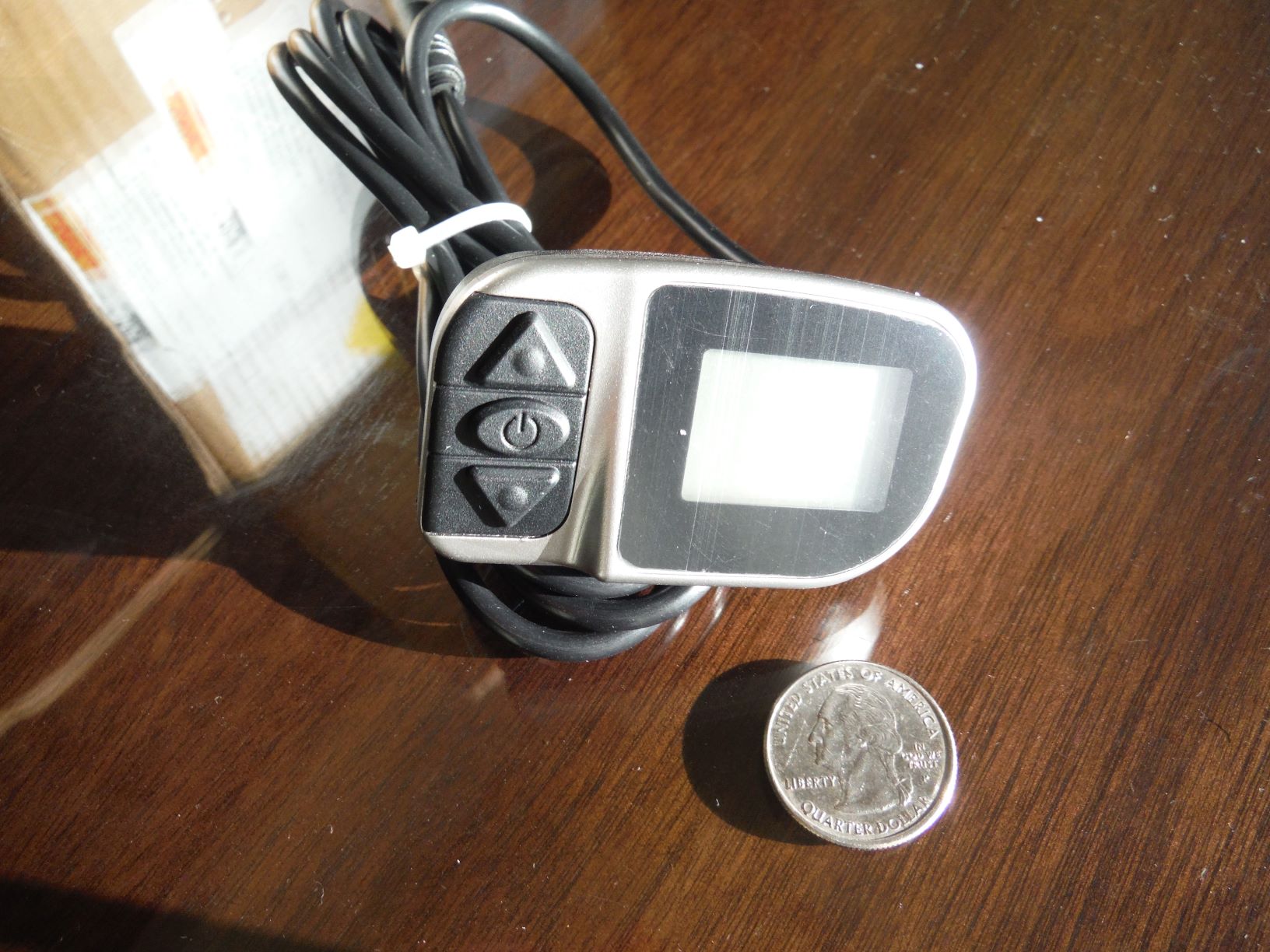

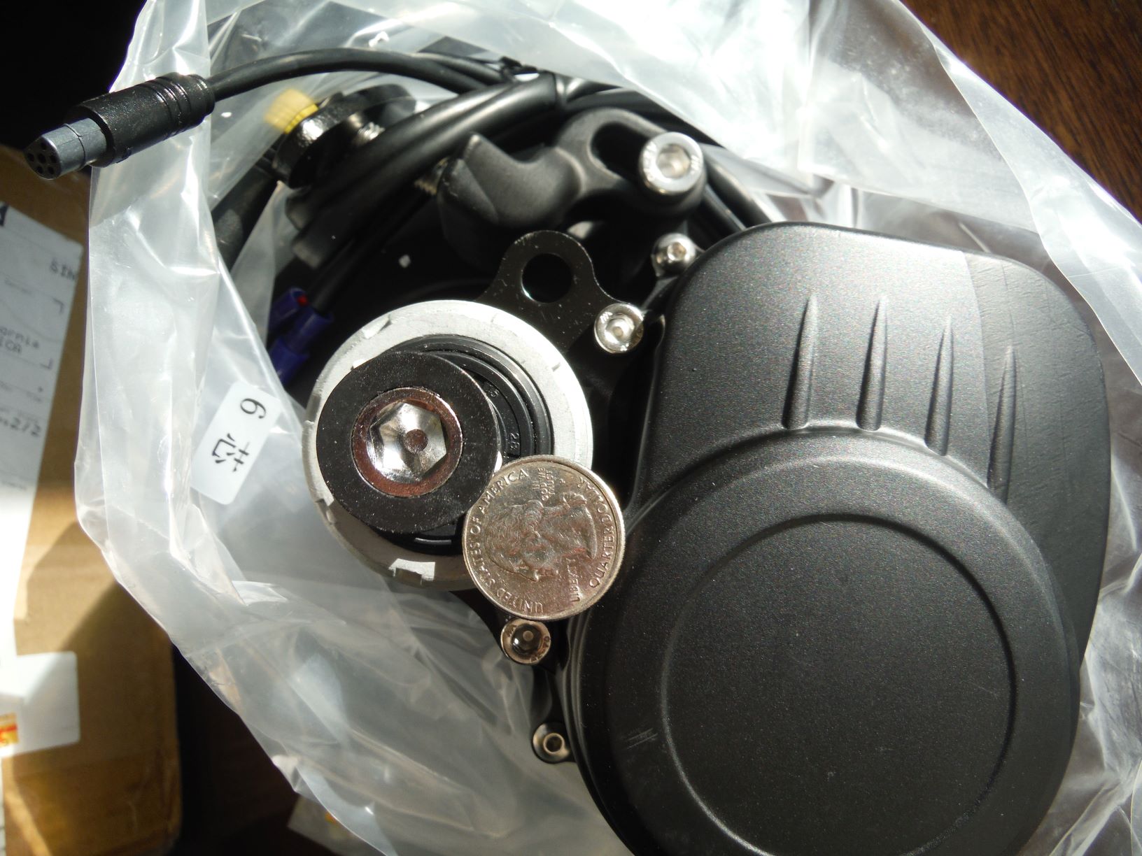

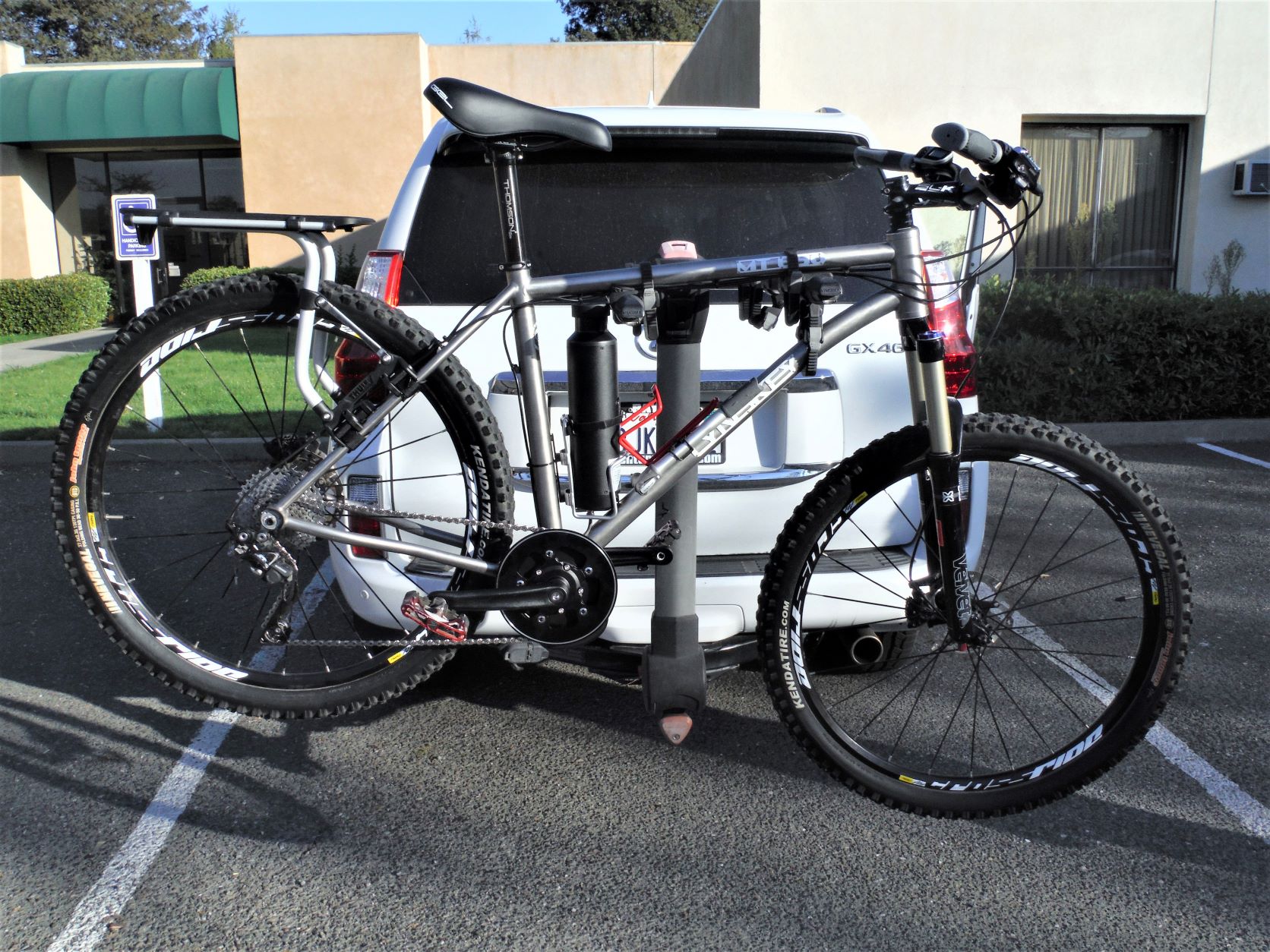

Yes, it is a mid-drive thing with some models that allow for such options. The firmware will take a class 3 bike to class 2, then add in some lag in the name of smoothness when you plug in the throttle. You don't want to do a throttle wheelie or snap the chain off at a start so lag is added. I like them perky and powerful but without bleeding-out the battery quickly so I can get big miles on a lightweight build. I like the 'throttle' in my foot with a torque sensor. Here is a recent build. The idea being, take a $300 bike and make it out run and out last $9400 bikes from stores. This Specialized 10-speed has a gold chain to commemorate the birthday of Mr. T. The display is on the left handlebar. The water bottle is the battery. It is lightweight and has good weight distribution with the motor between the pedals. I chopped off all the connectors and ugly wires. I will add a photo of another recent build with white wires for cleanliness and hygiene. But it is best when you get rid of all the wires, as with the third eBike.

I wish you were local. I'd be interested in rebuilding my custom titanium which was converted to a front wheel motor. The battery takes up the convenient downtube waterbottle position making the harder to reach seat tube water bottle primary. It is more powerful than my Specialized Creo but the front motor makes for more squirrelly steering.

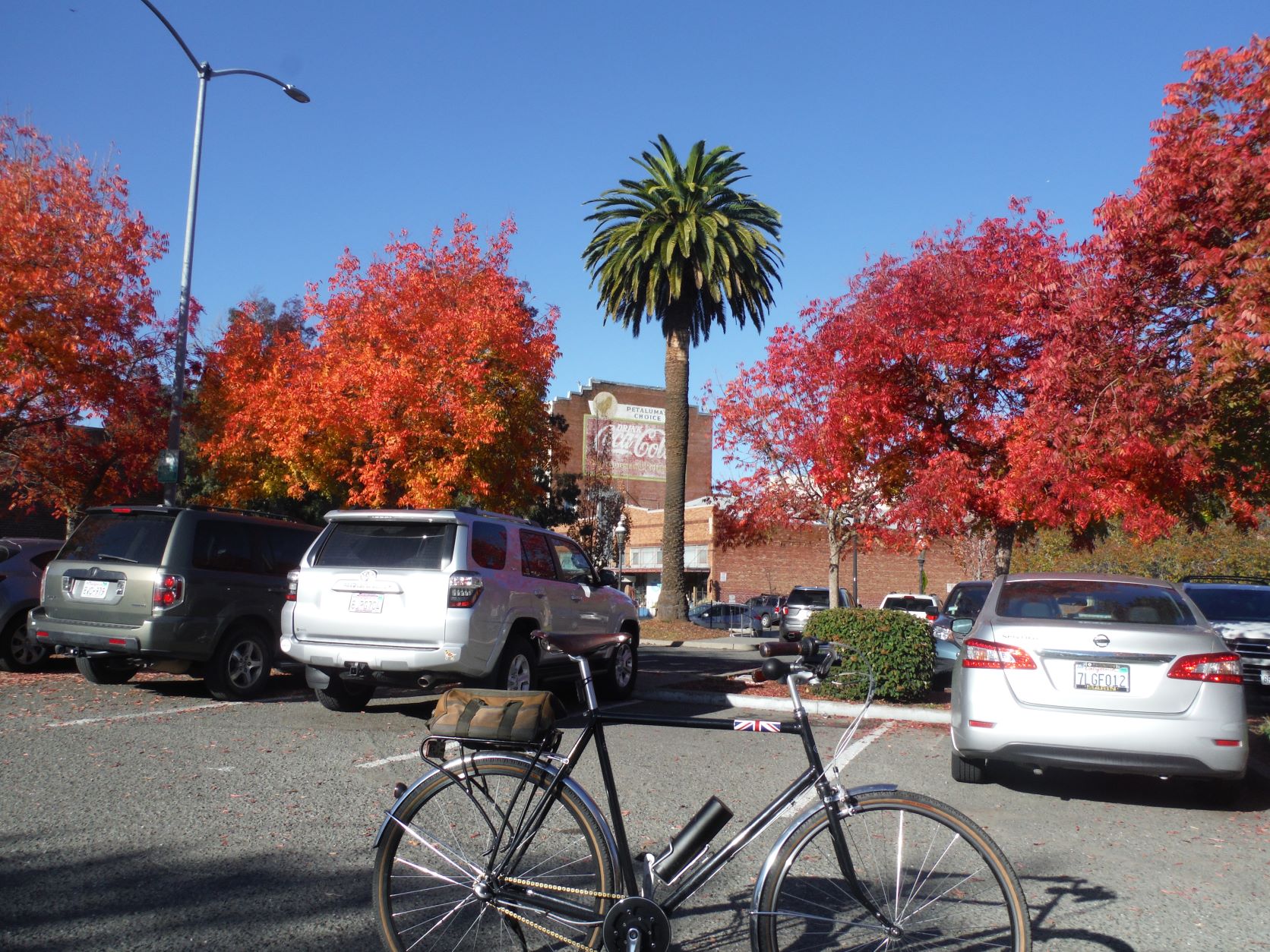

@kahn, Here is a titanium bike I converted two weeks ago. Today it is a recumbent. There are plenty of great bikes out there that can be updated and recycled. One of my personal favorites is a converted Crème from Poland. It is the black one by the brick wall. There is a chrome one in Canada for pre-order. https://velolifestyle.com/dutch-city-bikes/creme-caferacer-man-uno-chrome-new-arrival

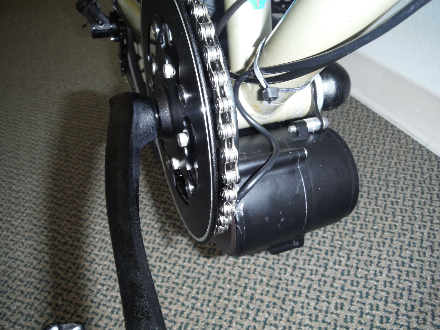

What kind of range to those batteries get - yes, I know if depends on use? How many rings on the chain ring - down to one? I want to see the MOTOR side view? (g)

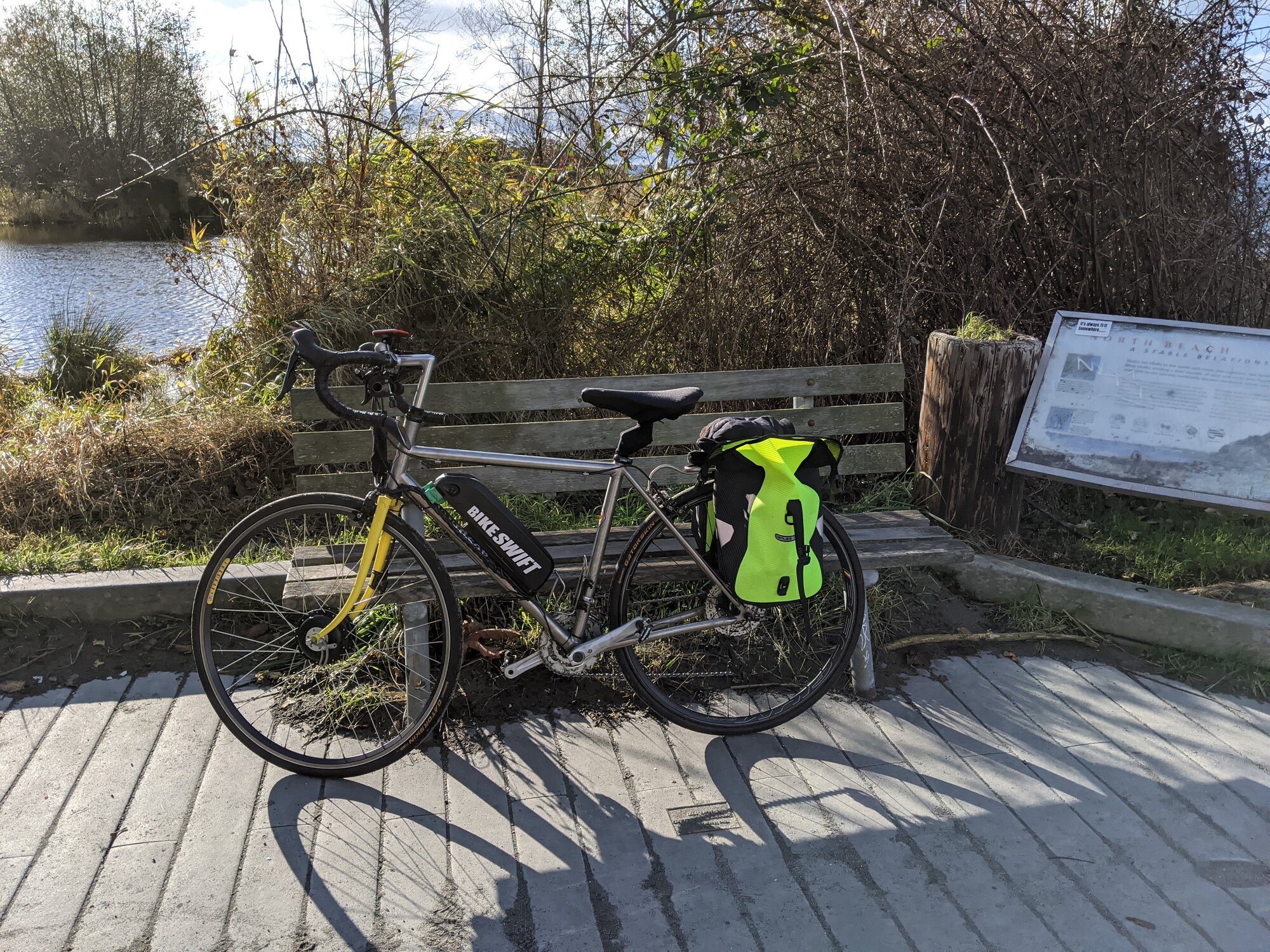

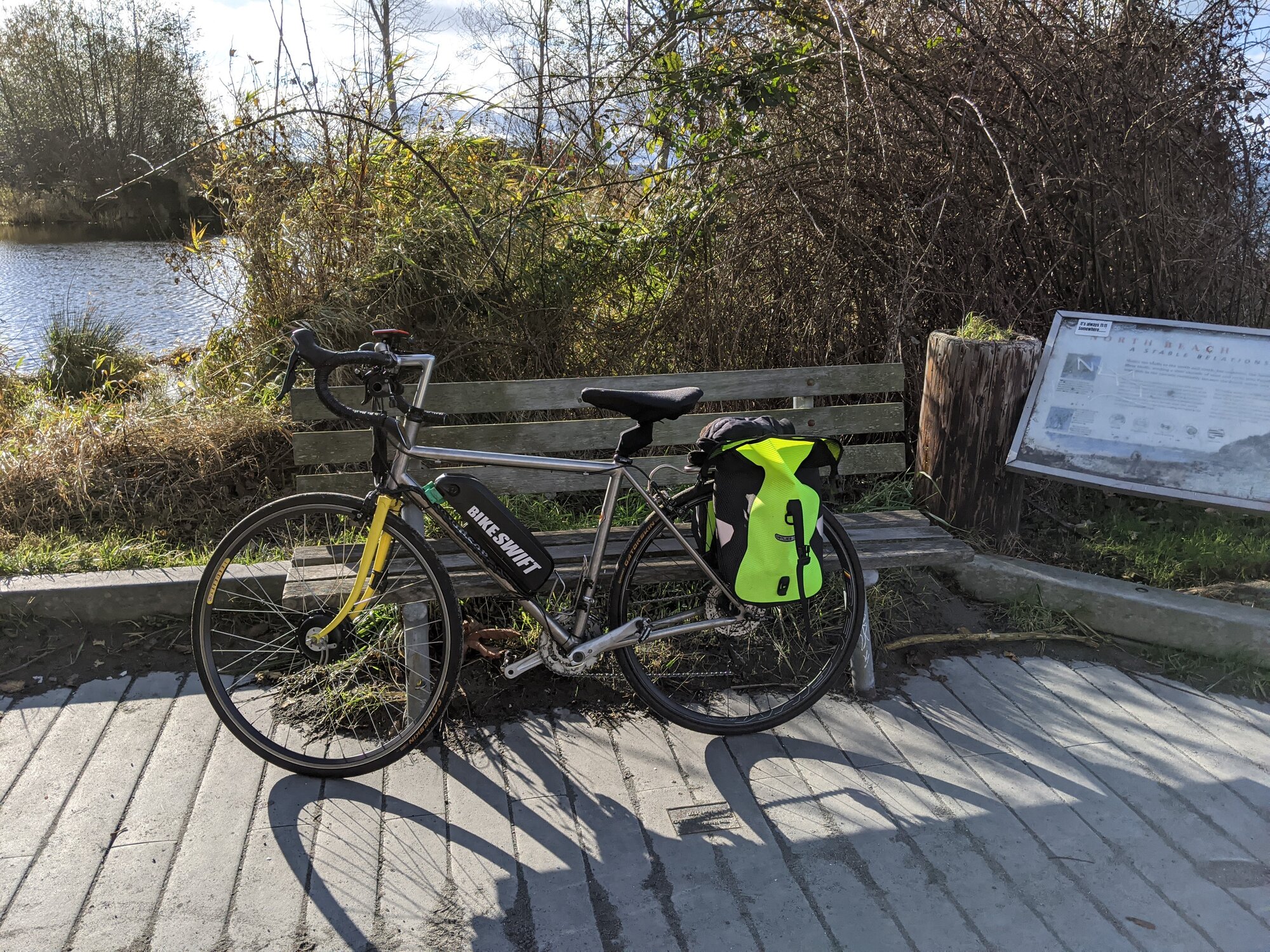

Here's my non-Creo e-bike

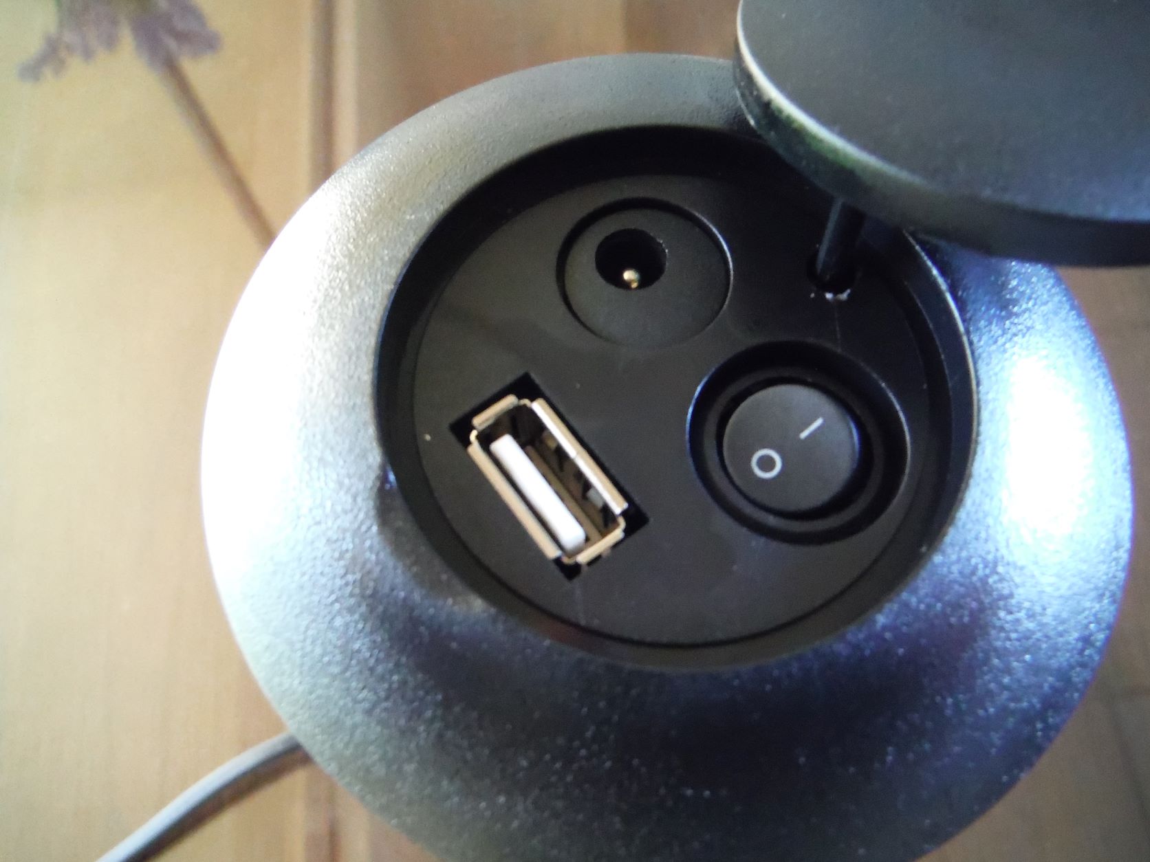

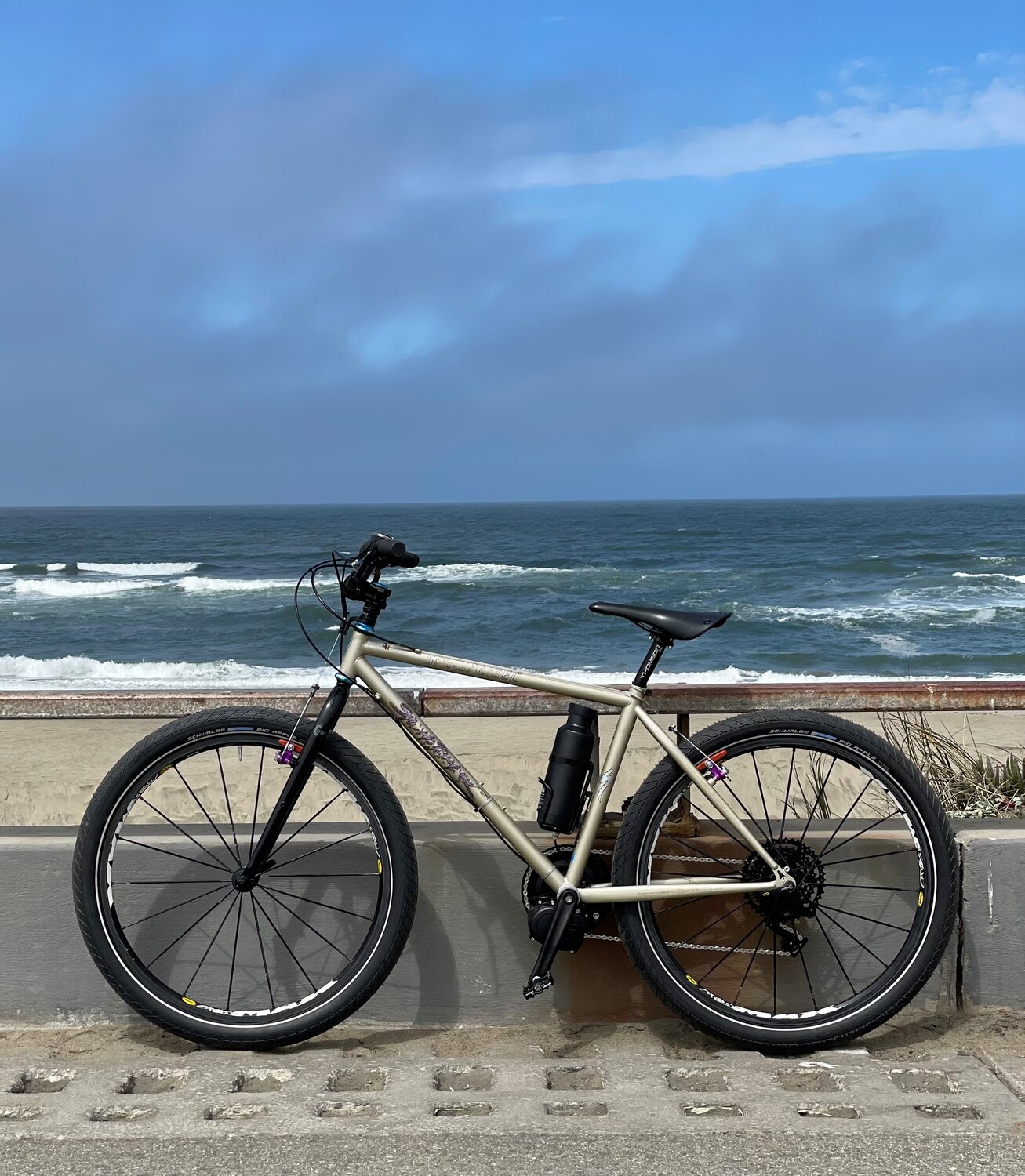

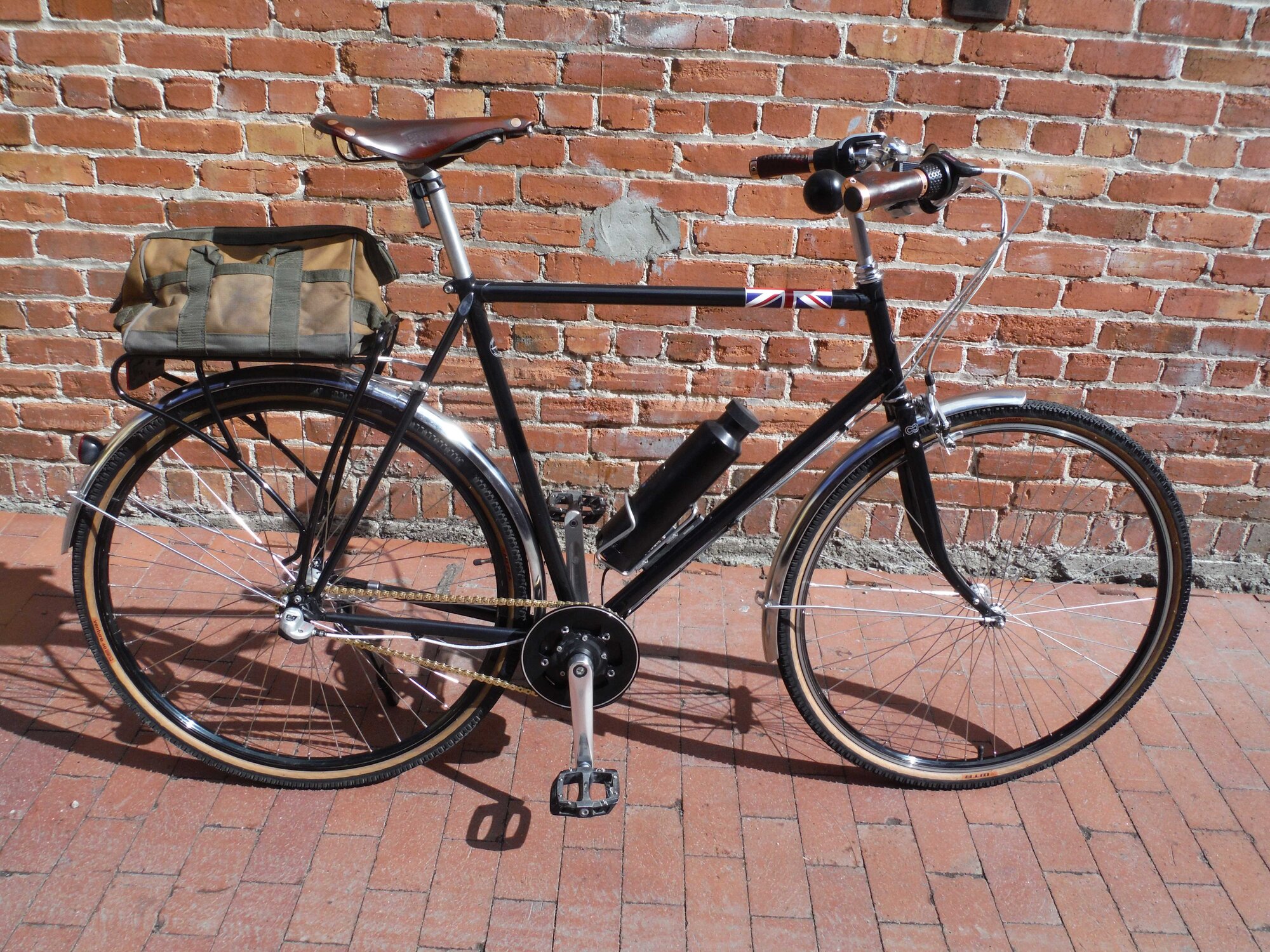

Cool frame. I love it. The bikes are built with a universal connector that works with a bunch of battery sizes. The 36V connector and 48V connector are different from each other on purpose. I usually go for the smallest battery the works for a particular ride. There is no reason to take a four hour battery on a 50 mile ride when a two hour battery saves weight. Default is a 42-t single chainring. Today's build is 50-t. Zoom in on the bike by the sea. That is a mid-1980's Specialized.
That classic looking black Euro bike is still being made in Poland for 2022. https://cremecycles.com/deutsch. It is a Creme Caferacer Men Uno. There is no US distribution for these handmade Polish bikes. In North America they are only available in Montreal and Vancouver. I purchased two. The other is in Boston.

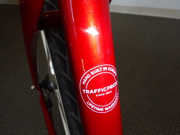

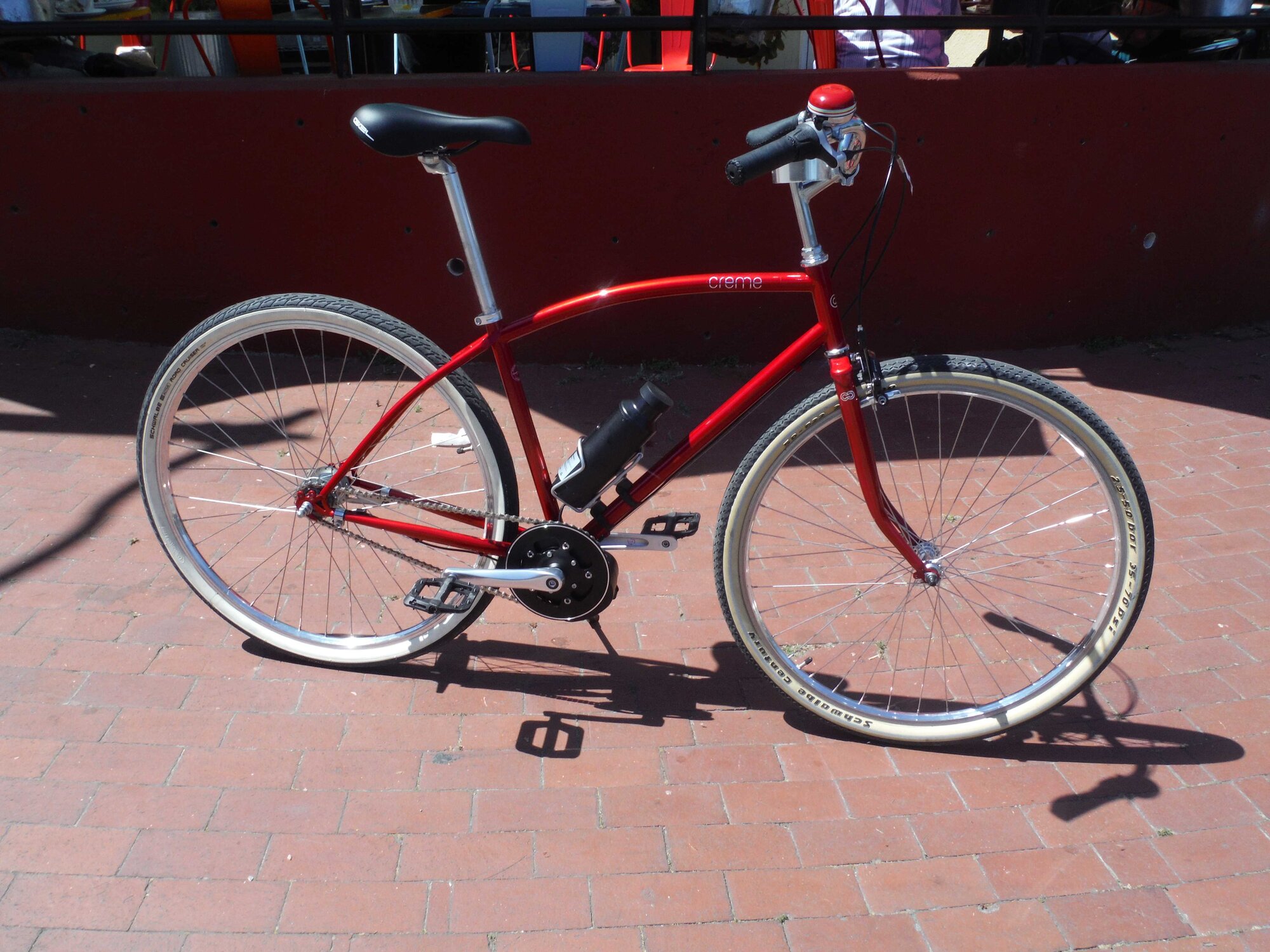

There are 23 Polish dealers of Crème in the major cities. They are largely simple classic urban bikes with handmade lugged steel frames. A few are Al. Their Shimano Steps 7 eBikes look like electric bikes from about six years ago. Batteries are obvious but easily removable, a good thing. Crème's non-electrics bikes have some lower level build details that can easily be upgraded, such as grips, saddles, and pedals. But it is all about the frame. My cousin in Boston says that he feels like he is in an Italian movie when he rides his. Classic with style. Everyone comments. Here is another handmade Polish Crème conversion to electric. The owner has hand issues so it is a coaster brake. So, she does not need to rely on her hands to stop. The 'throttle' is in the pedals for her starts. Sorry, the saddle is too high in the photos. I needed to test ride it. Does it look much like an electric bike?
