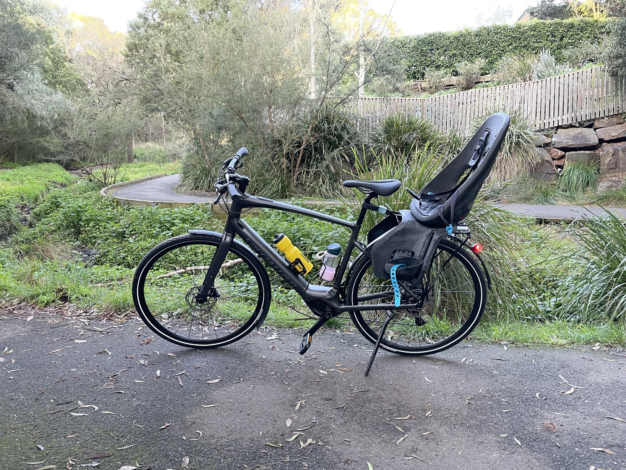

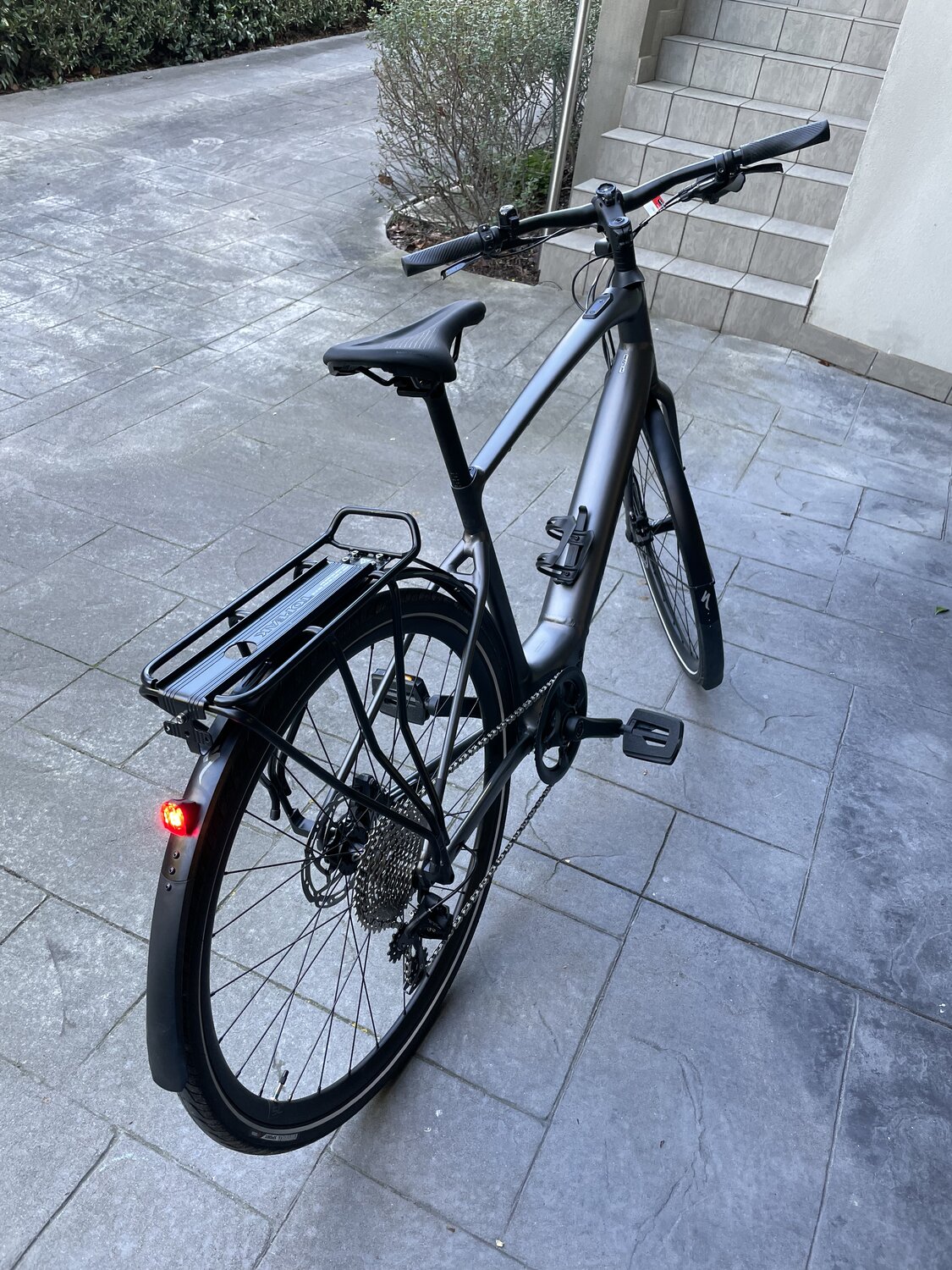

Just thought I'd share what I picked up today - I'm very happy with it. Carrying my 16kg toddler up hills is a breeze, I've had the rear rack upgraded to a topeak (by my LBS) one to increase carrying capacity to 25kg, the size (L) is also much better than my old bike (unsure of size likely a M and different brand) the new bike gives us both more room.

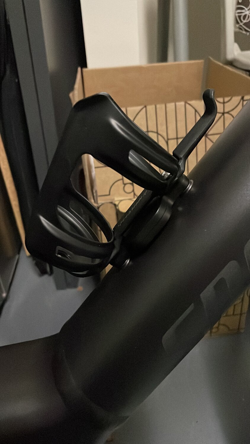

Added some bottle cages, hid an Apple airtag under one the cages with a black plastic case (I got on Amazon) plus some security bolts and it blends in beautifully.
Thanks very much again to everyone for helping with my questions - actually looking forward to my Monday morning work commute!

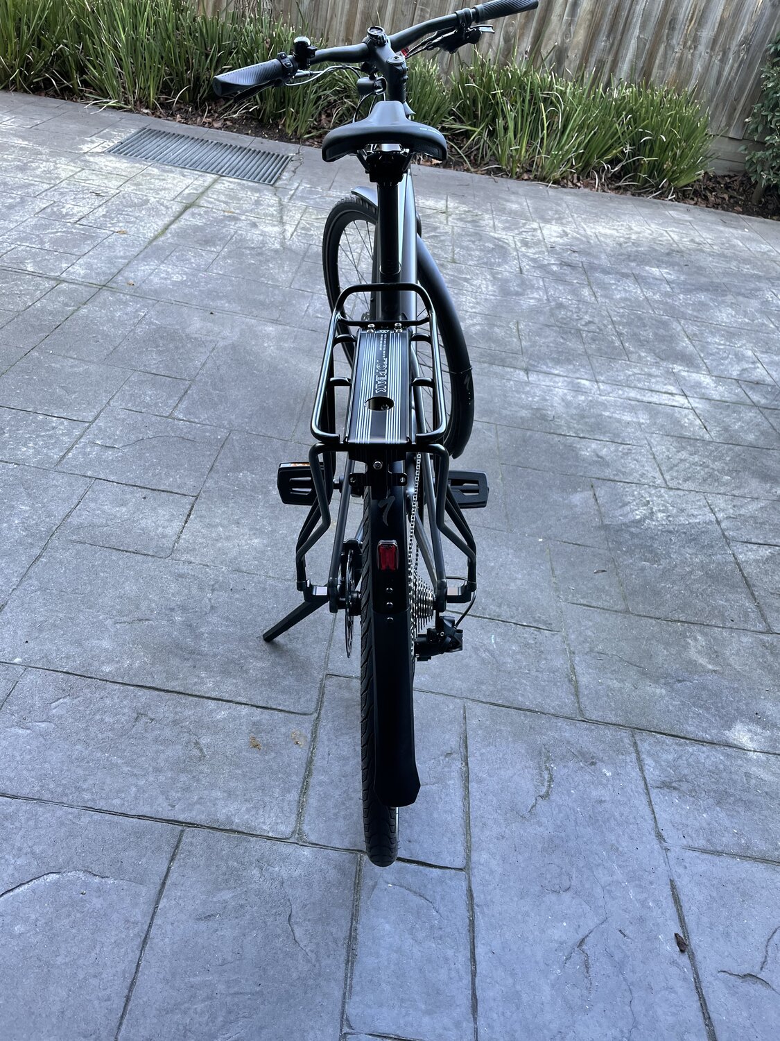

Has anyone had issues with rear guard being out of alignment (photo attached) suspect it's possibly
because of the rack change? I've gently bent it overback to centre after taking the photo.
Added some bottle cages, hid an airbag under one the cage with a black plastic case plus some security bolts and it blends in beautifully.

Has anyone had issues with rear guard being out of alignment (photo attached) suspect it's possibly View attachment 130660because of the rack change? I've gently bent it overback to centre after taking the photo.

what is the weight limit for the rack mount version of that seat? i have the frame mount version, and my little one is getting a bit too big for it. i wonder if it would work up to the 25kg that the rack supports?
Hey @mschwett
I got this rack https://www.topeak.com/global/en/product/318-BABYSEAT-II-RACK-(DISC)
The extensions for the rack I'm not sure which ones they used id have to check with my LBS but happy to if you want - I can send you some more photos. It's not 100% perfect right up close but gets my kid on my bike safely!
This seat it weighs 3kg and can hold a kid up to 22kgs

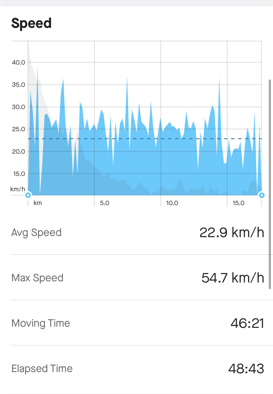

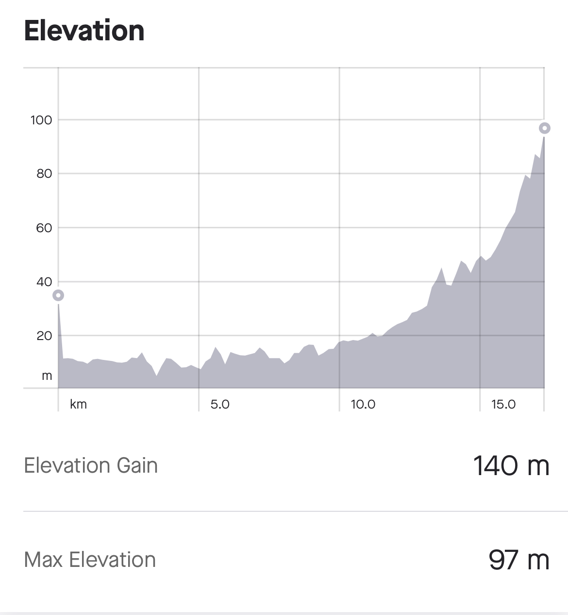

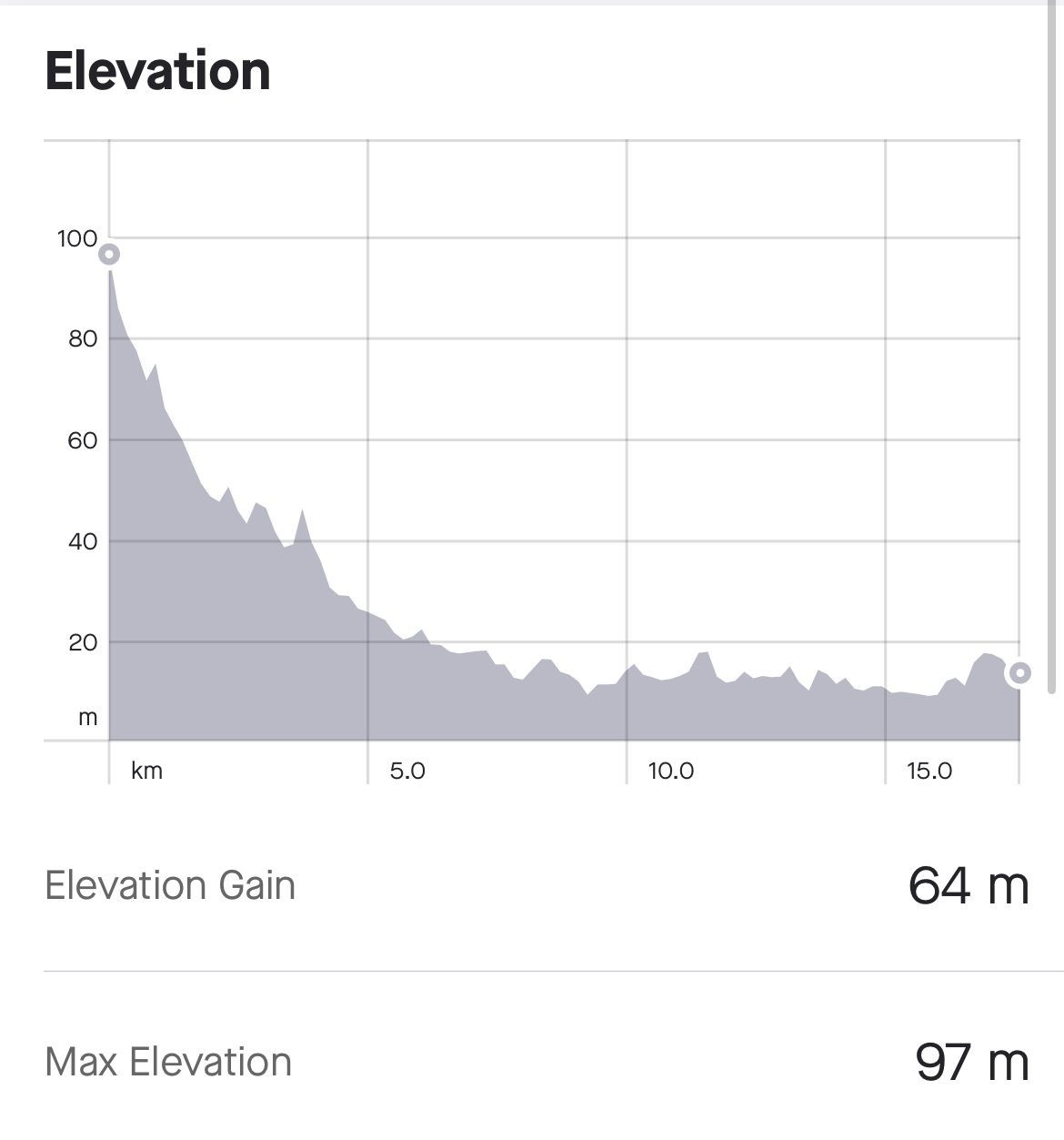

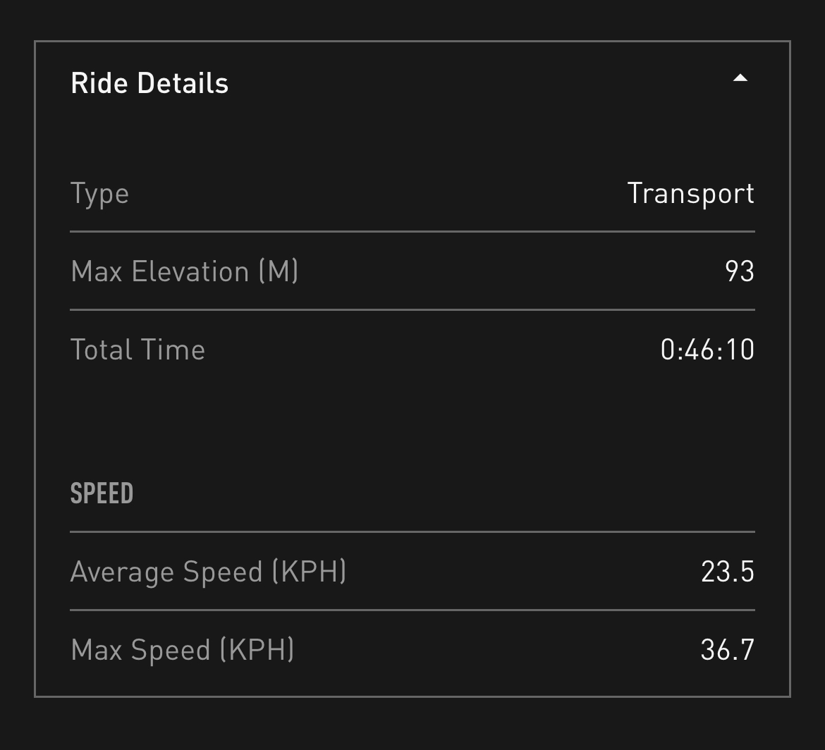

Here is my stats from the commute in - I’m impressed by your math!! And anxious about my battery life haha
You will see the elevation increase that will be in reverse for the battery and also attached speed separately - still think I can make it the whole way in sport?
if i'm reading your chart correctly... there's a climb of about 85m over a distance of perhaps 8km for the second half of your ride home. although there are some ups and down, that's only an average grade of a percent or two. to go 25kph up a 2% grade on a vado SL doesn't take much more than 250 watts TOTAL, including your input. in a situation like the one you describe on a partially charged SL bike, i'd turn the assist off completely until i got to the hill, and then put it on eco or sport, get into a climbing gear, and take it at 20kph or so.
Oh no! I have overlooked the fact Kris was riding an SL e-bike (for some reason, I thought it was a big Vado)! The whole math I did was useless! Thank you Mark. It is still morning here.

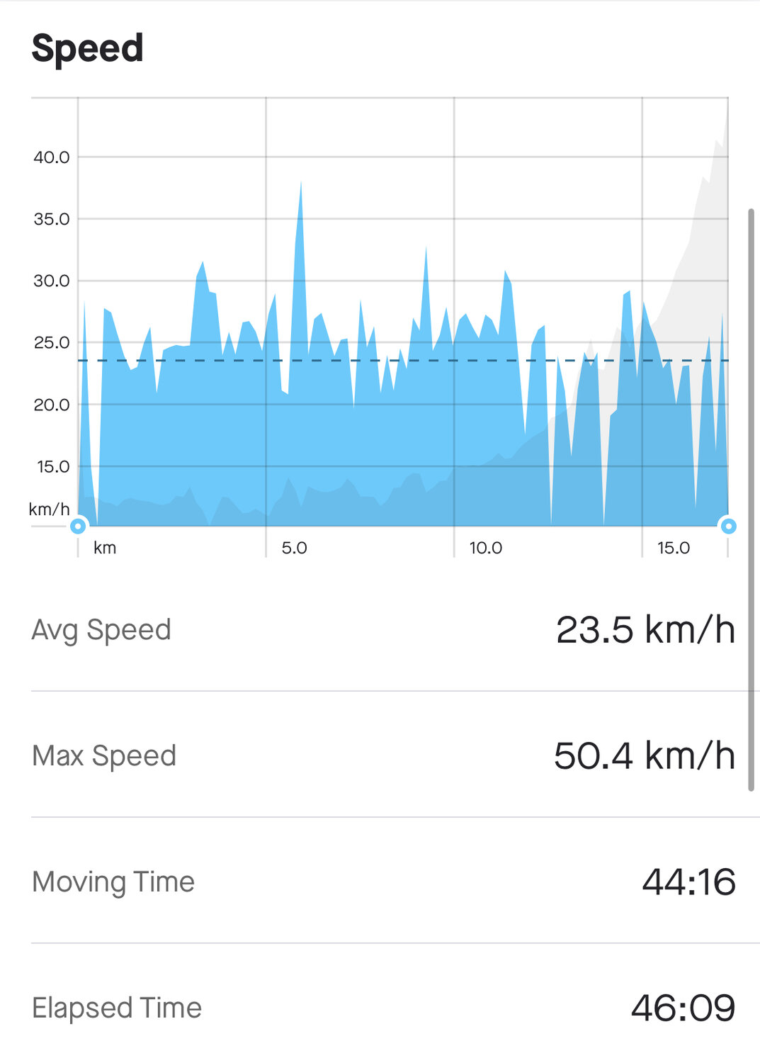

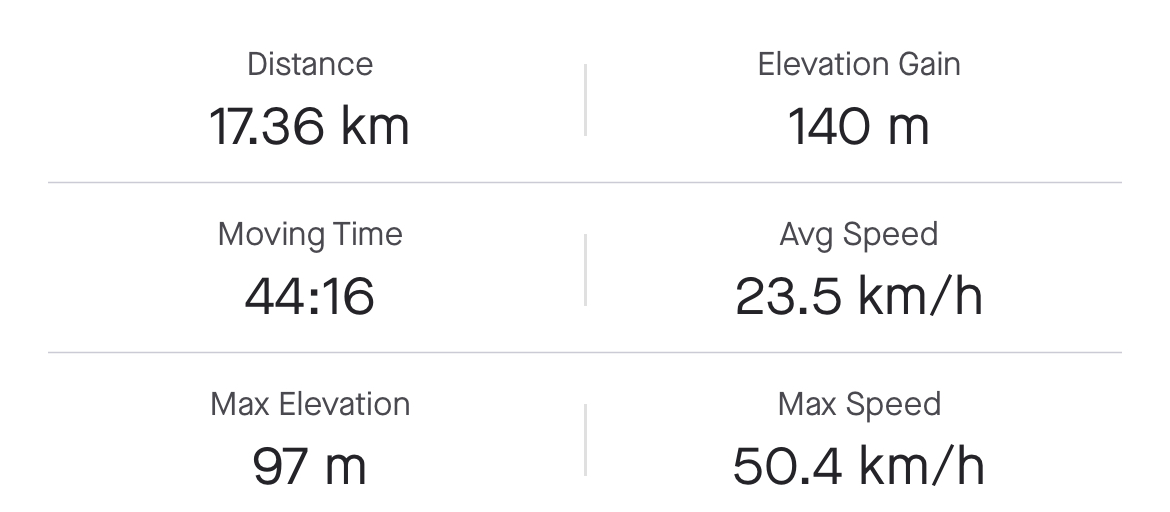

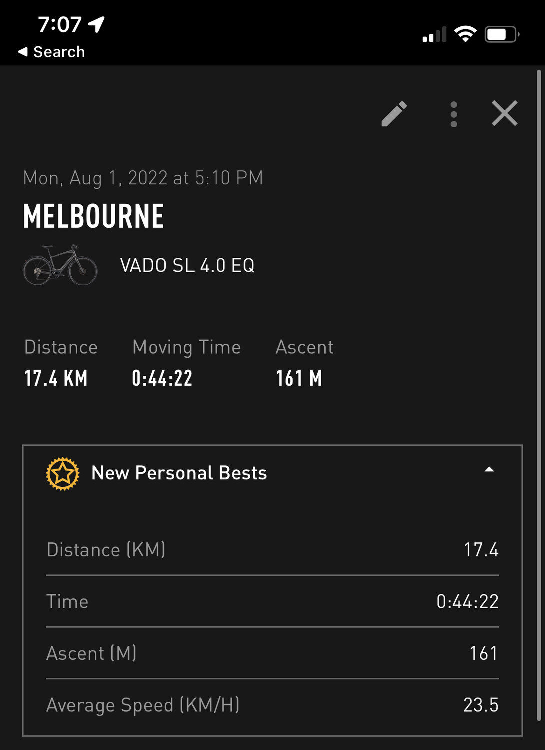

Thanks @mschwett and @Stefan Mikes I rode somewhat conservatively and came home with 2 bars of battery still! Interesting (black images are from Specialized app) and (white ones are from it being shared to Strava)
You’ll note 50km/h + max speed which isn’t in the ride app… strange…. Max speed on ride app is 36.7!
Either way great news is I made it home! Battery still with capacity and turbo used for the hills I needed it on!
Bike is currently on charge :)
@Stefan Mikes managed the average of 23.5 but did seem to hit 25 loads of time. Welcome to any suggestions to tune/improve anything… if only my bike cut out at 40 instead of 25 😂
